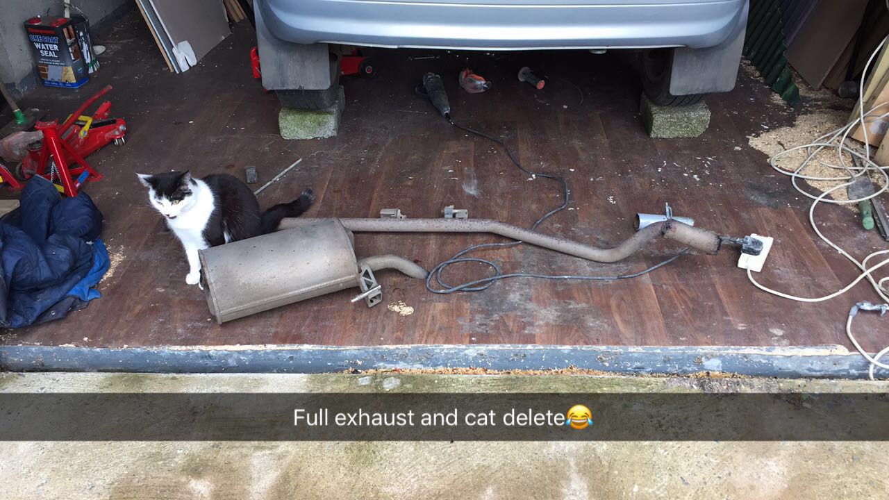

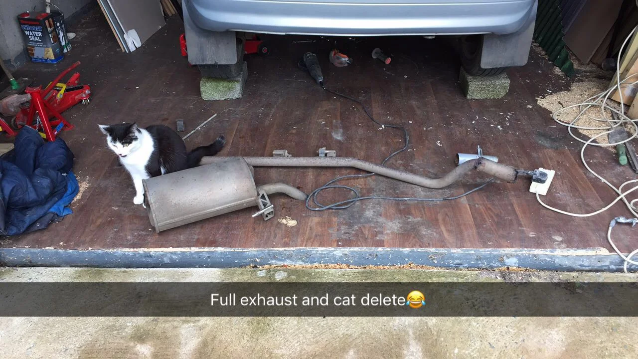

In this photo you can see i removed the mid pipe and the back box from the car. You may also notice there is already a straight piece of pipe at the end of the mid pipe which was from a previous attempt at this project which to be quite honest i messed up as i lacked the appropriate tools and knowledge, but we live and learn.

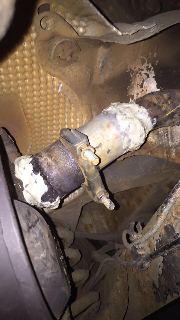

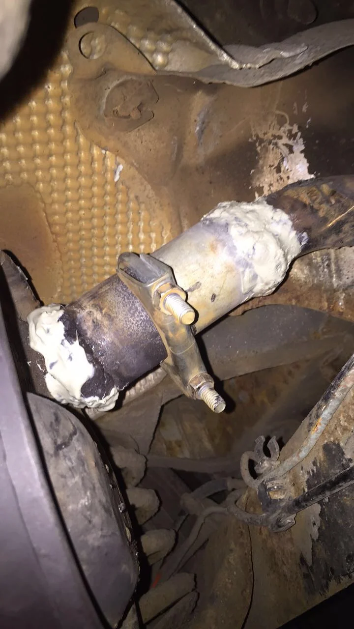

After cutting the excess pipe off the mid-pipe i reassembled the exhaust and cut the slip joint to match the size of the gap left between the back box and the mid-pipe.
After tac-welding the slip joint onto each section of the exhaust i dissembled the exhaust to finish up the welds. As you can see in the picture above this is the finished product, don't mind the white marks around the welds as i thought id rather be safe than sorry in case there was a slight leak so i sealed them with gun gum.
After starting the car i was delighted that there were no leaks and that i was successful. I like the idea of the slip joint because if i decide to fit a different back box to my car i can simply create a fitting for it so that it slips into the slip joint.
