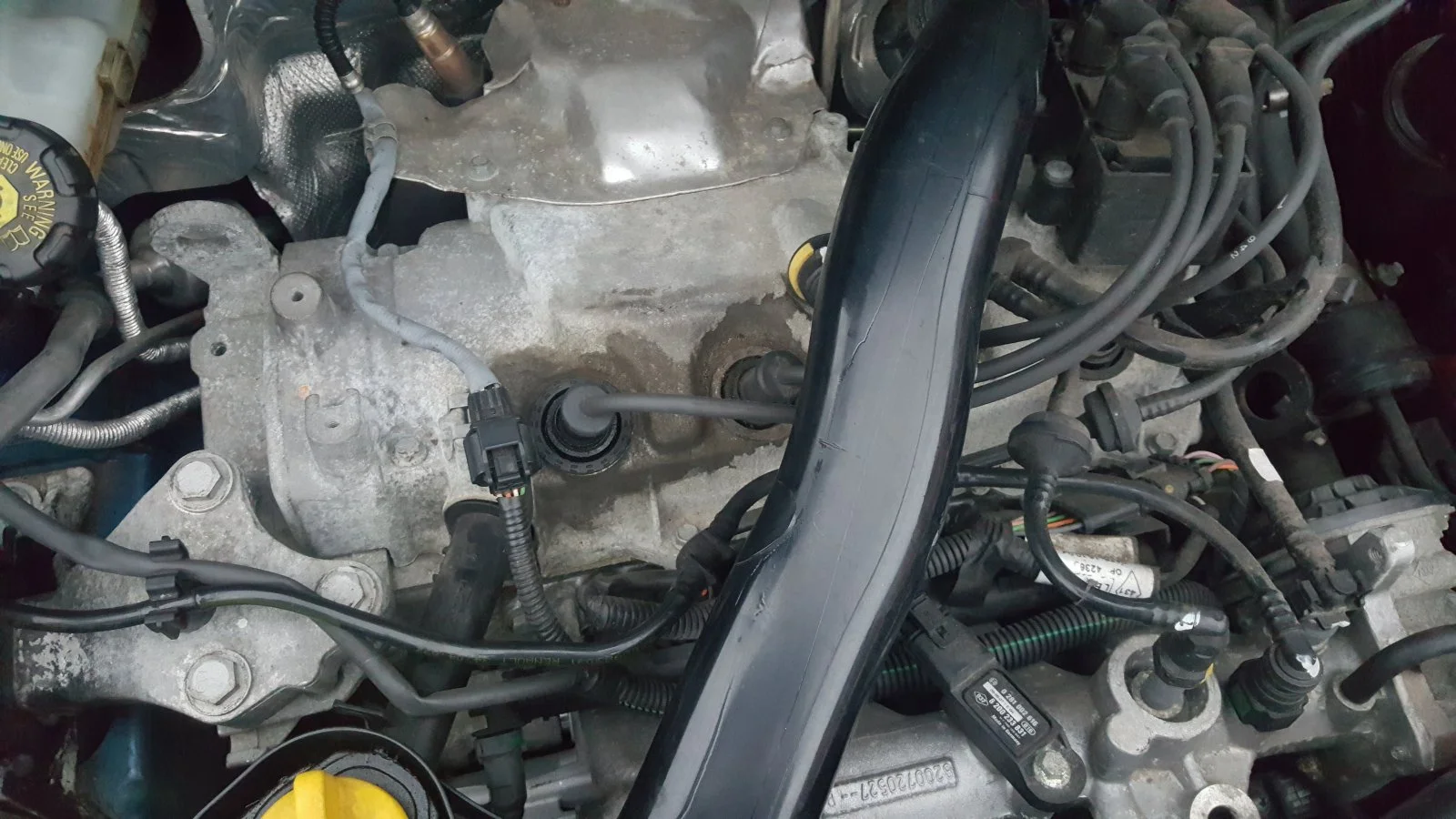

Well the good news is that there's no oil inside the holes, I pulled each HT lead out and checked. Also the engine laboured every time I pulled an HT lead out, meaning (to my mind) that the coilpack/HT leads/spark plugs are still OK.
