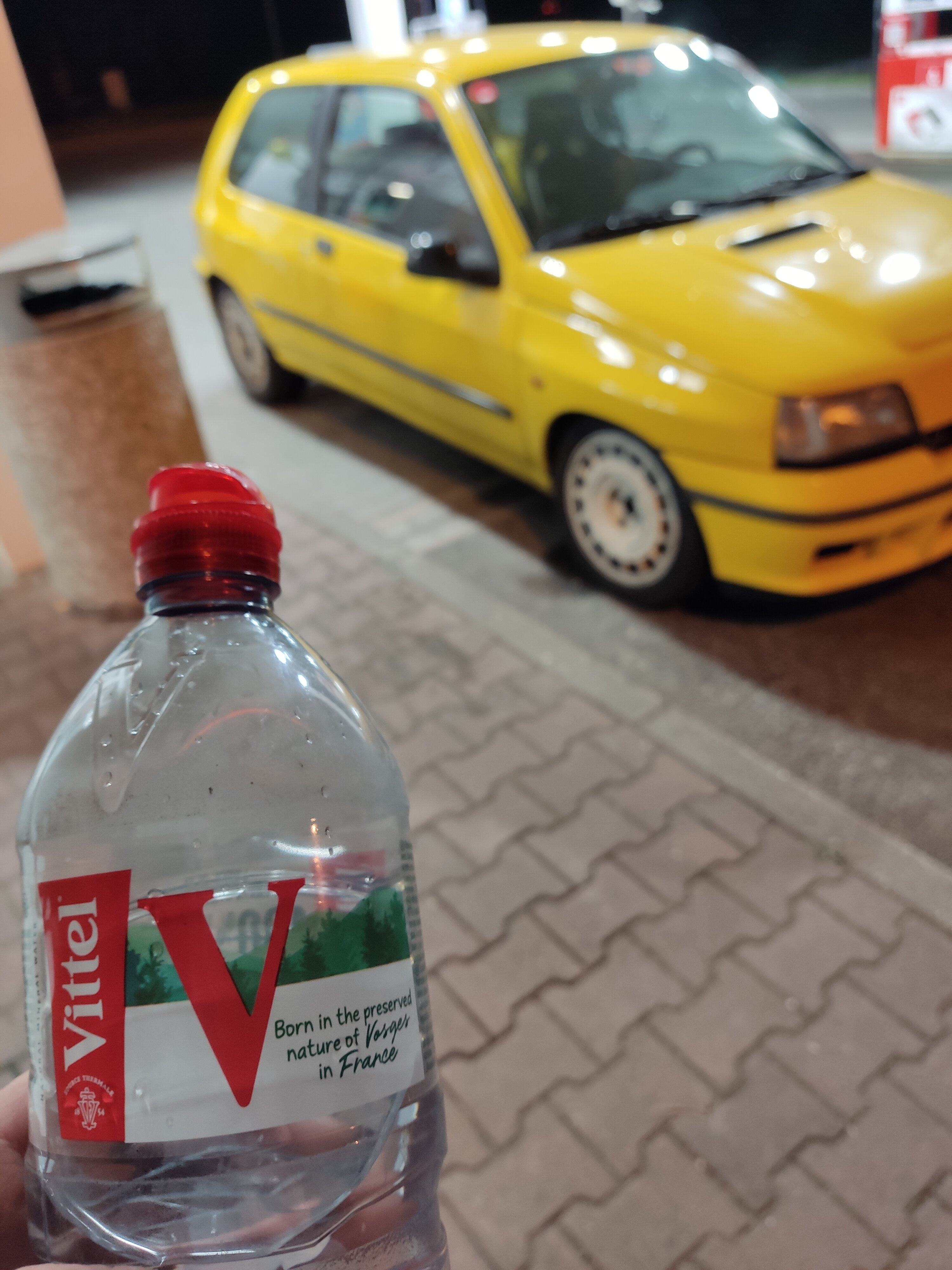

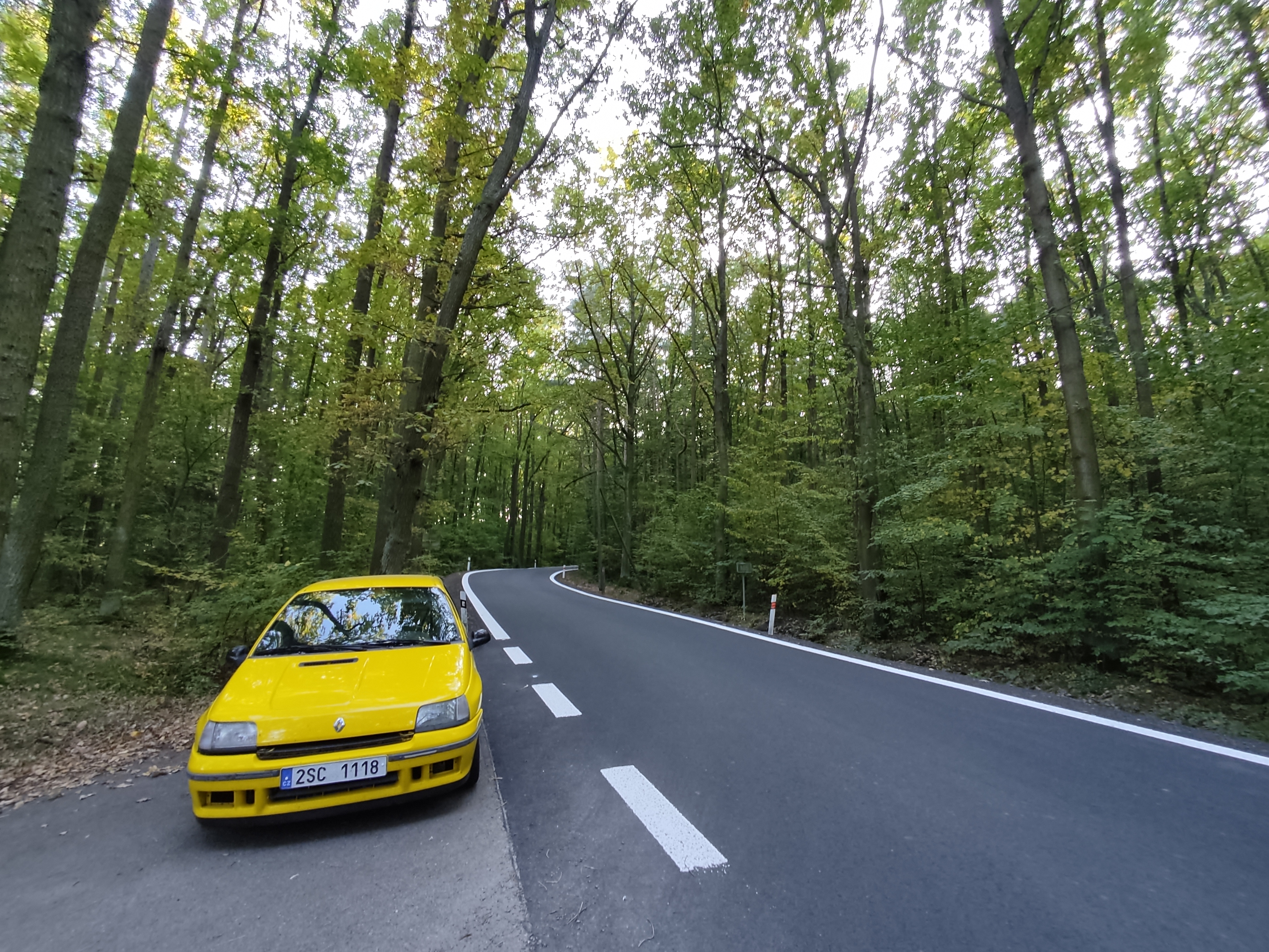

Hello, I´m Filip from Czech Republic.

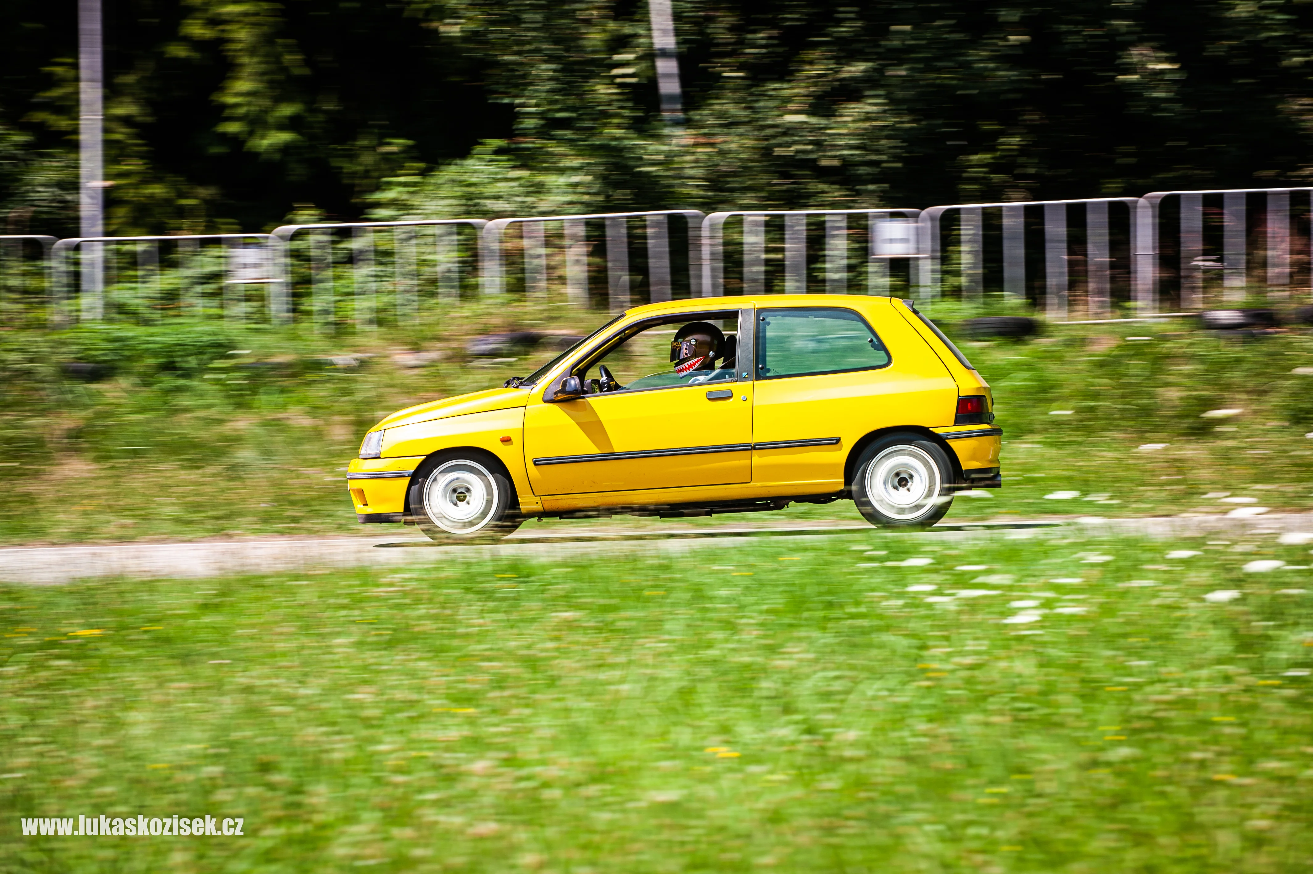

This is my Clio 1991 ph1 with f7p engine. I'm only interested in riding and I like to have fun behind the wheel of this devil. That's why I'm going to build and direct this car to trackdays and fun on the road. Renault is a matter of the heart since my first car was the Renault 5 GTE.

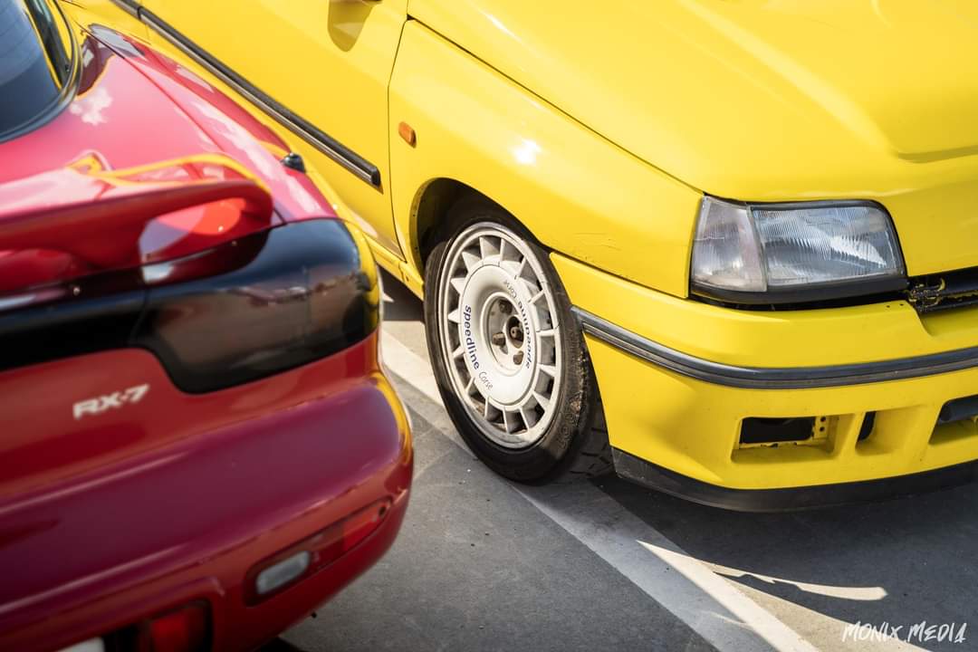

This is awesome :)
Did you paint it yellow or is it a colour from the factory??
Converting the front suspension to Williams setup makes a big difference!
Thanks guys,
I have already bought the car in yellow. It is probably the original paint, but the changed parts are already painted.
thanks for the tip with williams setup

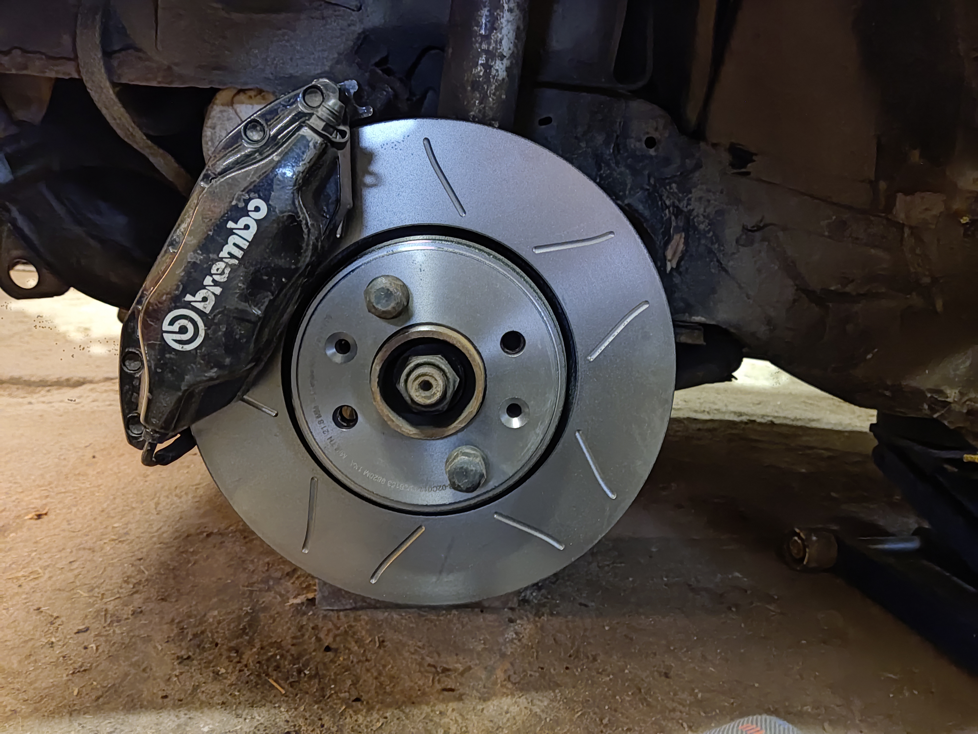

modification of brakes in the form of Brembo calipers from P406 Coupe with 280mm Clio 2 rotors + main brake cylinder from Scenic 23,81

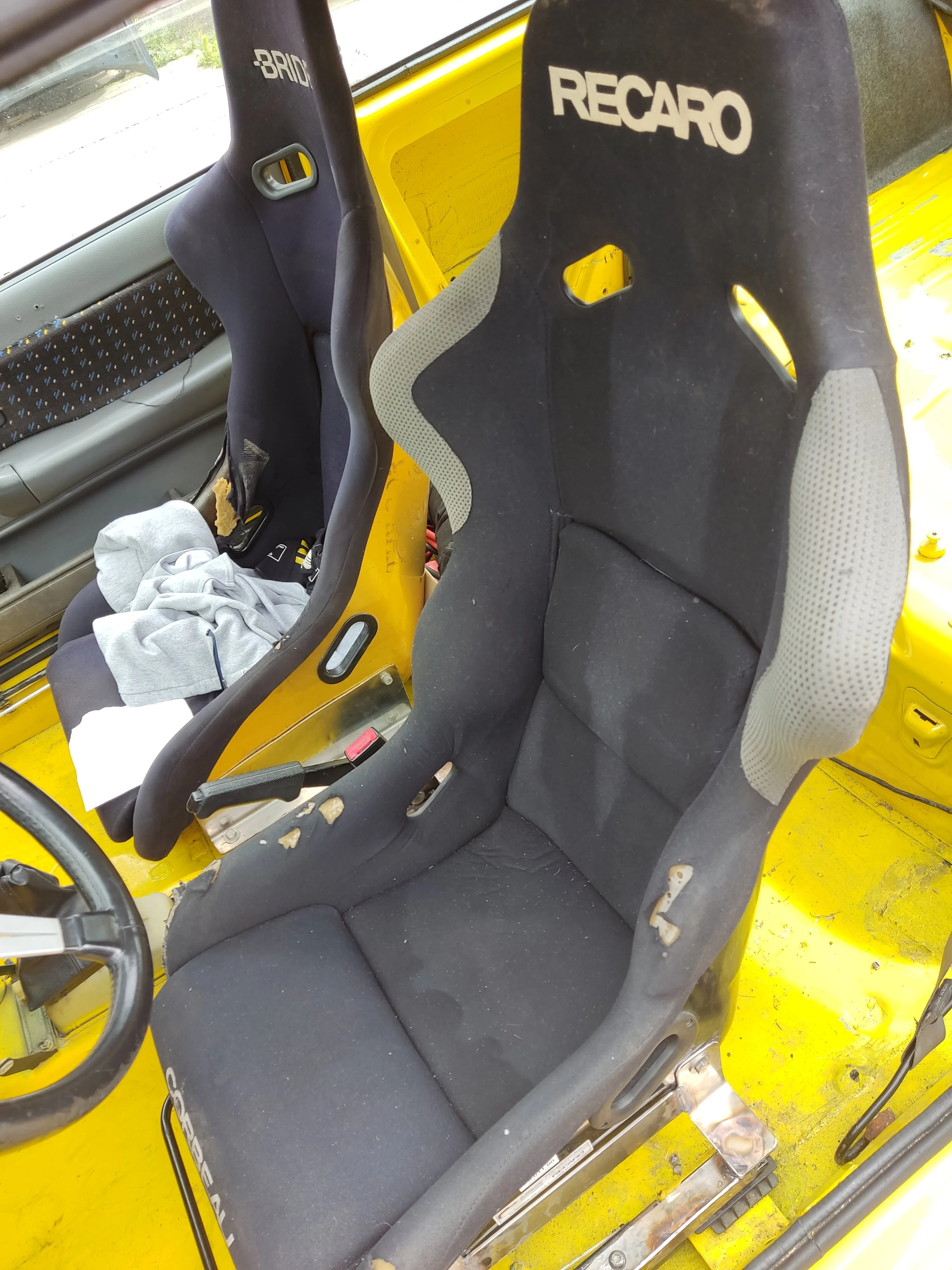

Nardi Classic steering wheel with Recaro Profi SPG and Bride Zeta II (i would like to revive the whole interior, including the seats and the steering wheel)

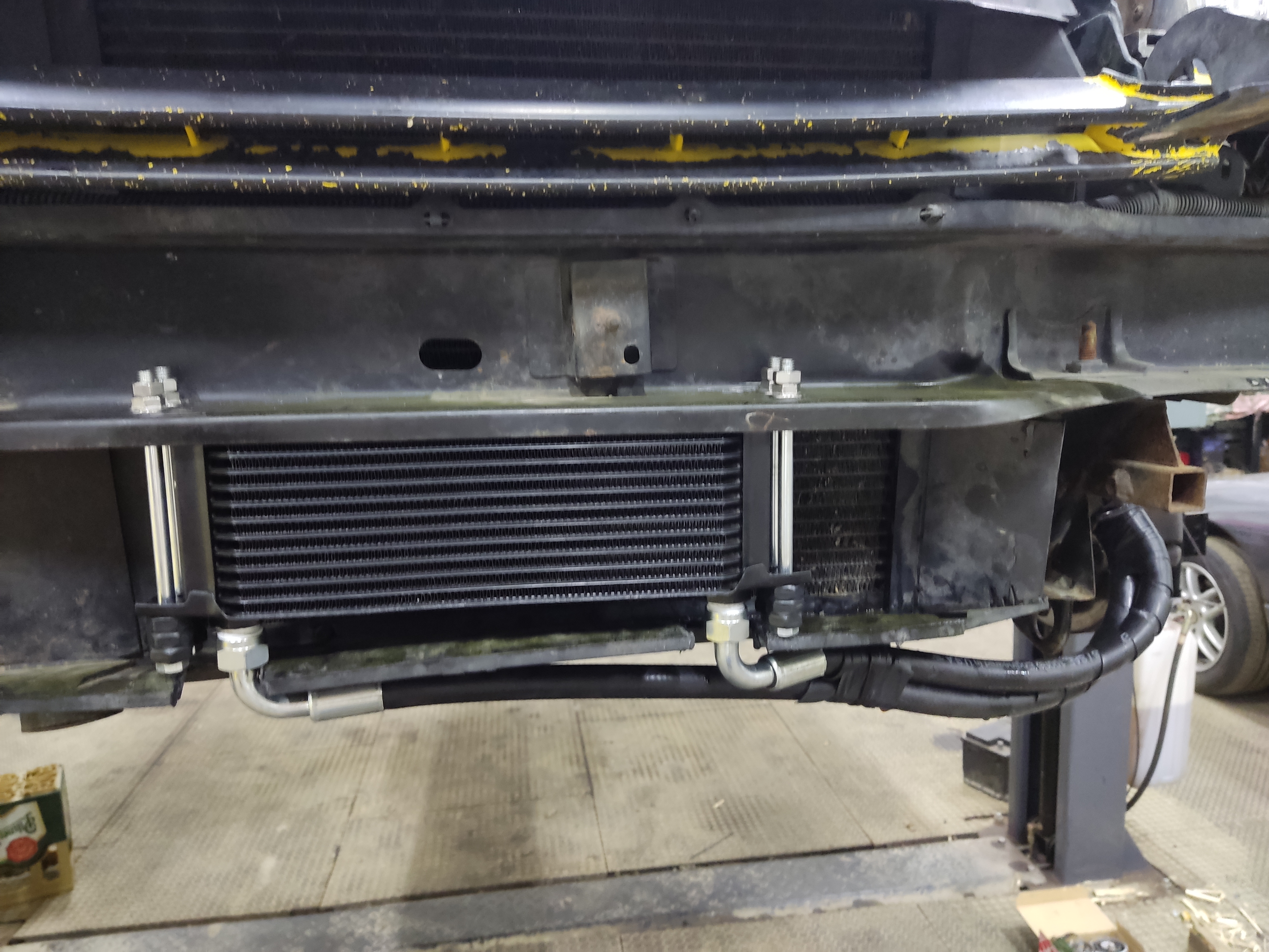

Mocal oil cooler fitted

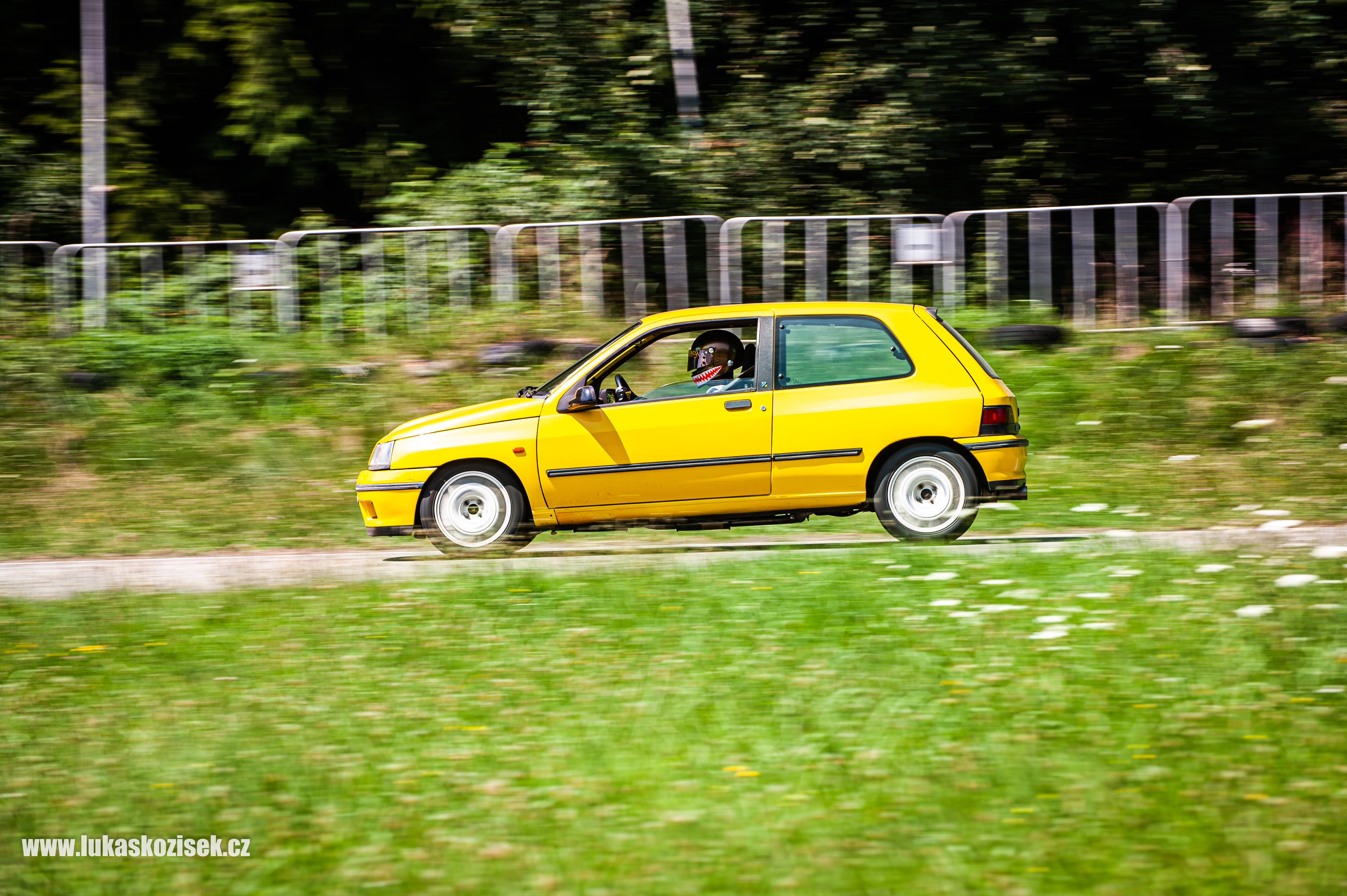

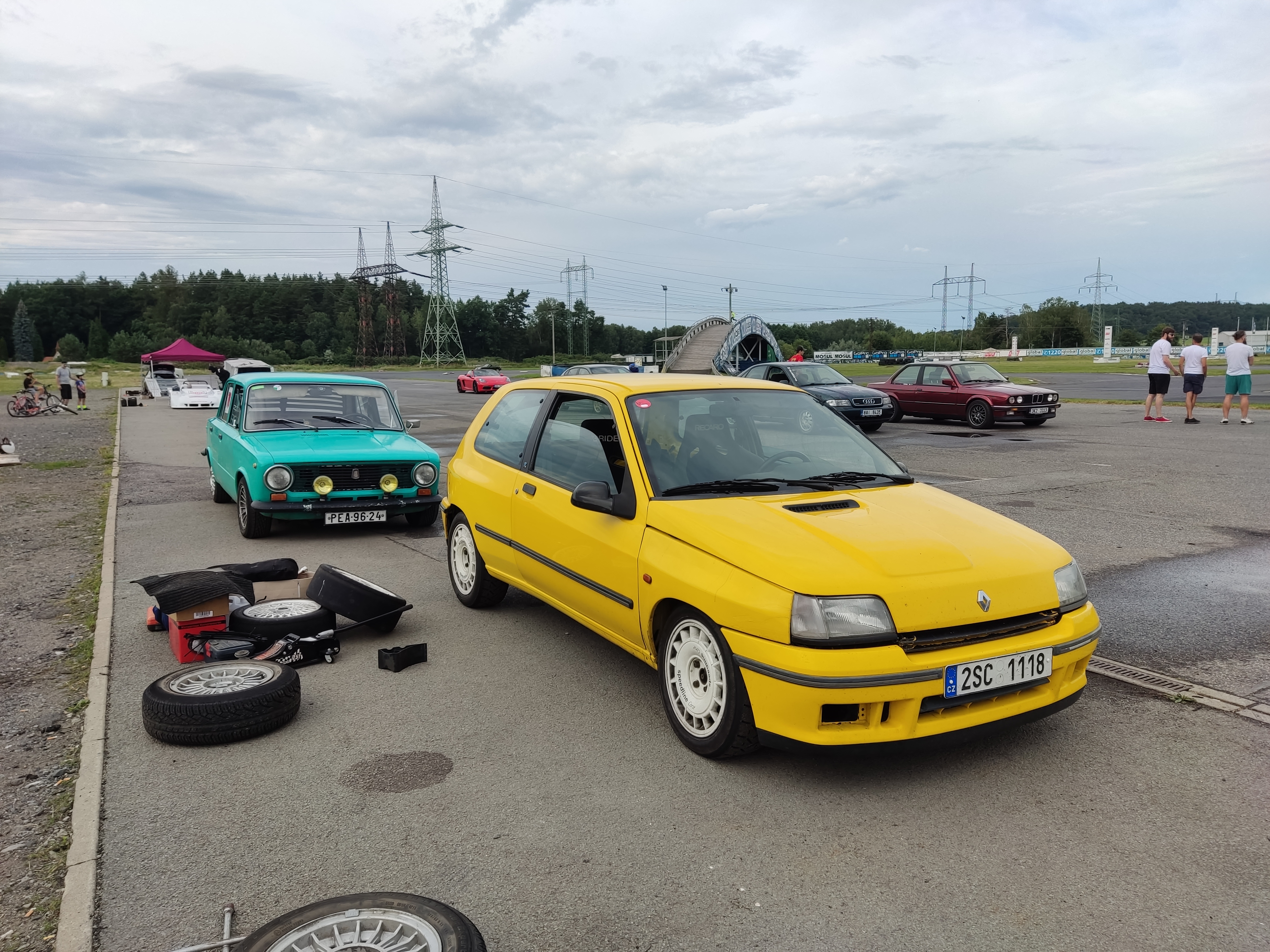

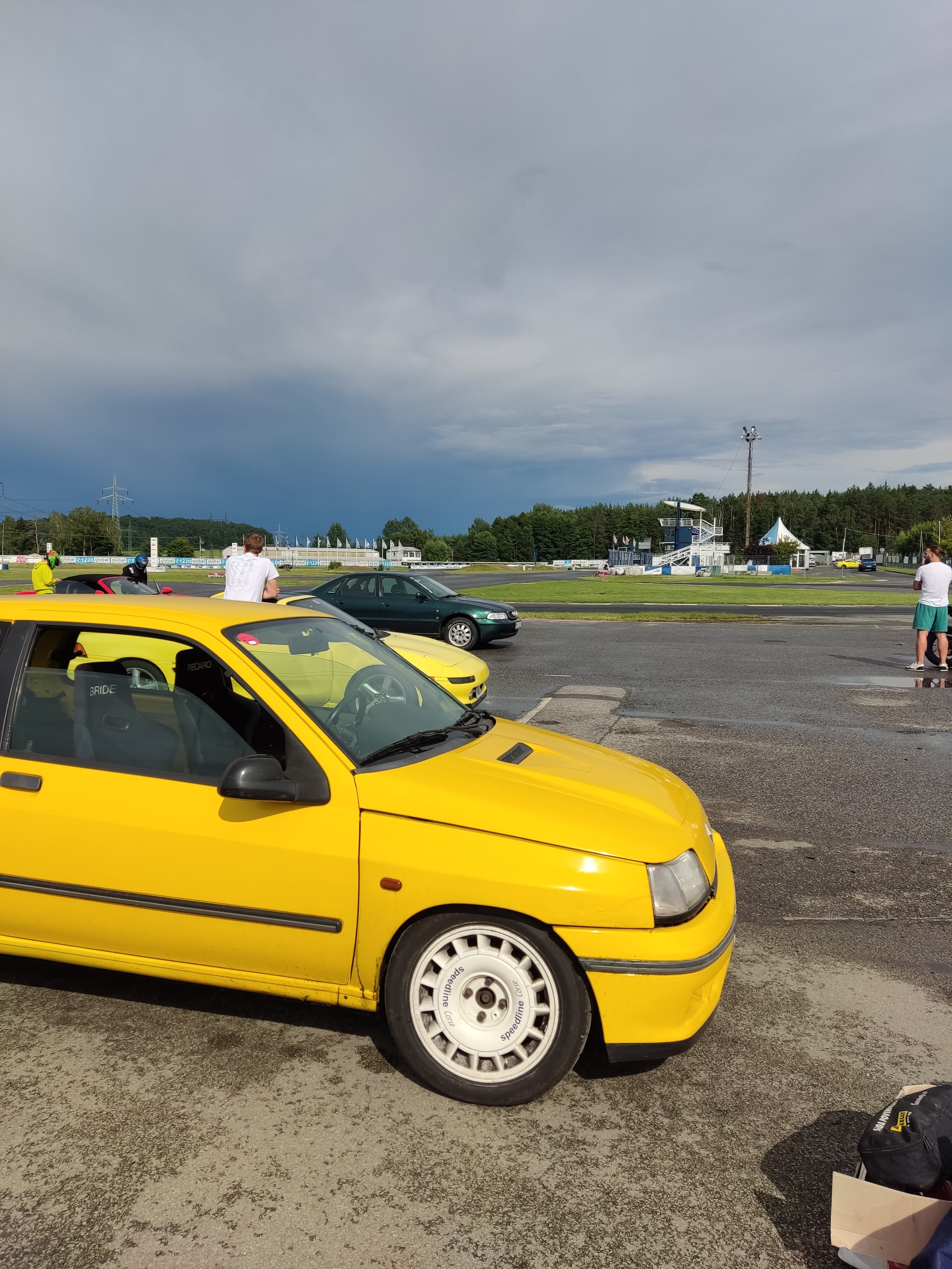

some trackdays and rides this year
