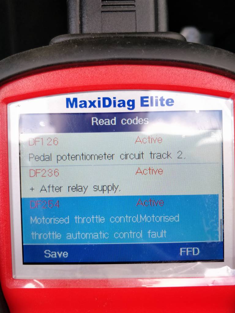

2 days ago, I plugged in my code scanner I'm getting codes below;
DF126 'ACTIVE' PEDAL POTENTIOMETER CIRCUIT TRACK 2.
DF236 'ACTIVE' + AFTER RELAY SUPPLY.
DF254 'ACTIVE' MOTORISED THROTTLE CONTROL, MOTORISED THROTTLE AUTOMATIC CONTROL FAULT.
DF002 'ACTIVE' THROTTLE POTENTIOMETER CIRCUIT.
DF009 'ACTIVE' ACTUATOR RELAY CONTROL CIRCUIT, SHORT CIRCUIT.
