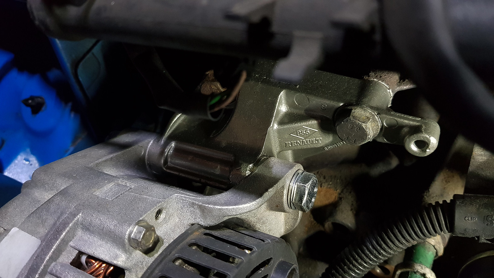

Any ideas of length this bolt is for mounting cup alternator to bracket , i have adjuster bolt , im away from home for work so need to order something to suit for the weekend

This one?
Jekyll

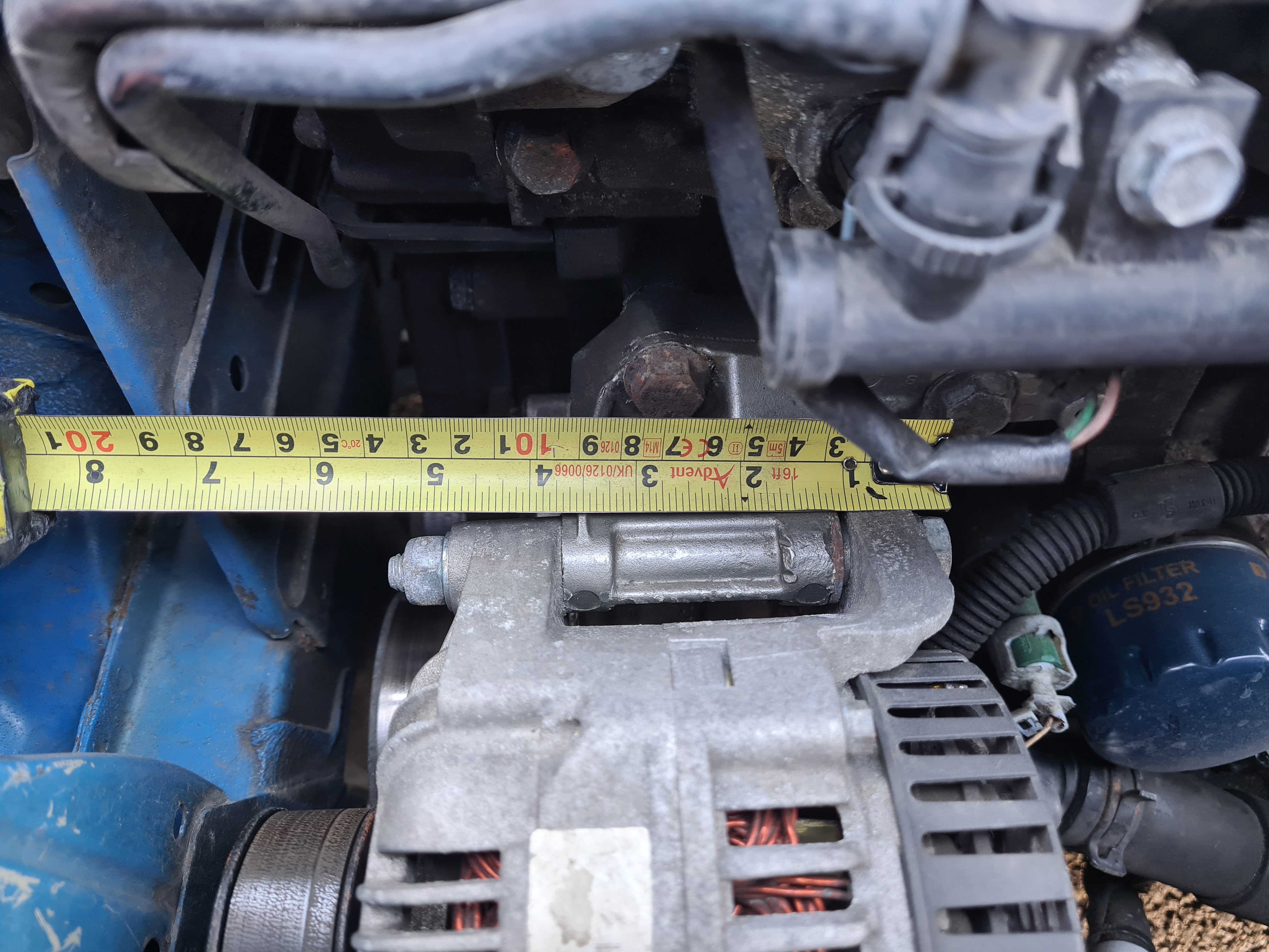

I have a non genuine alternator and it measures 130mm as its not threaded in the end so needs to be nutted.
Genuine one is threaded so 10mm less.
Depending on what alternator you have, it'll be m10x120mm or m10x130mm. Pitch is 1.5
