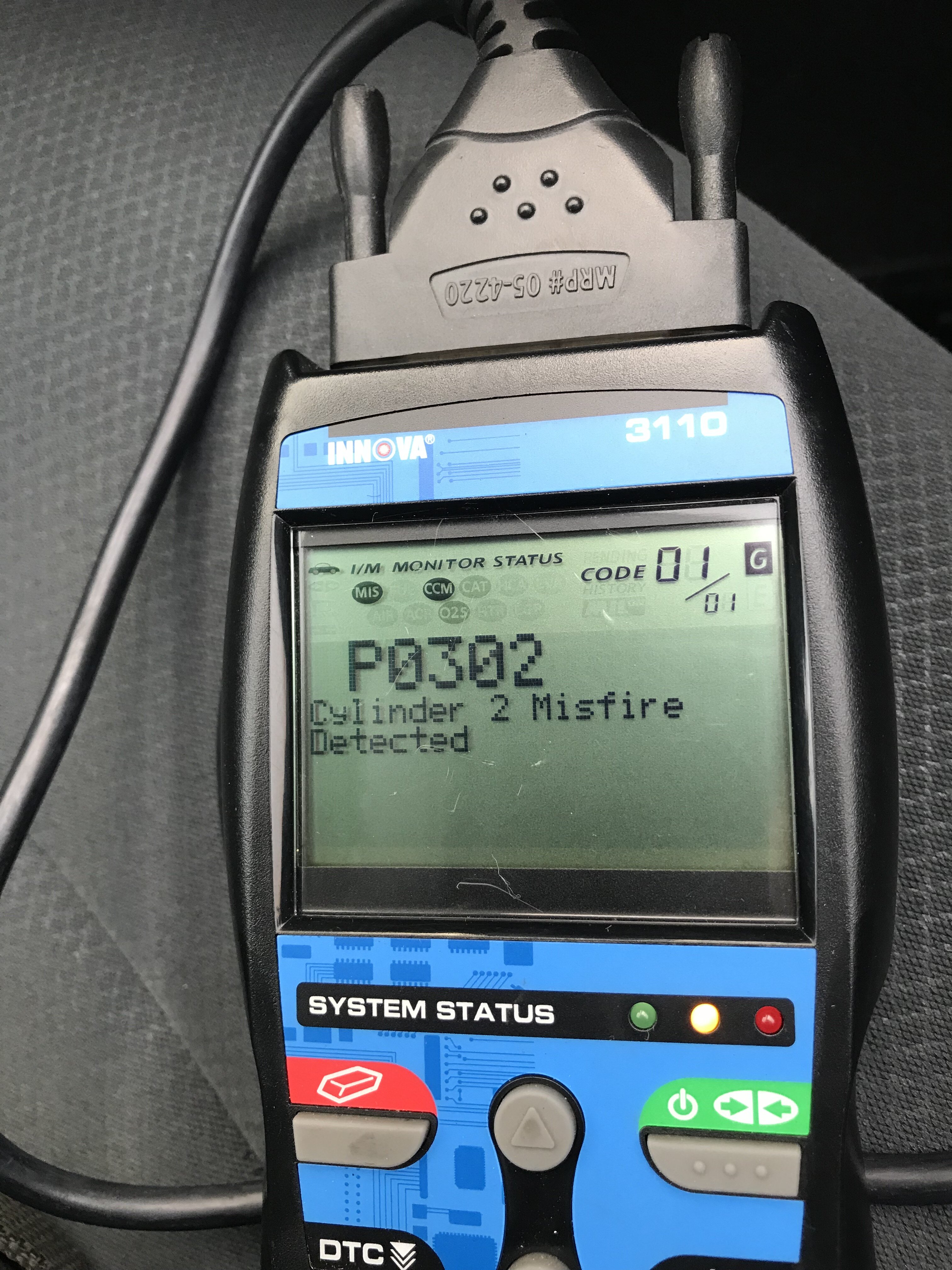

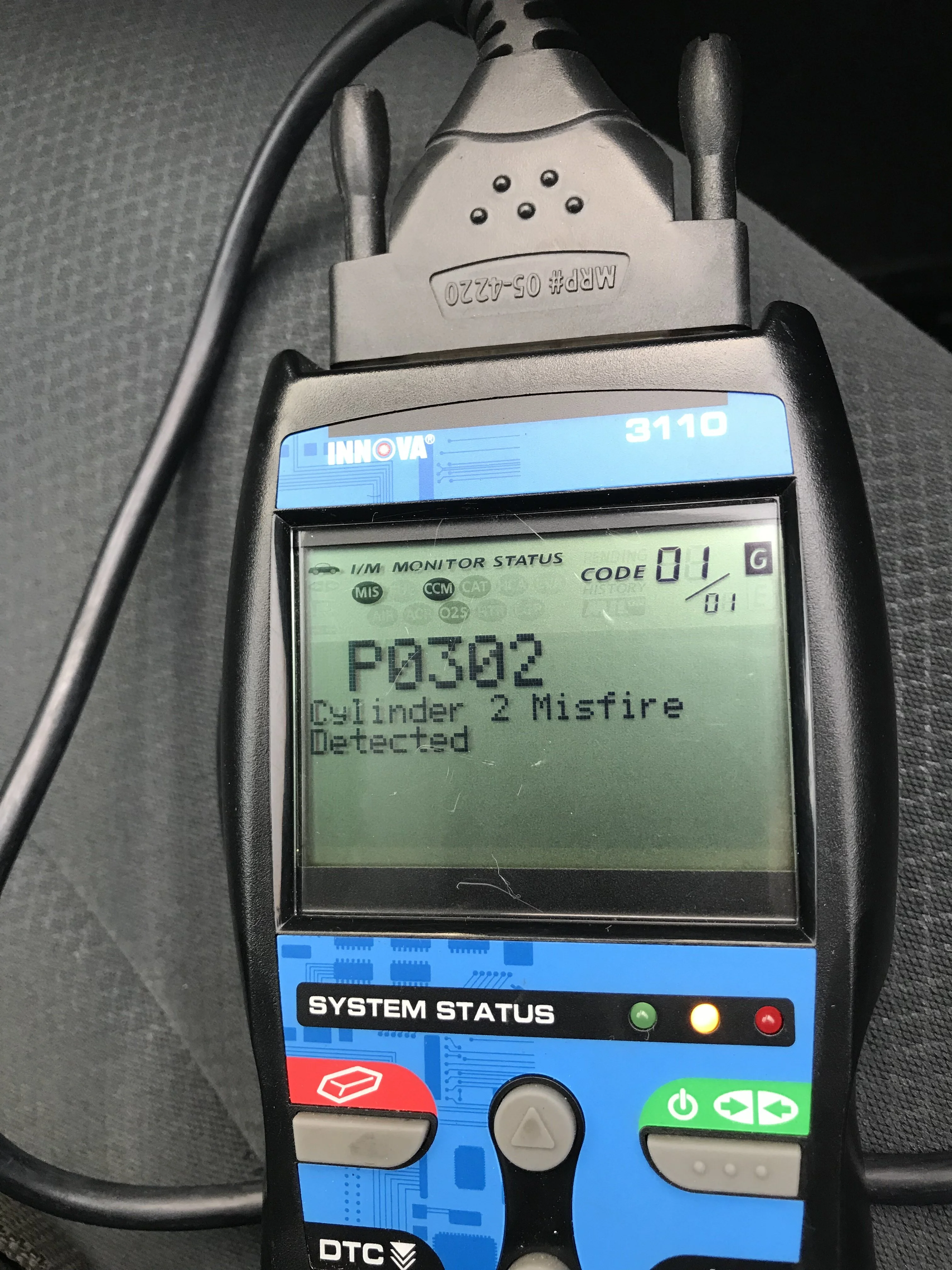

So after a fairly uneventful winter bar the battery draining after a few days, I had a reminder of French car ownership!

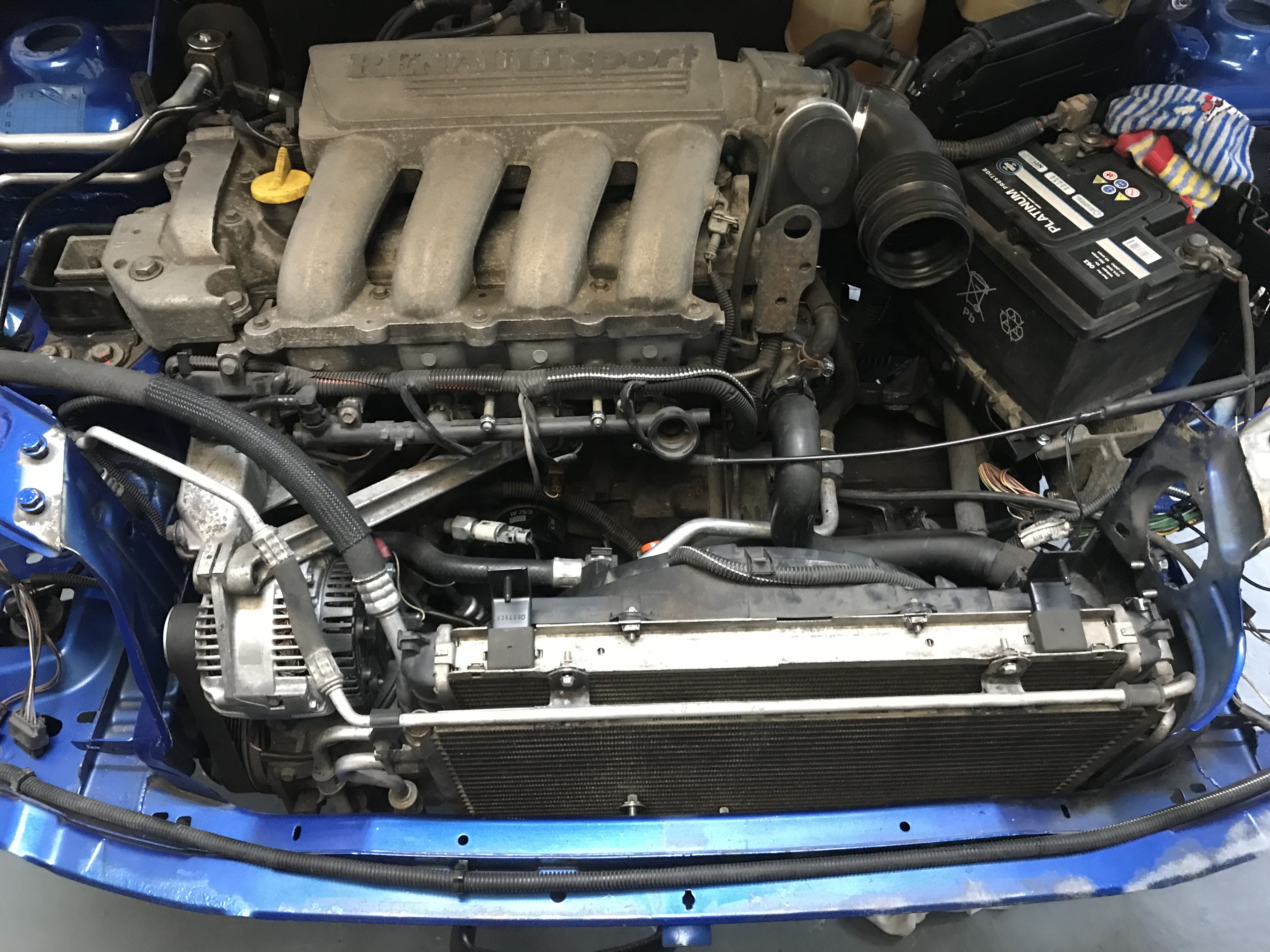

It rattled a bit in time with the engine note then cleared, so I cancelled work that afternoon & drove it straight home for a look. On the way home it ran fine, although I was reluctant to thrash it due to the rattle & feared doing more damage.

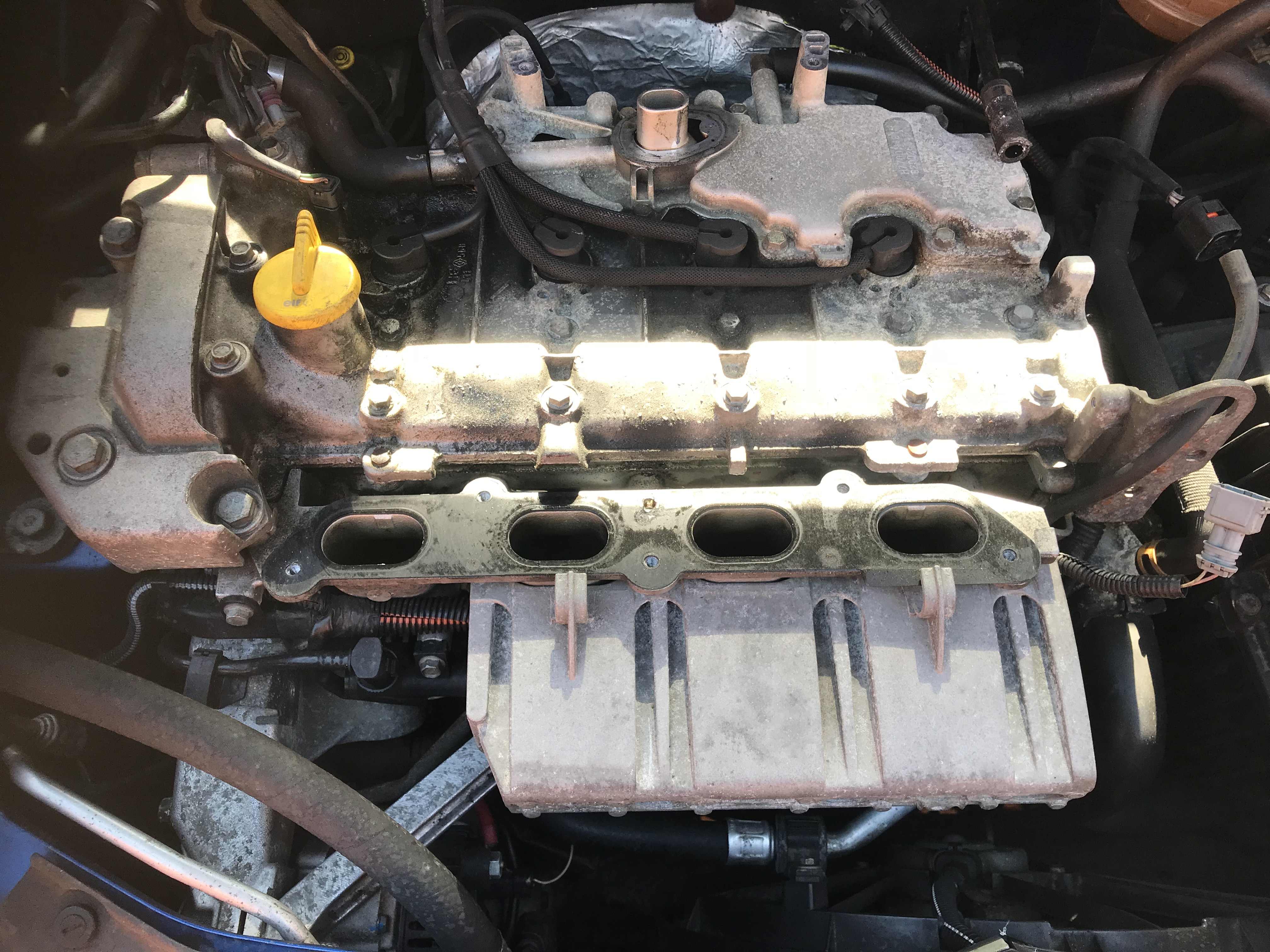

Went for the obvious first then found this:

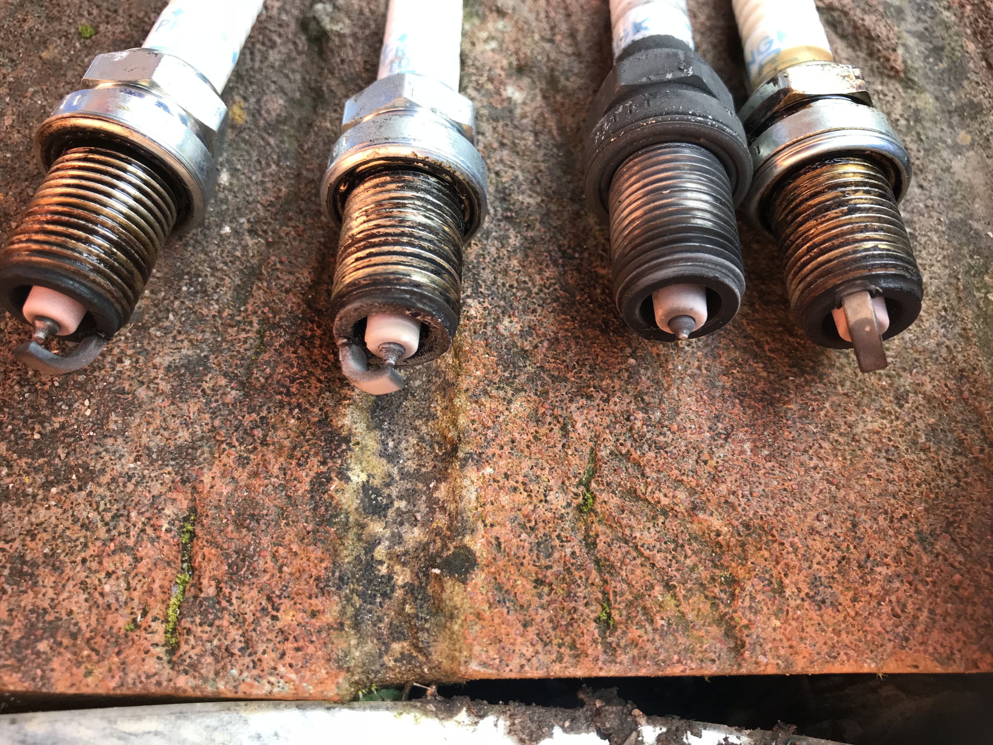

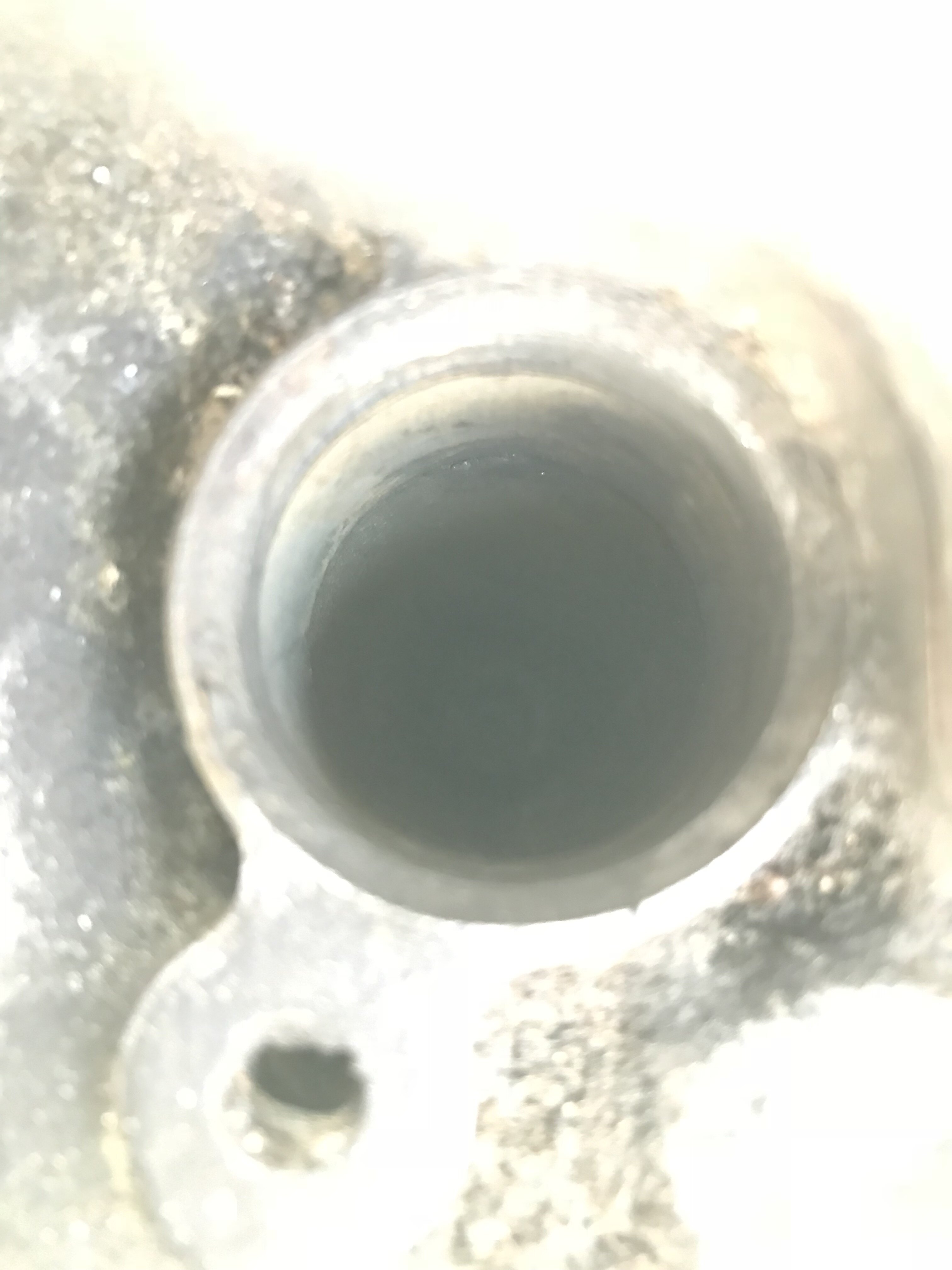

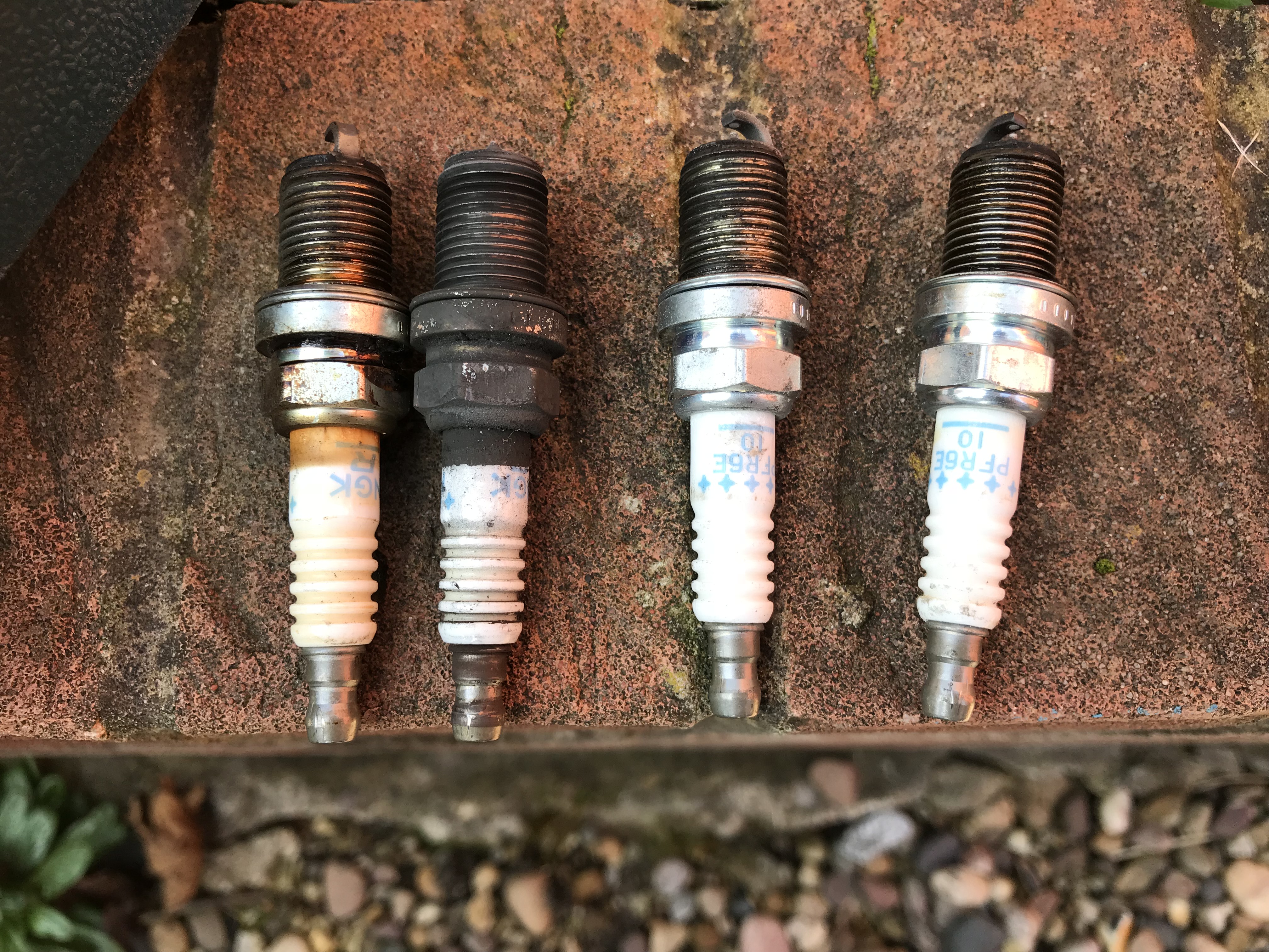

I then found the spark plugs ground electrode in the lower section of the inlet manifold. Somehow the spark plug had come loose & possibly got hot? Which could've caused the side electrode to weaken it's weld to the shell? There didn't seem to be any damage to the threads & looking down the hole I couldn't see any shiny dented aluminum!
Note the oil leak from the dephaser solenoid. standard.:rolleyes:
The above picture isn't great but there's no reflection or shine from the chamber, so I believe I got away with it!
I then purchased some new spark plugs for a small fortune as I needed them quick, fitted them, cleared the code & all seemed well.
In the near future I'll do a compression test & possibly an endoscope camera inspection, but the car has run fine since so It'll be more for peace of mind.
It would be nice to hear & benefit other owners If anyone's had the same problem & if anyone with experience has a theory as to why it happened?
