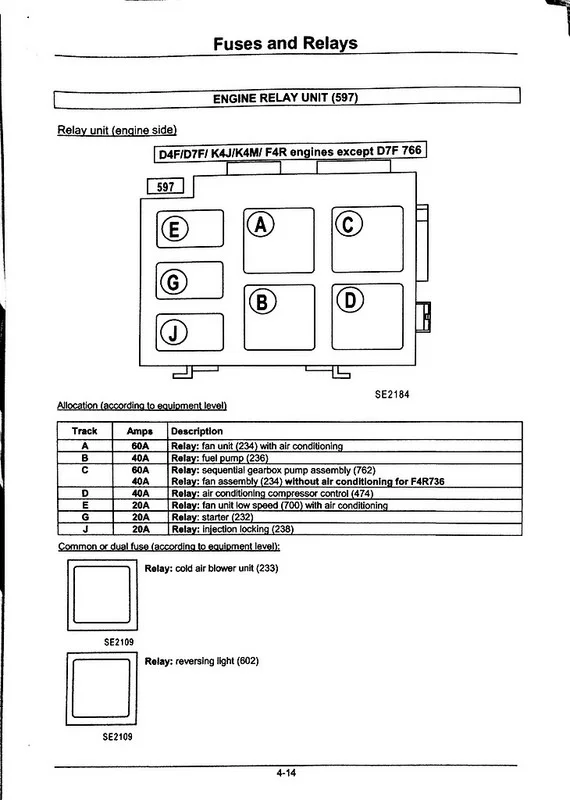

Broken white wire from Relay J to Pin 10 of the ECU.

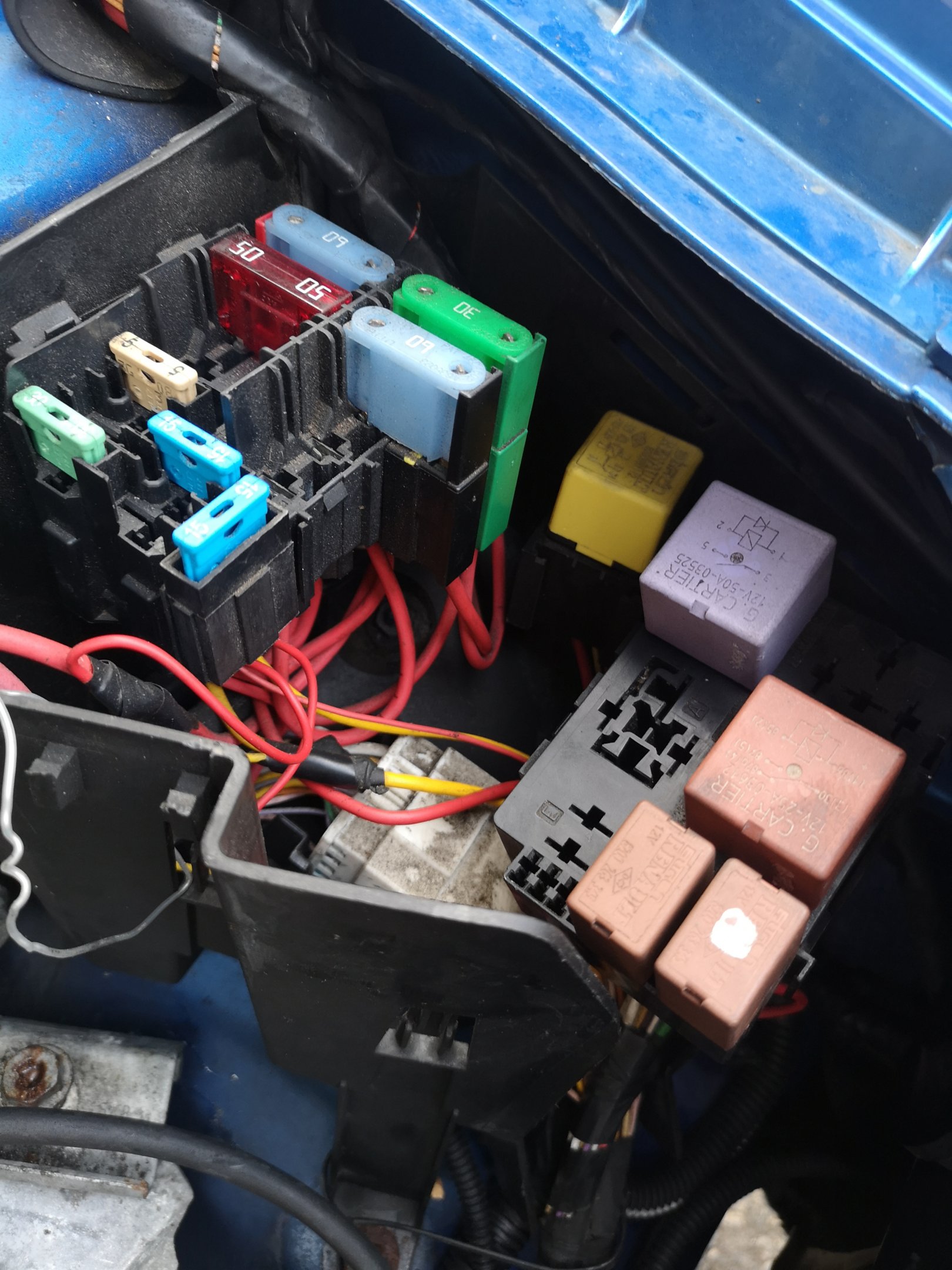

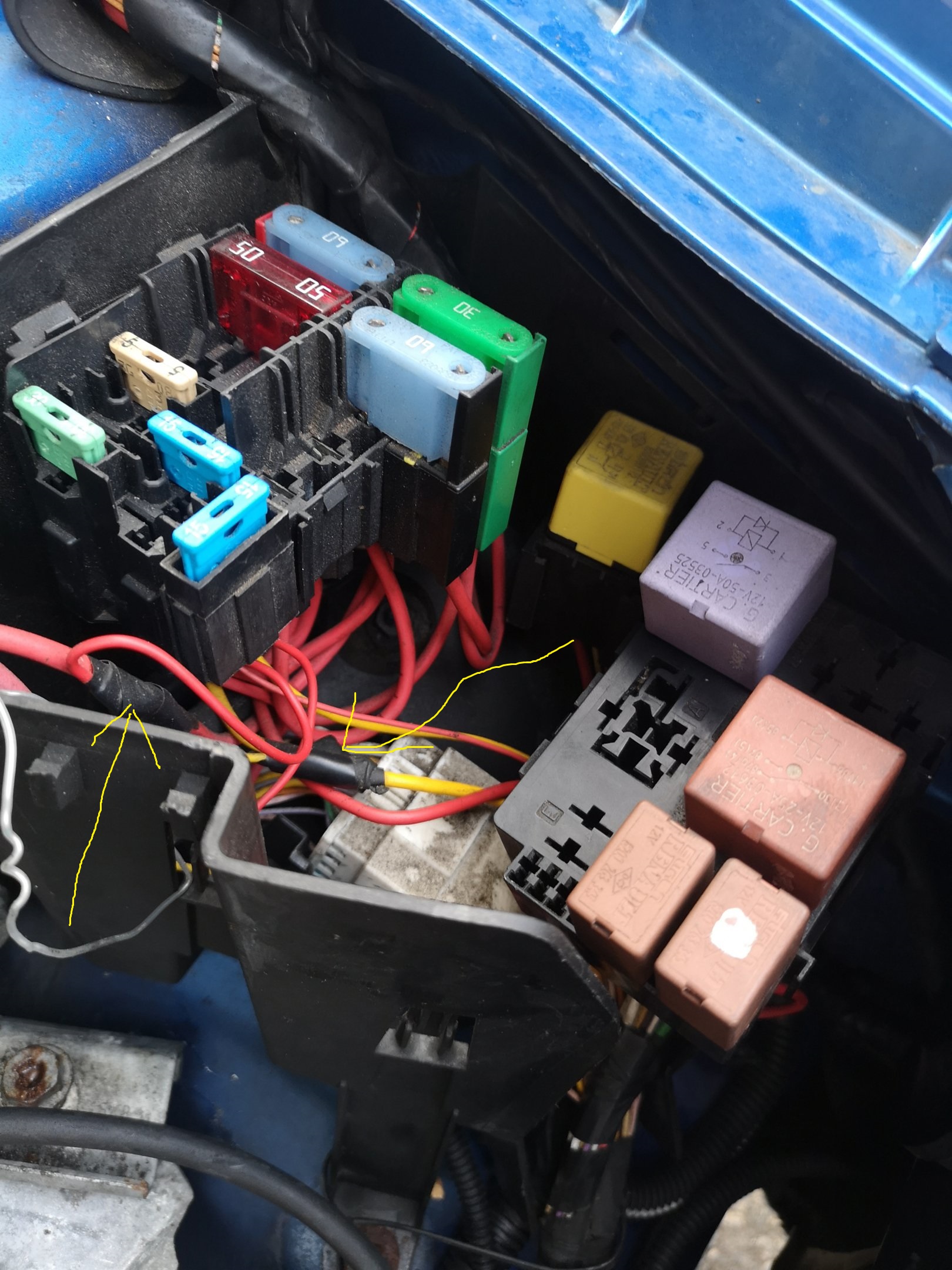

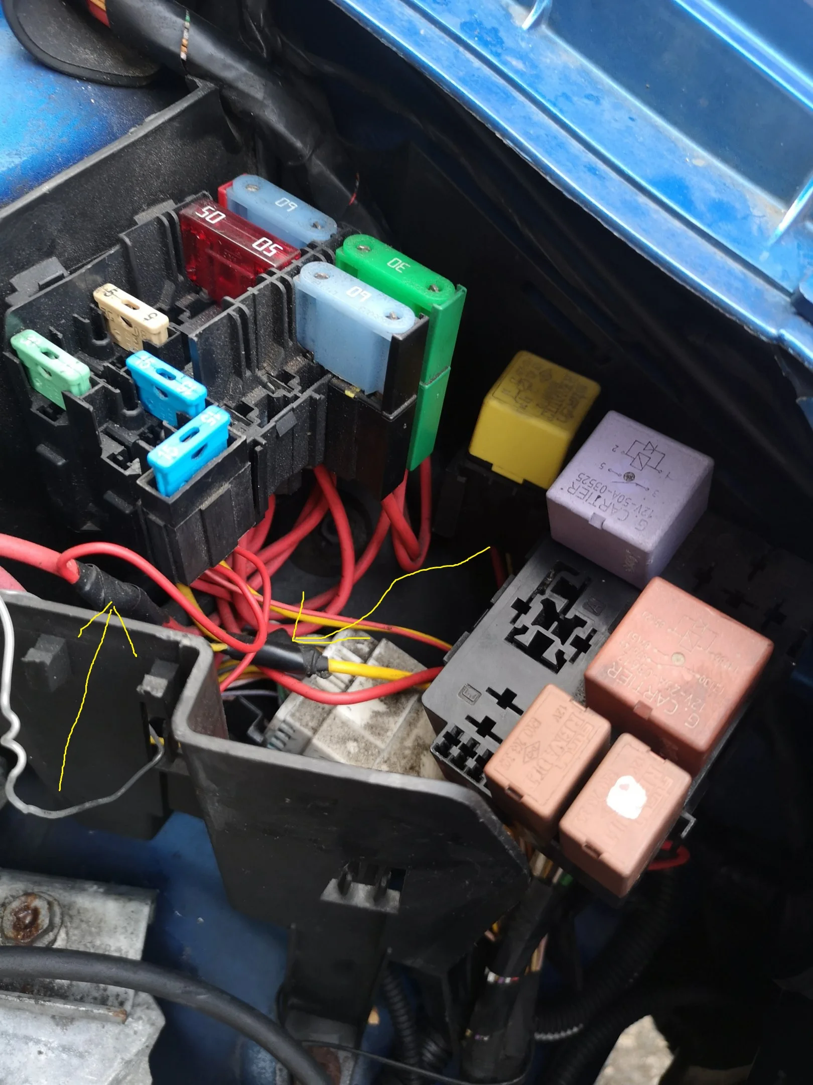

My wiring loom is completely different to the one in the photo not sure which relay it could be from
It looks as if the wiring has already had some modifications.
