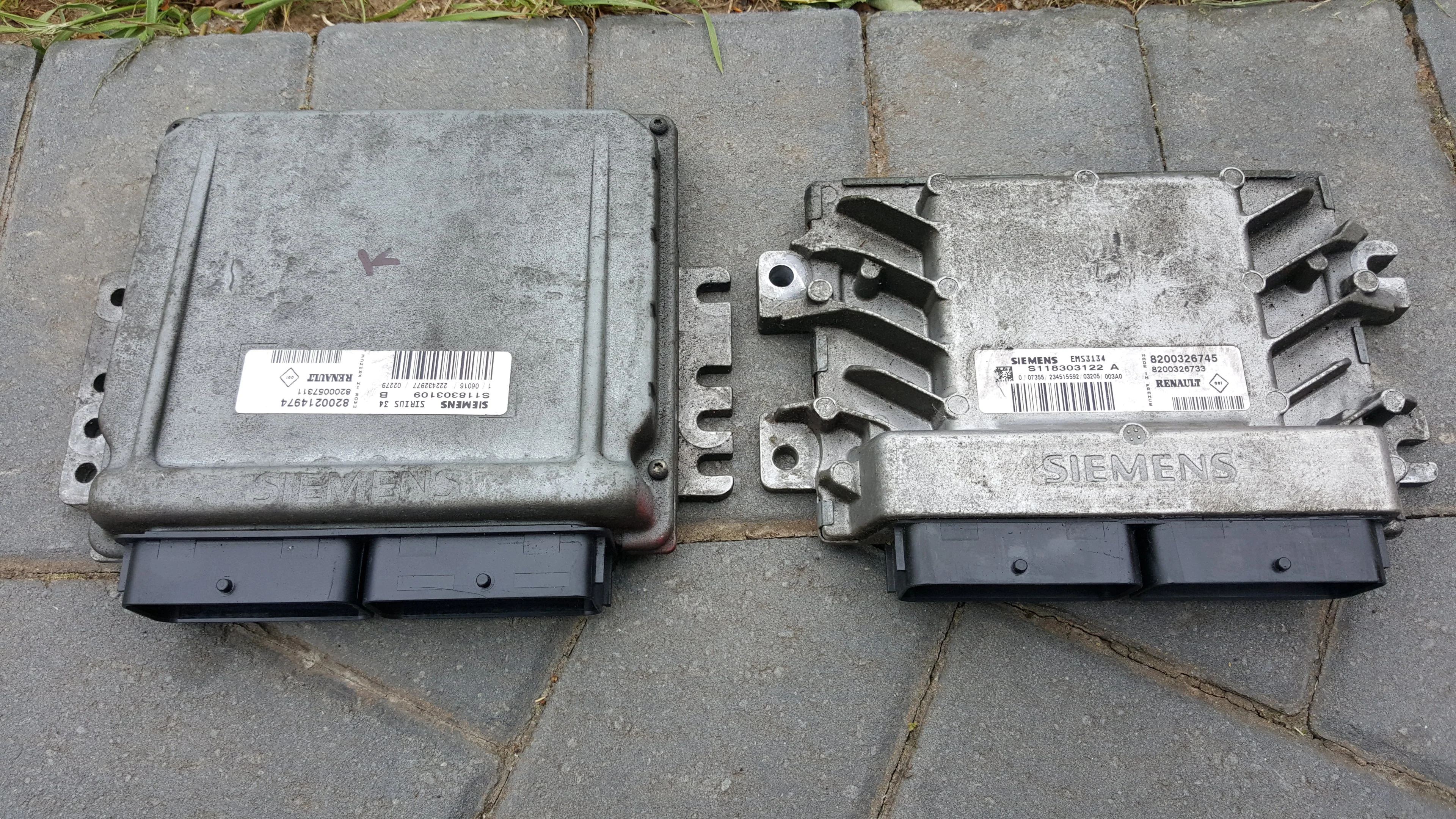

Typically i would scan it/reprogram with clip but waiting for a new clone clip to turn up. Anybody had this fault before when swapping non cup ecu? Also new ecu is different part number compared to old one - original on left in pic below. Will this cause any issues ??

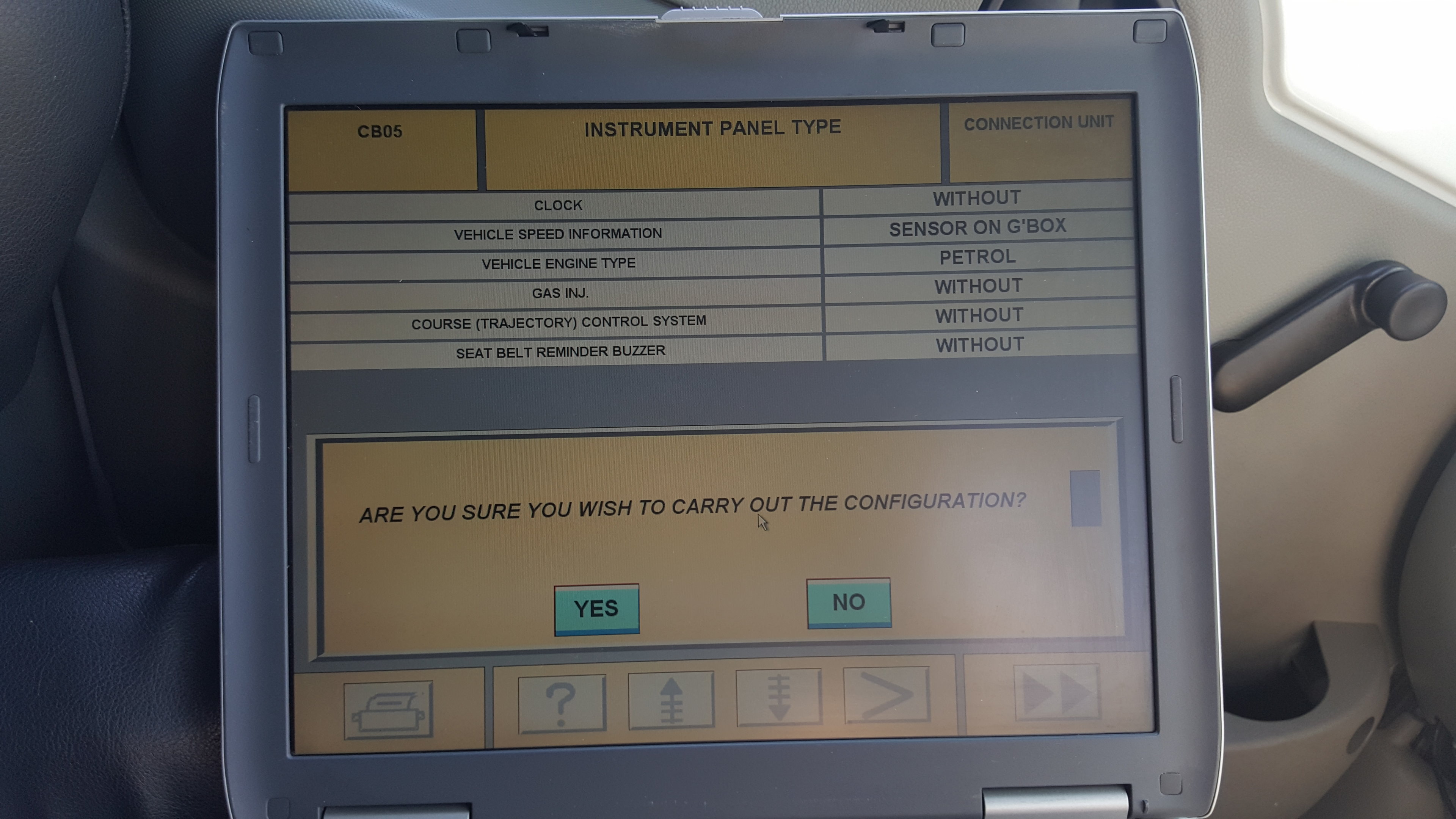

Renault can clip needed to recalibrate uch

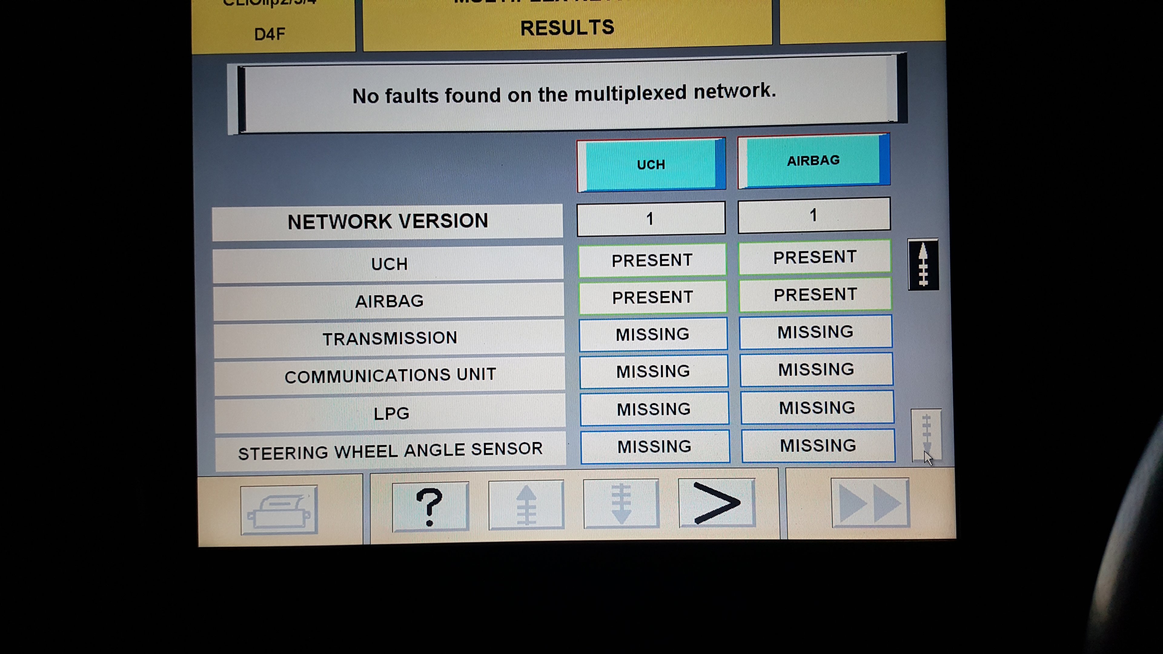

Basically recalibrate the multiplex network to set abs and steering angle sensor to missing. This removes the multiplex faults if present. I also have normal squib fitted so this might be necessary
Then recalibrate the clocks to remove course (Trajectory) control system to turn the esp light off. Job done no more network faults or serv light. Not sure if abs light is on as mine does not work/cup clocks etc - still serv light not on so assume off.
