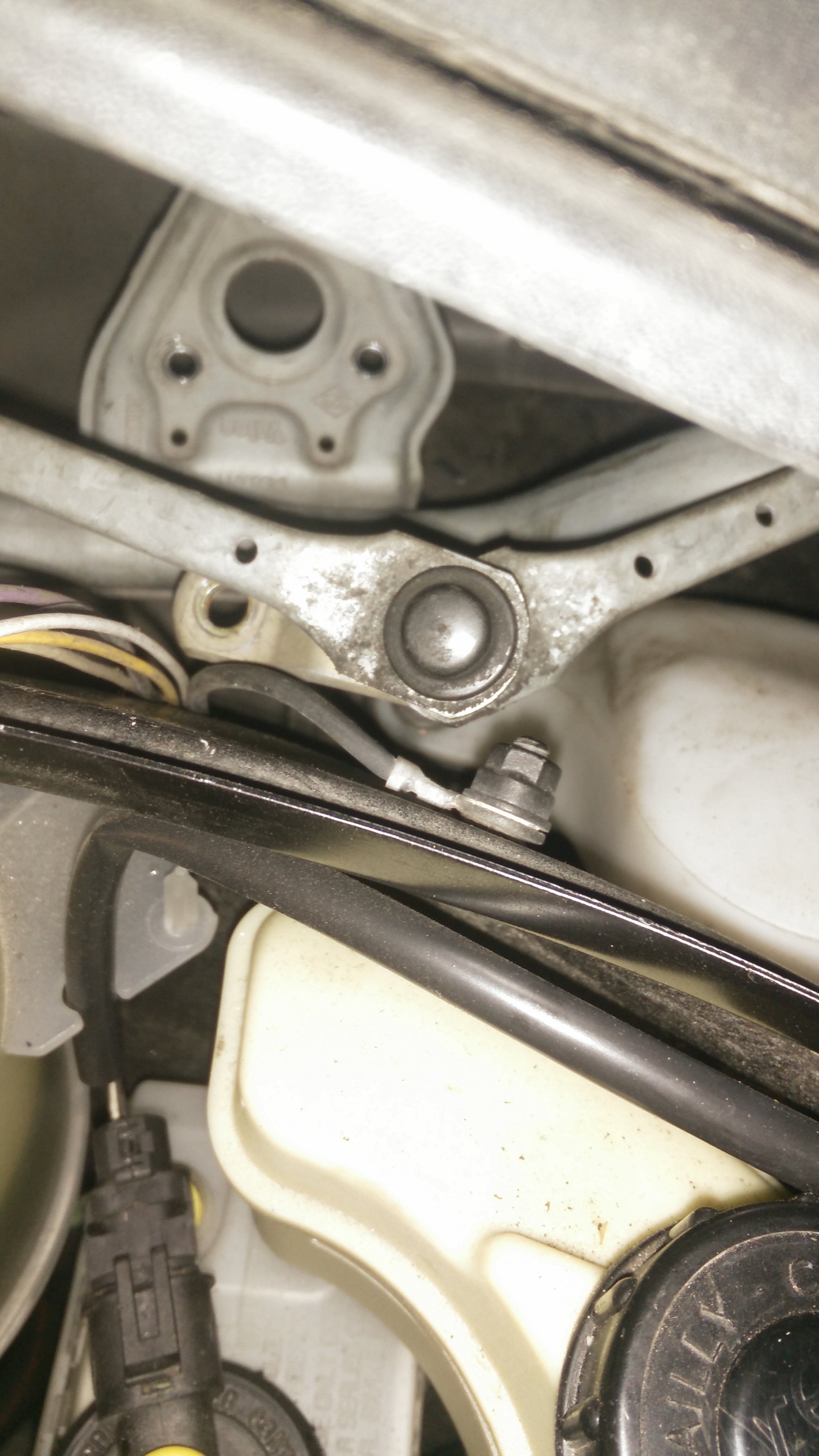

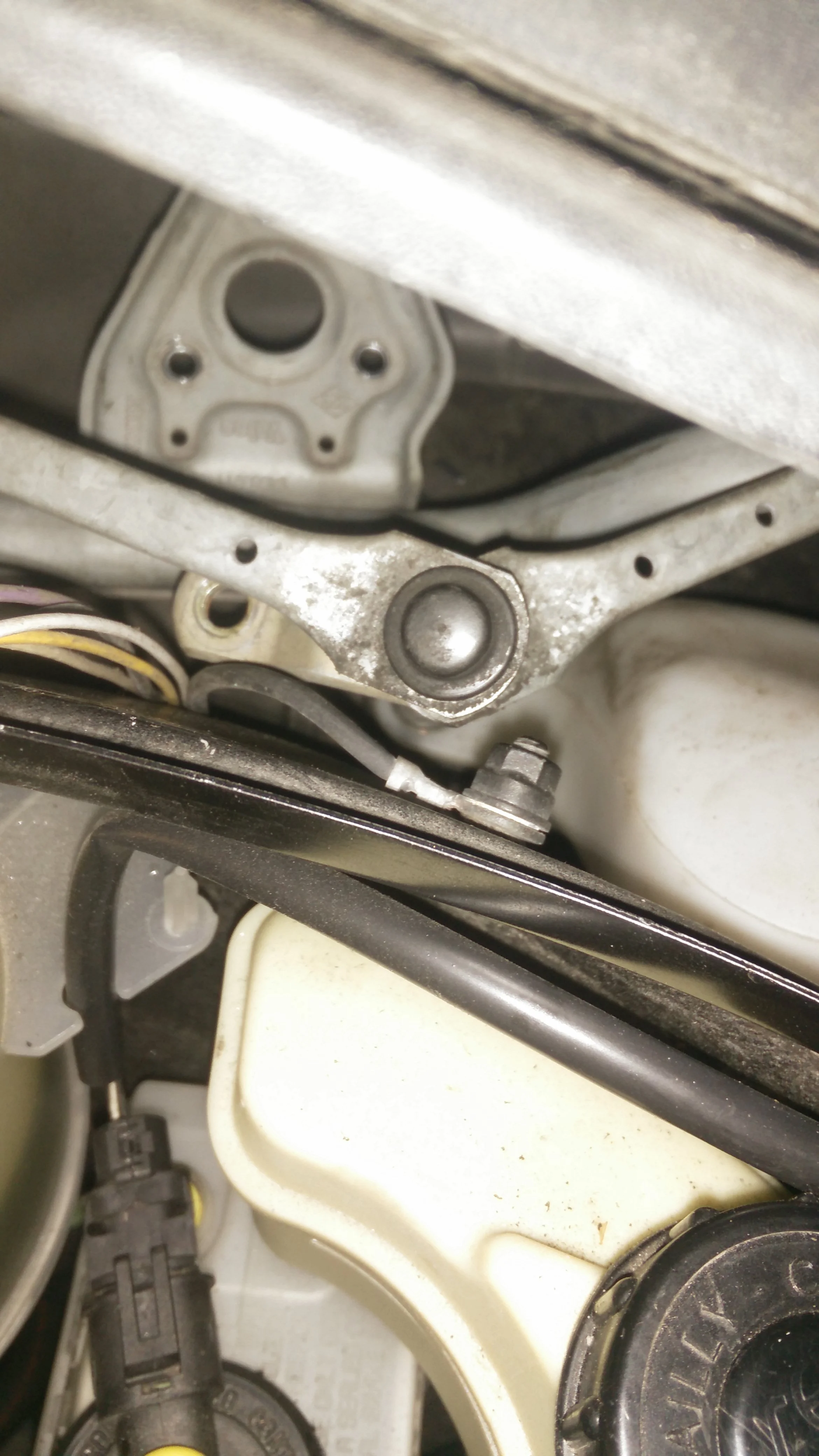

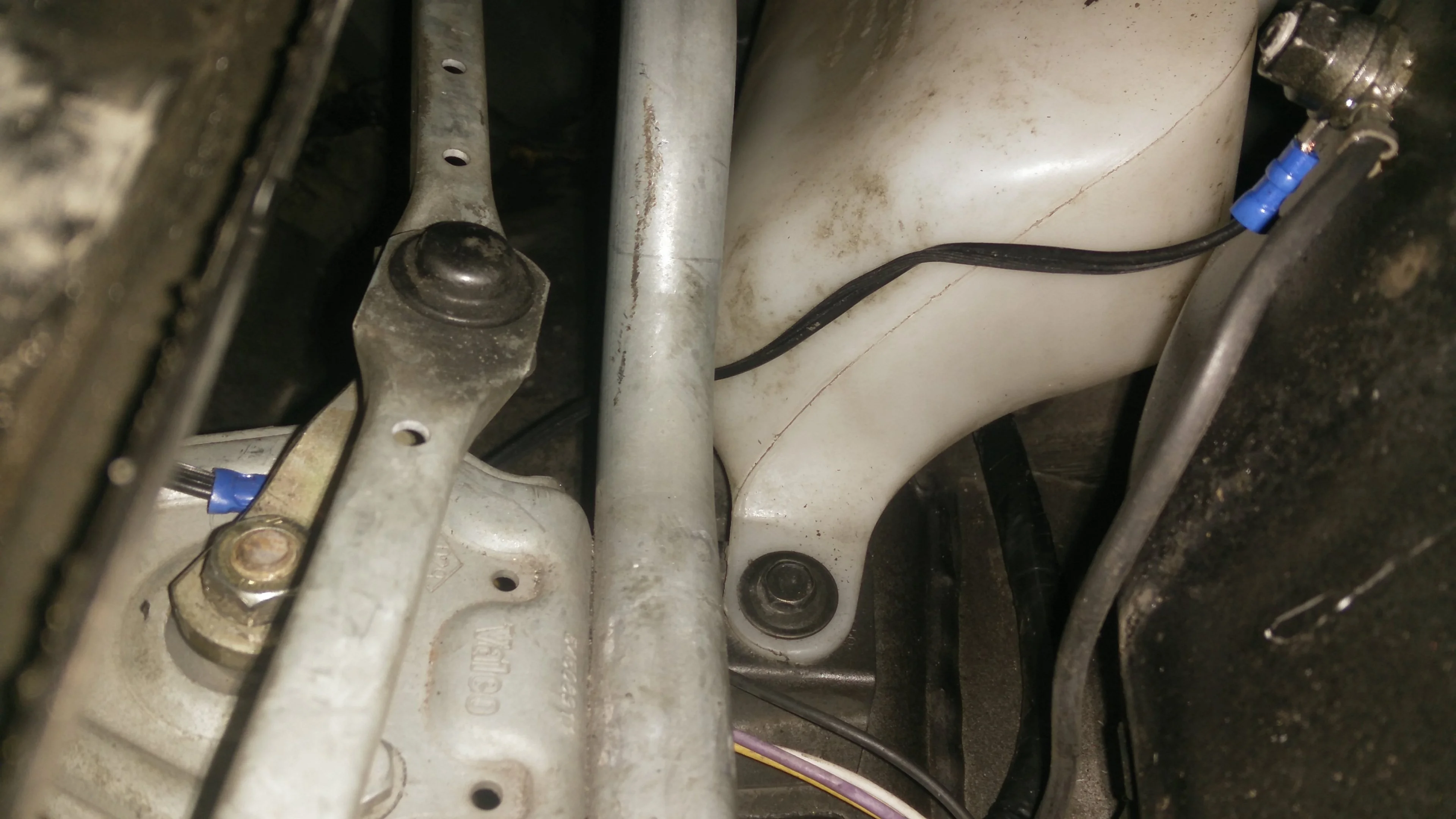

A good GND place near the wiper motor.

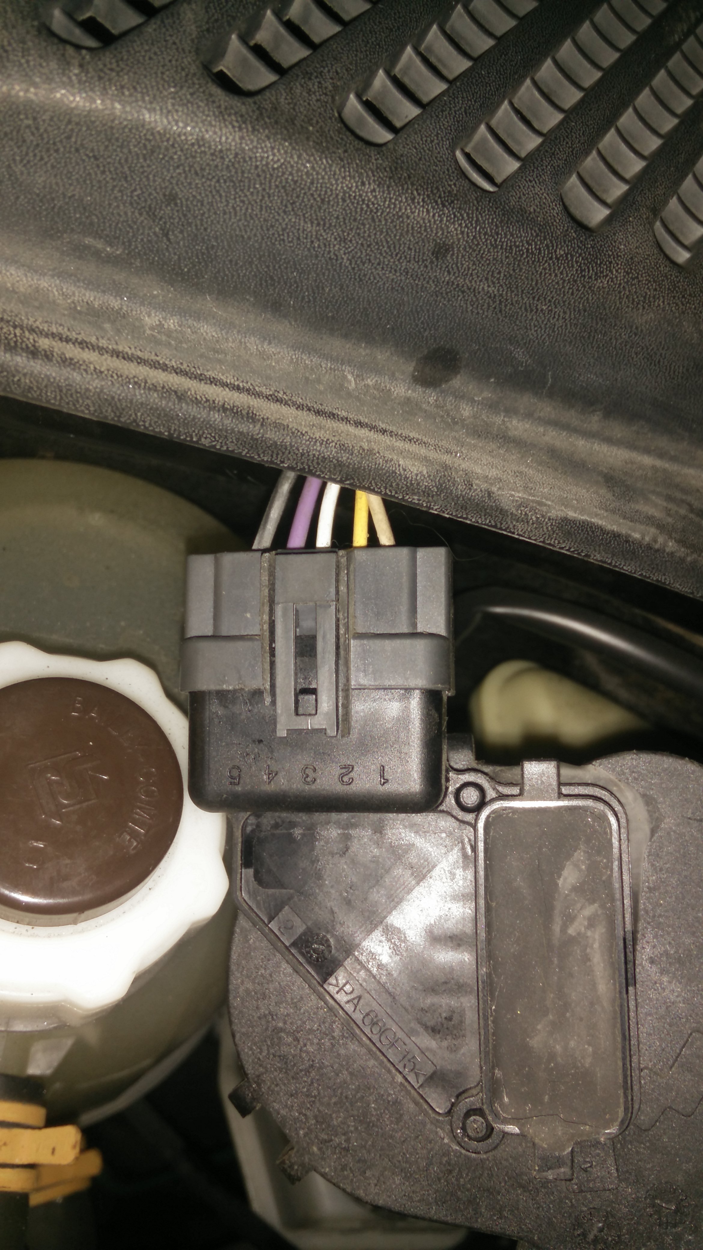

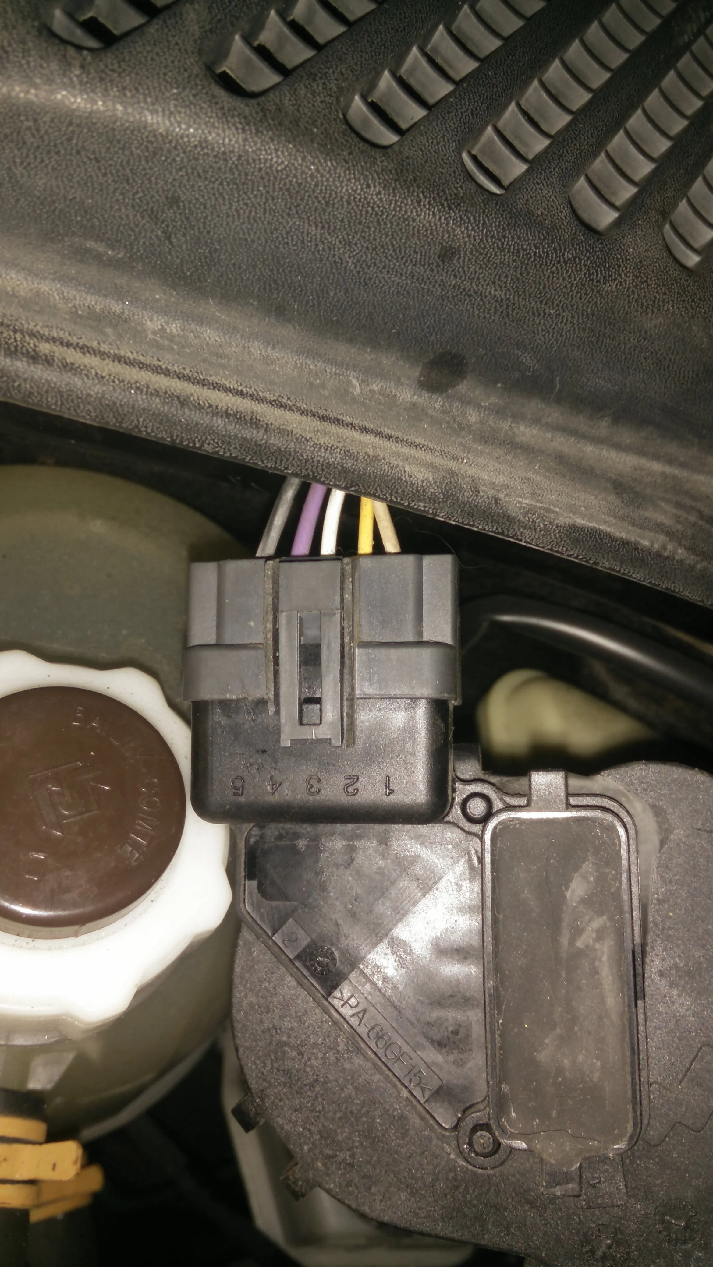

The contact to the wiper motor, electric below. Had 12v between pos4 and battery but nothing between 4 & 5. Bad GND :)

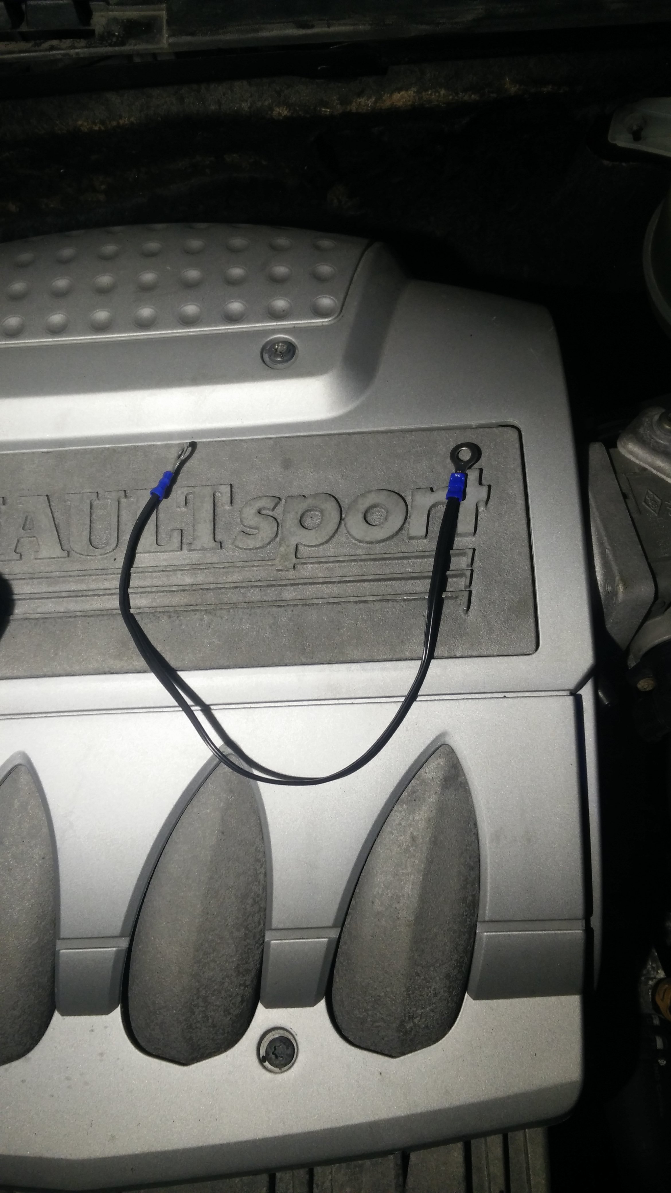

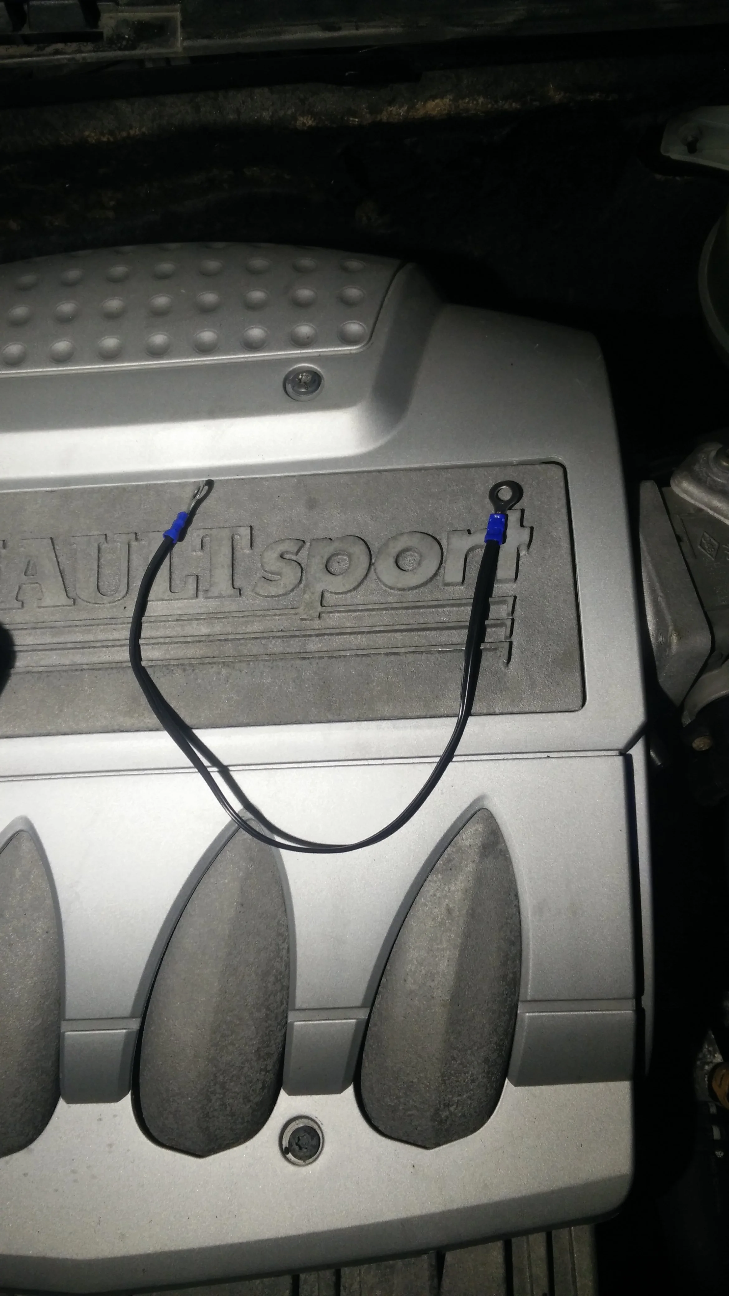

Cable to fix the problem!

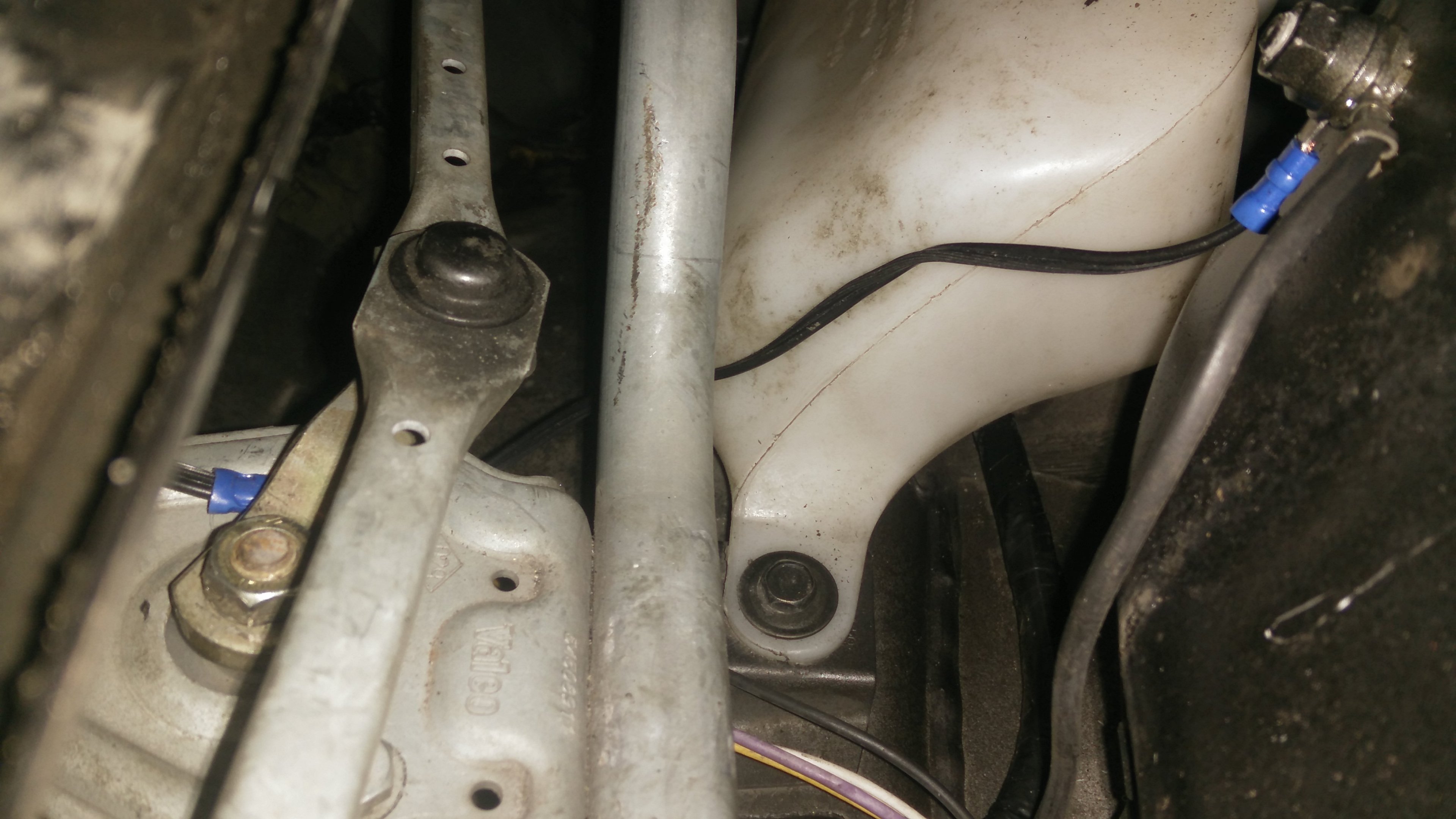

Cable on place, works like a charm!

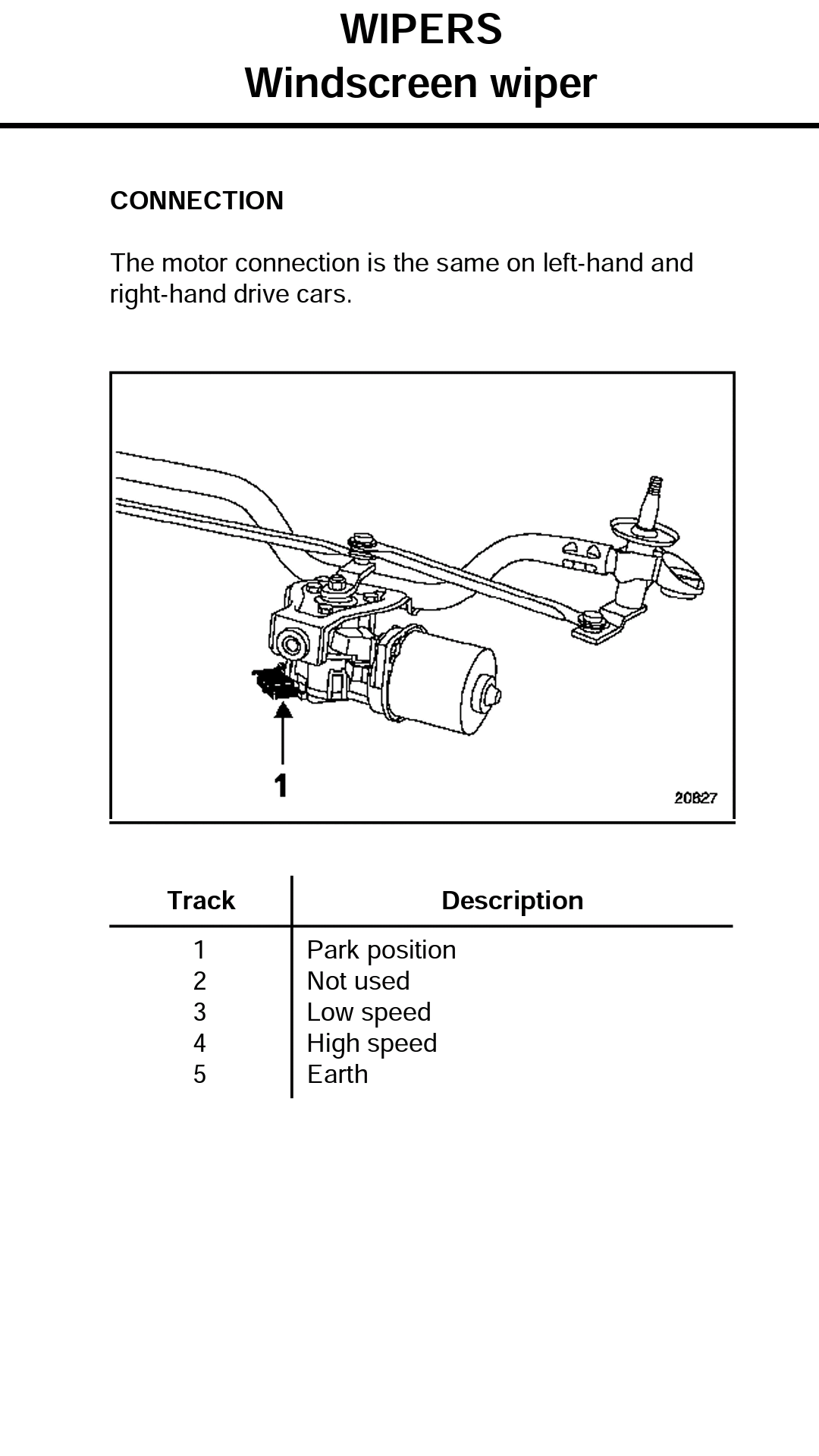

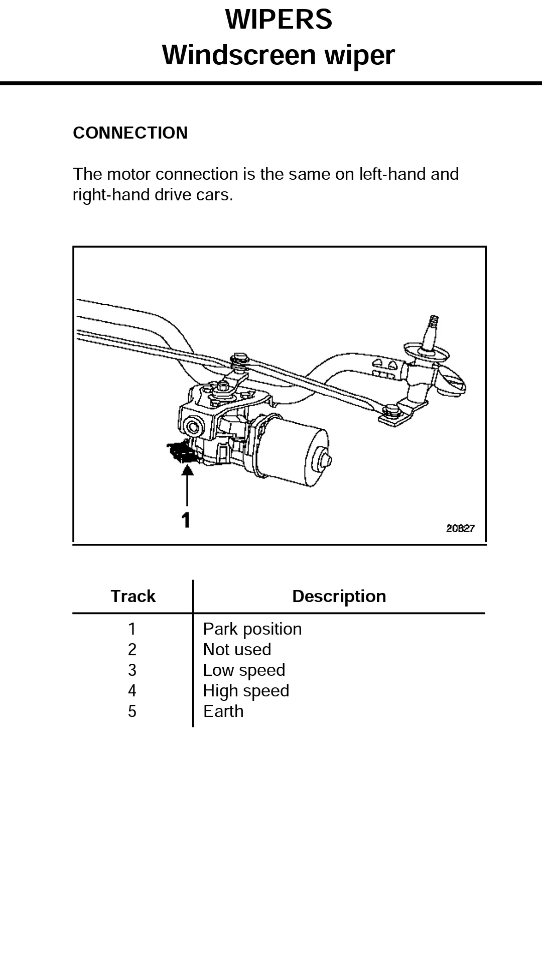

Electric information :)
