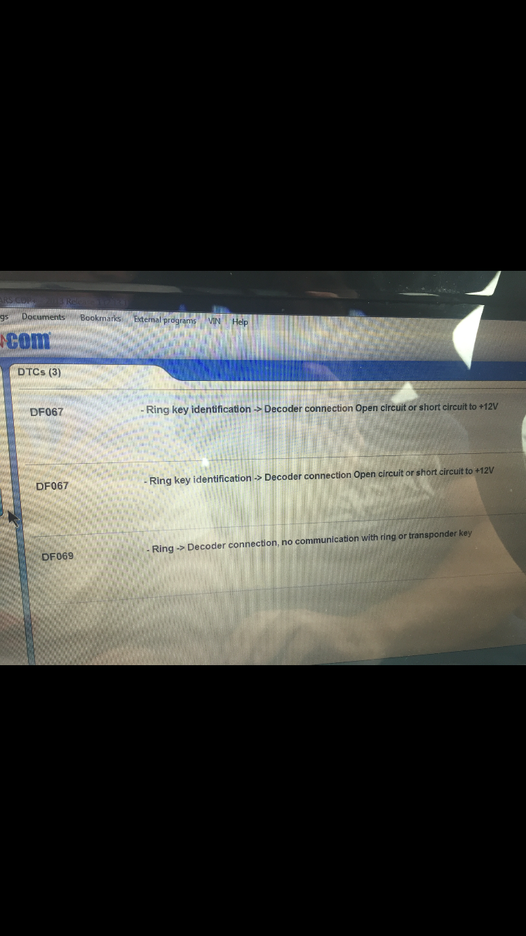

Got them codes??
I remember it being something like being inside the car, lock the car, then unlock it. Put key in ignition on number 2 for 30 seconds. Remove key. Lock car, unlock car.
Ok I'll give that a go when I get a chance. Is the imobilizer light defiantly meant to go off and not stay illuminated when the key is in the ignition?
