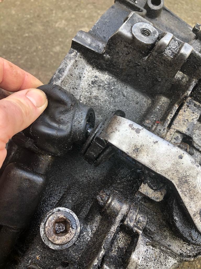

Currently have the engine/gearbox out of my 172 Monaco for some new belts/clutch etc and I am needing some help..
Noticed a lot of oil buildup around the selector area and the rubber boot has split- is it possible to buy this part?
Also is it best to get a selector seal kit?
M90SR
RPD say that the gaitor is available from UK stock, part number 8200136186 @ £43.10 i/c vat + £5.50 postage., so bargain.
The selector shaft oil seal leak is a gearbox strip down to replace, and is a very common problem.
Most owners just top up the box every 6 months, as it usually looks worse than it actually is.
