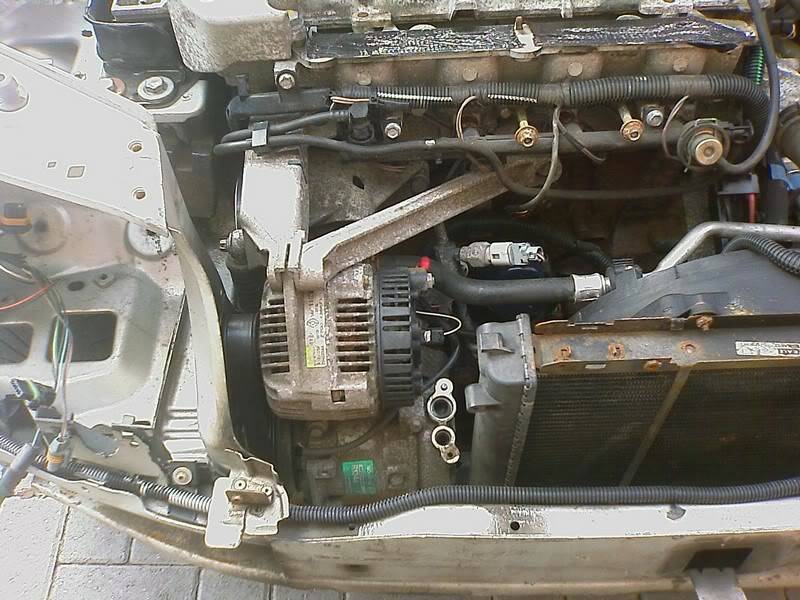

Power steering sensor is near the wire for a/c clutch. It's possible they've disconnected that ? I'll see if I can find a photo of what is looks like

That link didn't seem to work . Posted picture instead

The only wire to do with a/c near the power steering sensor is that wire I pointed out. I've not seen a wiring diagram for a/c but I wouldn't have thought that would have stopped the blower. If Renault said it's the resistor pack just buy a new switch cluster on eBay . But I would check if you can see that that wire is disconnected . It might be out and be the cause of the problem

Got it! Thank you very much for you help. I will check it out and keep this thread updated. I will try also to swap in the resistor pack of my friend's 182. Just for me to pinpoint the problem if the wire you're talking about is plugged in or not.
