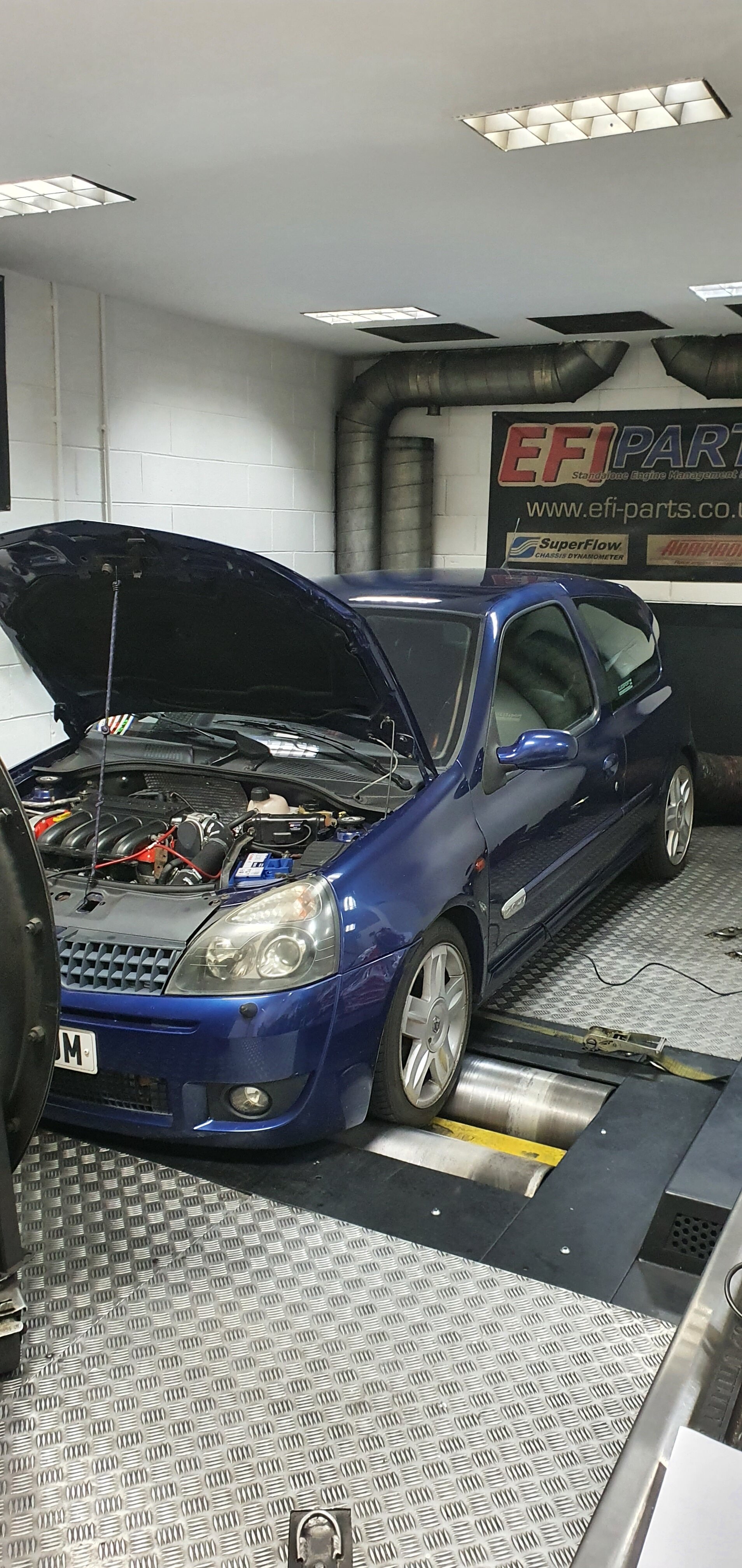

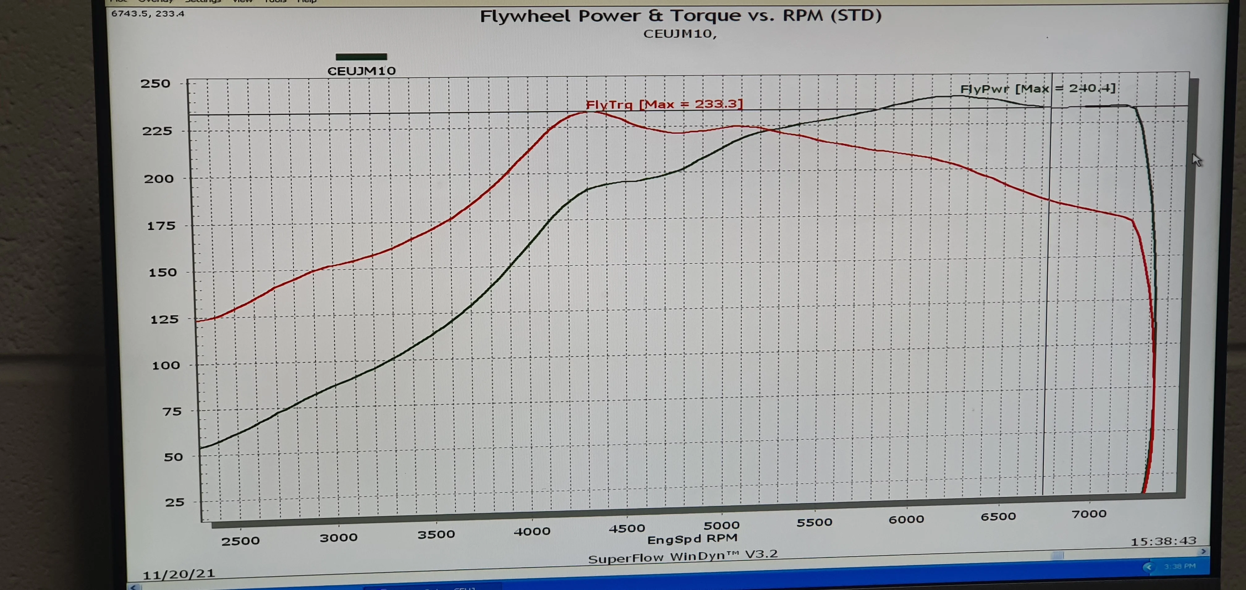

I'll put some build info up shortly, but here's the results at EFI yesterday after a bit if fettling and map tweaks:
240.4bhp and 233ft/lb
Quite pleased with that.

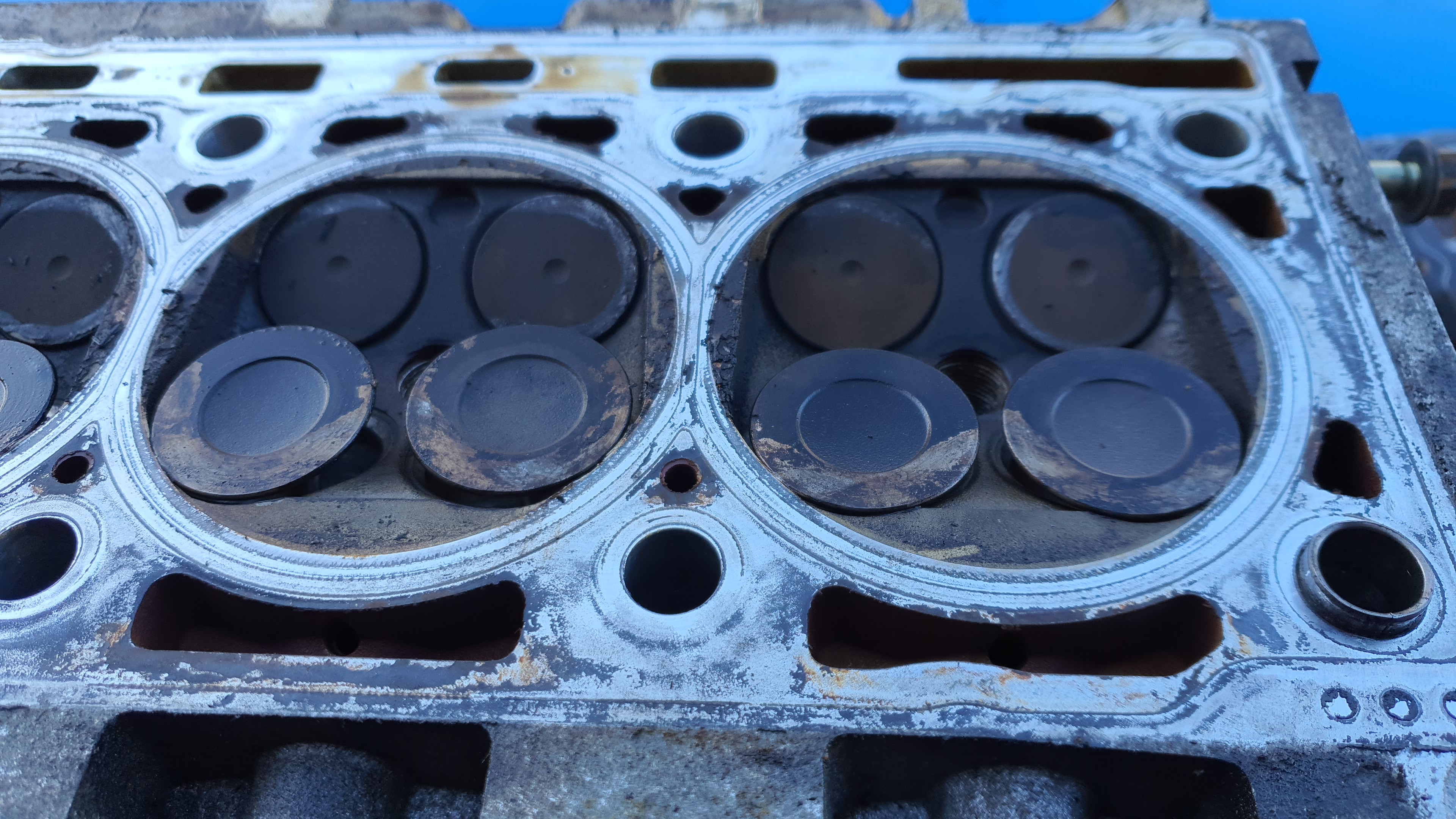

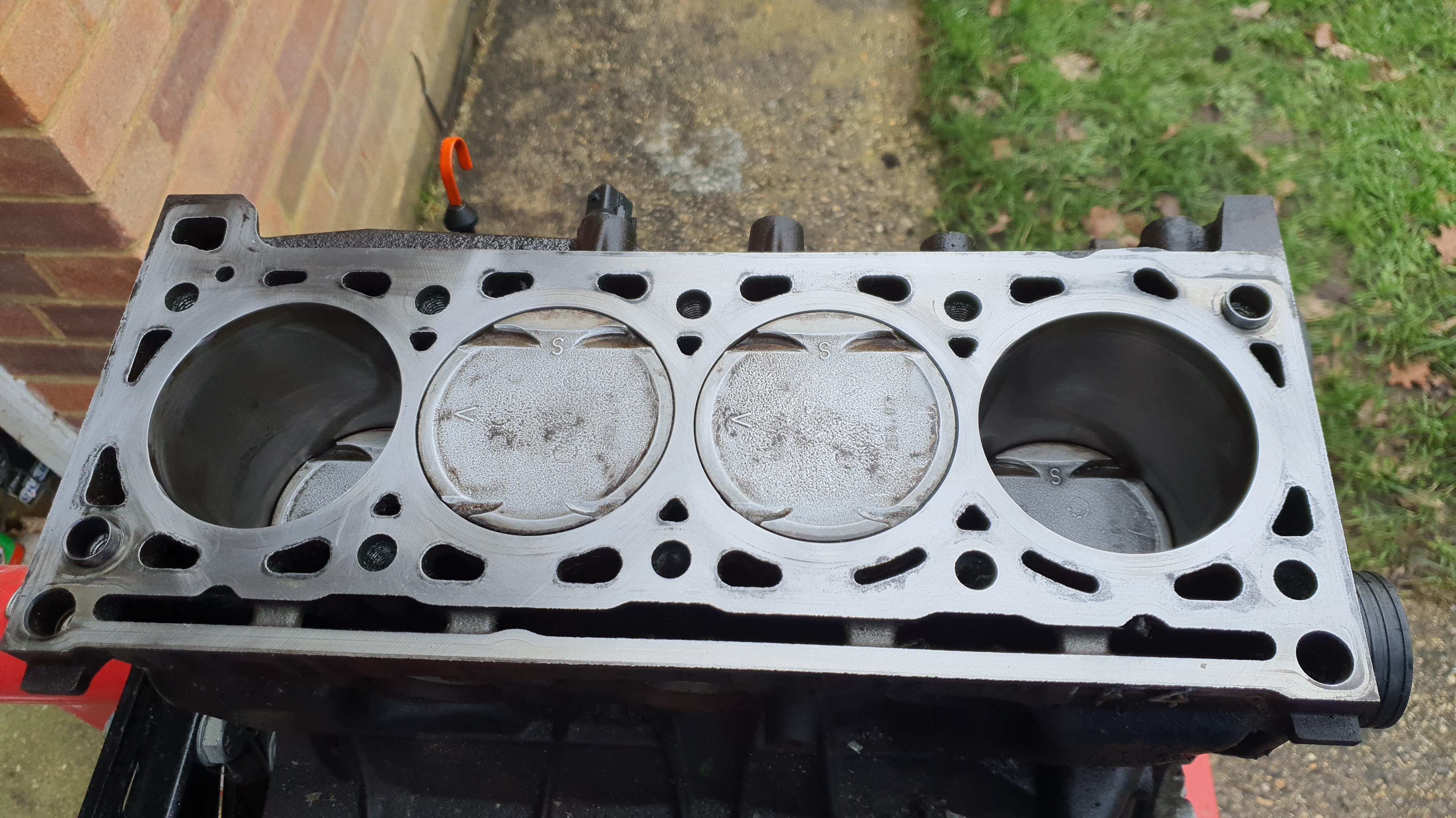

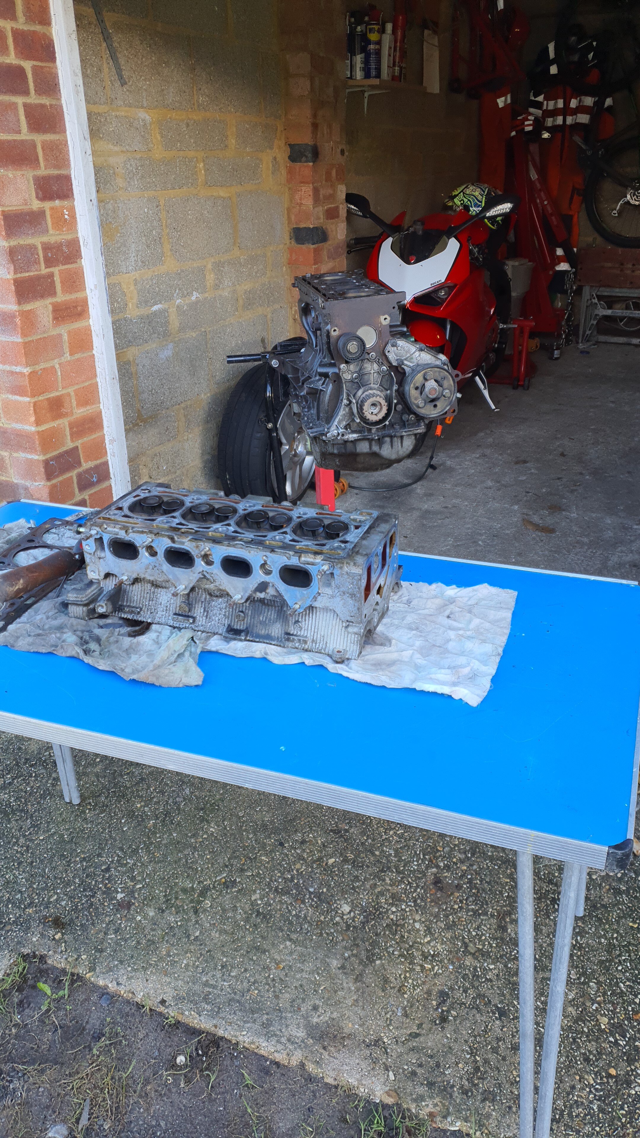

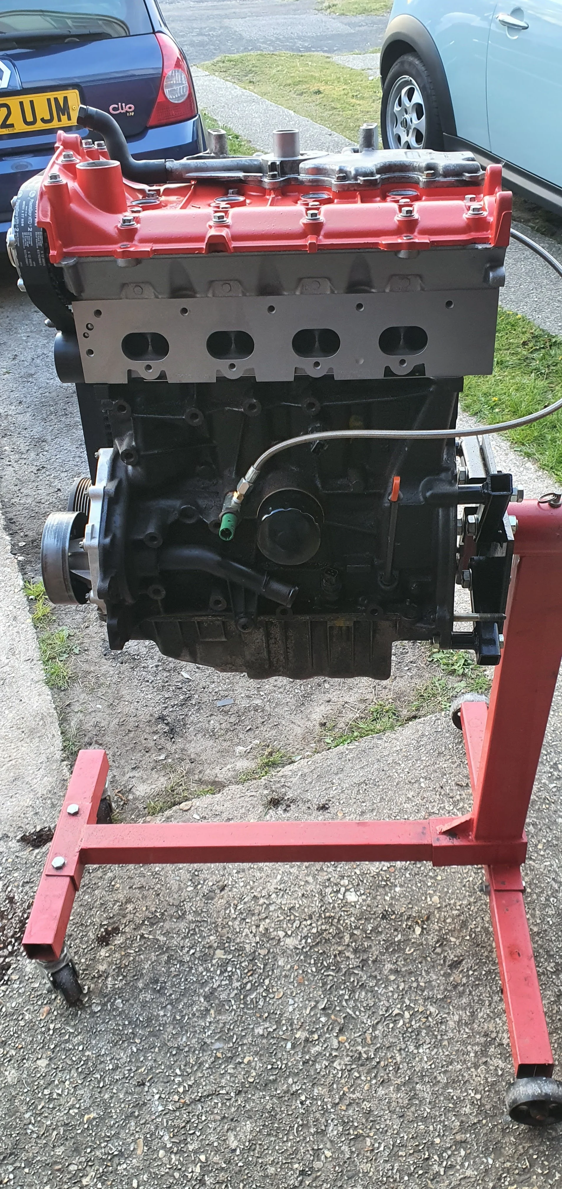

The engine had been sat in my garage with suspected bent valves....looks like I was right 🤣
Fishfire
  Clio 172

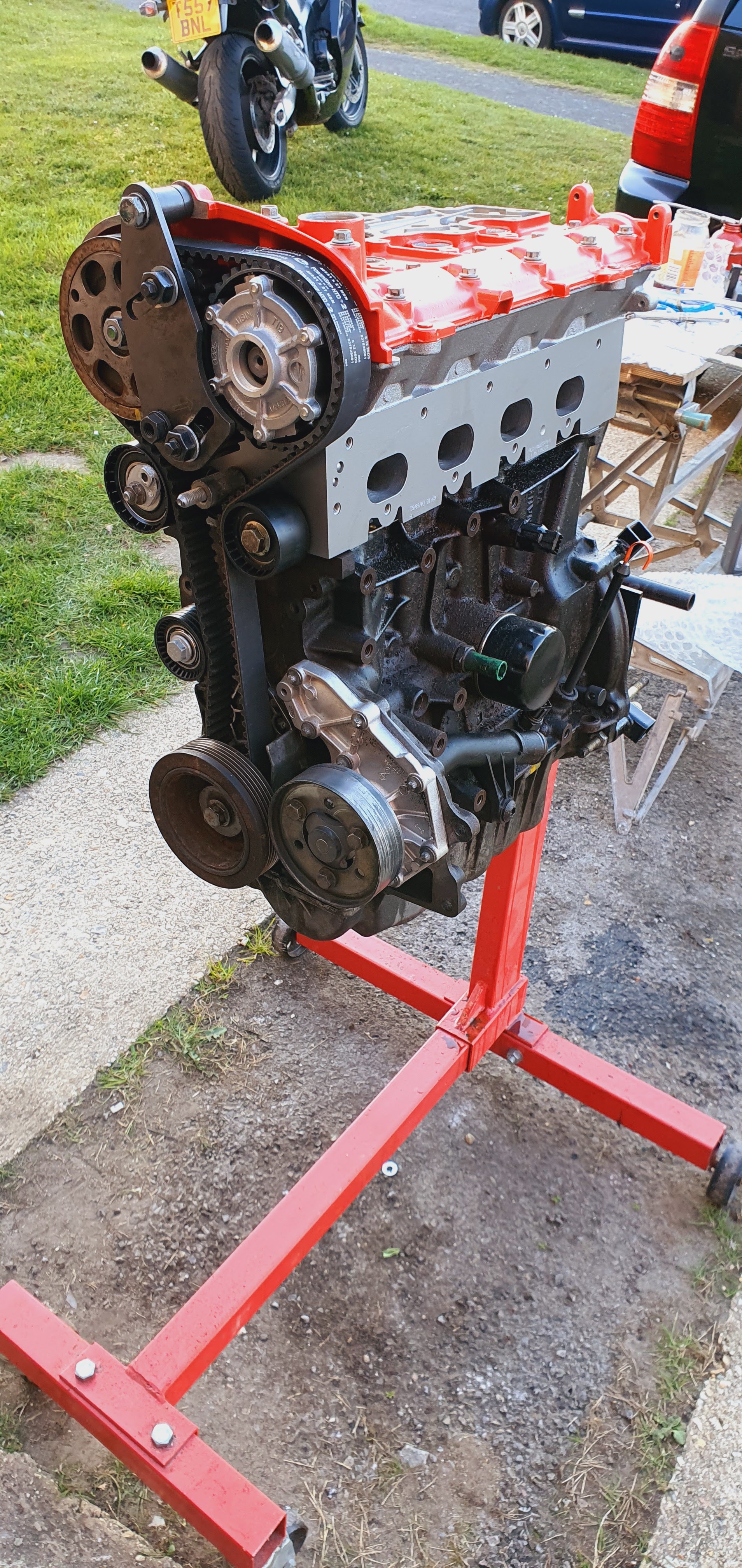

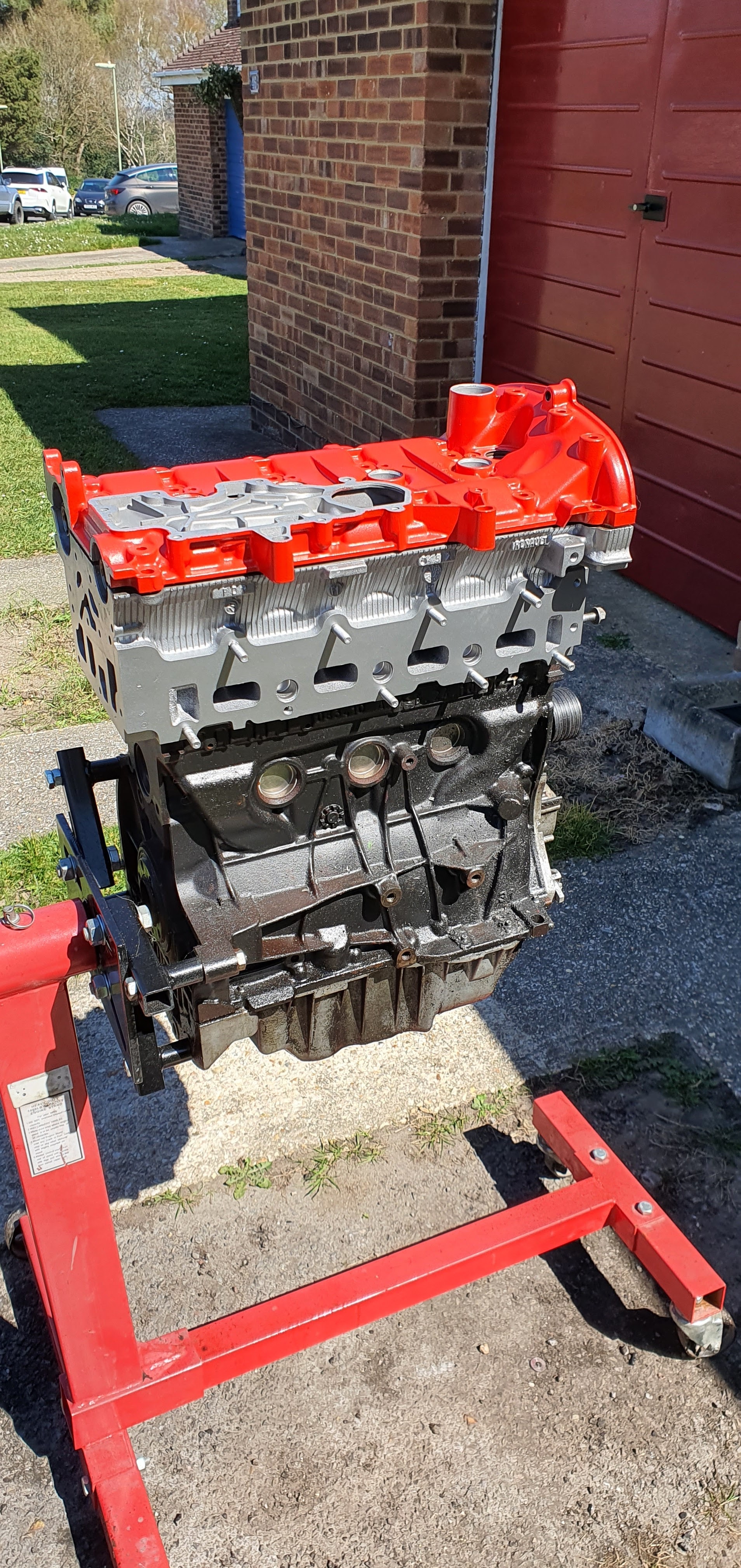

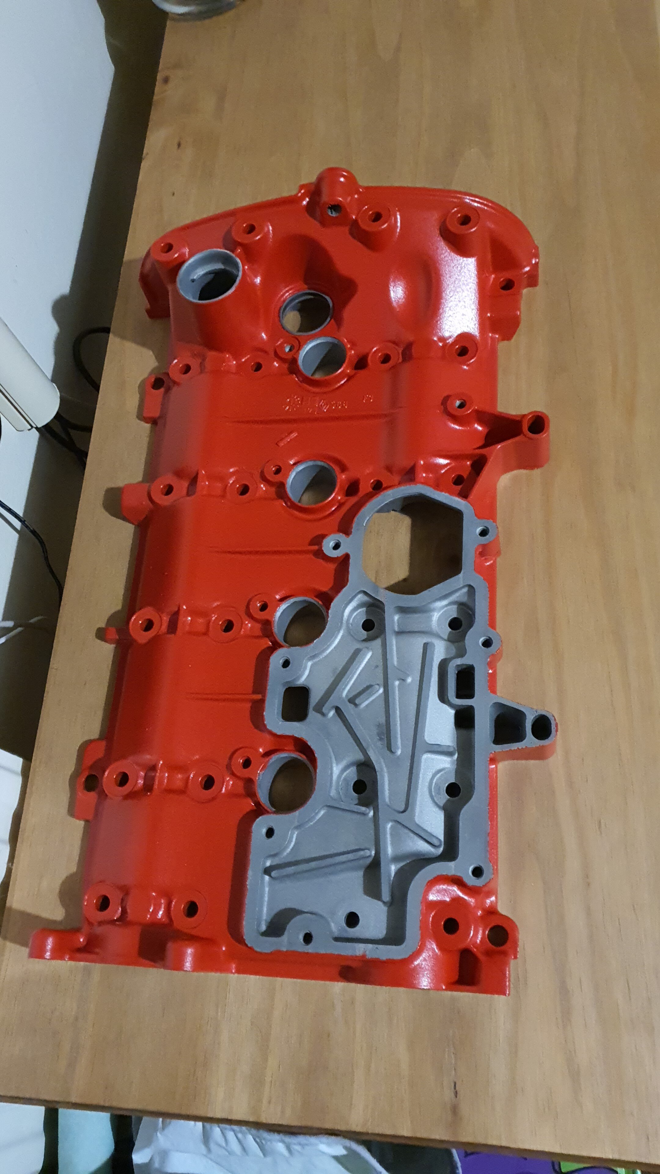

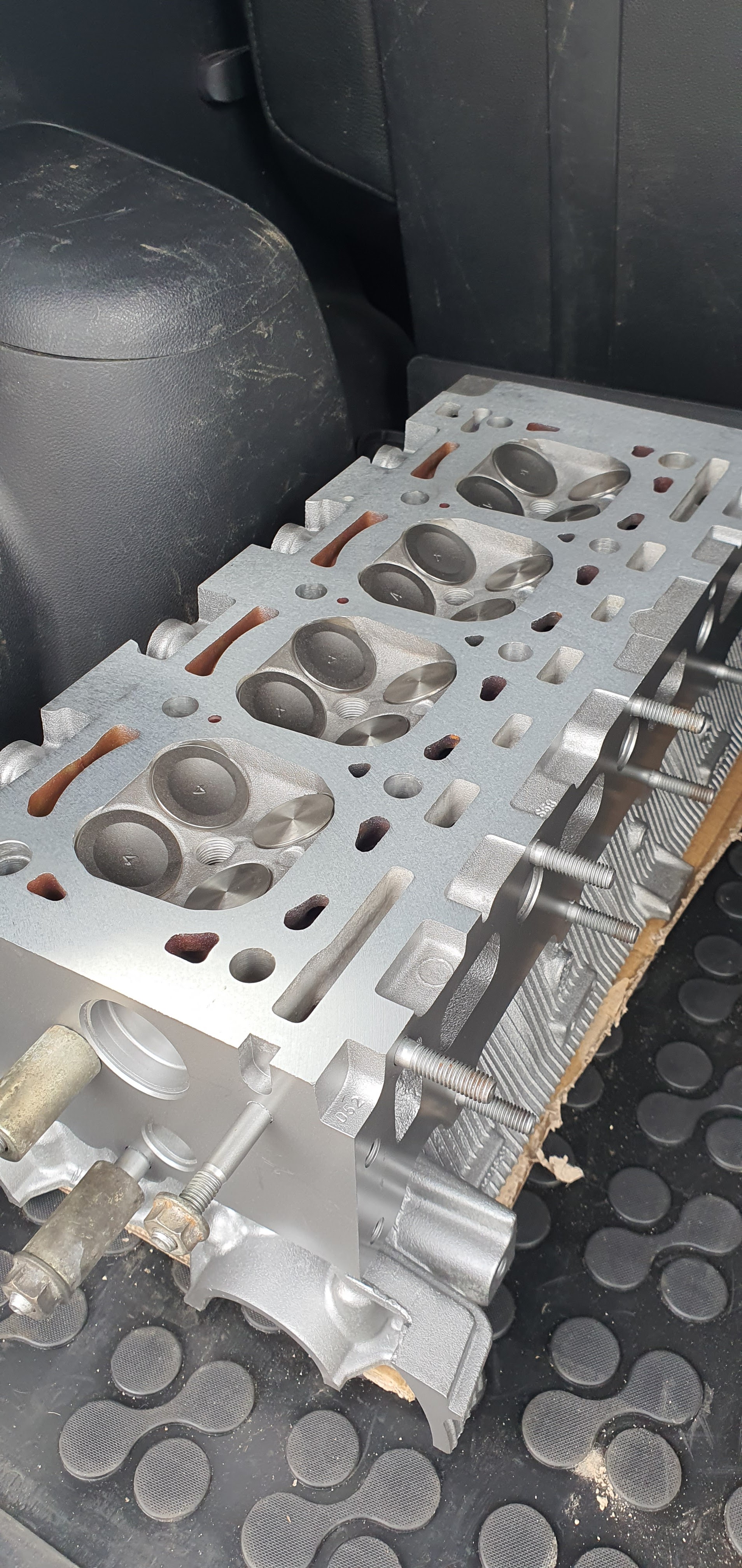

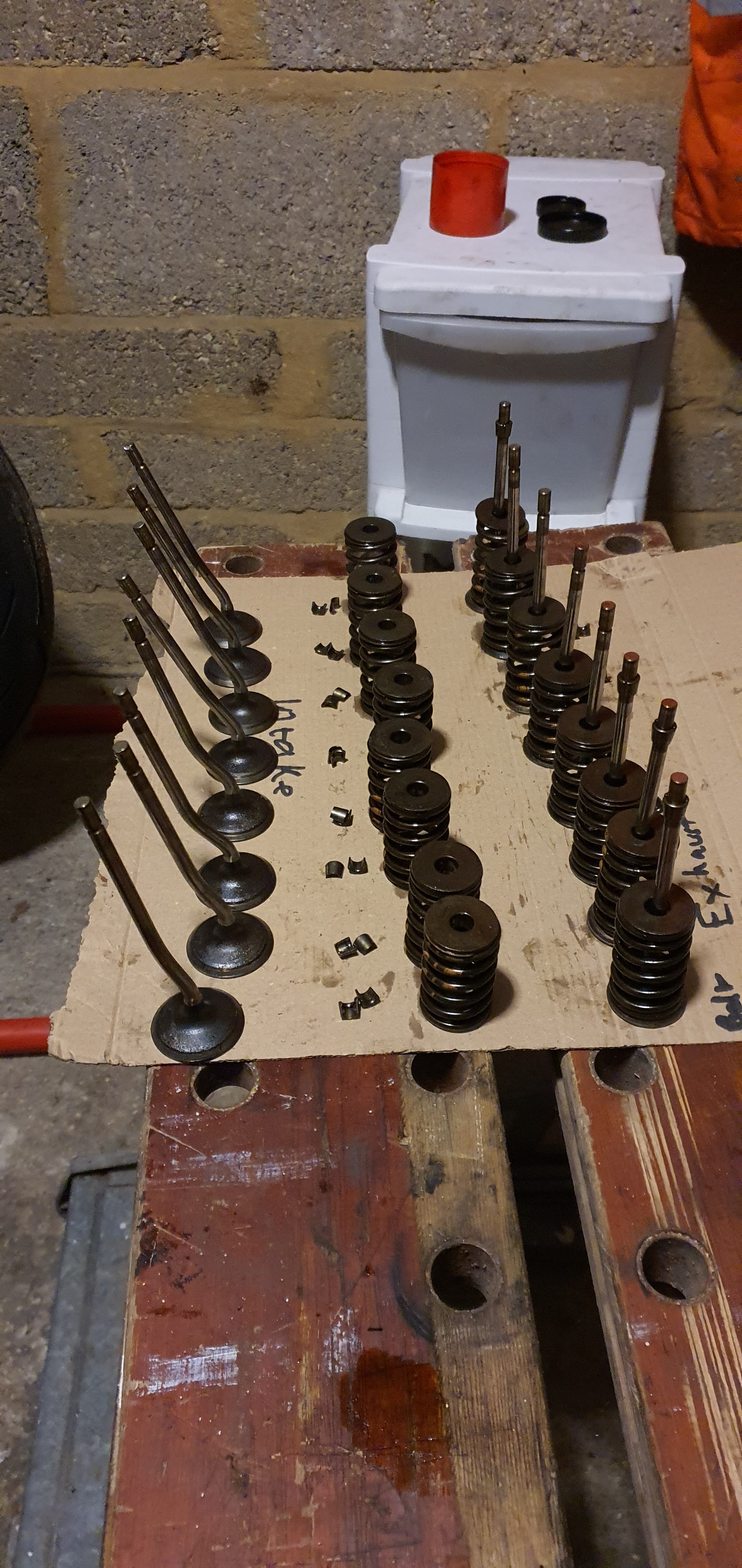

Got the head checked, with a light skin and fitted all new standard valves
And a light clean up of the block

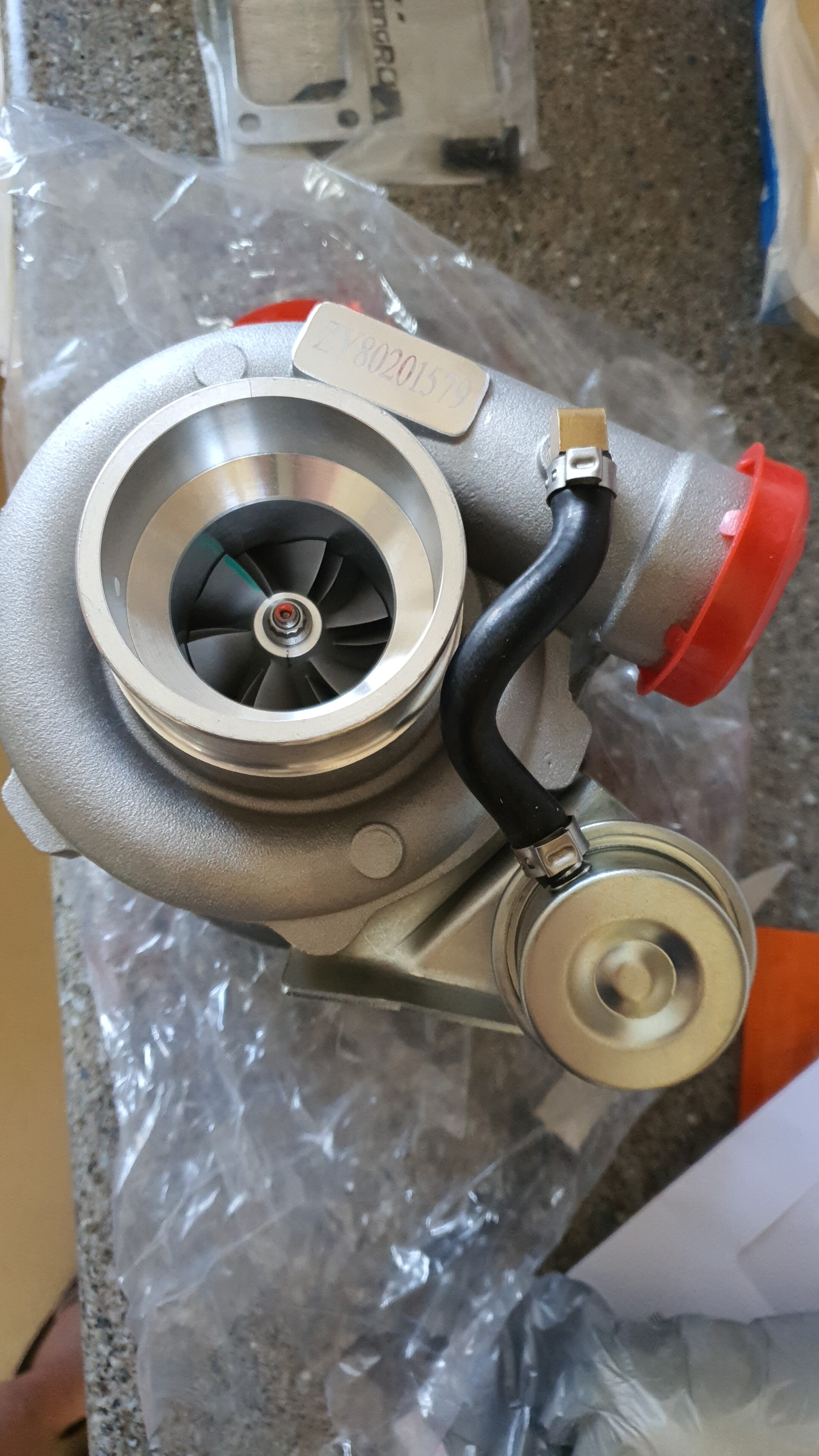

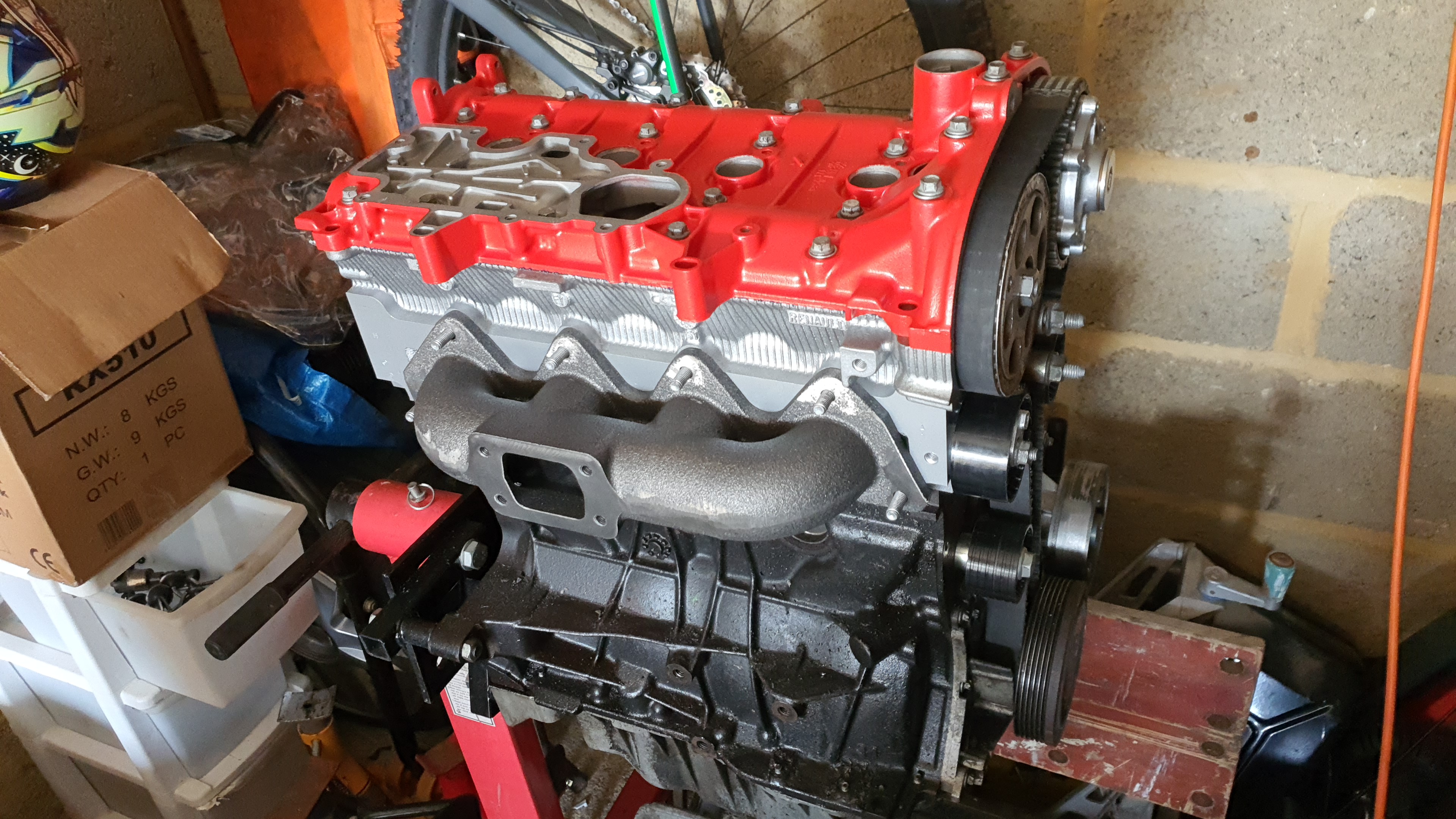

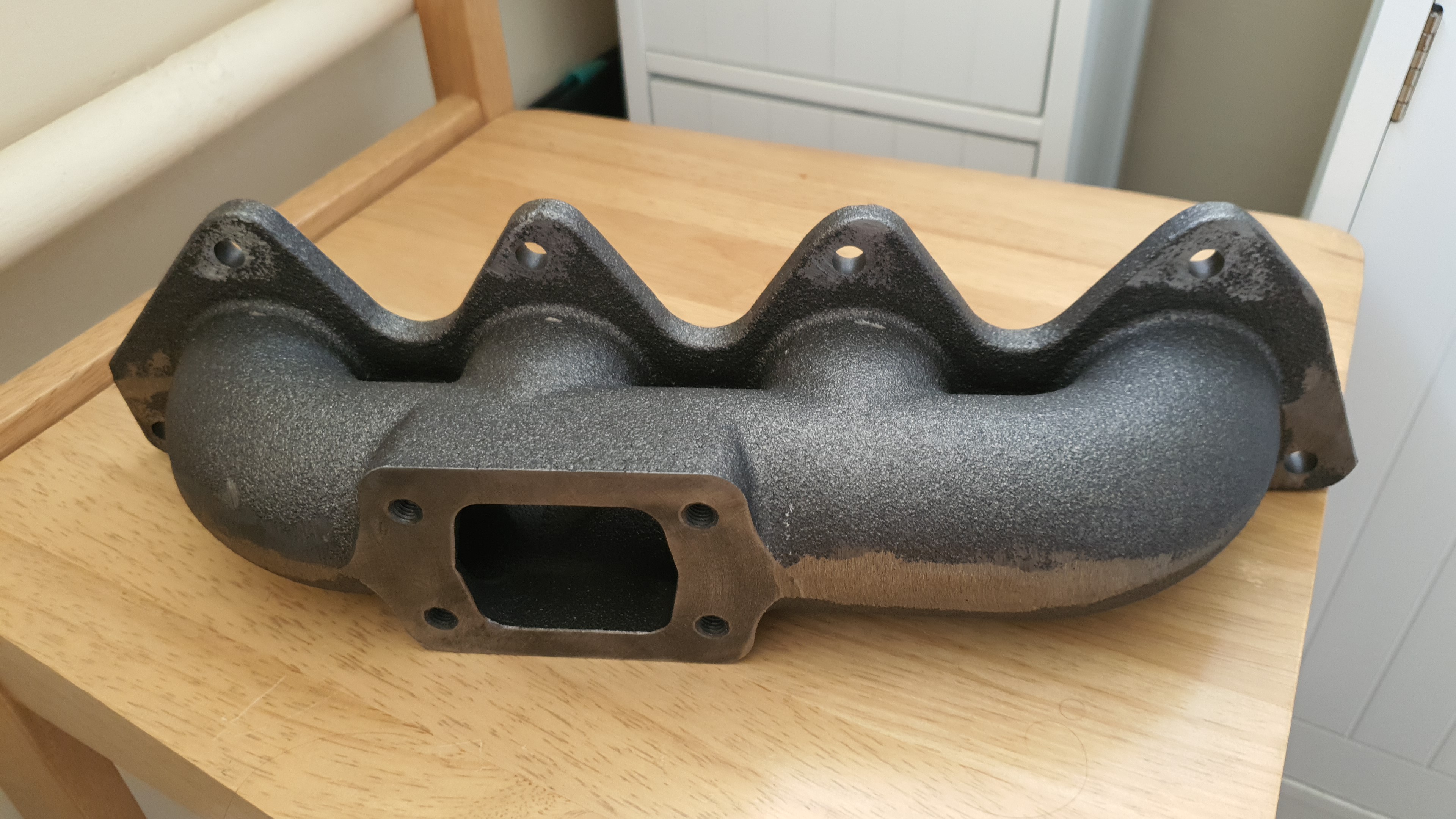

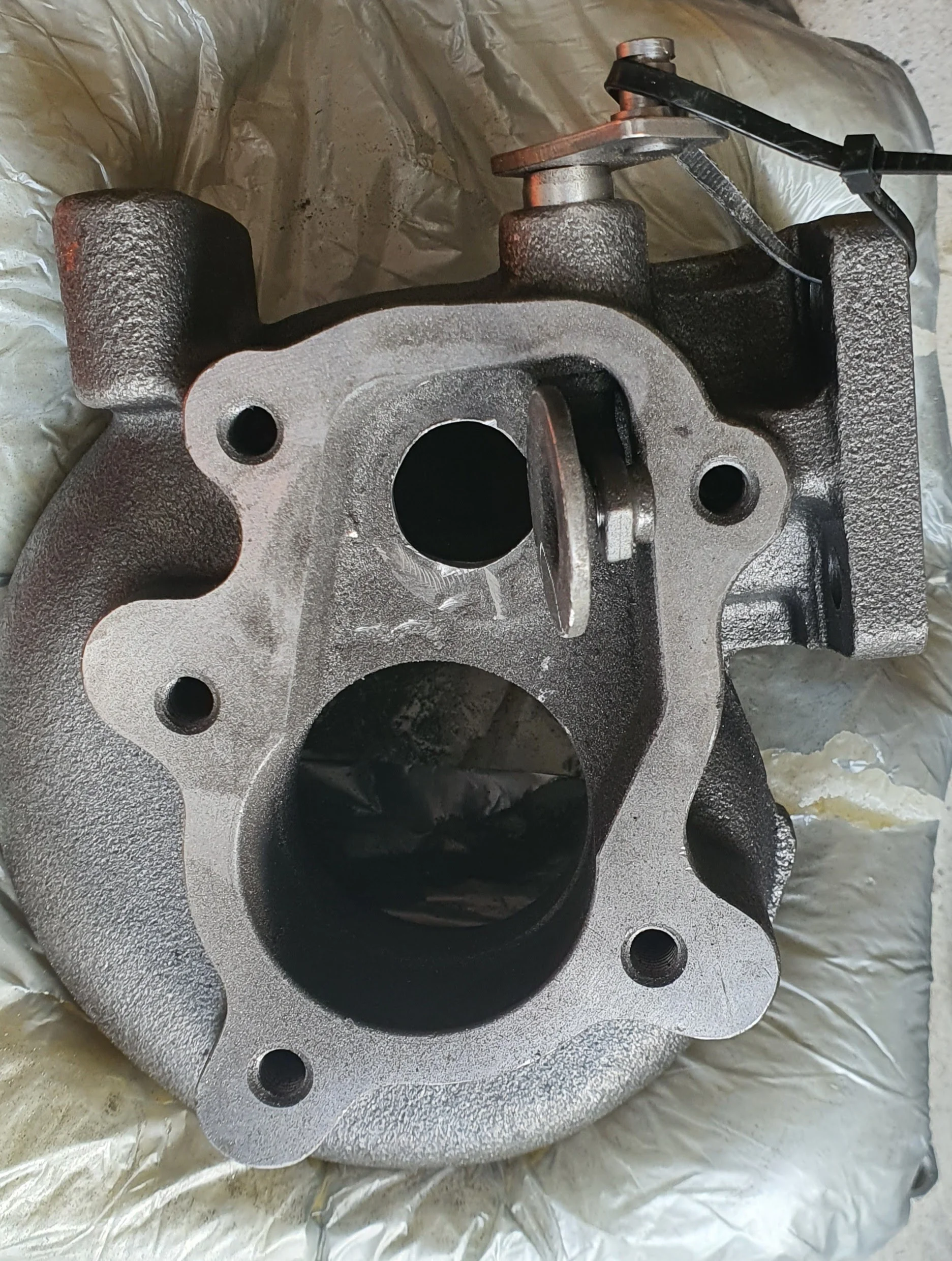

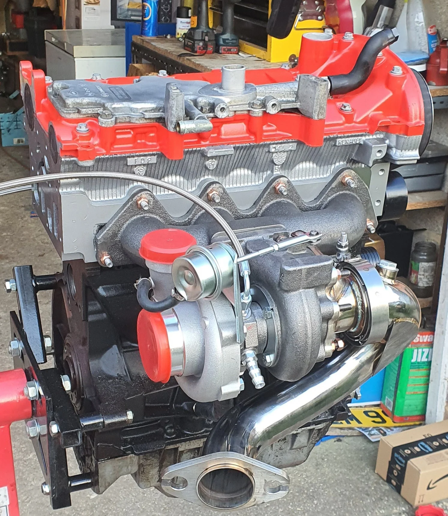

And bolting on the turbo bits. The manifold is a cast item bought from a company in China. Had the mating surfaces checked for true, and actually, it wasn't bad!

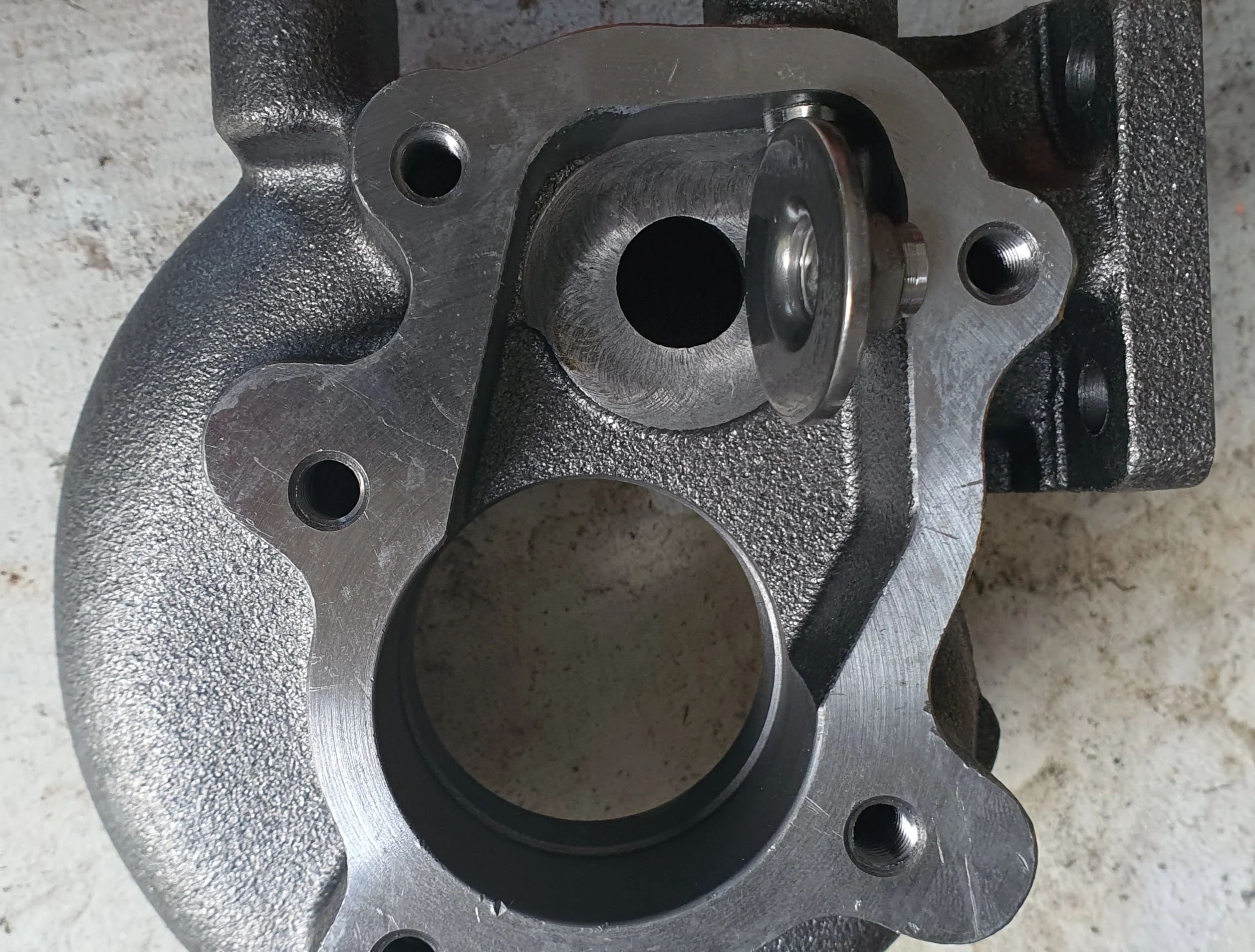

Turbo was a Maxspeedingrods 'churbo' that was balanced (again, pretty good for a cheapie!) and I ported out the ridiculously small wastegate.
GT28 replica
Before porting:
After porting:
Fishfire
  Clio 172

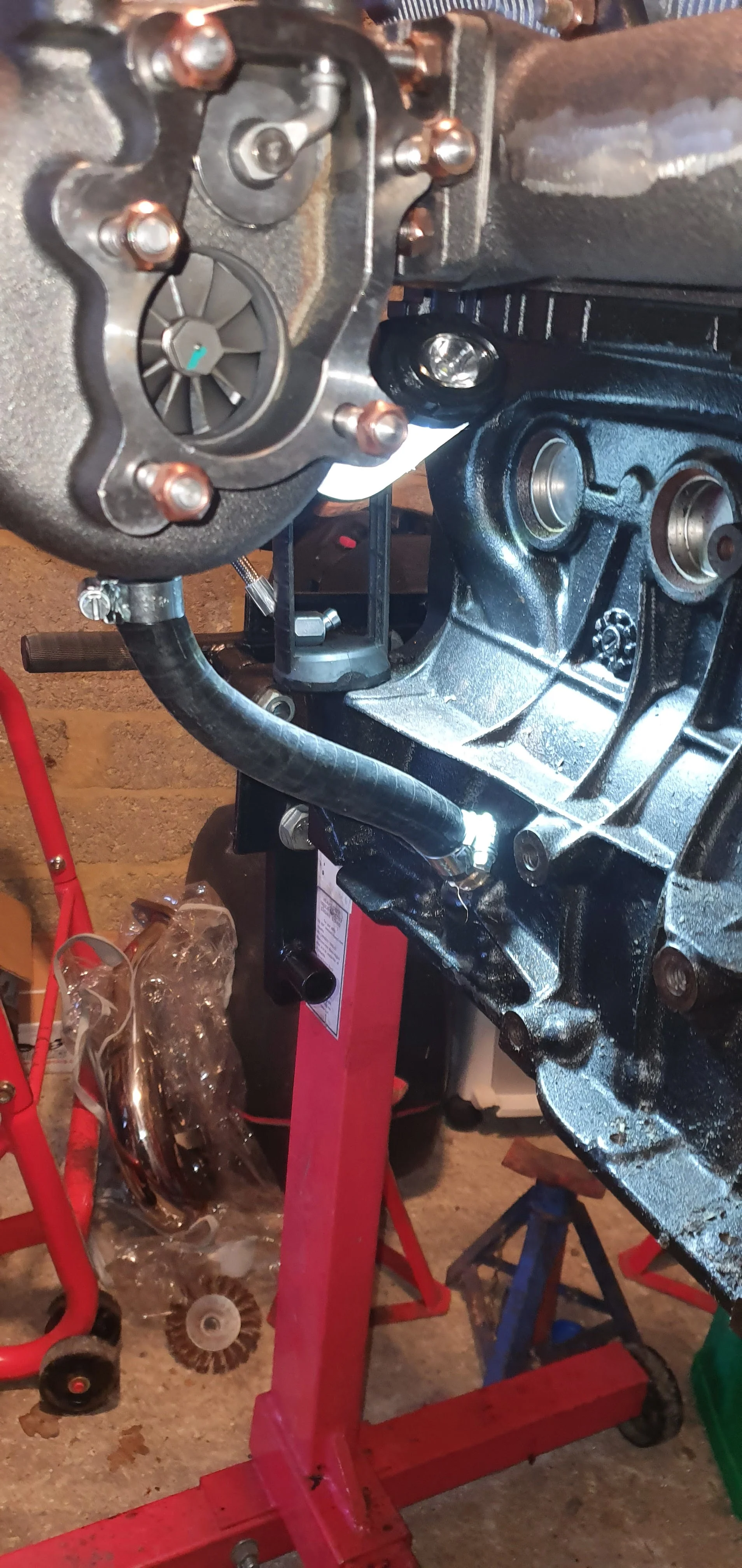

The actuator that came with the turbo was way to high. I replaced it with an adjustable Kinugawa actuator with a "0.5 bar" spring.....more on that later 😏

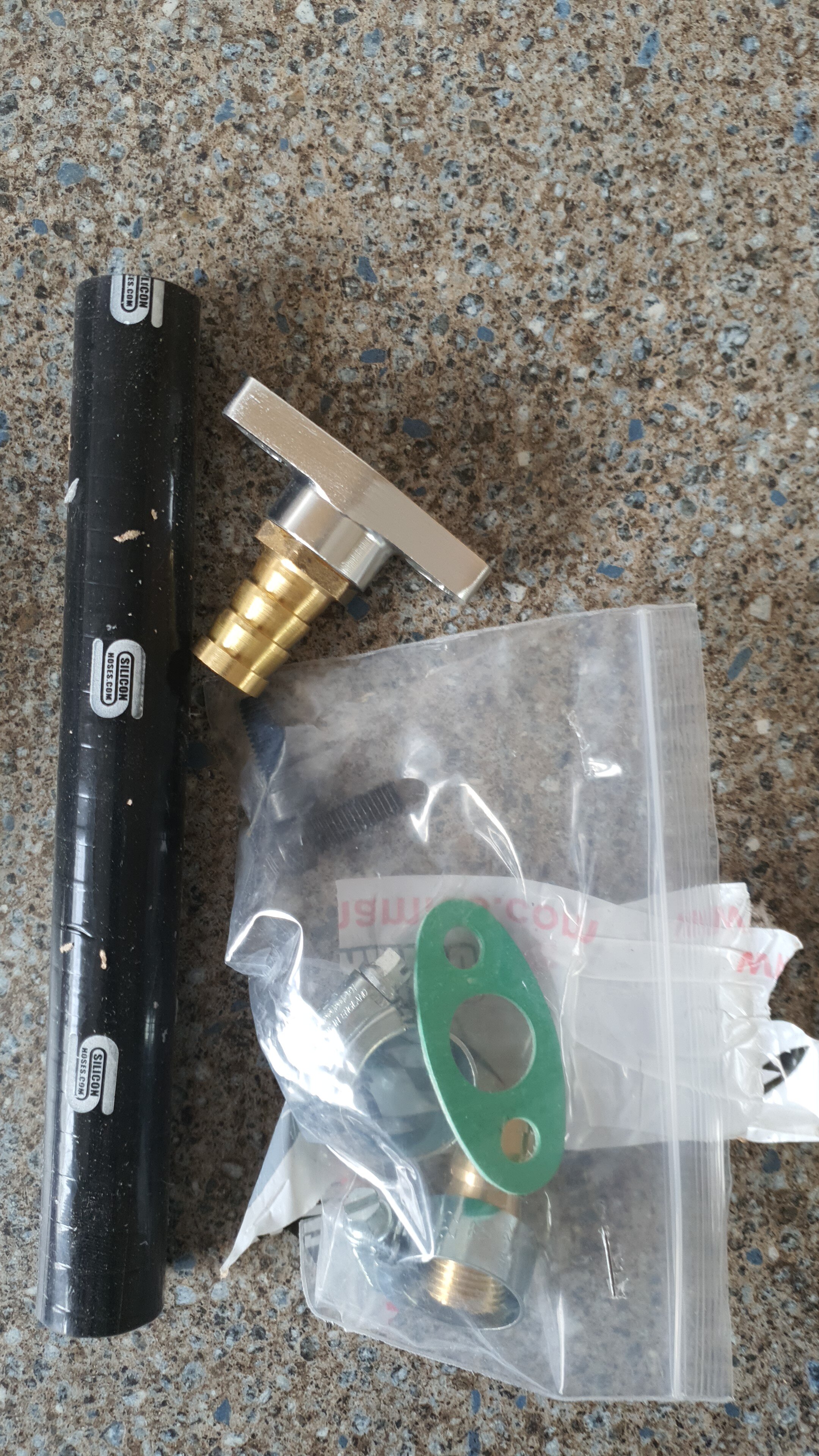

After a chat with SteveC_1879 who was on a similar build, I bought some oil feed lines and various fittings from the FleaBay. Water feed and return pipes and banjos were another eBay purchase and far cheaper than buying in kit form.
Oil drain came from Engine Dynamics as i wanted a drain that was proven to fit, but to be honest, was an utter ball ache to fit.
Turbo downpipe was another ED item, though it does foul.the subframe annoyingly

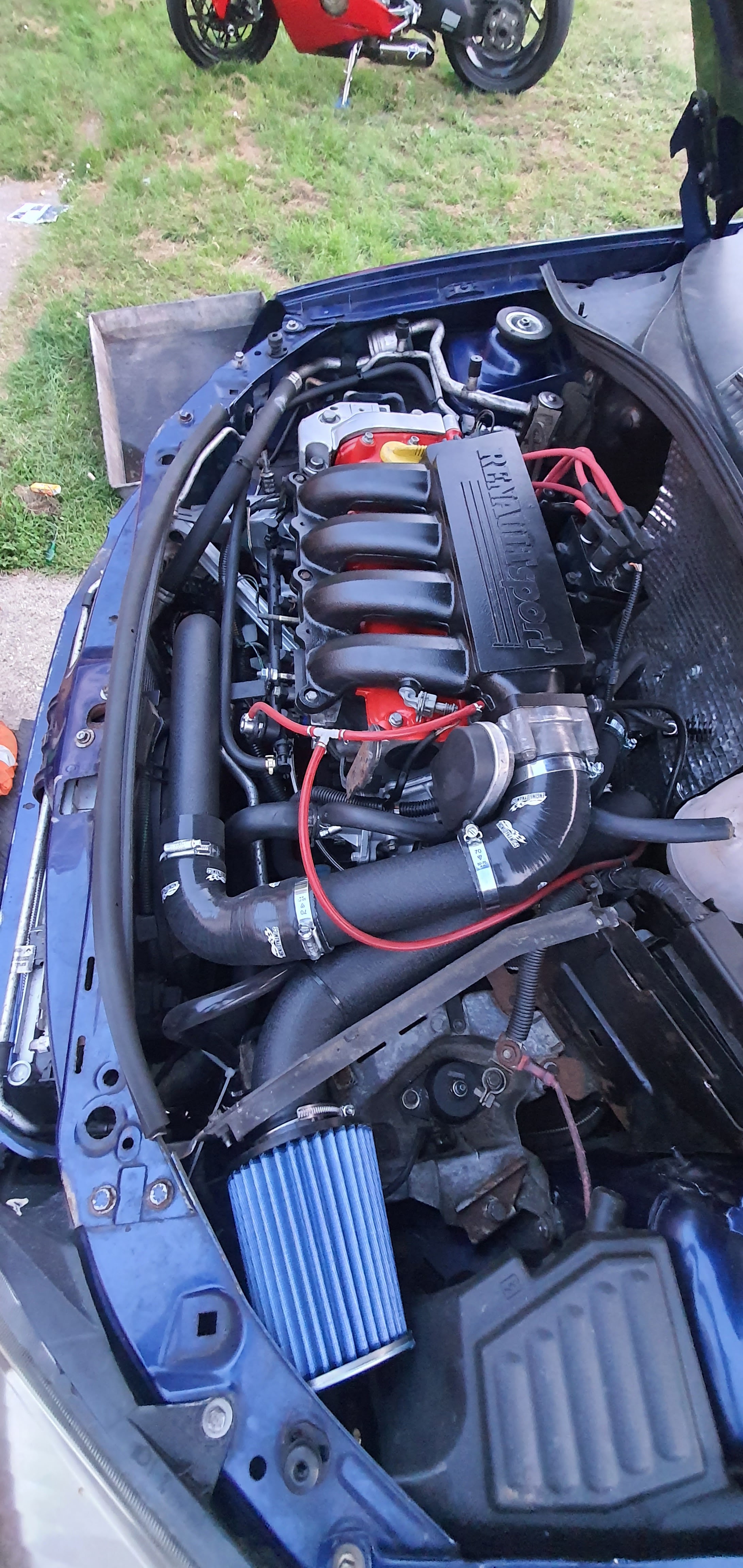

All the bits fitted:
Oil return:
And oil feed:

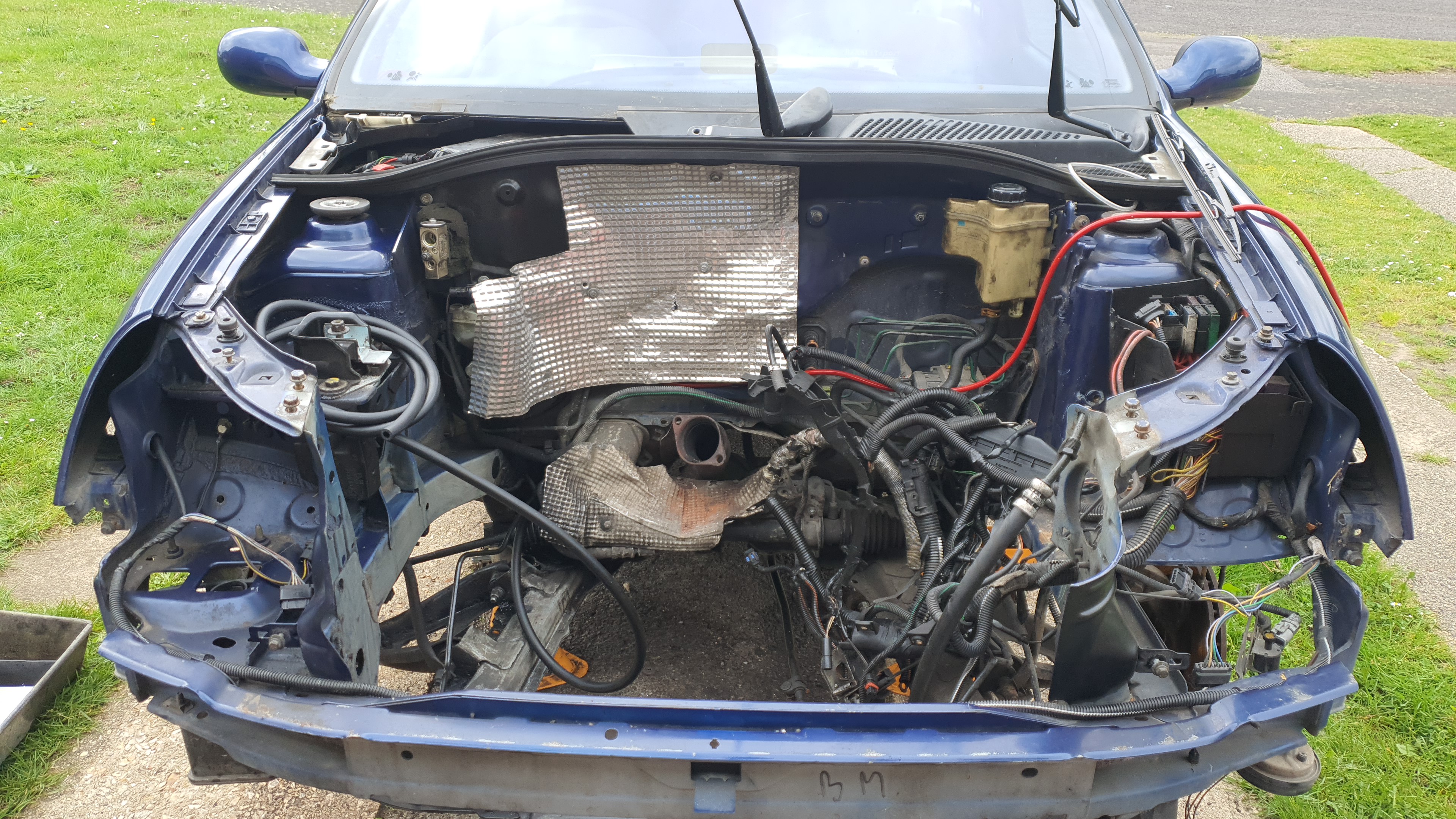

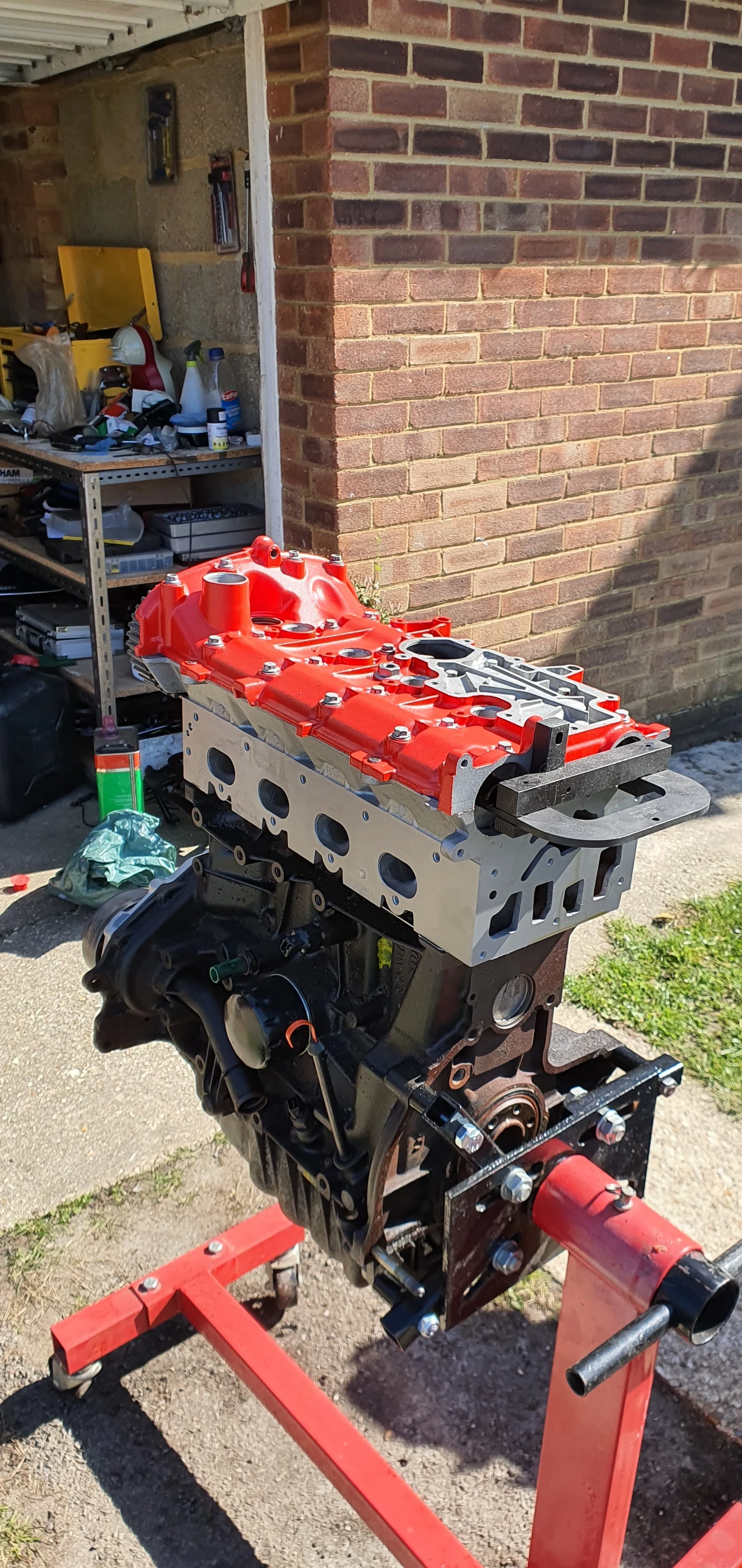

I removed the current engine so I could get busy fitting the nimbus heat shielding. Word of warning....that stuff is sharp. I managed to slice my finger which I guess is my bad for not wearing gloves lol

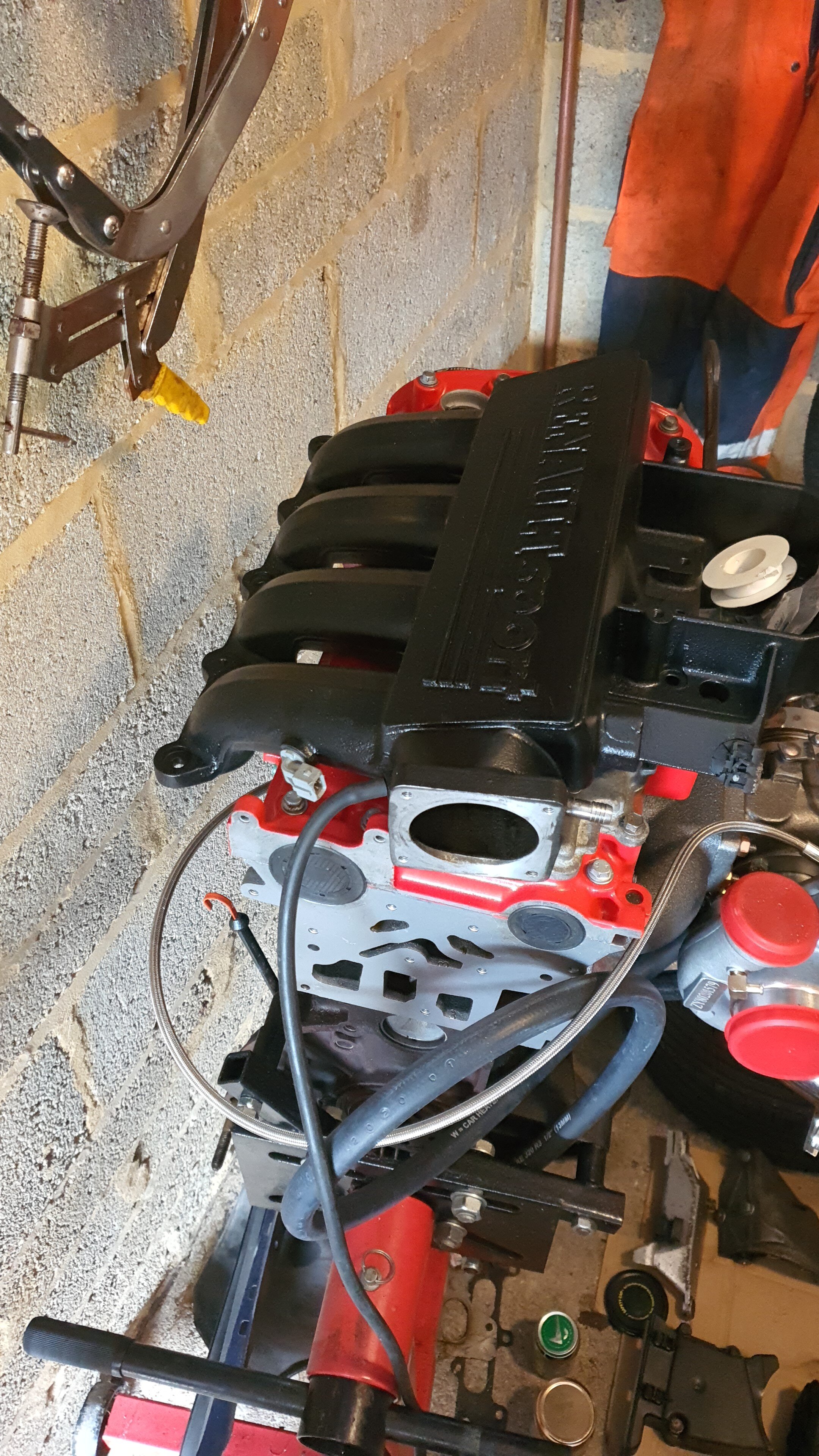

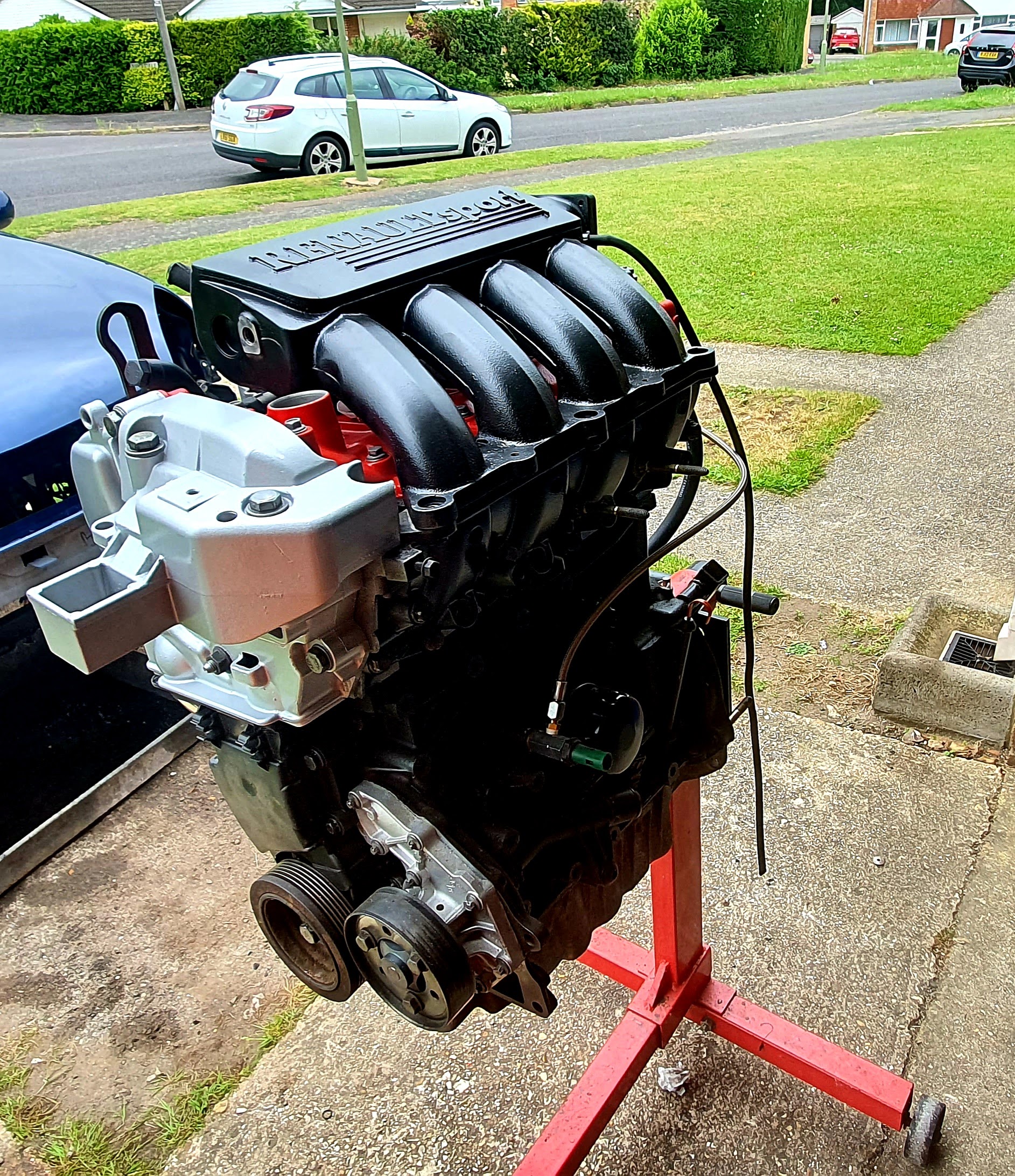

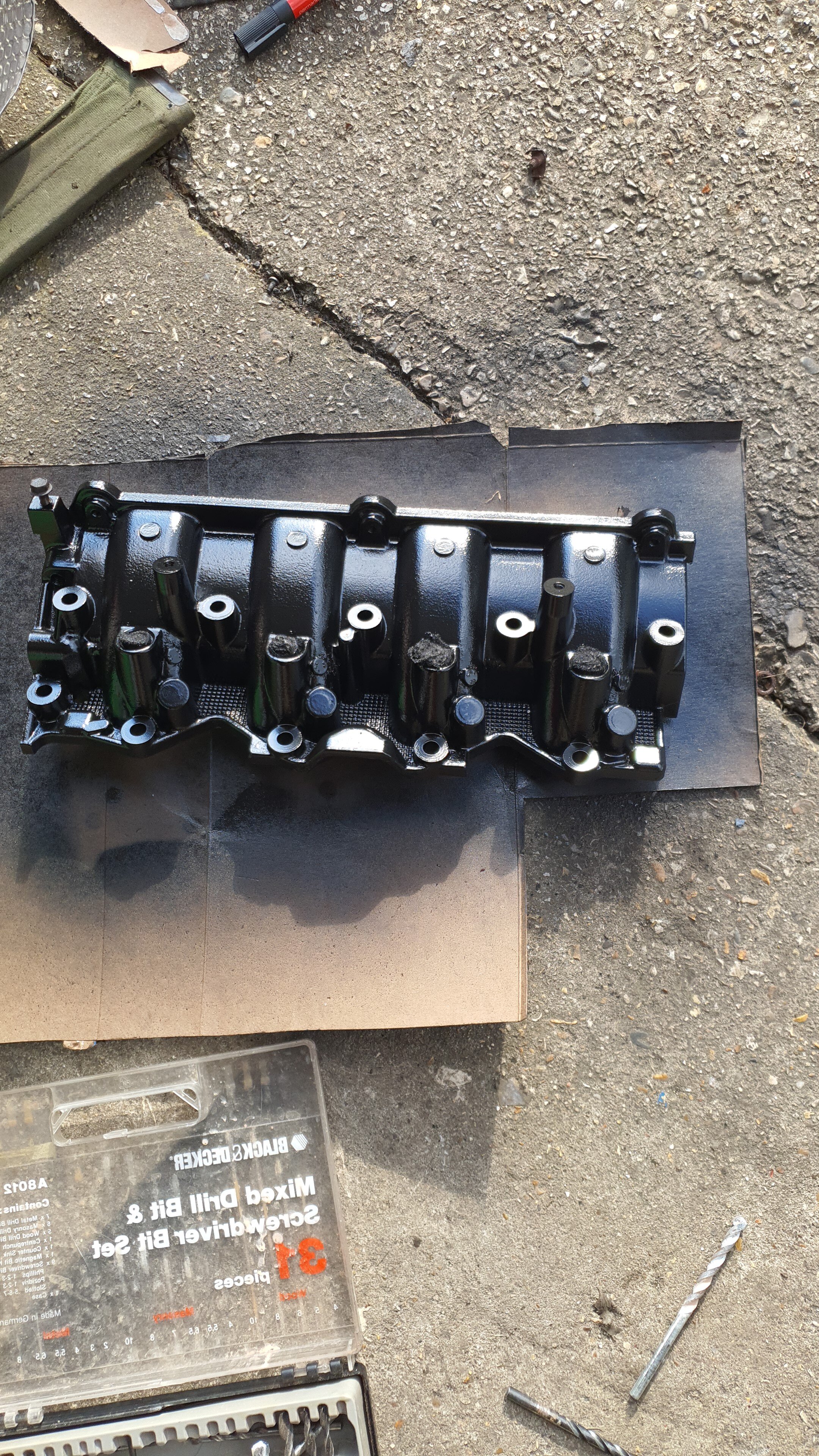

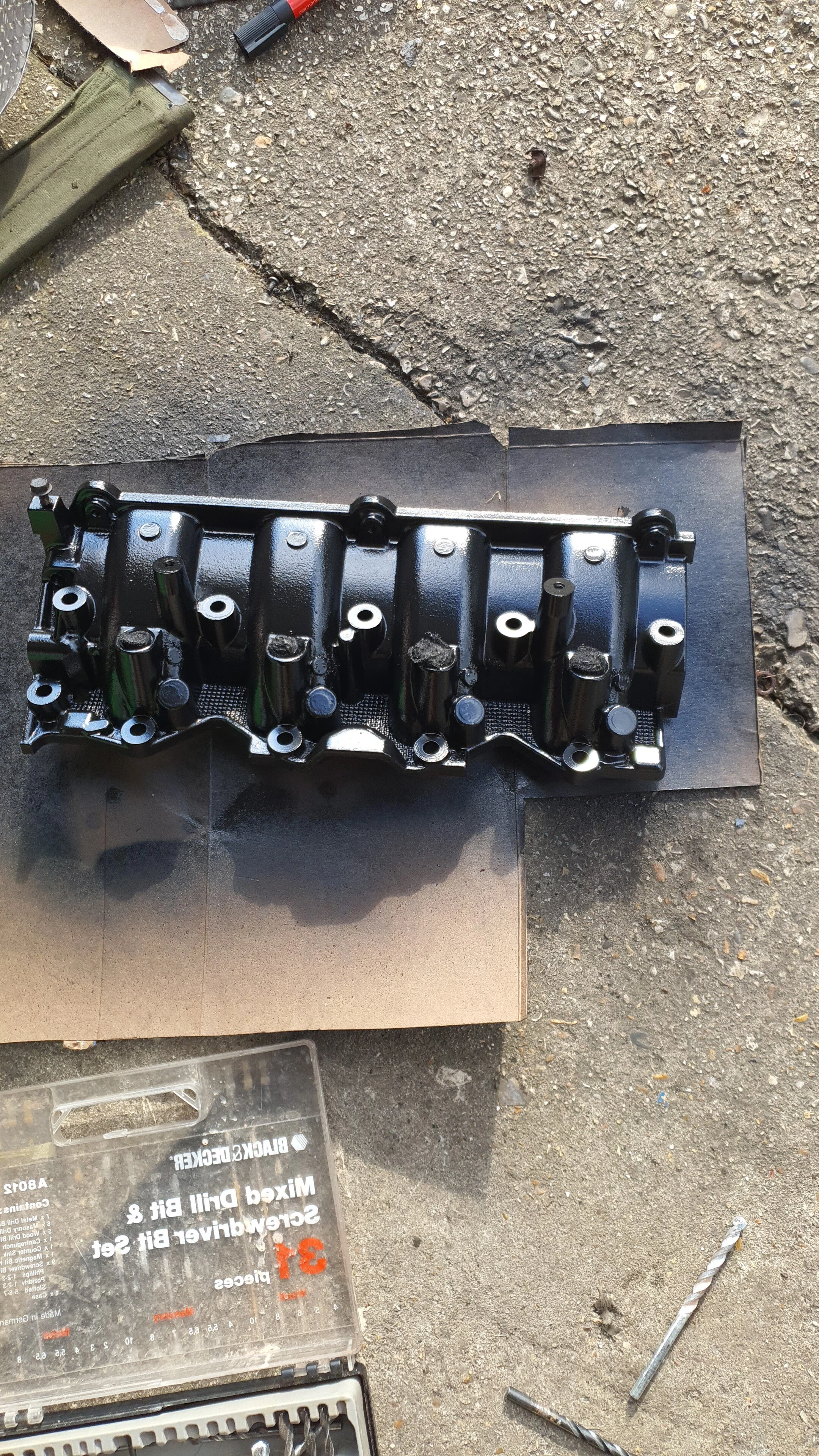

I also sprayed the intake maninwhike I was at it too. Looks good on the red rocker i think.
Cleaned up the mani with some acetate, then warmed it up a bit with a heat gun before putting a couple of coats of Hammerite matt black.
Quite happy with the results.

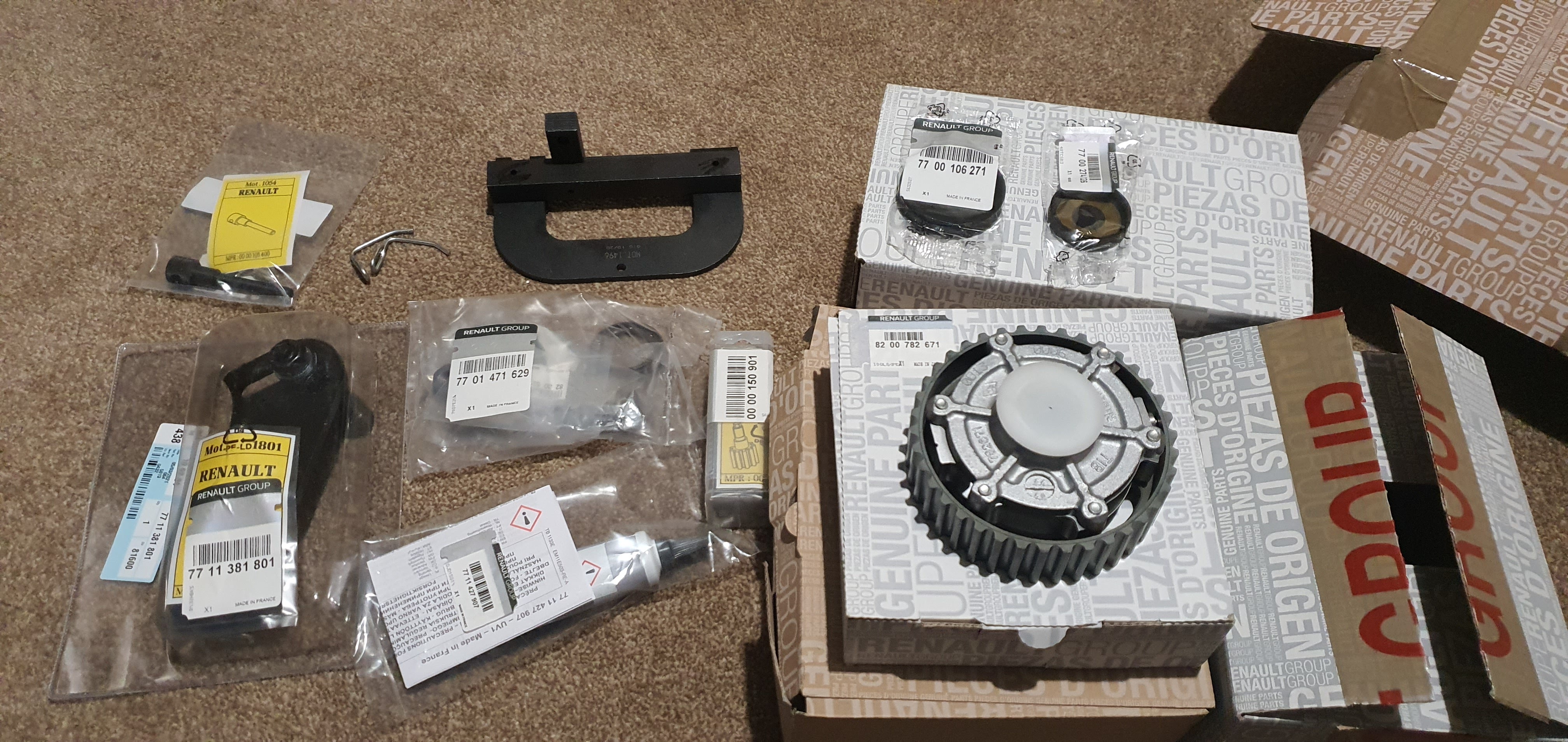

Probably cost me around the £2k mark all in, but that includes rebuilding the head, fitting a new Renault water pump, dephaser and belts etc, so worked out a lot cheaper than a drive in drive out service, and learnt lots in the process.
