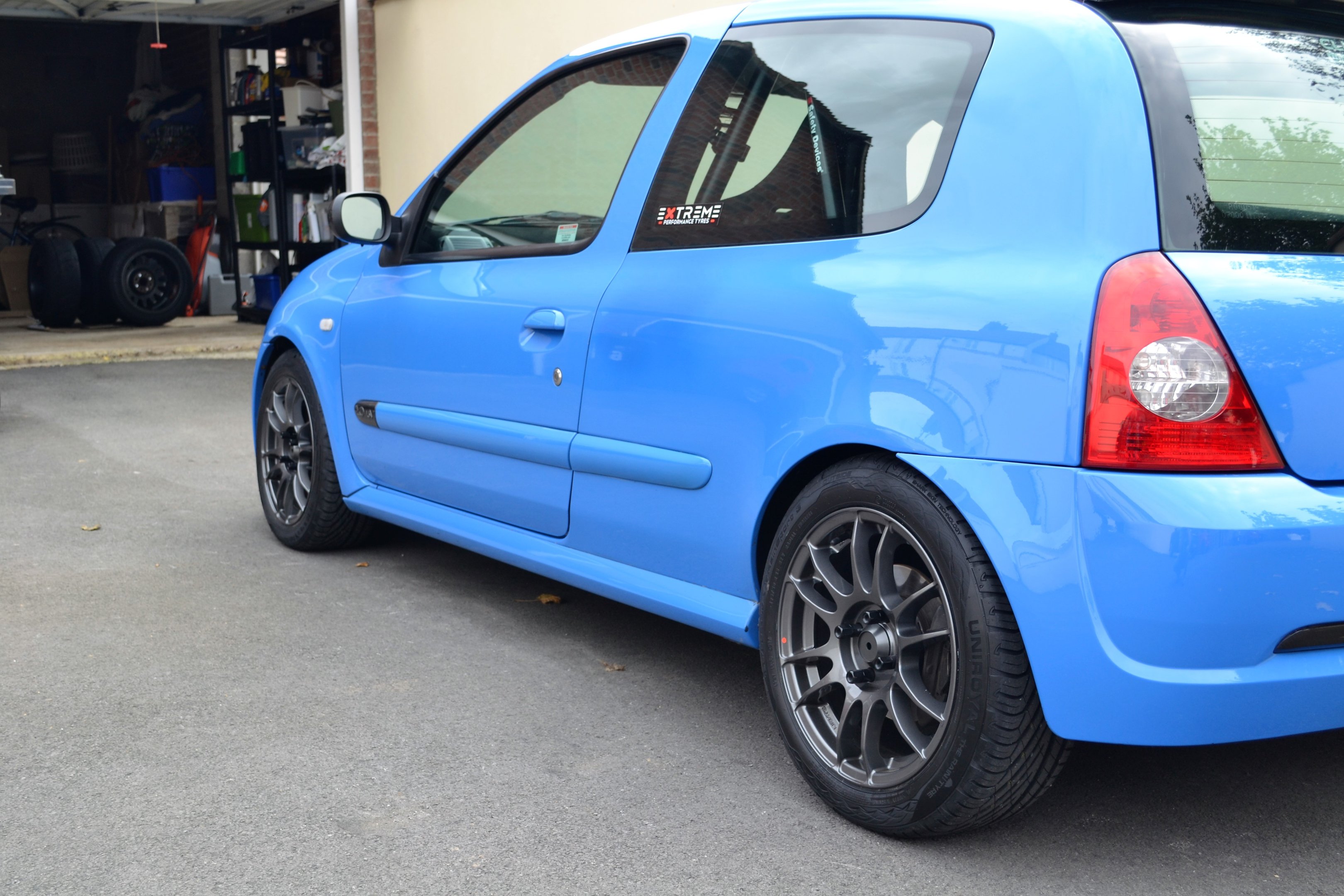

New wheels and tyres have been ordered. cheap wheels but as they are being used for track i didnt want to spend alot as they will get trashed im sure.
I went for the Calibre Suzuka in gun metal with some 195/50/15 Toyo R888, I was going to get the R888r as they are meant to be epic in the dry but as they are shocking in the wet i thought the R888 are the best alrounder.
Will take some pics the second they are fitted :cool:
Wheels look nice, r888s aren't great in the wet either BTW, OK in the damp, shite if there's puddles about. I only use mine on dry days now and have an old set of F1's with Rainsport 3's for wet days which are great for a mushy budget road tyre.

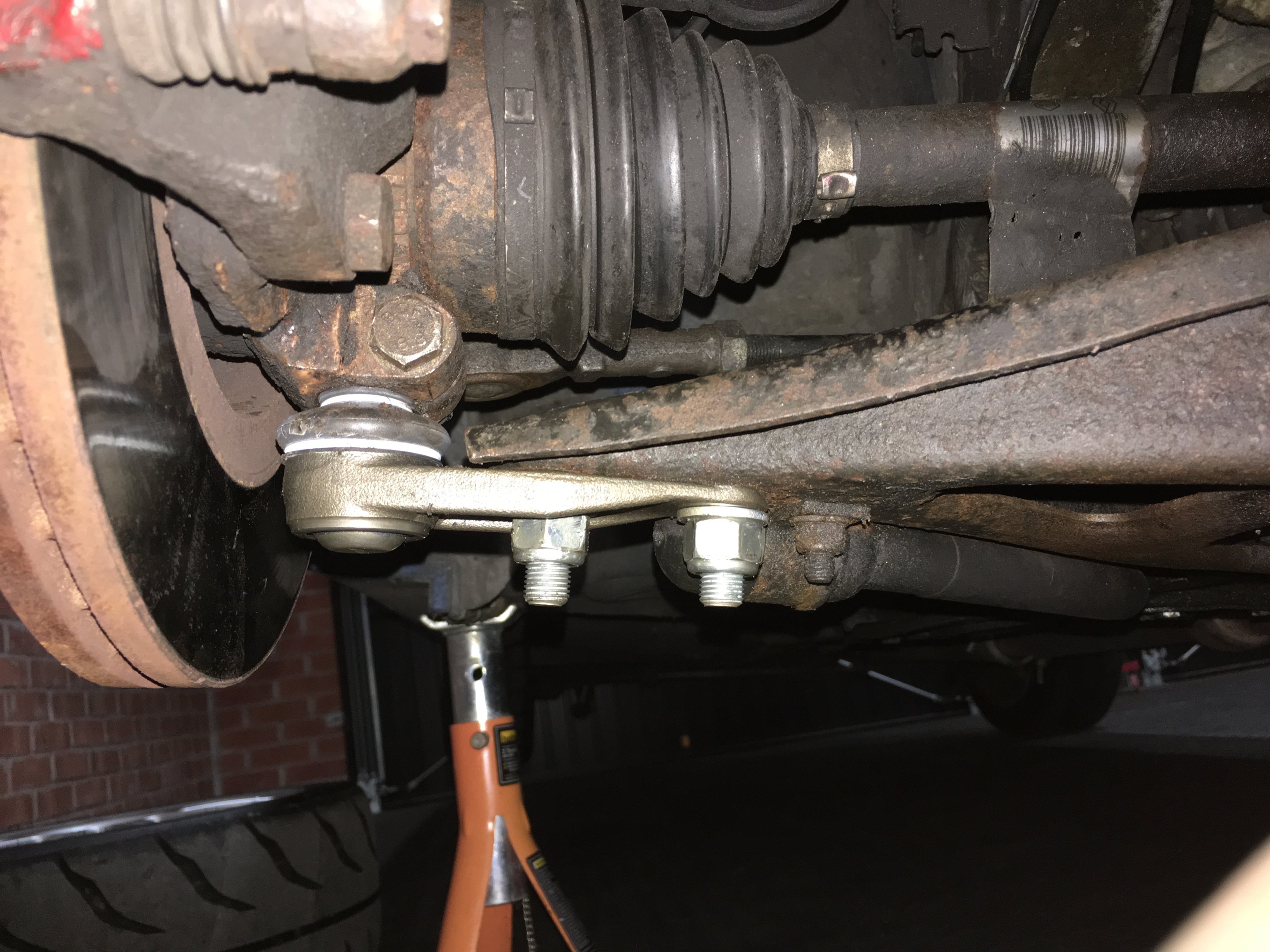

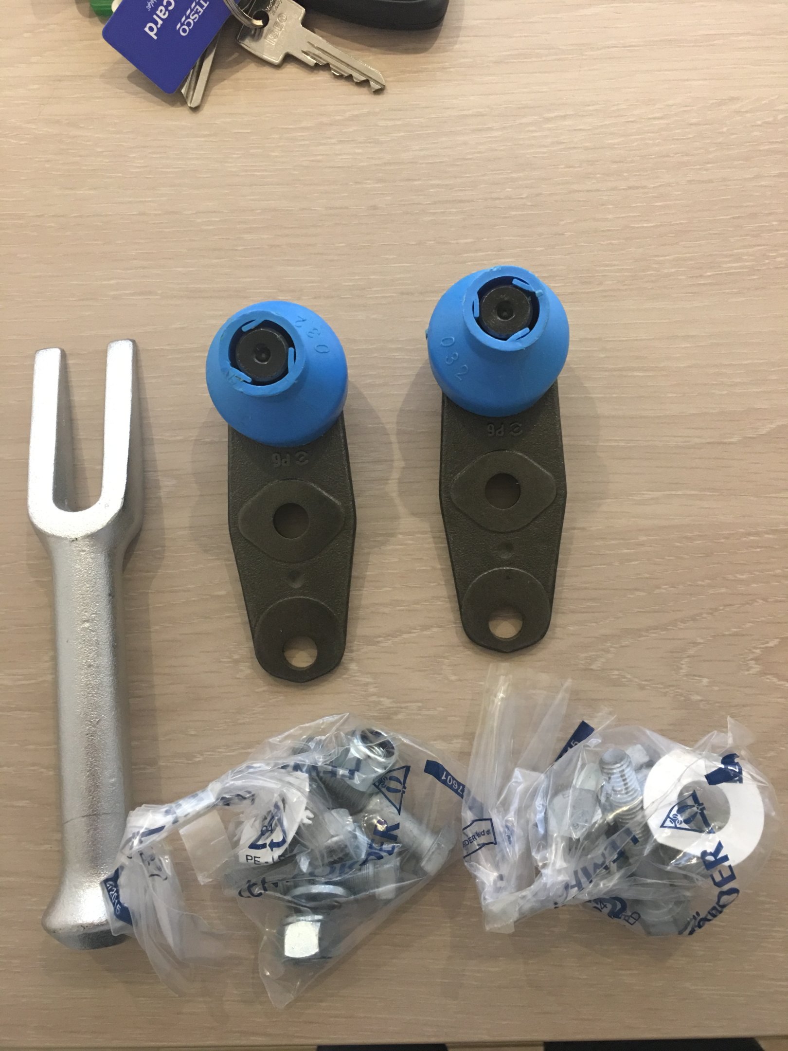

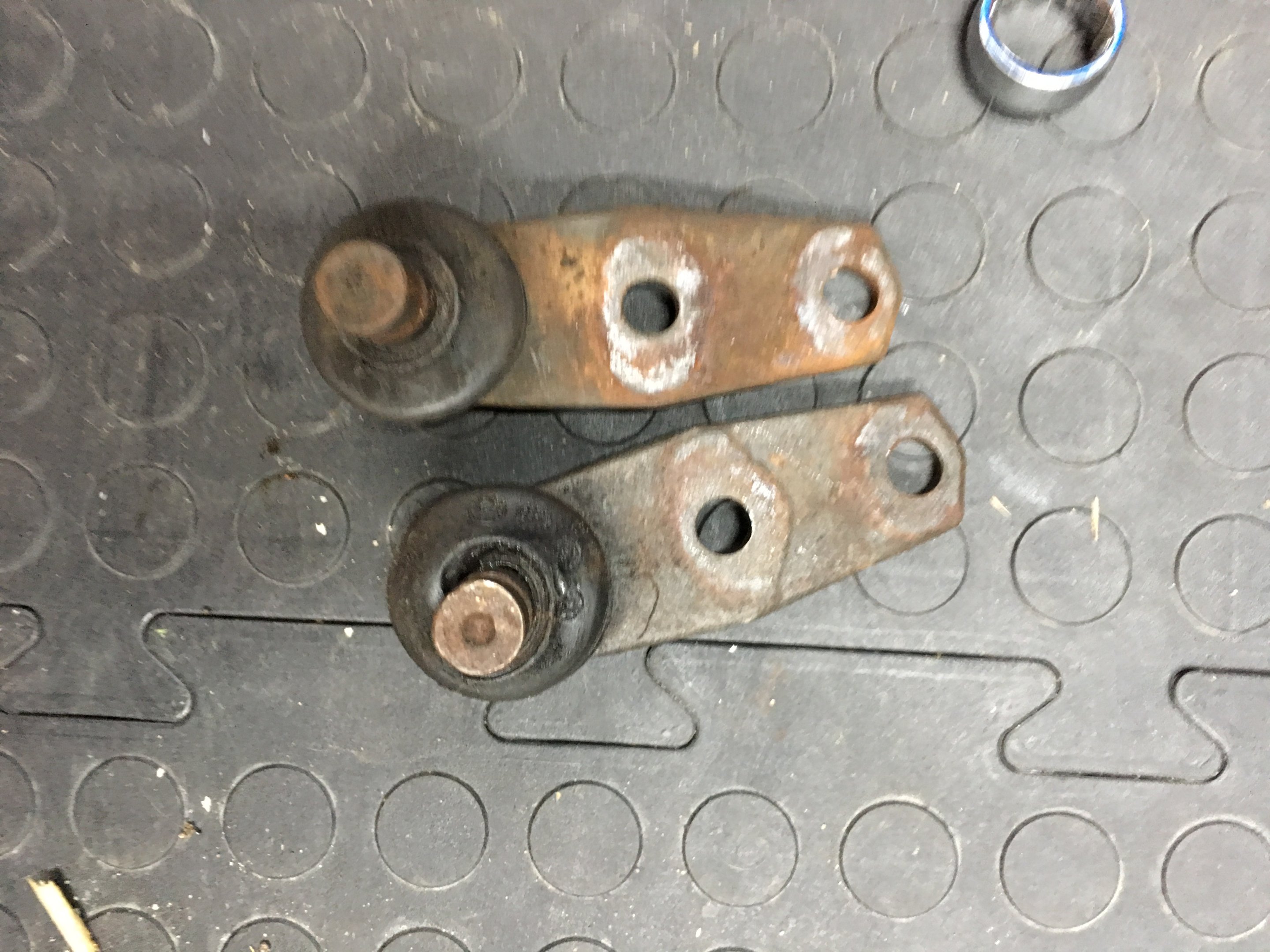

Busy evening. Had a few deliveries, some metal sprigot rings but no wheels grrr. :smile: Had a pair of lower ball joints arrive so thought I’d get them fitted. Hour and half later and viola.

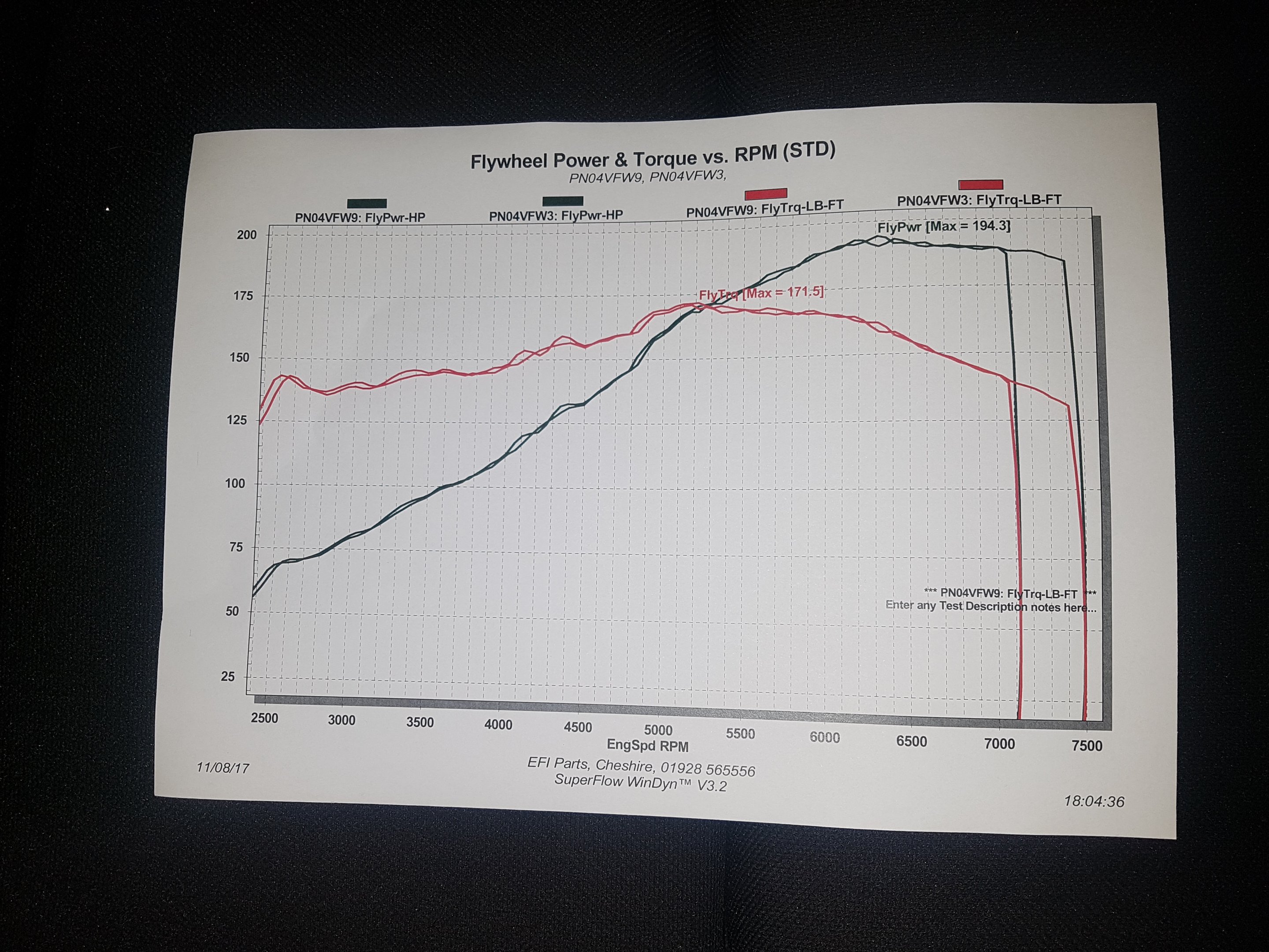

ed are good. we've been seeing comfortably over 190bhp and 170lb/ft torque. last one was 195bhp and 175lb/ft.
doing another that's going in on wednesday but that's on a phase 1 head so be interesting to see if there's any noticeable difference.
I'm looking forward to seeing my results Carl, I'm like a kid at Christmas :smile:

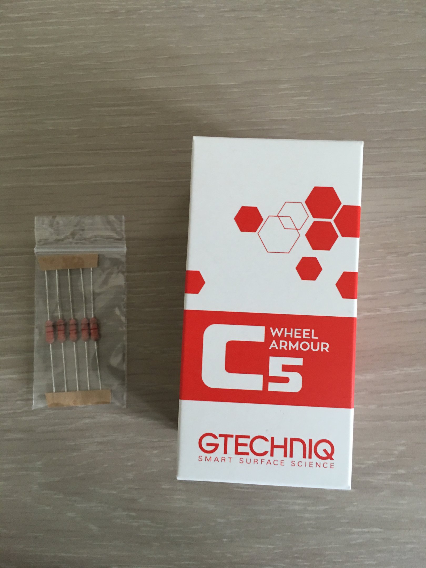

Couple of small bits arrived before work this morning.
Some 3.3ohm resisters to hopefully get rid of some of the lights on the dash.
Also some Gtechniq C5 for when the new wheels arrive. this stuff is unbelievable and will hopefully help in keeping brake dust from sticking to the wheels after a track day.

Dan @ SJM and Michael Woodford managed to crack 200bhp with those cams didnt they? all in the mapping it would seem.... or a healthy engine?

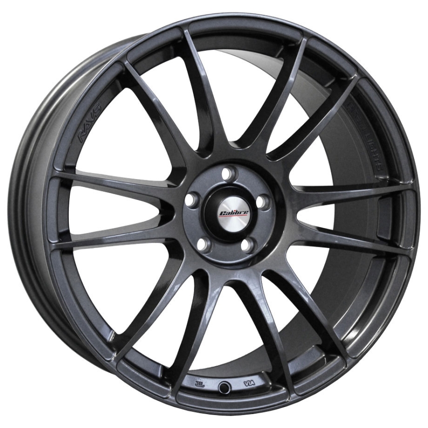

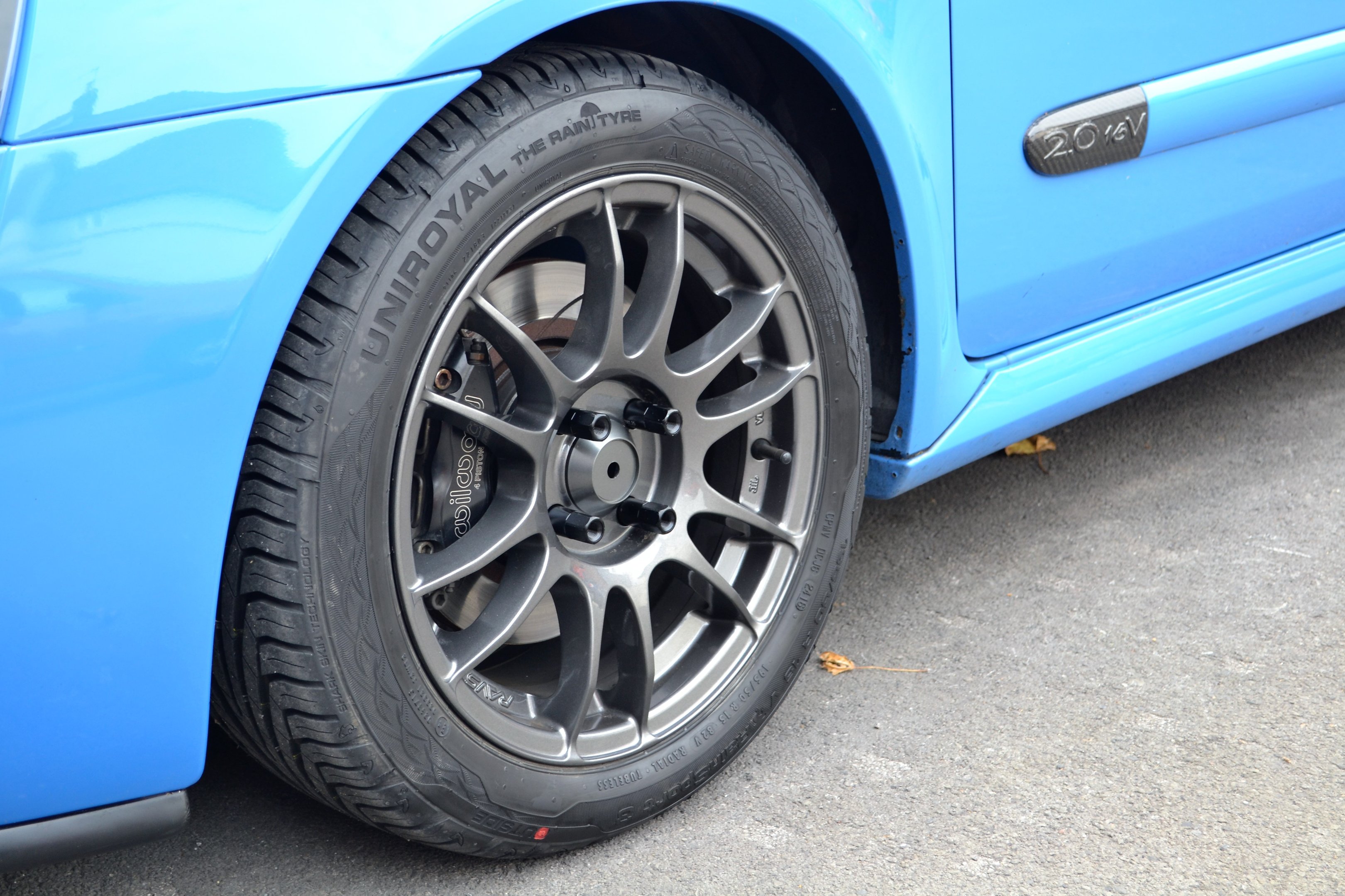

Re the wheels:
I put these on about 2 months ago - very pleased with them and they are lighter than 2118s.
I believe they are a clone of the 'Rays Gram Lights' which are very popular in the JDM market. Note that if you have a stud conversion you will need 'Tuner' nuts (as in pic).
Louis
I Park Like a C**t
Re the wheels:
I believe they are a clone of the 'Rays Gram Lights' which are very popular in the JDM market. Note that if you have a stud conversion you will need 'Tuner' bolts (as in pic).
What are those centre caps buddy?
  ford fiesta 2004
Re the wheels:
Graham huge thanks for the pic. Anymore of the whole car then please share. No stud conversion so they should be good. I took a bit of a punt on the wheels thinking there link the 2118s so should look good. Hadn’t realise they were lighter so bonus.

Also after you’ve all made me paranoid I spoke to Andy at ed. He confirmed that the they replaced the cam and a map to suit, with the modifications 186bhp is about right.
Car runs very well so I’m quite happy. Not looking to increase its power I want it to be as reliable on track as possible :blush:

Car looks great looking forward to seeing how you get on with those Calibre wheels. I was tempted with a set recently but heard a rumour the bolt holes are too small for the Clio and they require machining to fit :grin:
Re the size of the bolt holes ..... yes, I think they may be smaller than standard but they do come with a set of new wheel bolts that match the wheels. I exchanged my new bolts for a set of 'Tuner' nuts as I already had studs fitted.
  Clio 182
Yeah I've heard they are ok with a stud and nut conversion but if you have the standard setup it's a problem. Great looking wheels though and really good value!

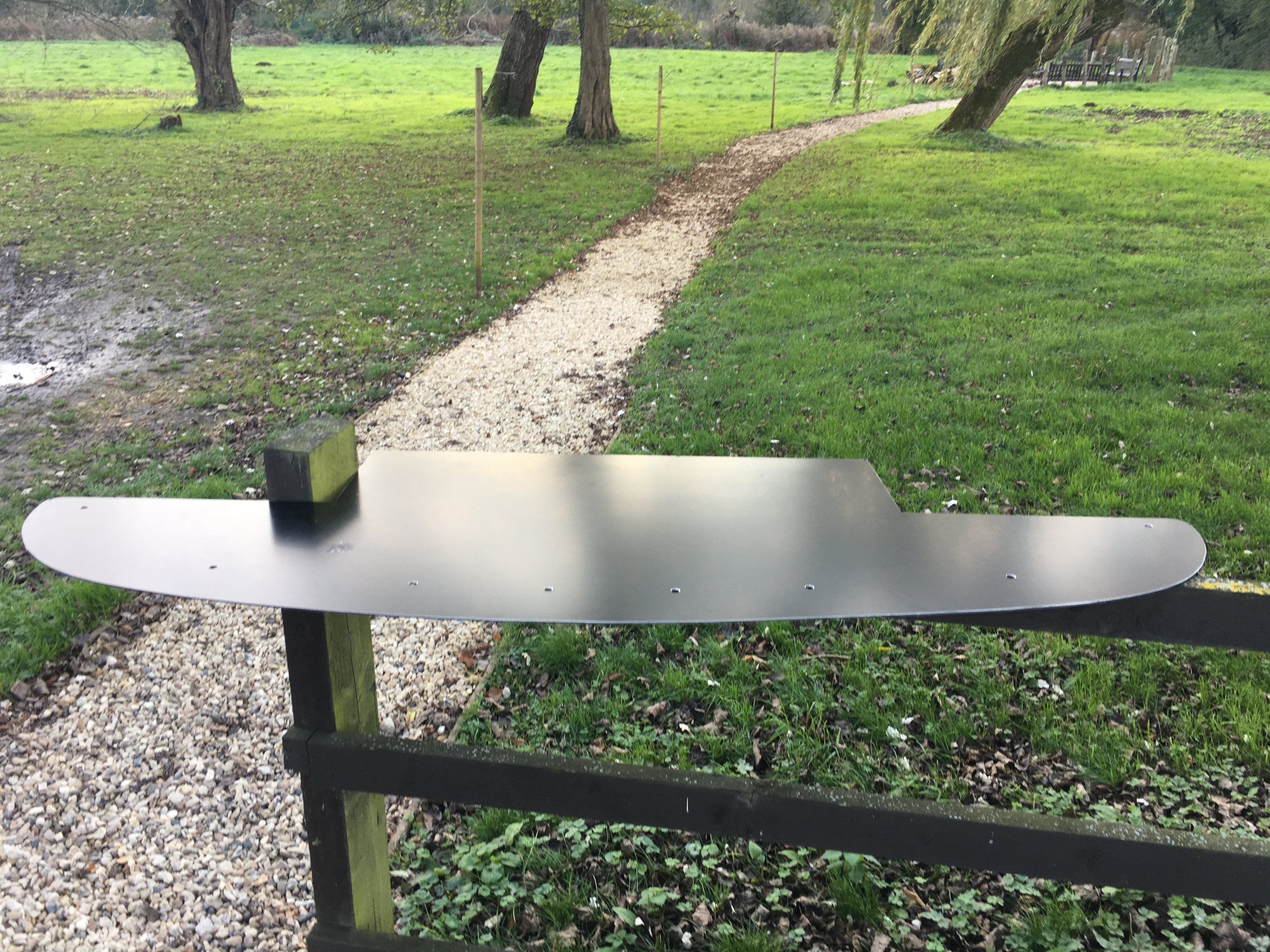

Picked up a second hand but brand new CMC splitter. Should help with making the car more aggressive looking :smile:
Ordered some splitter supports as well.
Cant wait to get this and the wheels fitted.
