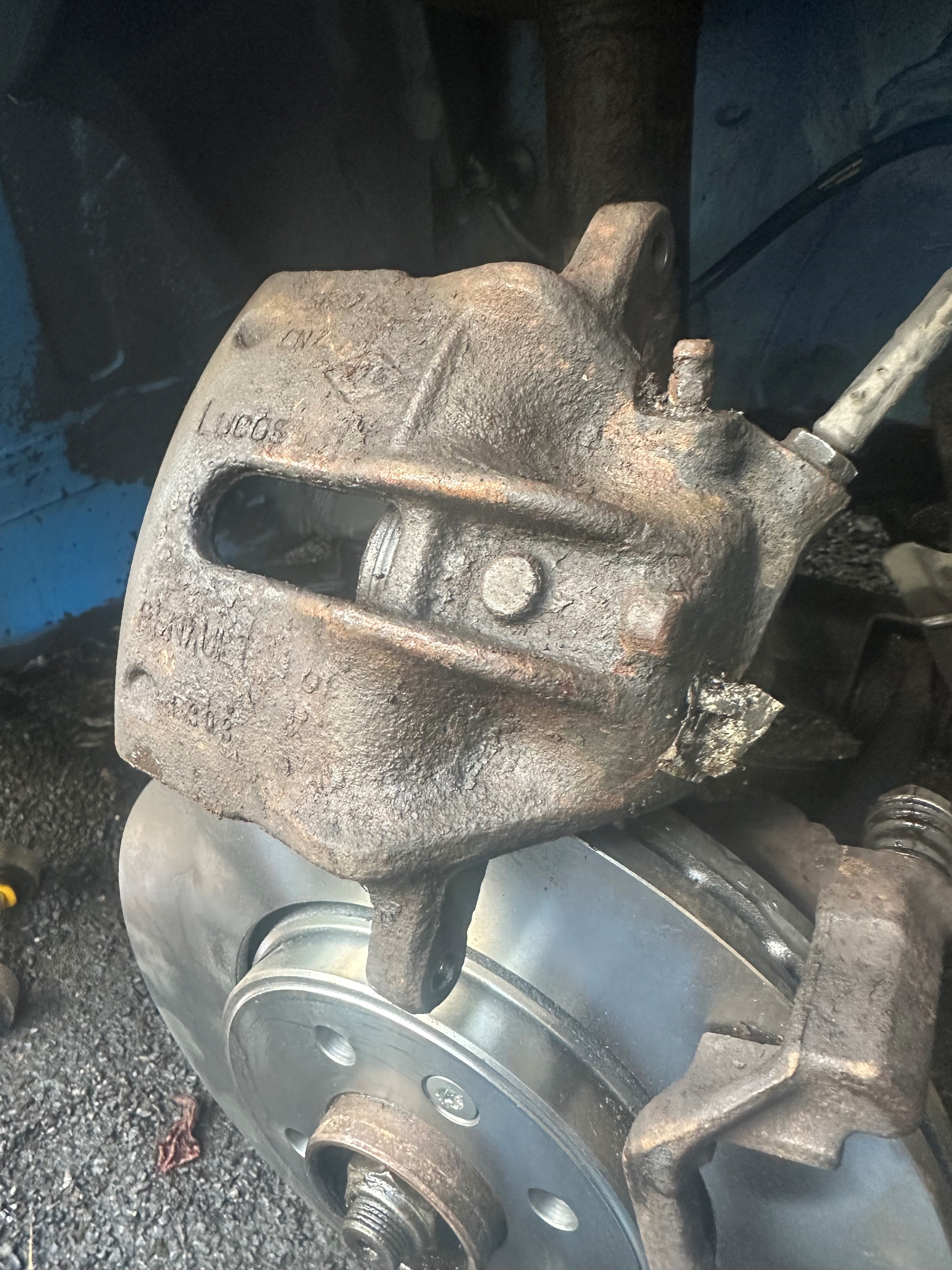

Changed my discs and pads today due to a sticking front caliper. Turned out the piston on one of them was totally seized, and also the bleed nipple was almost rusted away. Bought 2 new Pagid calipers from Autodoc and proceeded to swap them over only to find the mounting holes / brackets to the carrier are wayy too short!
I have attached a photo of my caliper - do they look standard? All of the parts I am finding online have a shorter mounting brackets. Is it the case that the Cup has different front calipers / carrier brackets?

All genuine callipers are the same afaik.
The 182 cups have just different hub bolt spacing for the shockers.

You probably bought the wrong calipers, parts listed in autodoc ar not always compatible, you have to double check.
But tbh, I would rebuild the old calipers with new pistons and seals plus bleed nipples. The seized nipple you have there might be removed with some serious heat on it. Not impossible

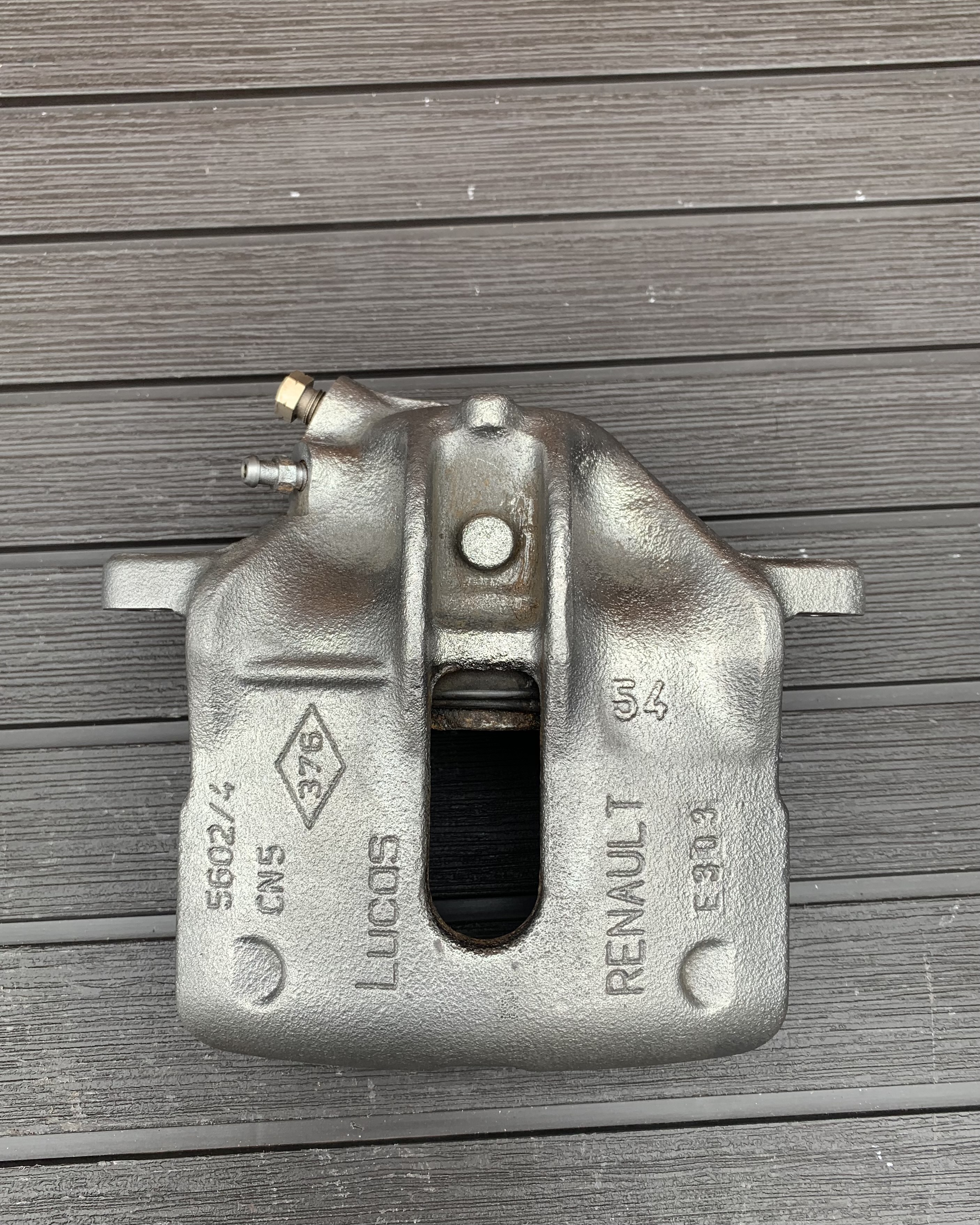

The one in your post is correct. Here’s a pic of some spares I have to compare numbers.
Genuine part number and OEM numbers are as follows:
RH Front Caliper - P/N (7701205833) - OEM Mfr. TRW-Lucas P/N (BHW242)
LH Front Caliper - P/N (7701205832) - OEM Mfr. TRW-Lucas P/N (BHW241
