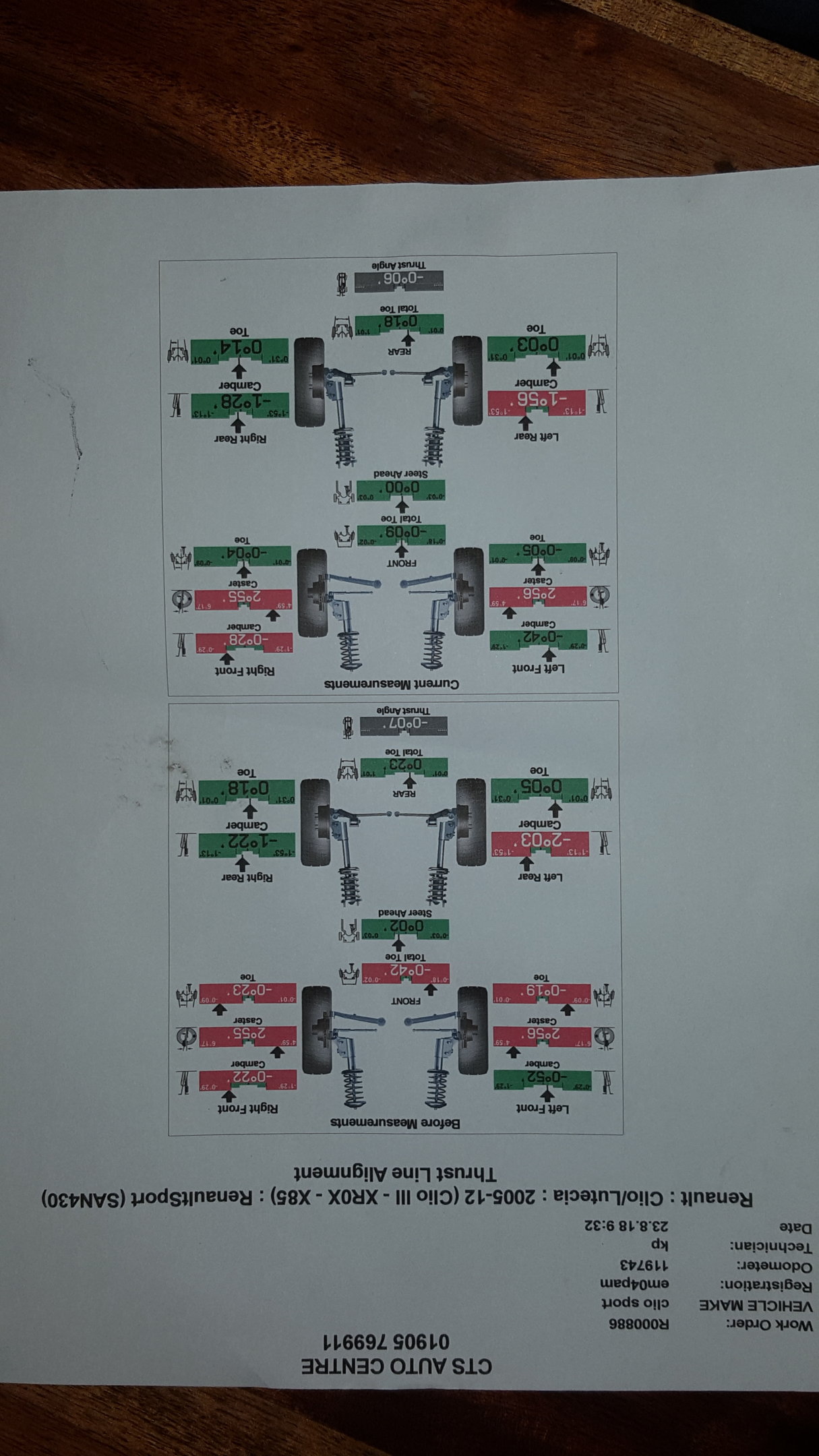

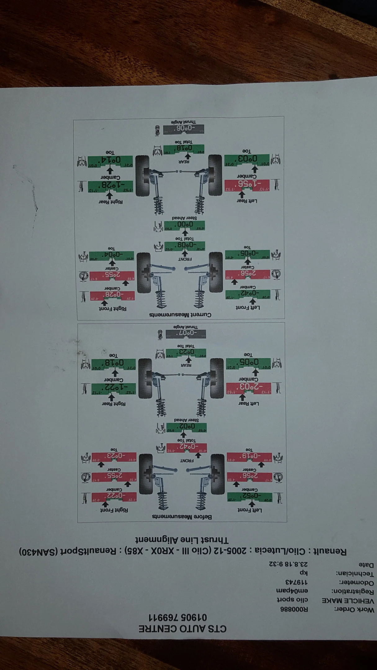

Attached is the hunter tracking I had carried out following work - I'll probably create a separate post for this regarding rear end.
