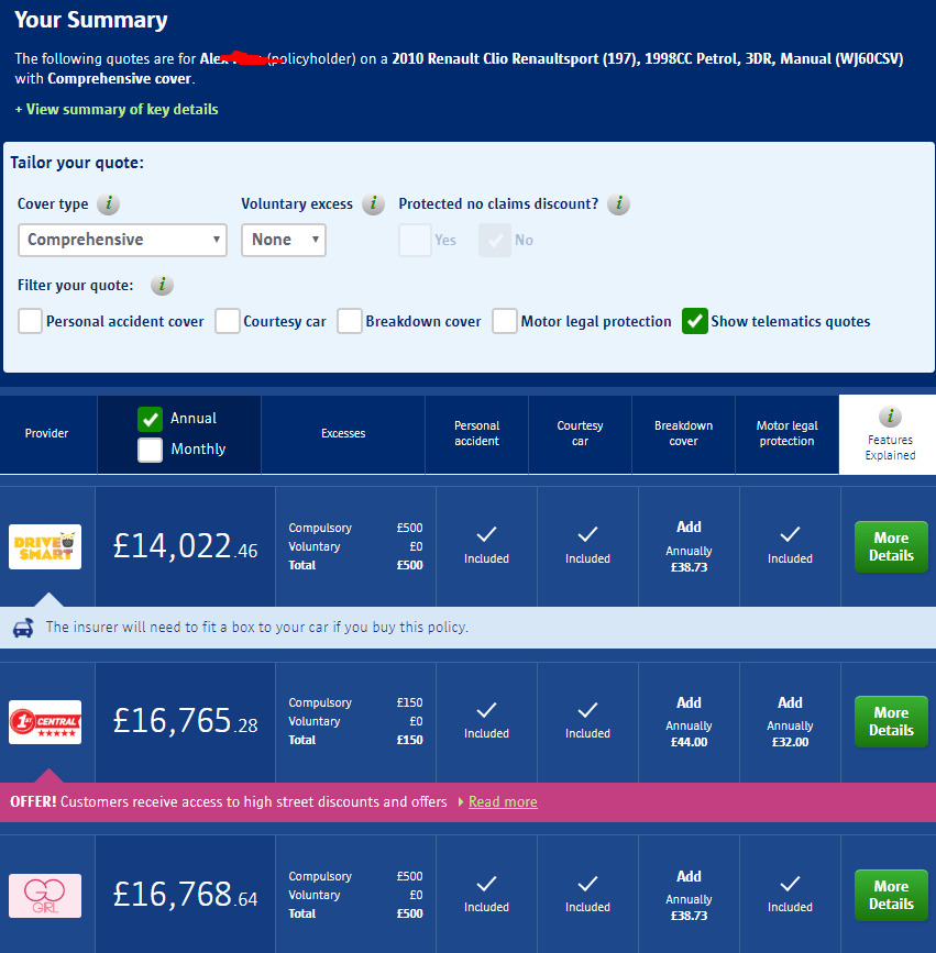

True, My brother has a 2.0l Ford and he rear ended me trying to "drift" its a front wheel drive keep that in mind but im wanting to drop around £5-6k on it to get it up to date and modify it. I don't know anything about the mechanical/electrical side of the car i just know how to drive it. :ROFLMAO:

FCUKING LOL at spending £6k to get half of a £1500 car from 2002, which will be out-dragged by most diesels.
£14k for insurance... Are you 11 ?

By the time you've finished fcuking about getting some frankenstien piece of junk to work, you'll be 21 and insurance will be sub 4-figs with a decent specialist for a regular 172.
Have a look on here how often it's a) easy, b) cheap c) actually ever finished with no issues.
If someone had given you a 172 which had been rear-ended, and you were handy with the spanners.... it maaaaay almost be worth a laugh to put it all into the 1.2 shell, but honestly it's just such a waste of time and cash.
As above, get some quotes for your psuedo-172 and just go buy some beer instead.

90% of insurance companies probably won't even cover it, the rest will be 16K or something equally silly.
How do you plan on doing the conversion in the first place then??
Not gonna be Insured on that gonna be using it as a track car possibly or end of my 1st year get it all done then get quoted
