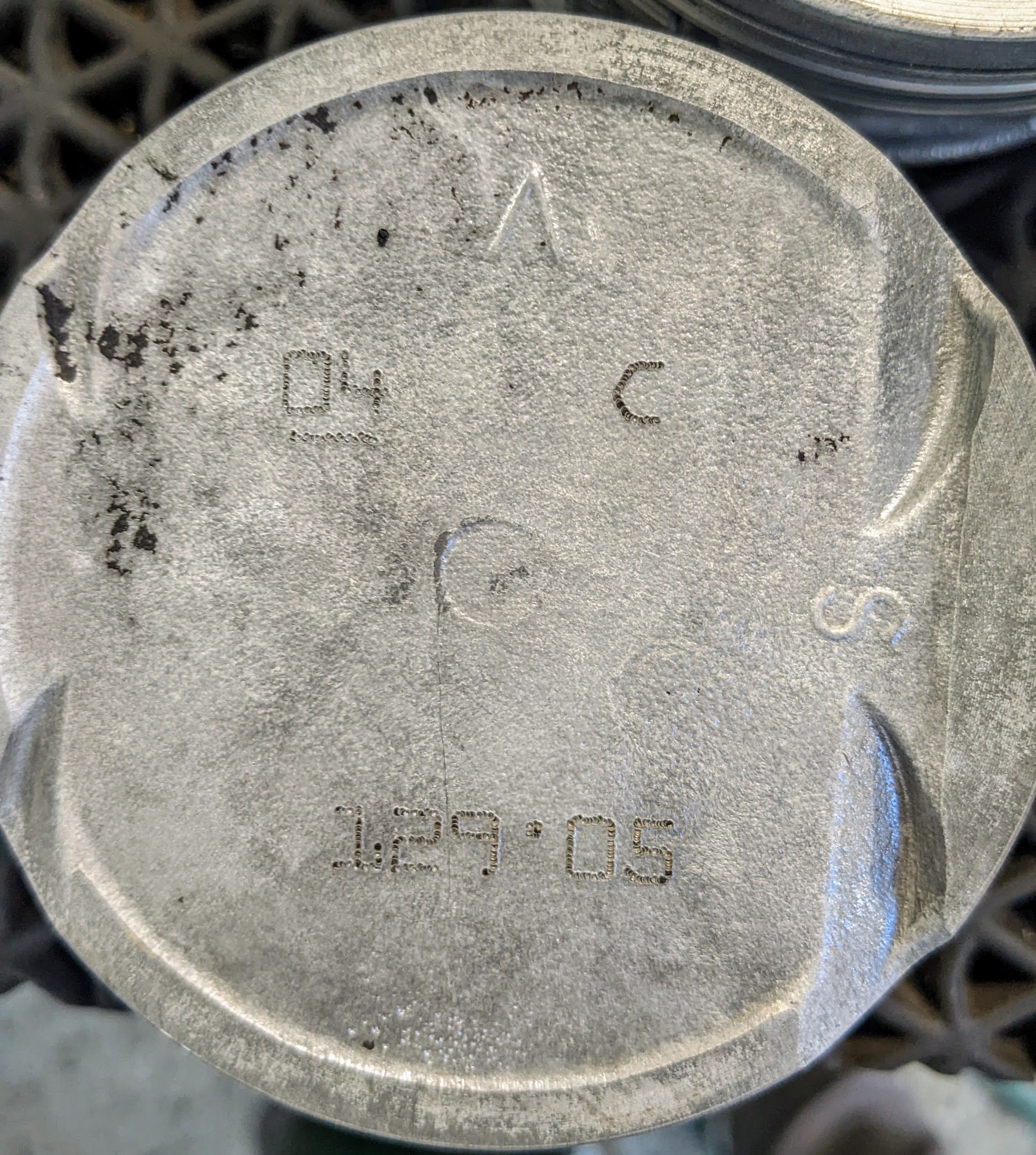

Decided to rebuild an engine of my Clio 182.
- decided for Schrick cams as my old original warn out too much and to replace with OEM or Kolbenschmidt not interesting.
Mechanic surprised me with micro cracks in two pistons so pistons need as well. Do not consider forged so wanted to go with OEM but here is the catch... RENAULT EUROPE does not produce them anymore. It is not an option to order from dealership. In my case it is East Europe.

2. And following question regarding to picture attached. As far as I understand these are Type-C pistons du to symbol "C" on piston. I just can not figured out what means those numbers: 129.05? Asking as three of the pistons have numbers 129.05 and one 175.05. Do not know whether it is important information for choosing correct pistons.
