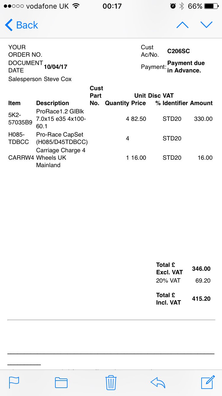

I bought these from Rinstock a month ago or so. £330 delivered, I spoke to Steve Cox.

When I phoned up I said that someone had already offered them to me at £330, he then must have applied the max discount available because he agreed with my figure saying it was £331.20.

I just spoke to rimstock. They can match that price earlier in the thread.

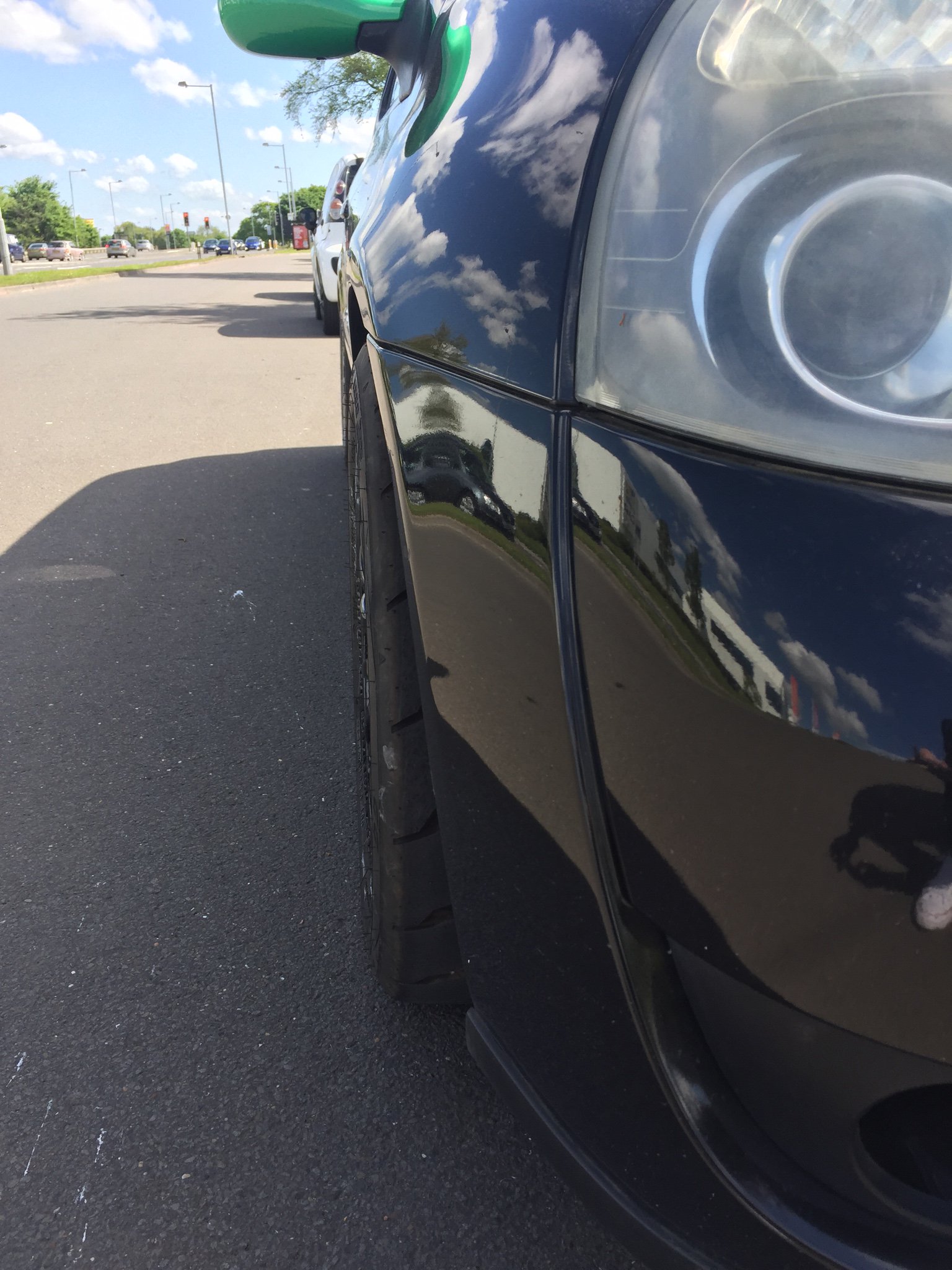

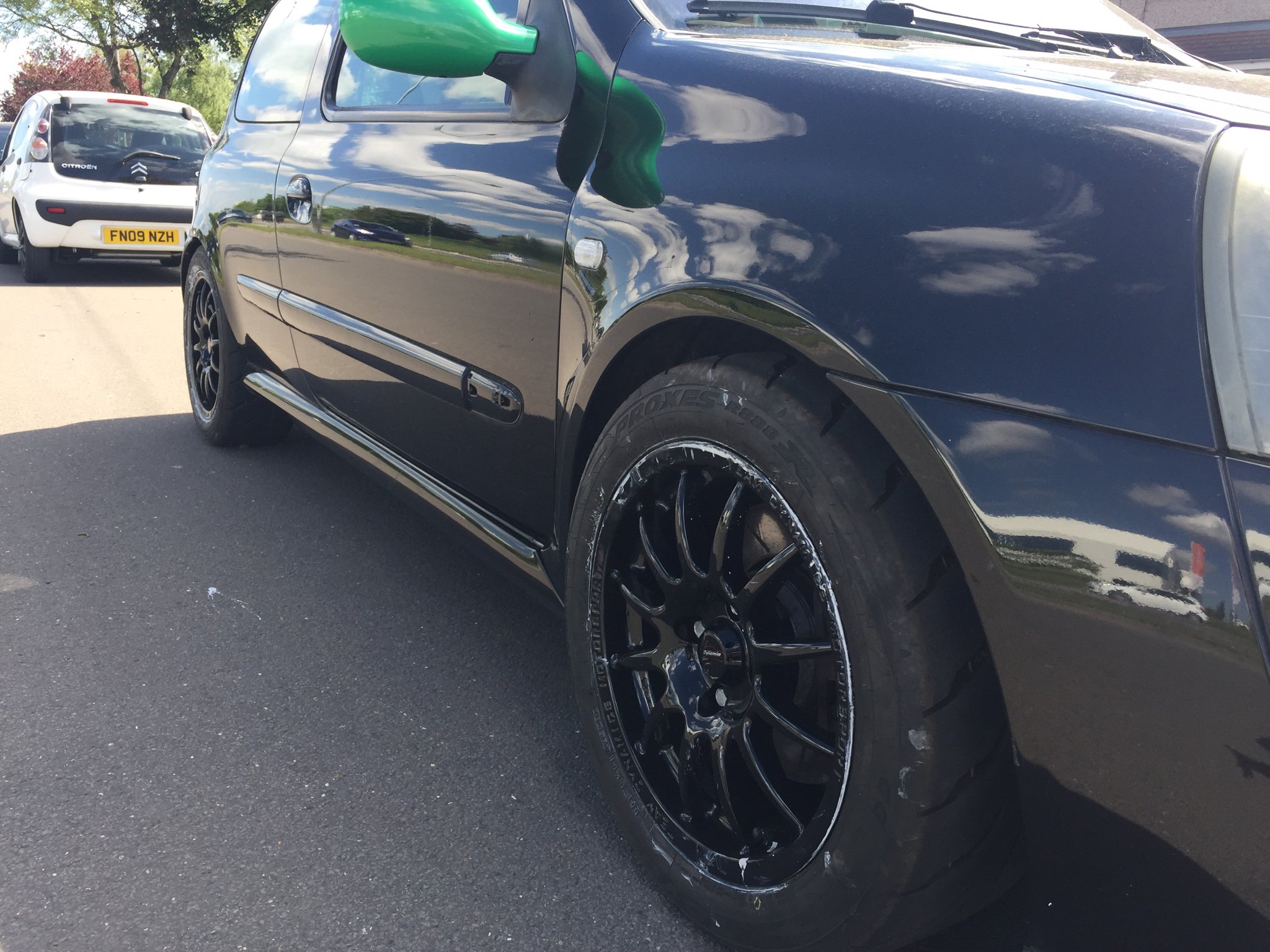

Got fitted today currently left spacers on tho as stud conversion goes on today sticks out a little I thing but worried when remove spacers will sit in to far
