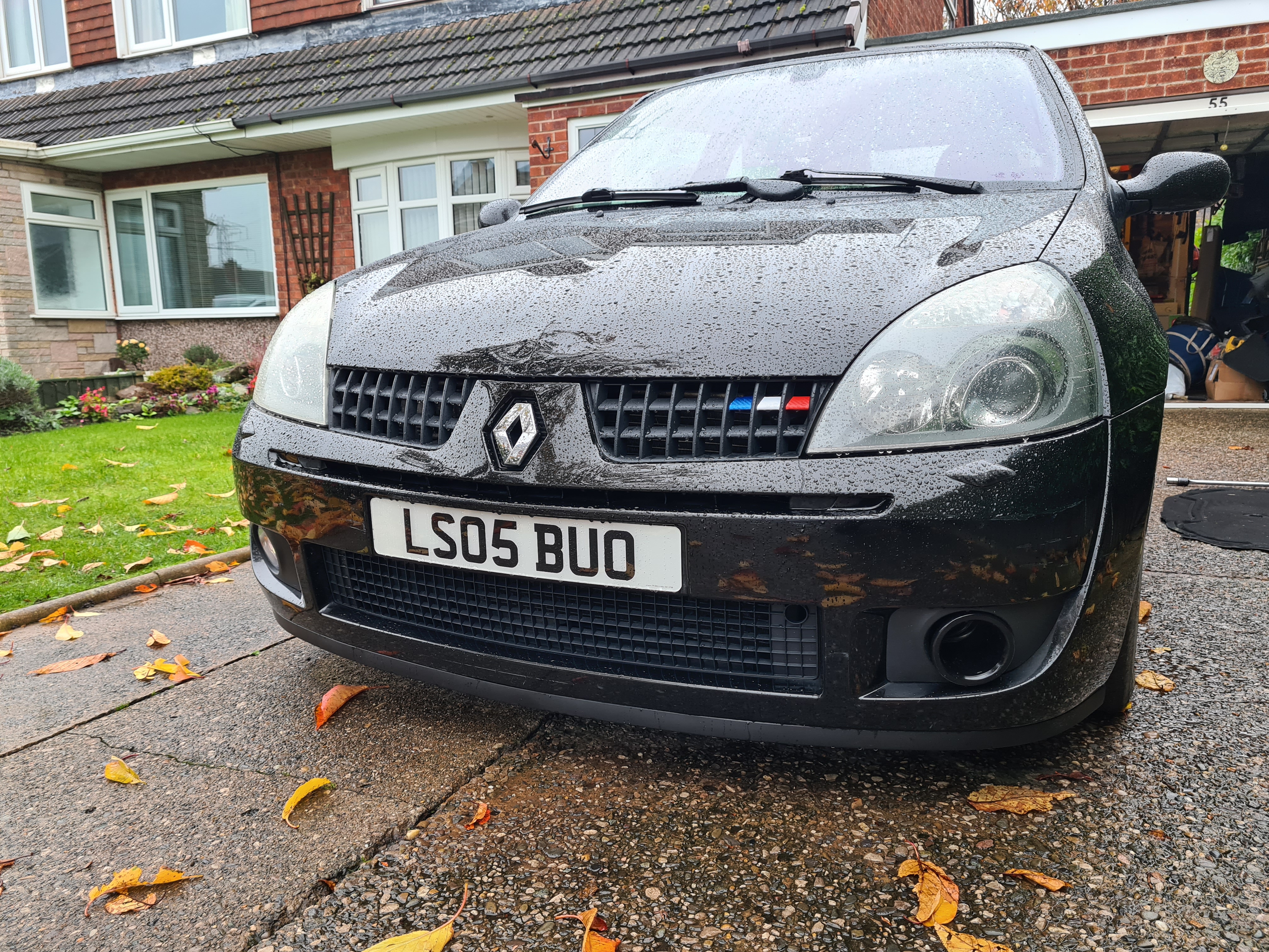

Those grills and fog light surrounds had too be sorted as they made the car look tired (also the scuttle and wiper arms) so after trying some c4 trim restorer and deciding it was too far gone decided to get them painted along with fitting a skoda splitter, a 3/4 front plate and sorting that silver intake out

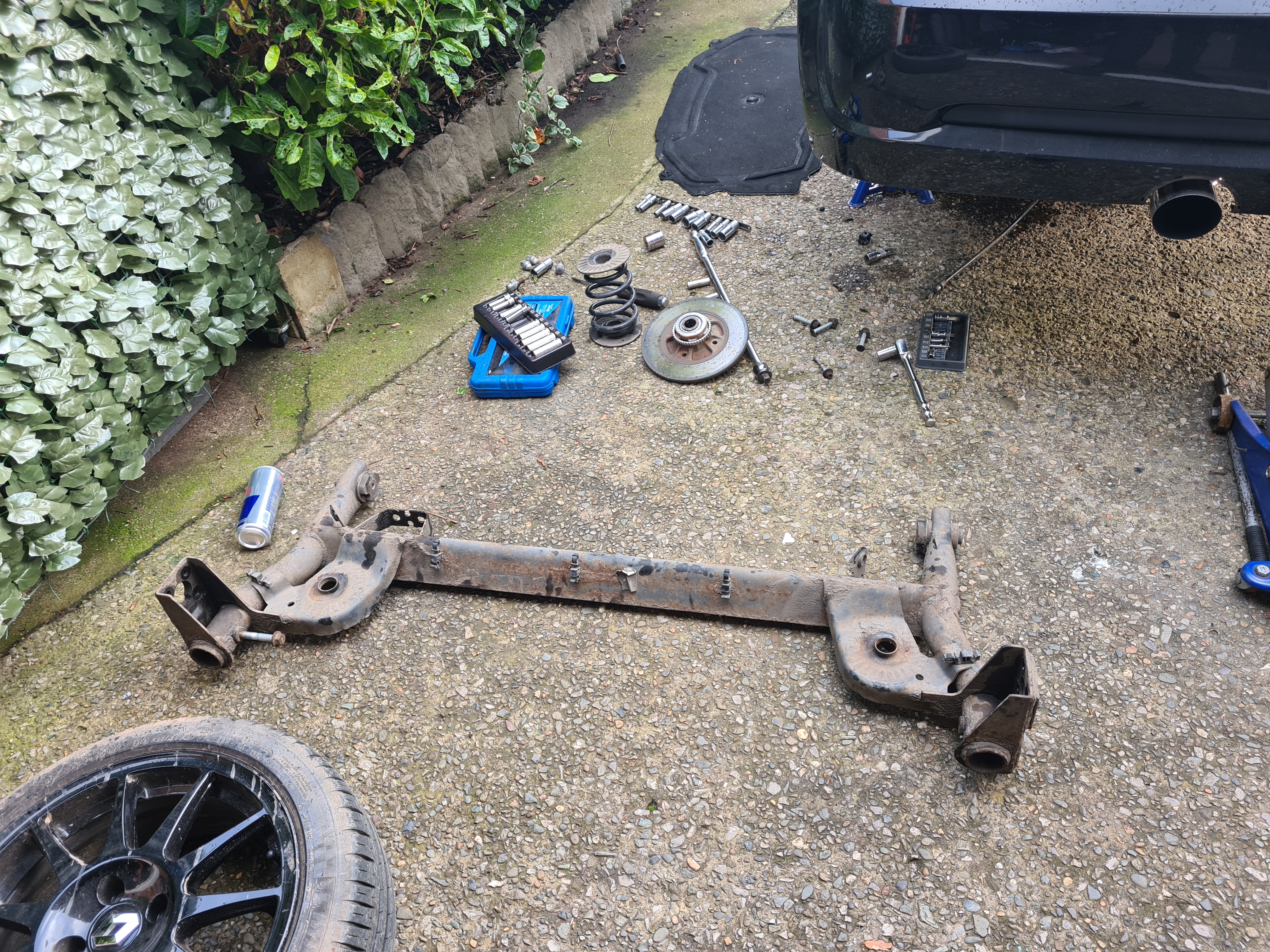

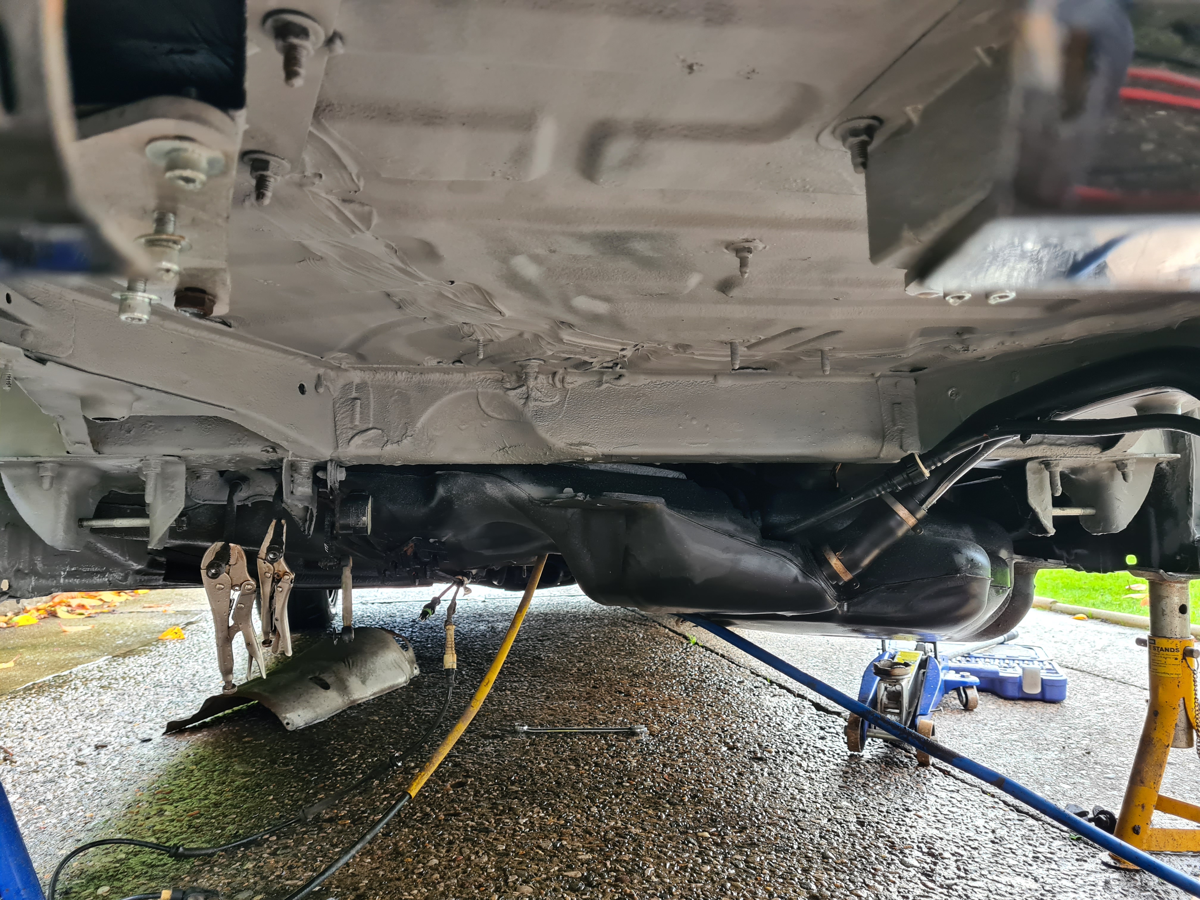

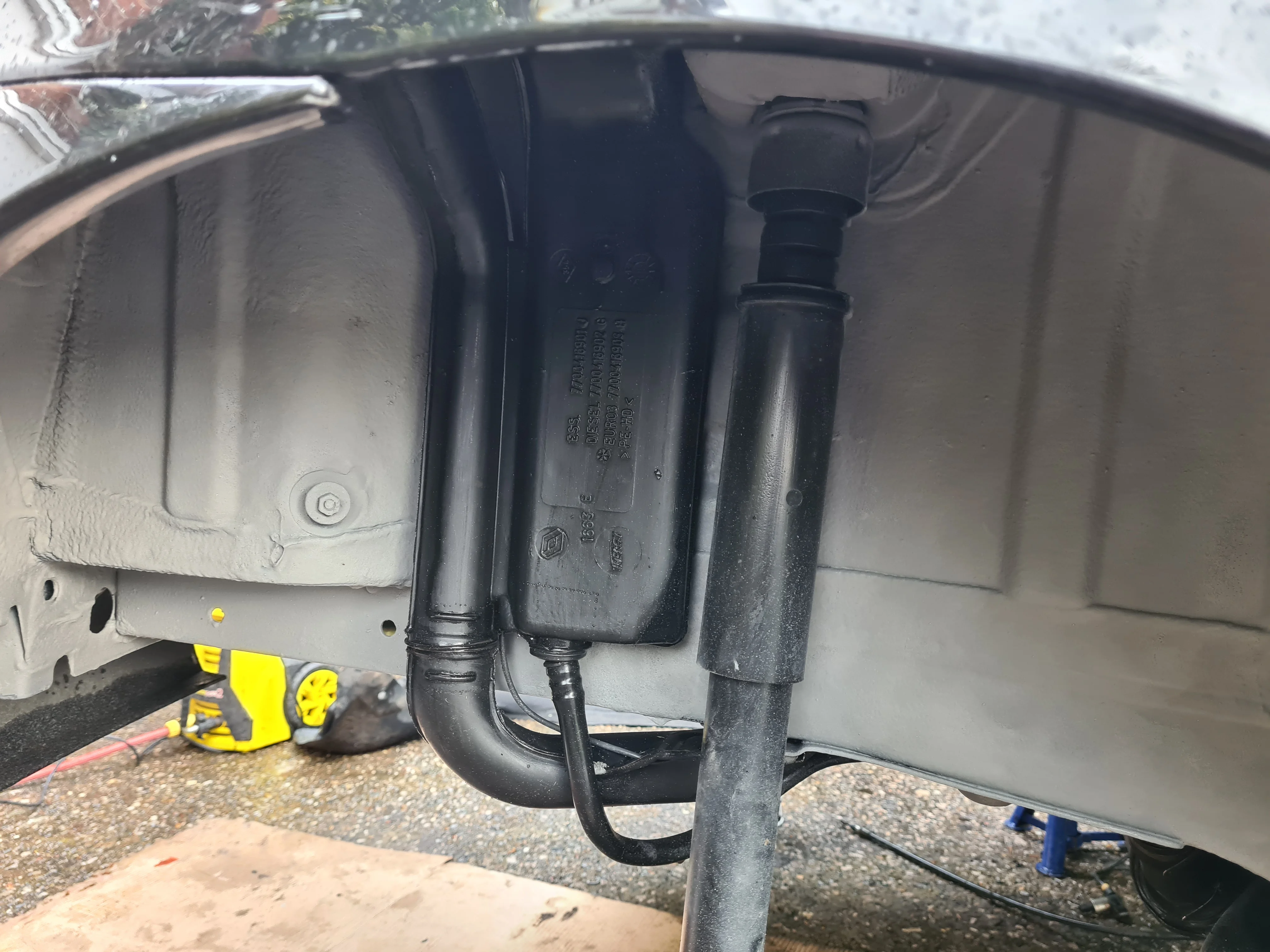

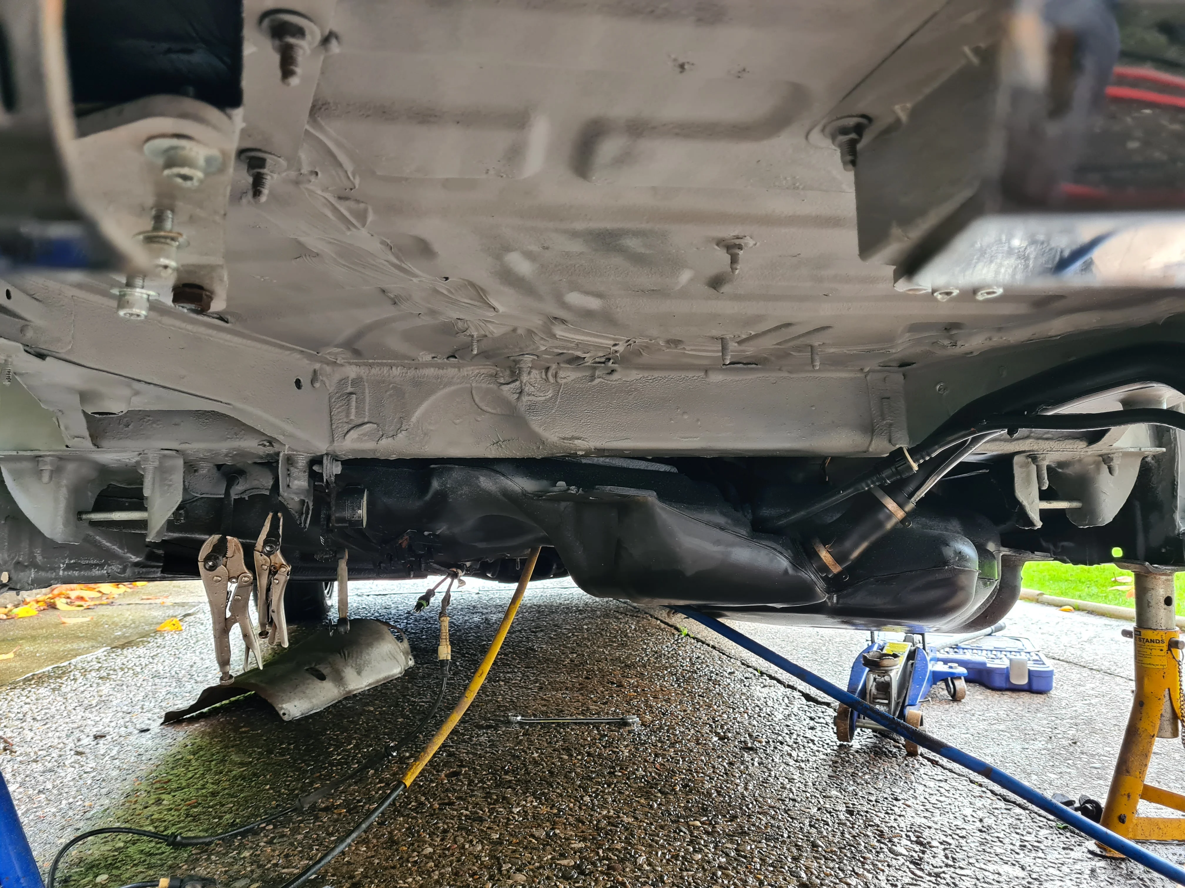

I started onto the rear of the car as suspension wise it just felt a bit worse for wear. So i decided to remove the rear beam

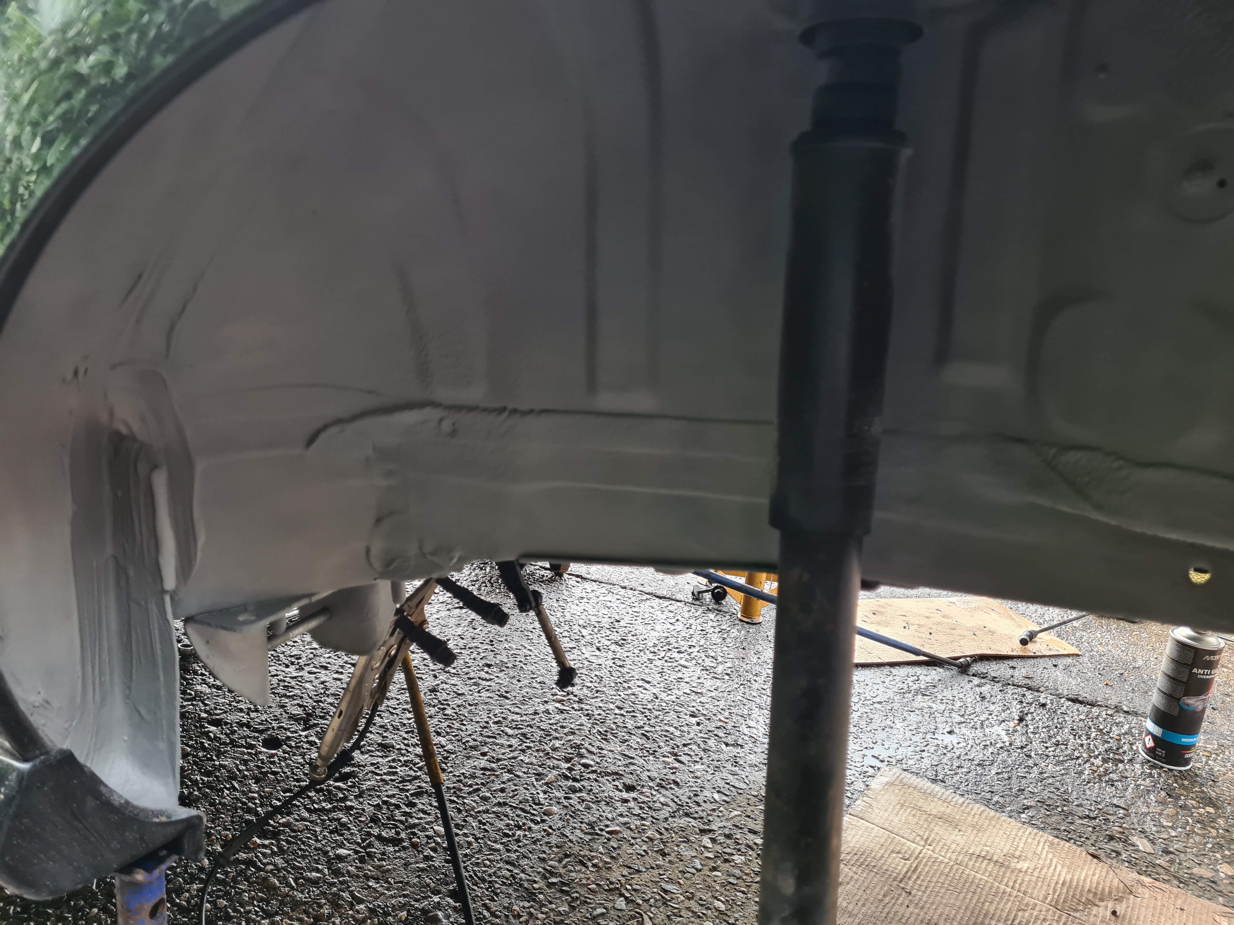

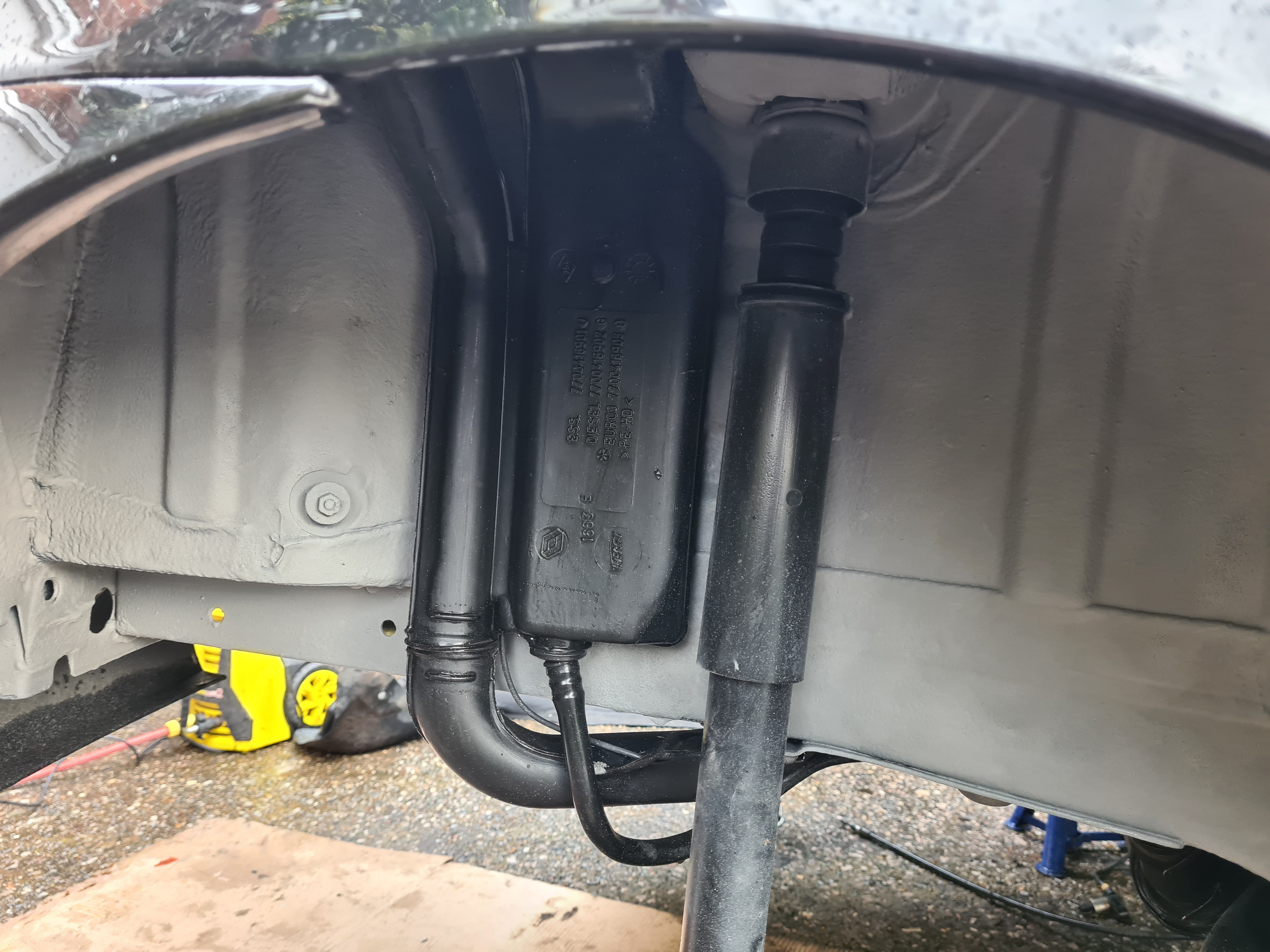

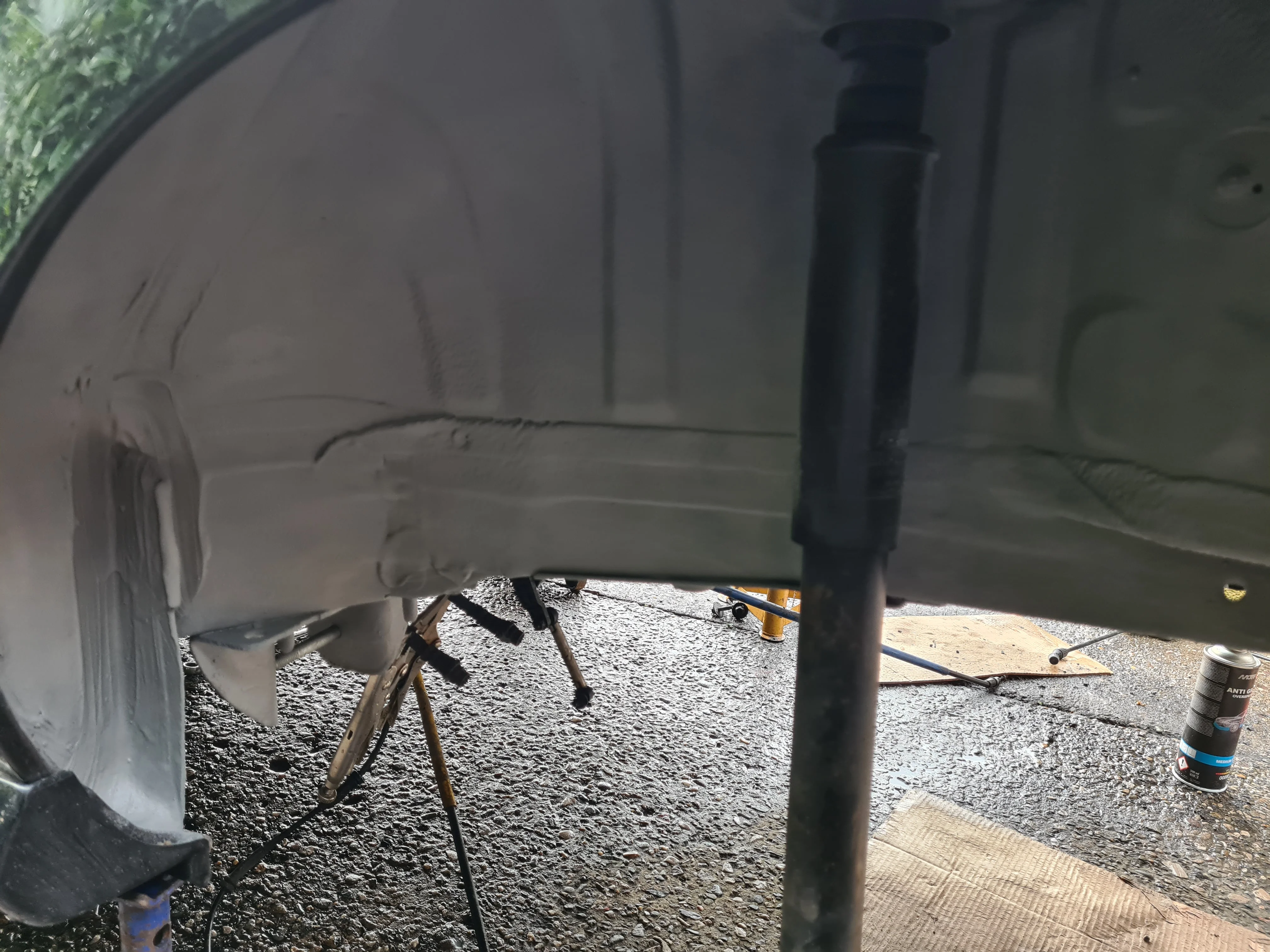

While that was removed i fitted powerflex beam bushes, camber shims, and cleaned and sprayed stonechip to the rear arches and floorpan
Looking clean didnt remove the shocks to spray as i had new cup shocks on order 😀

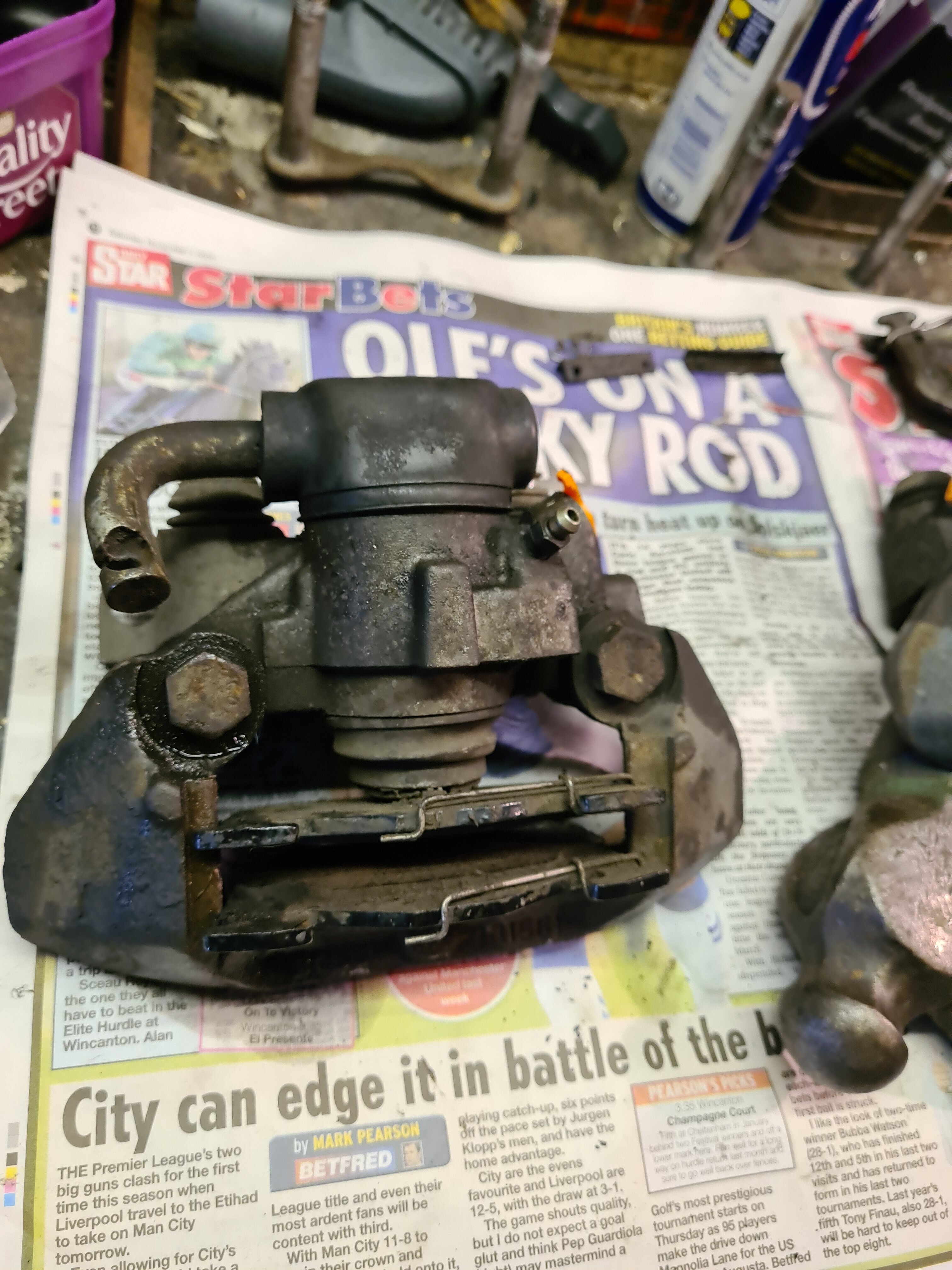

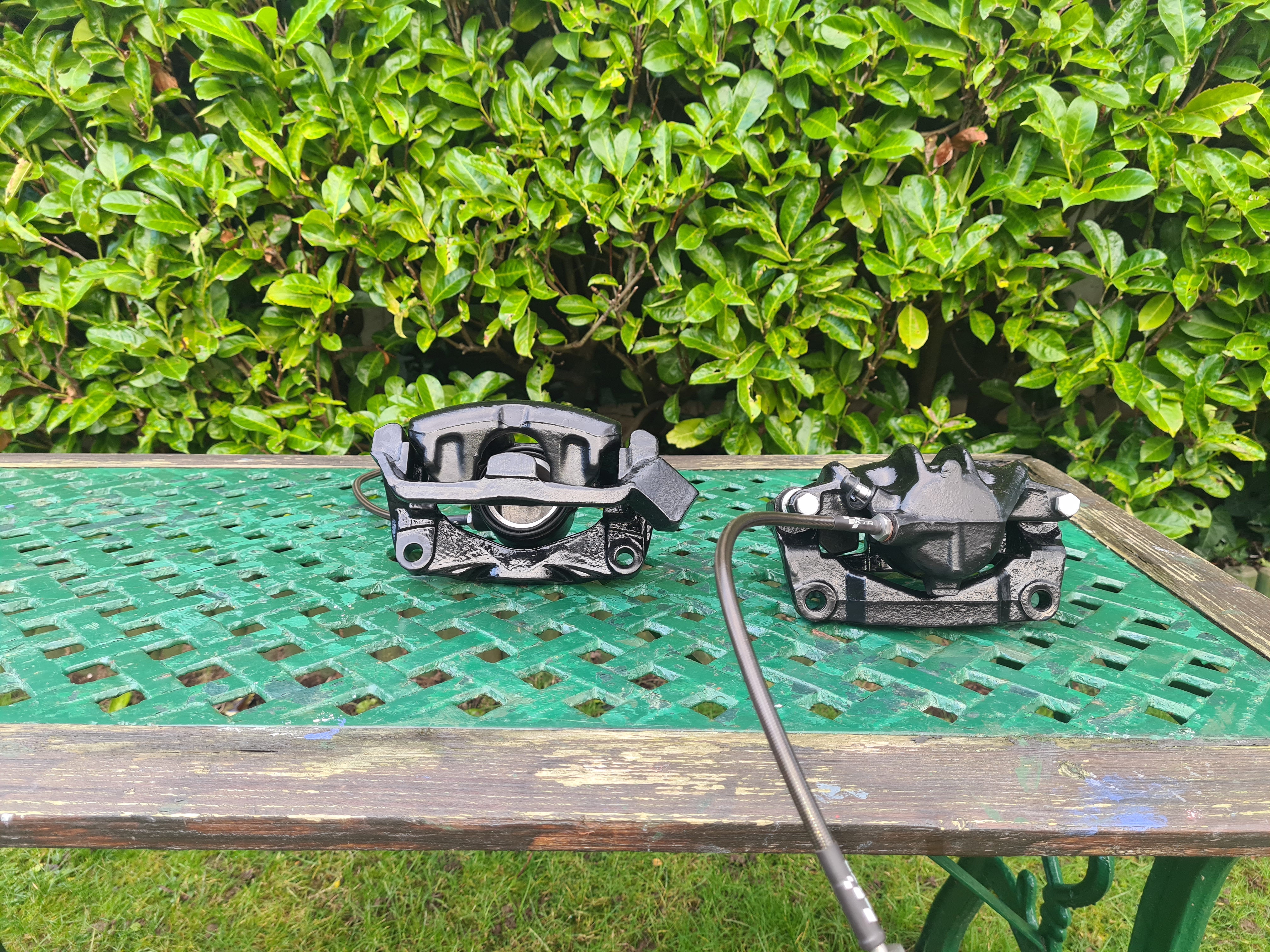

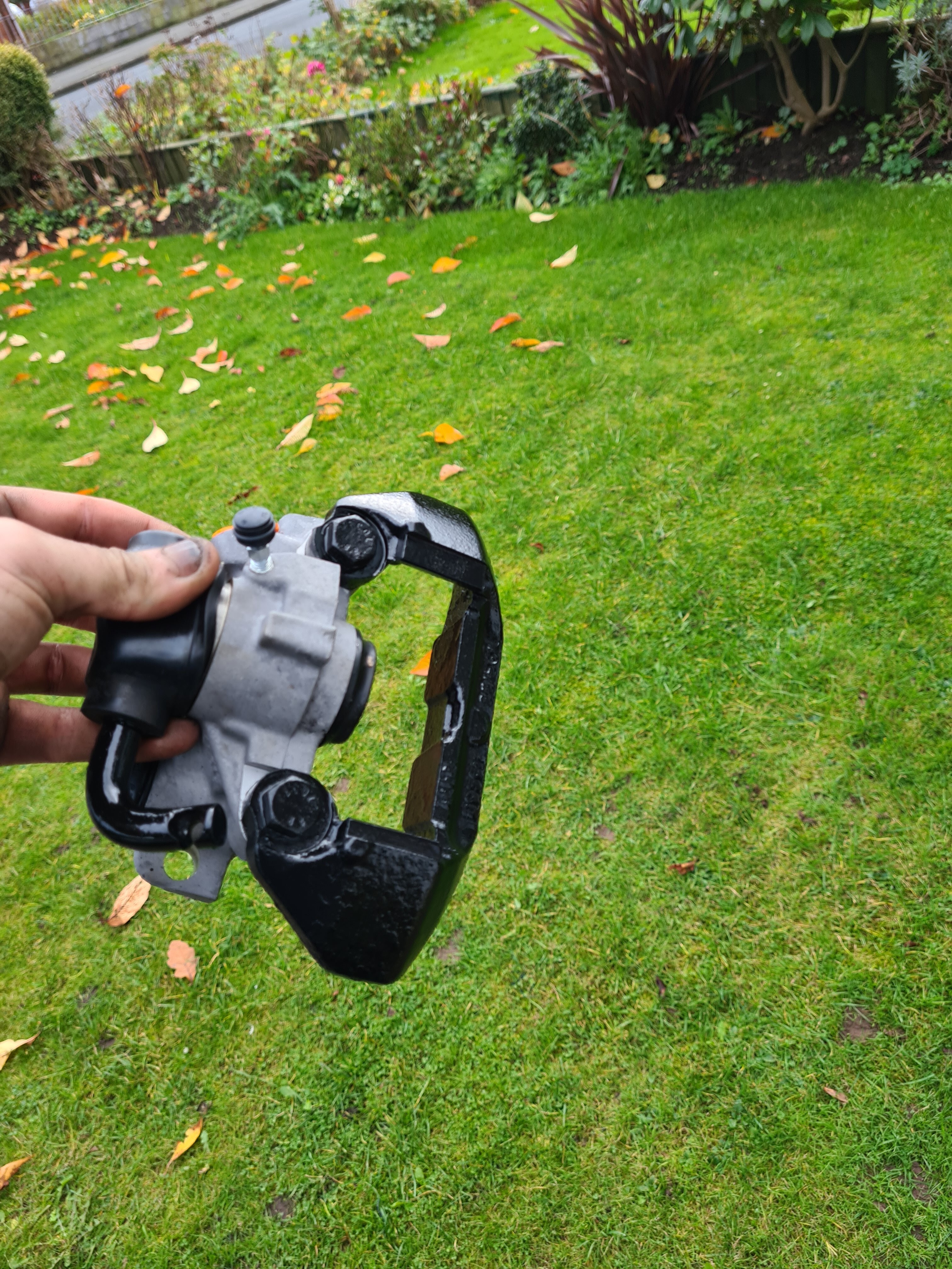

While the beam was stripped down thought i may as well clean and paint the calipers along with fitting new, nipples, ferodo pads and a fitting kit
Didnt want to go anything too fancy with the colour so i thought black would look clean cant believe how well the caliper came up with some wheel acid and a detail brush 😮

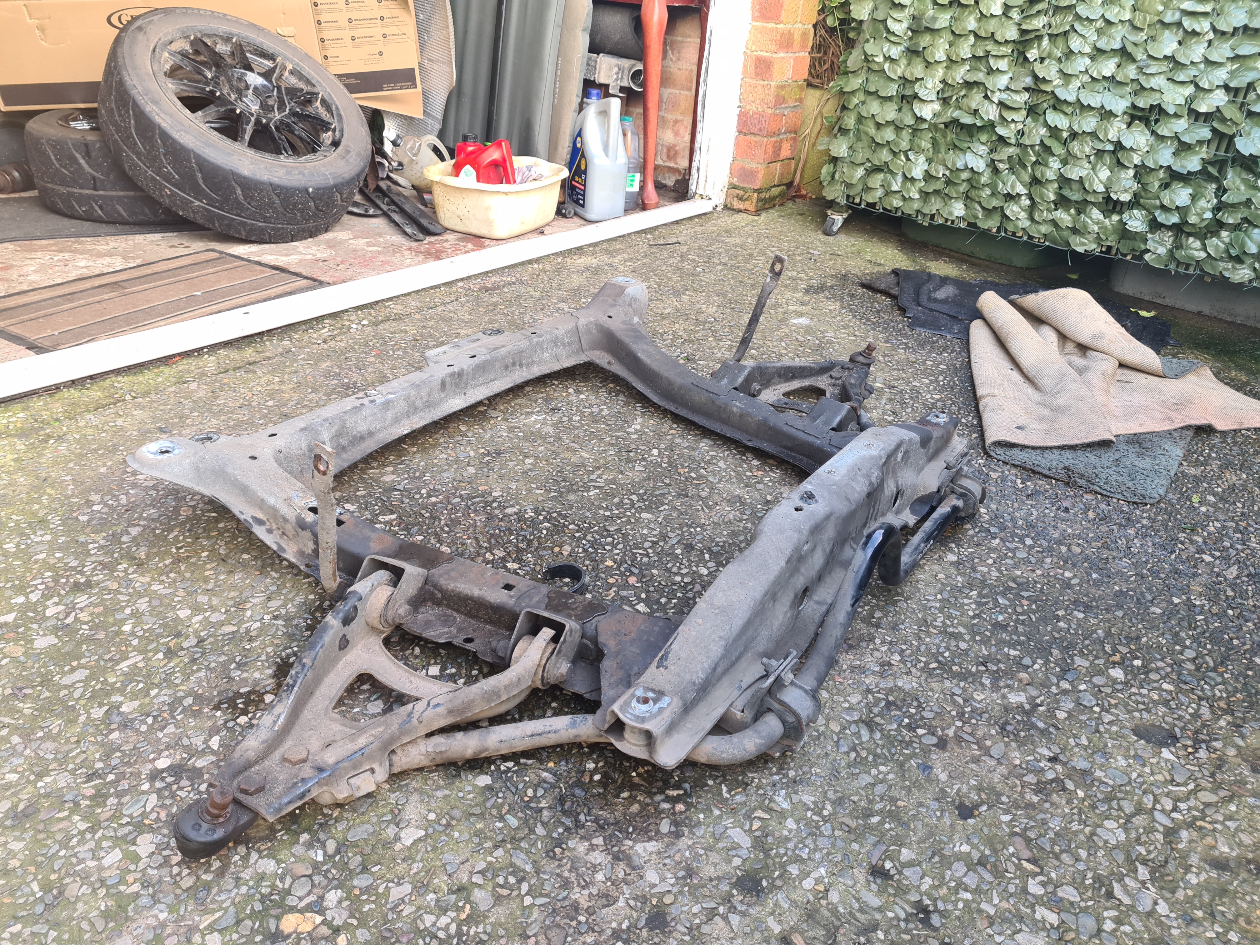

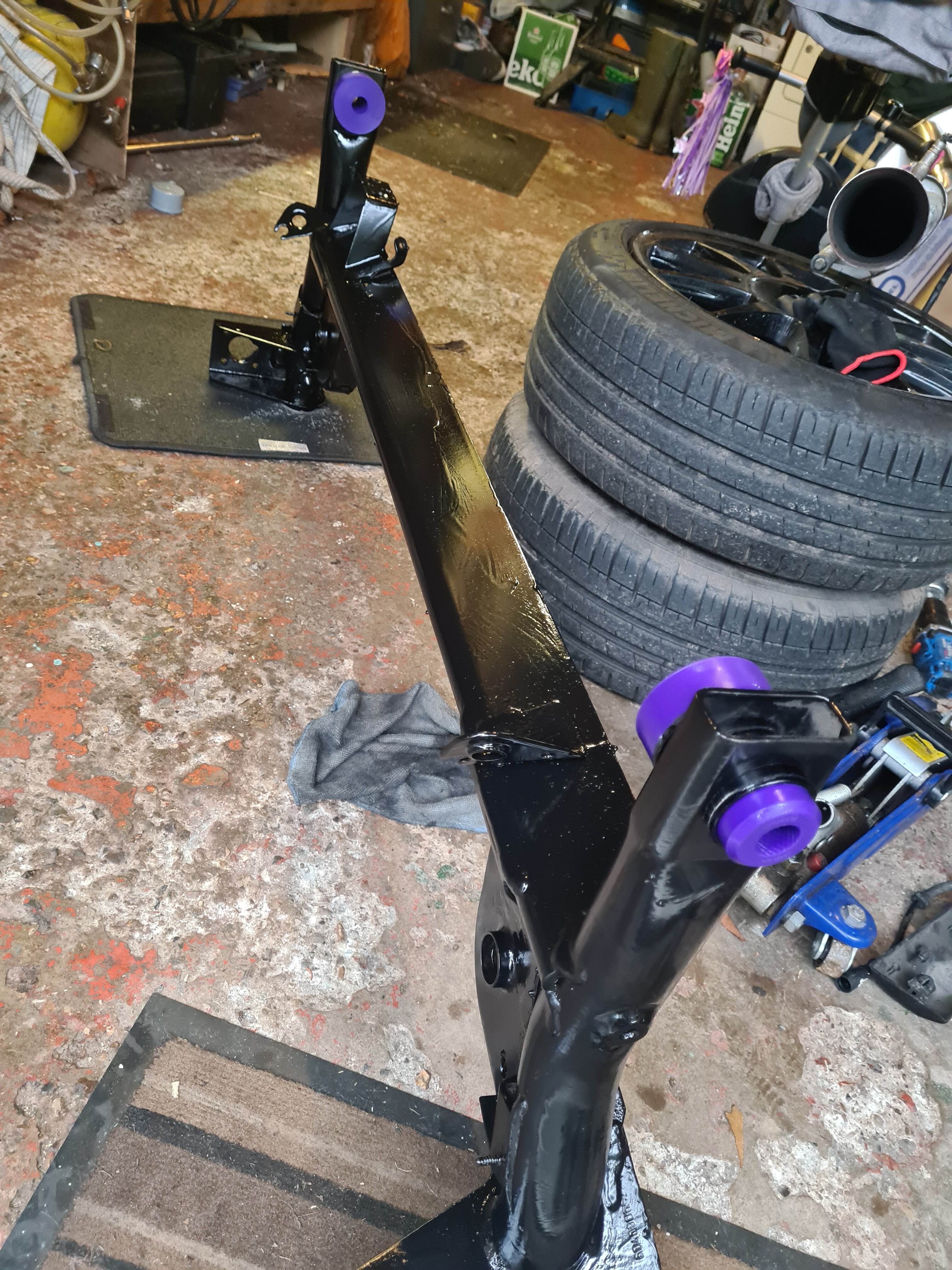

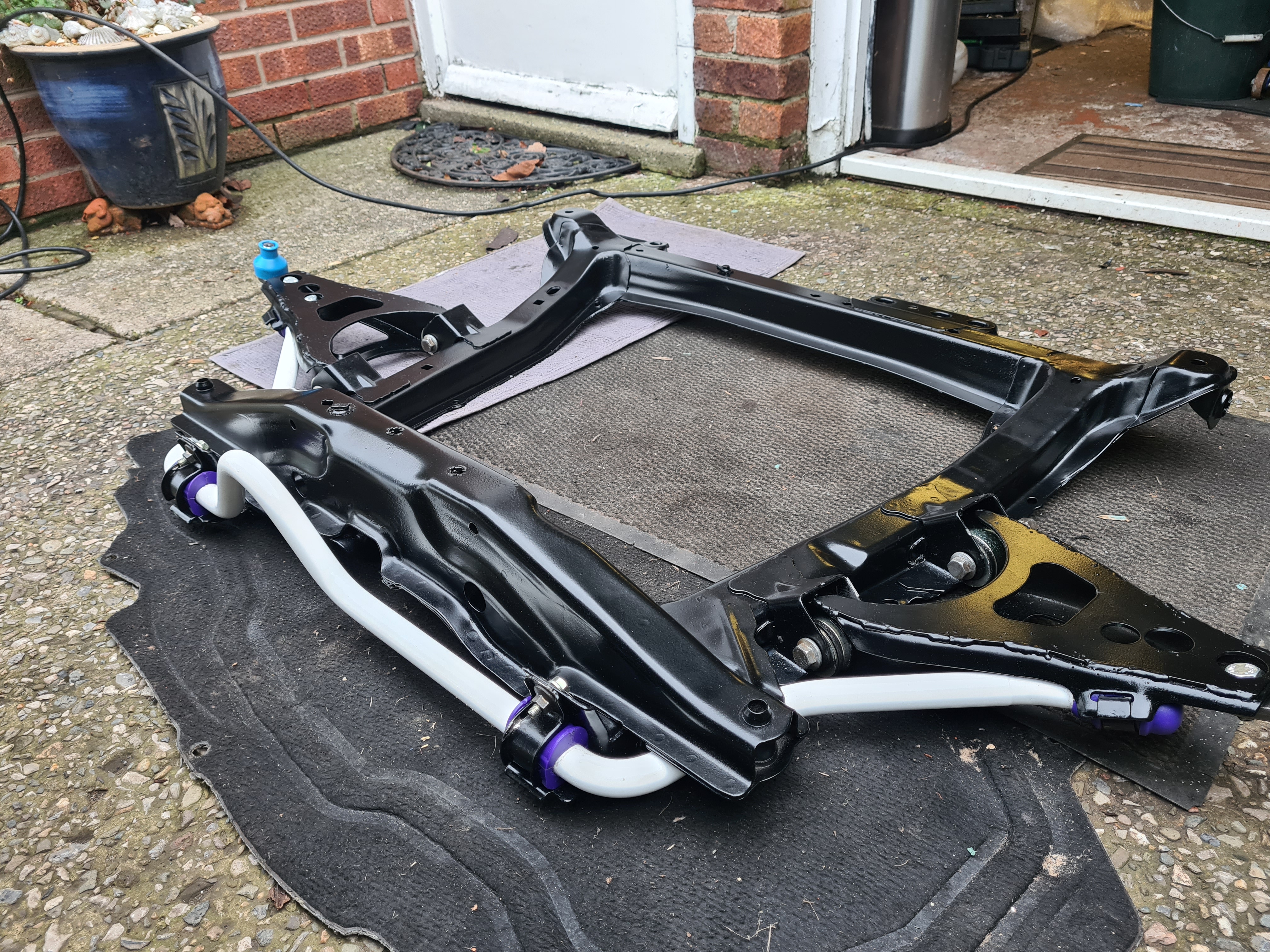

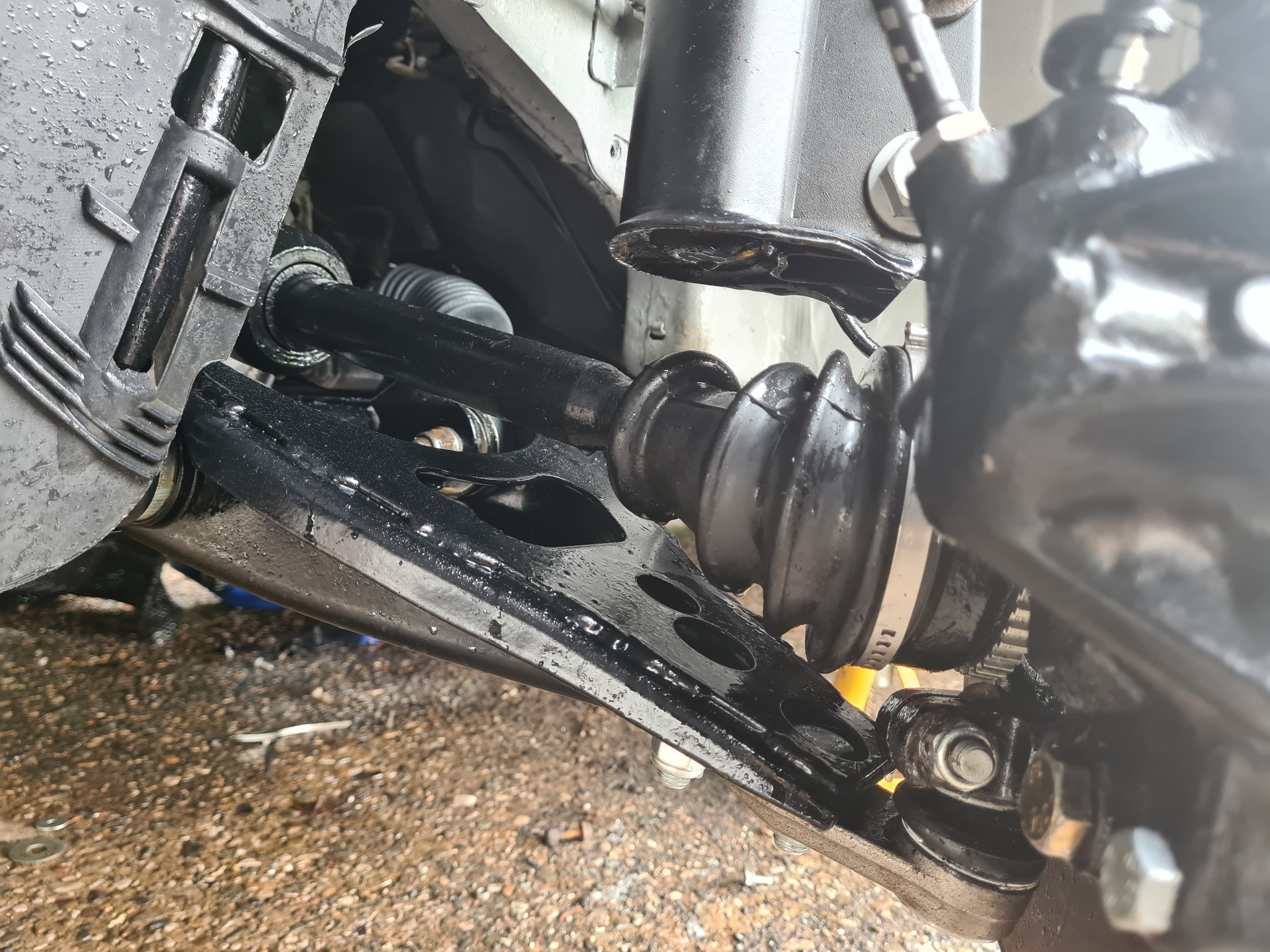

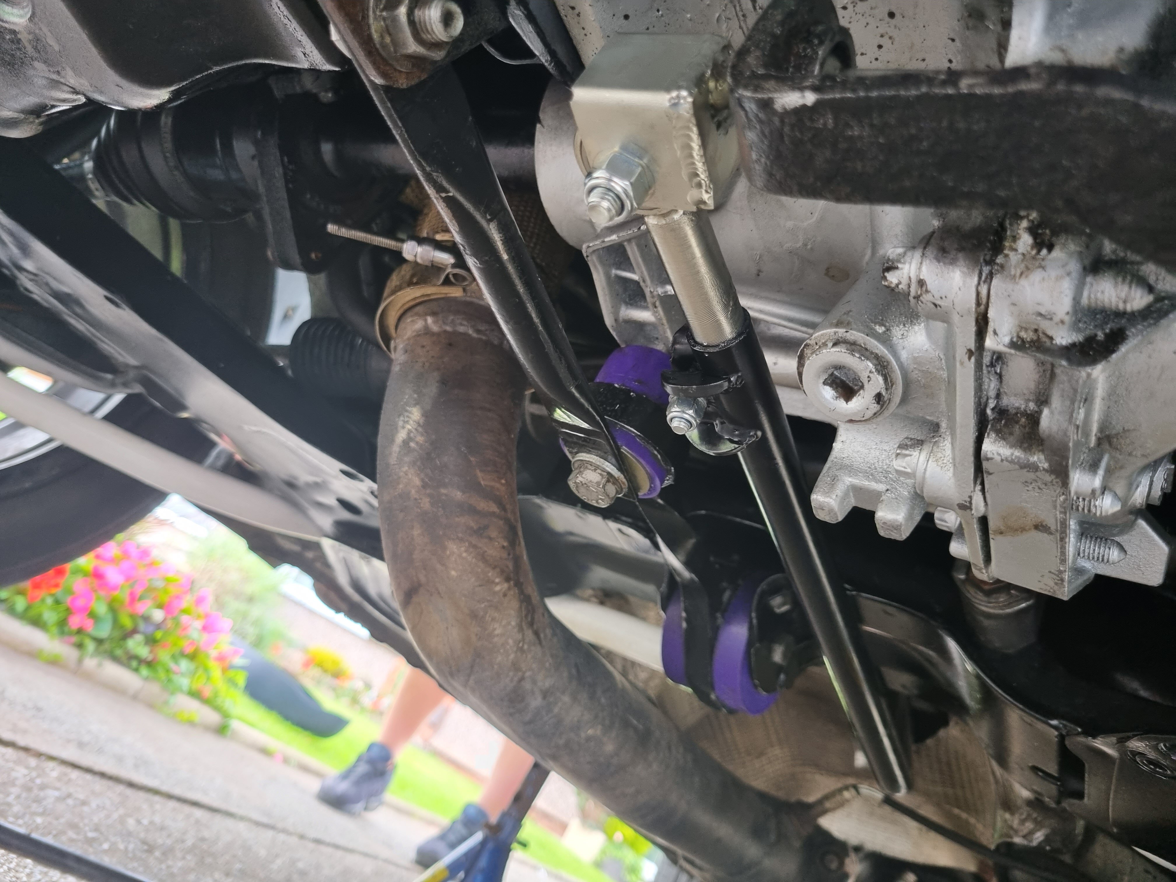

Subframe off. Was sent to the powdercoaters along with the arms and arb. Came back looking like this 😍

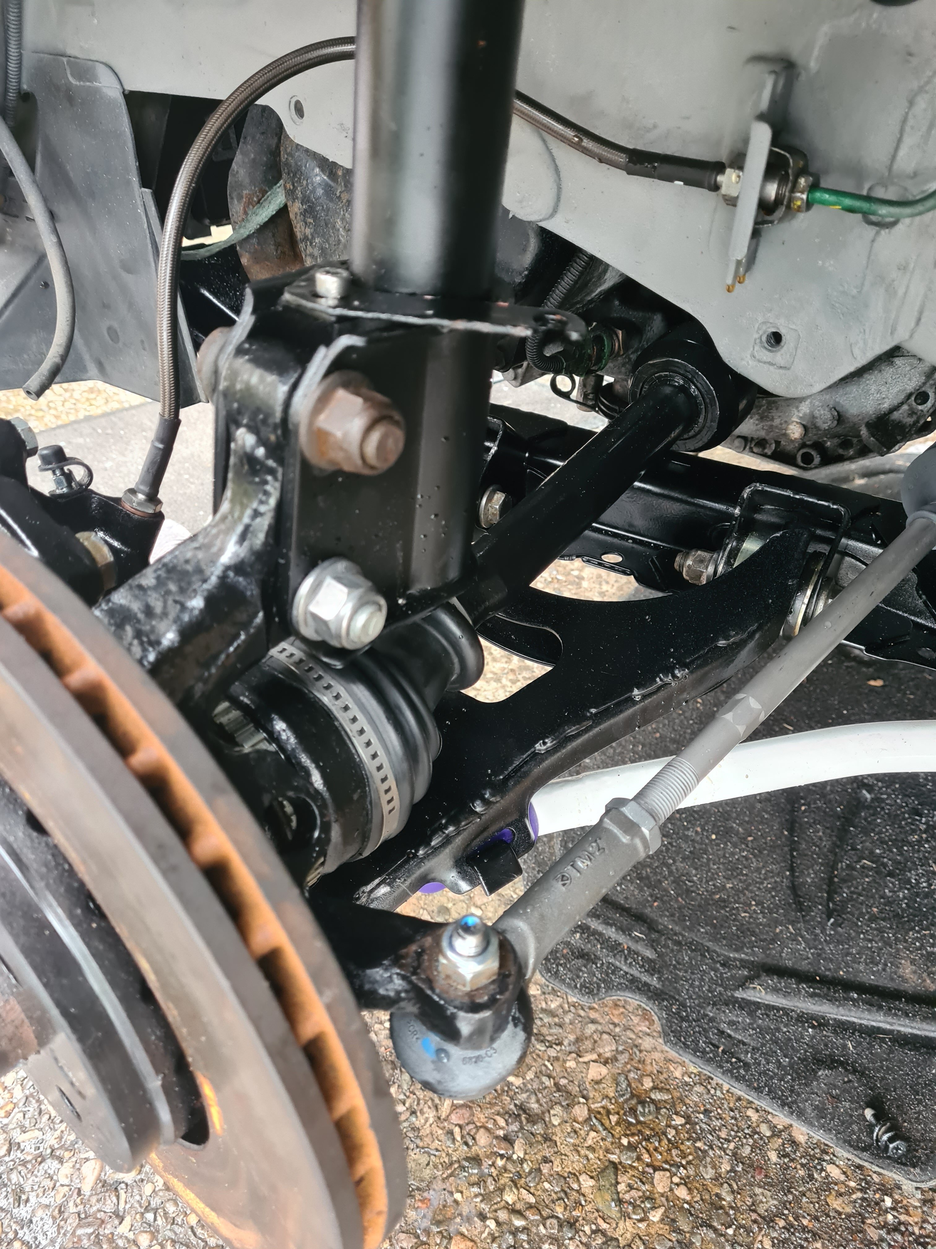

With new inner and outer powerflex bushes. The inner ones were a b**ch 🤣 new lemforder ball joints, powerflex black series wishbones bushes and pms strength plates welded on. While the subframe was out seemed silly not to change the rack bushes so swapped them out for powerflex ones.
And fitted genuine renault rack arms and dust covers and some lemforder track rods

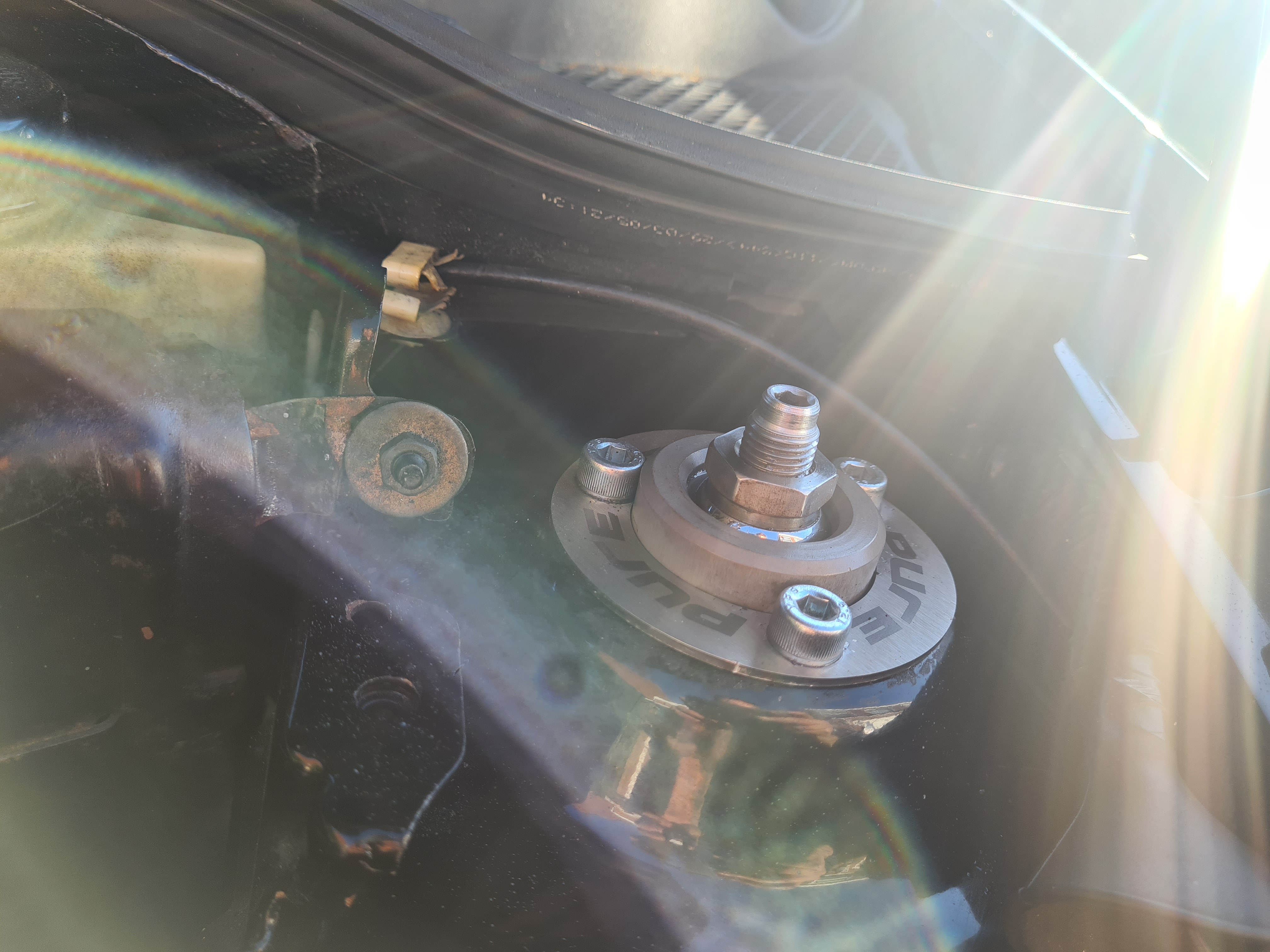

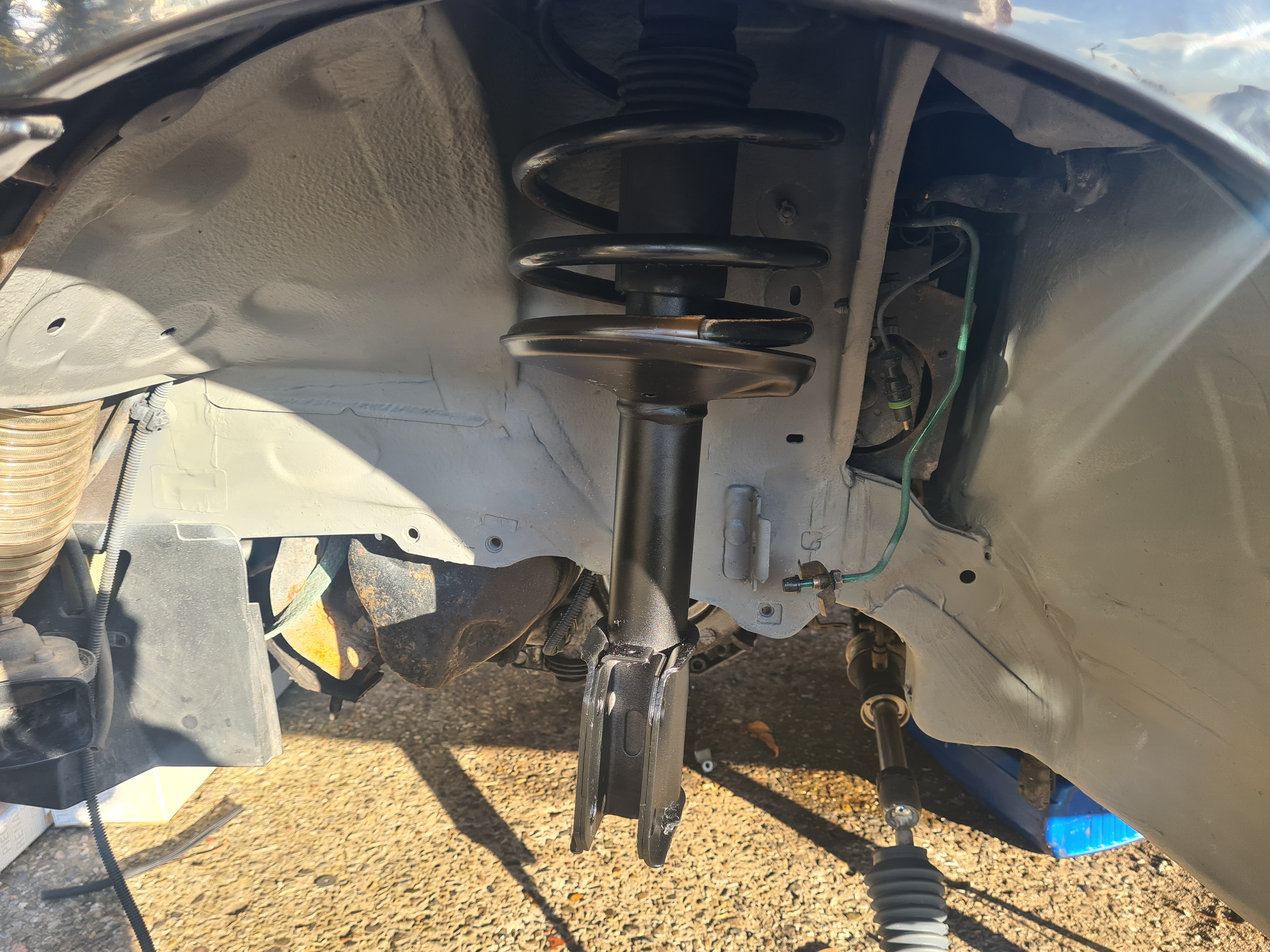

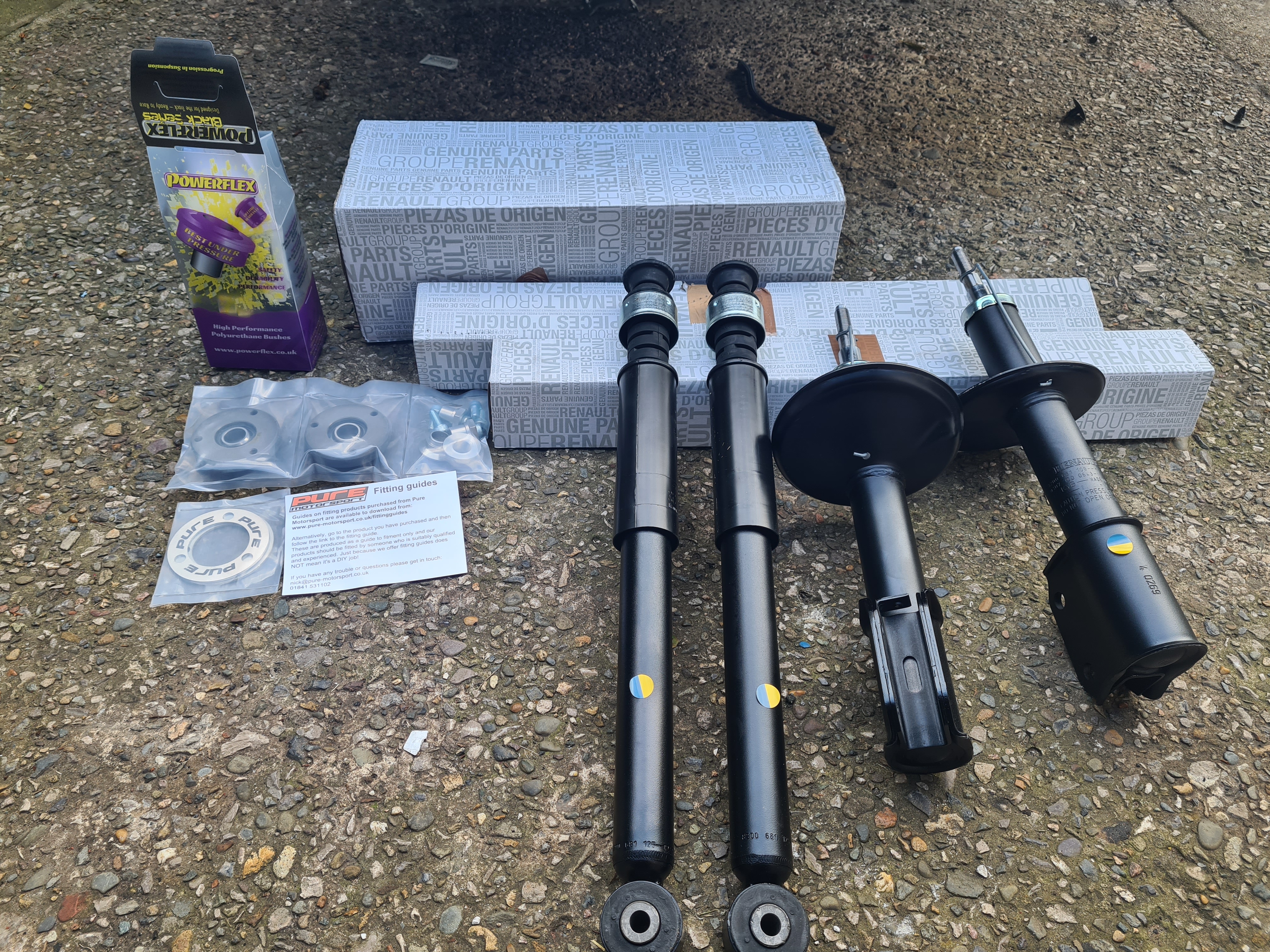

New cup shocks and pms solid top mounts 😁
Must say the car feels so much tighter after this. And while the brakes were off decided to rebuild and paint the front calipers with pistons seals and slides along with some ktec carbon braided lines all round

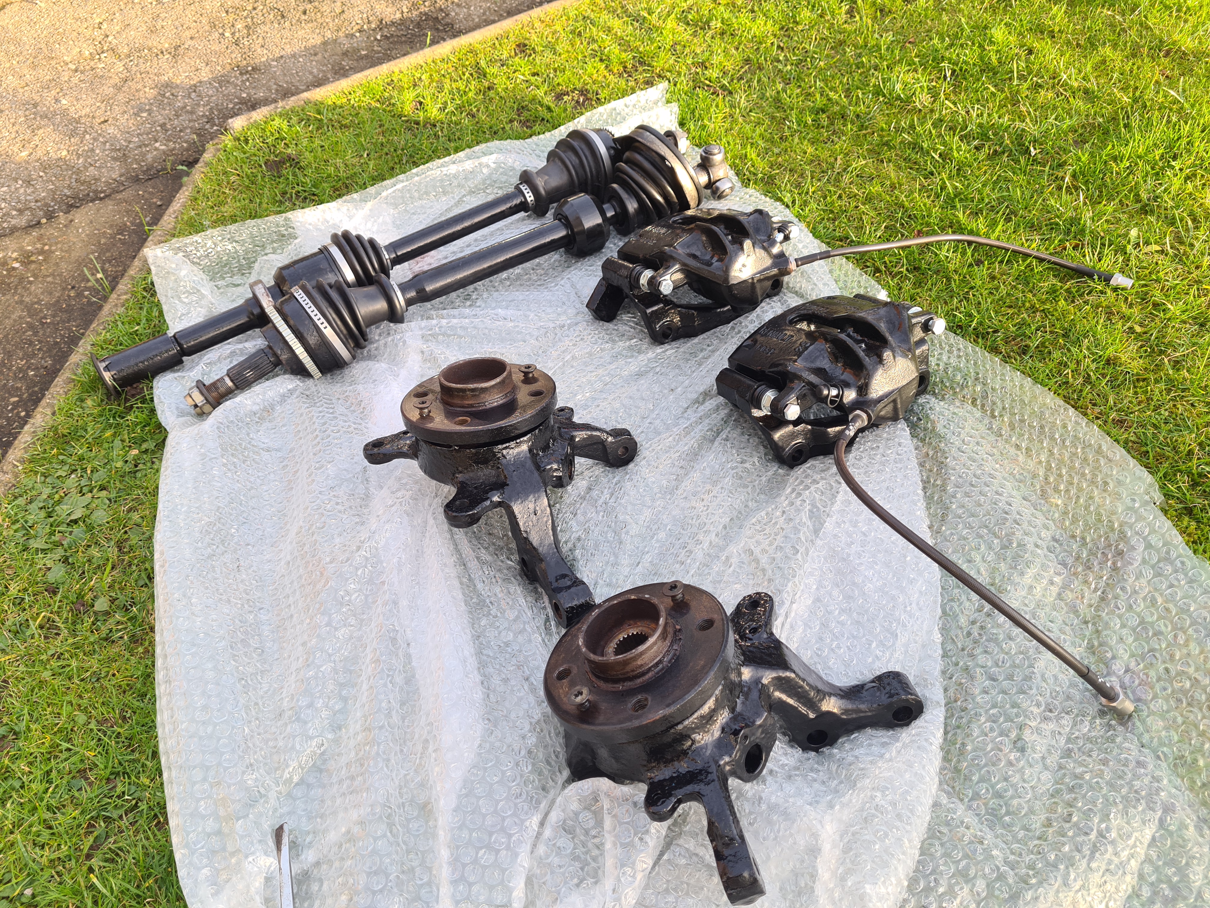

Again happy with how these turned out. While the drive shafts were out thought i may as well put new boots, clips, abs rings and regrease them as well as giving them a lick of paint 😋
Bolted them back together

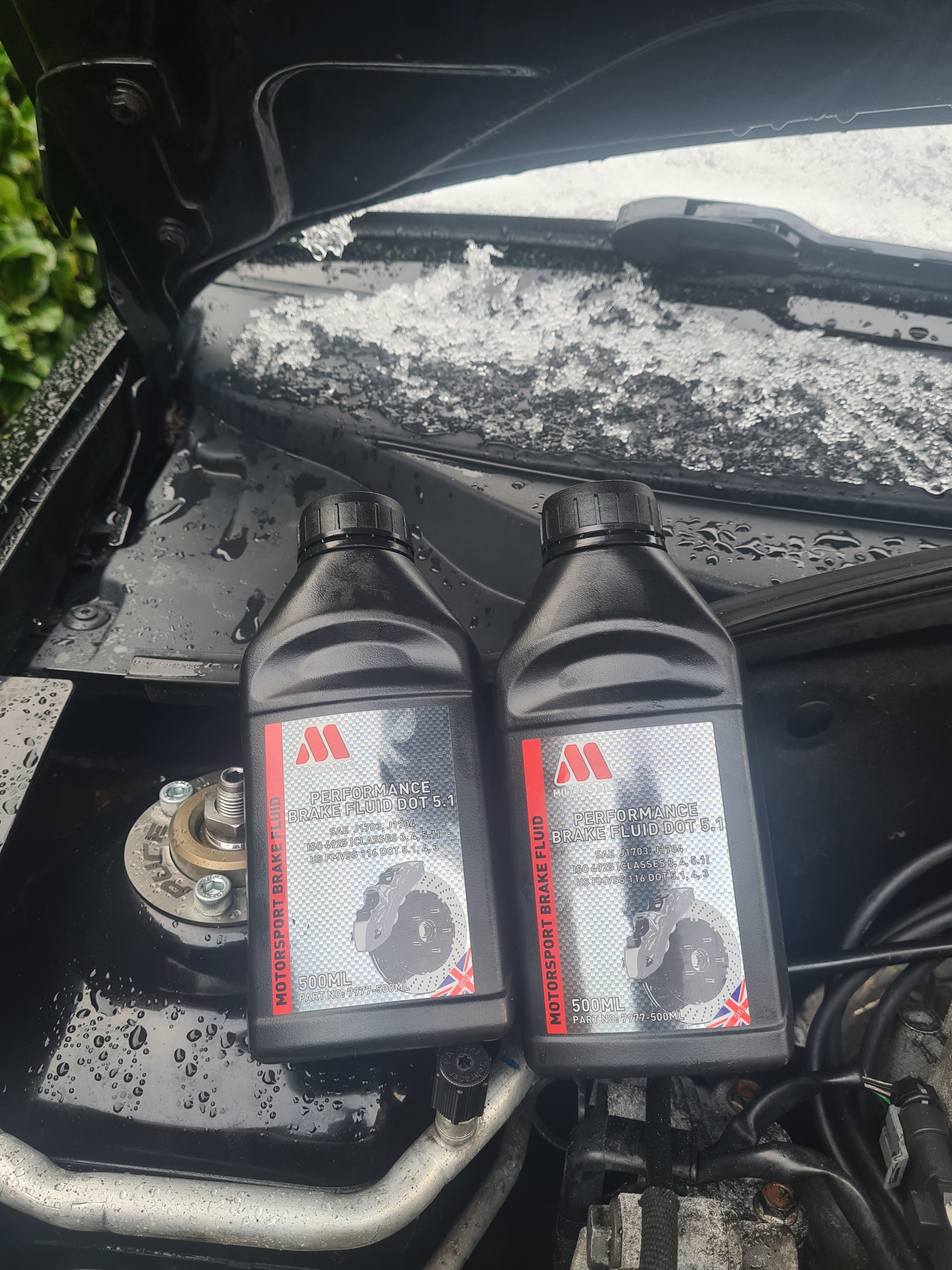

Just finished off by throwing some dot 5.1 millers brake fluid in and finally getting back to being able to enjoy the clio again 🤣

Looks bloody brilliant that!
How much of an arse was the rear beam to drop? I plan on doing the same thing soon and have read about the bolts being a git to get out.
Thanks mate 👍 not too bad i read somewhere not to touch the plates that go thru the rear floor and drop the tank a bit and take the bolts that run through the bushes out instead. All came out and back in fairly easily with a hand off my mate
Good to know, thanks. I’ll try that before attacking anything with a grinder.

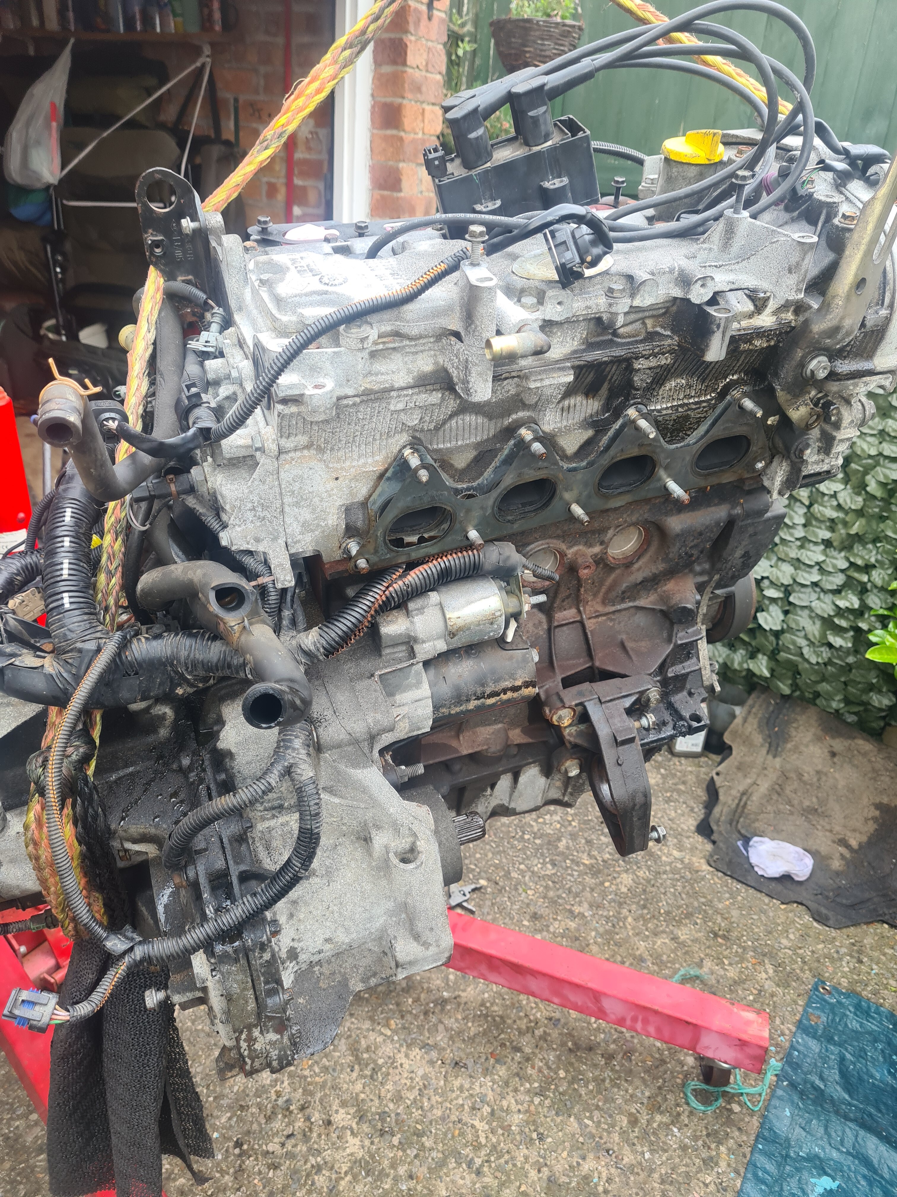

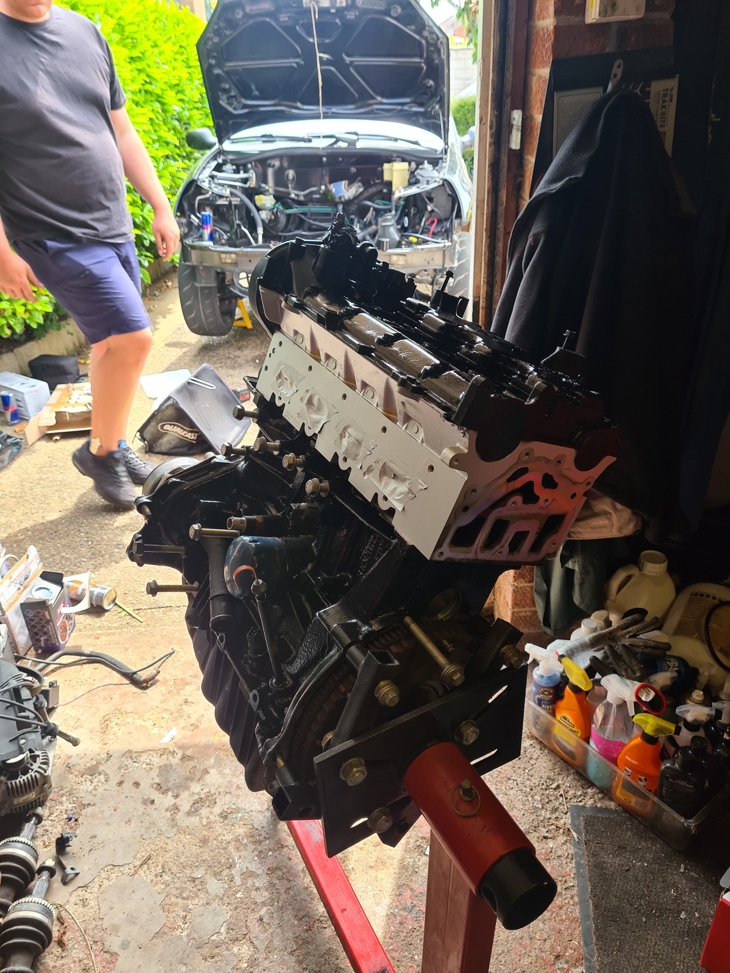

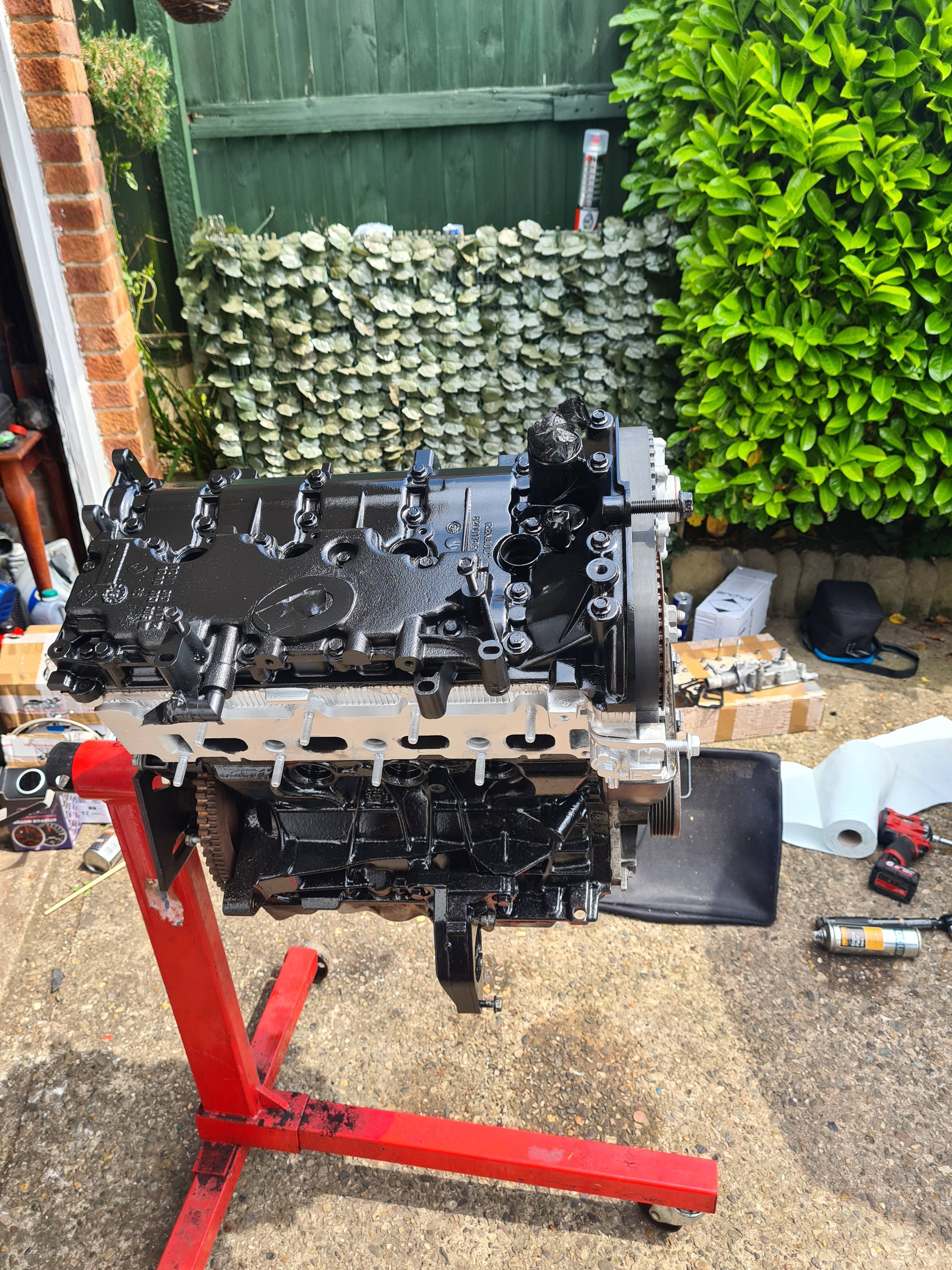

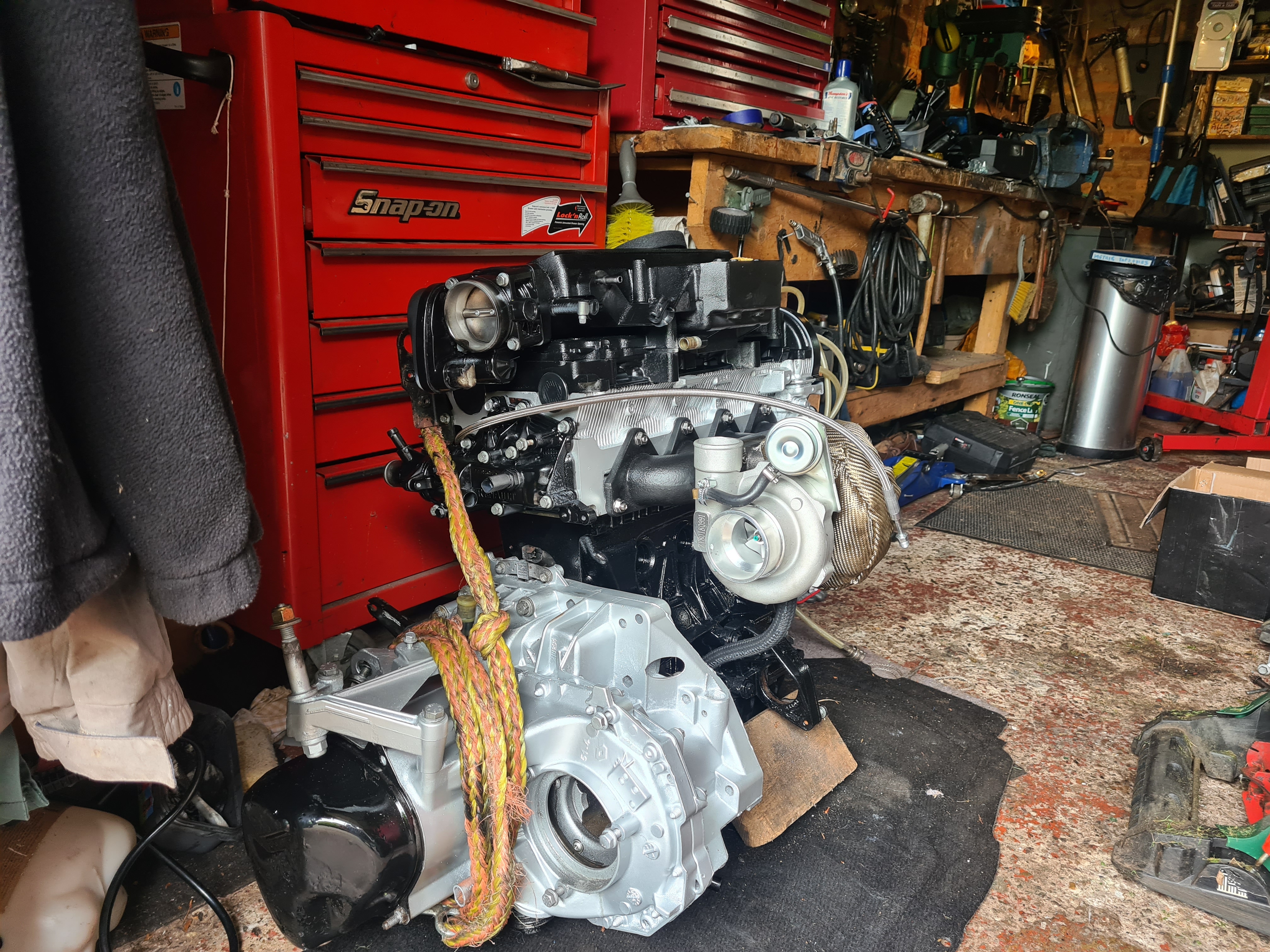

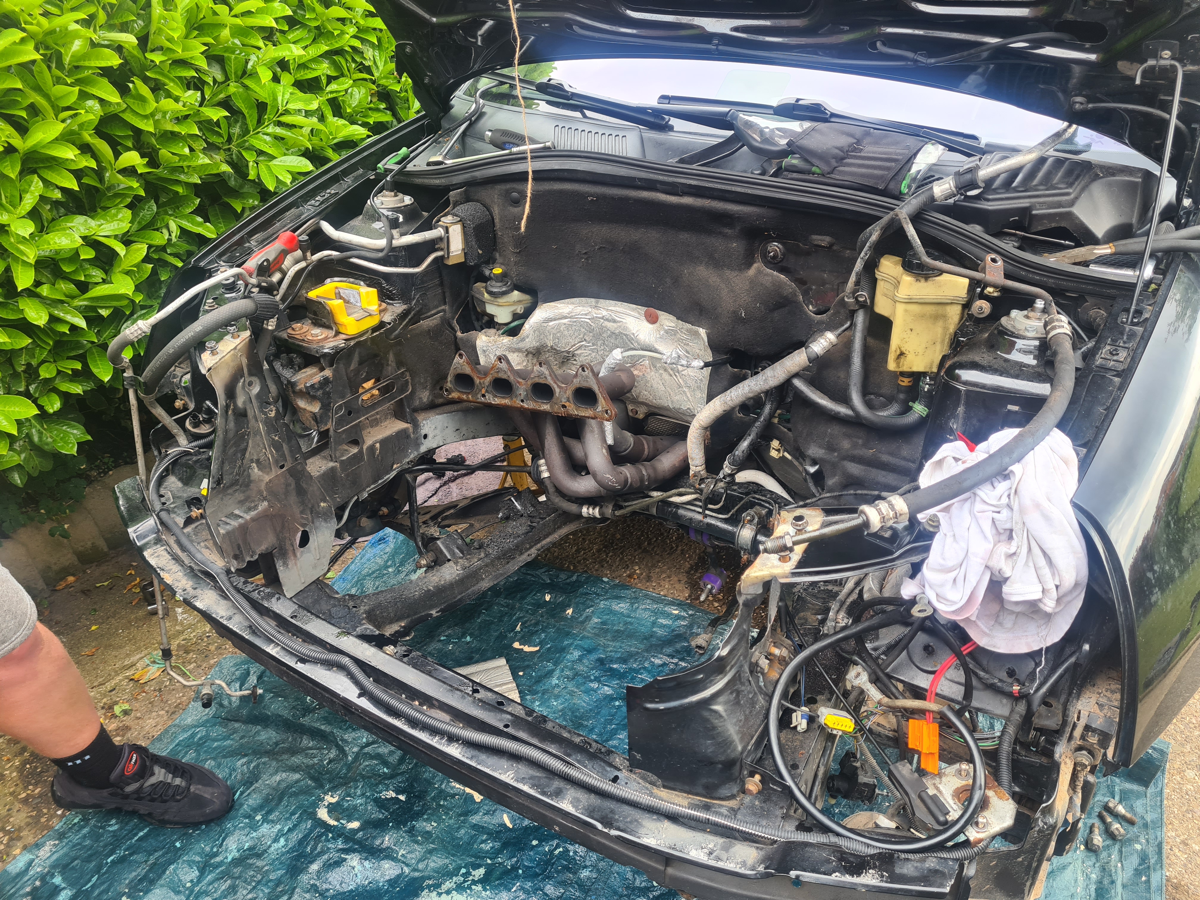

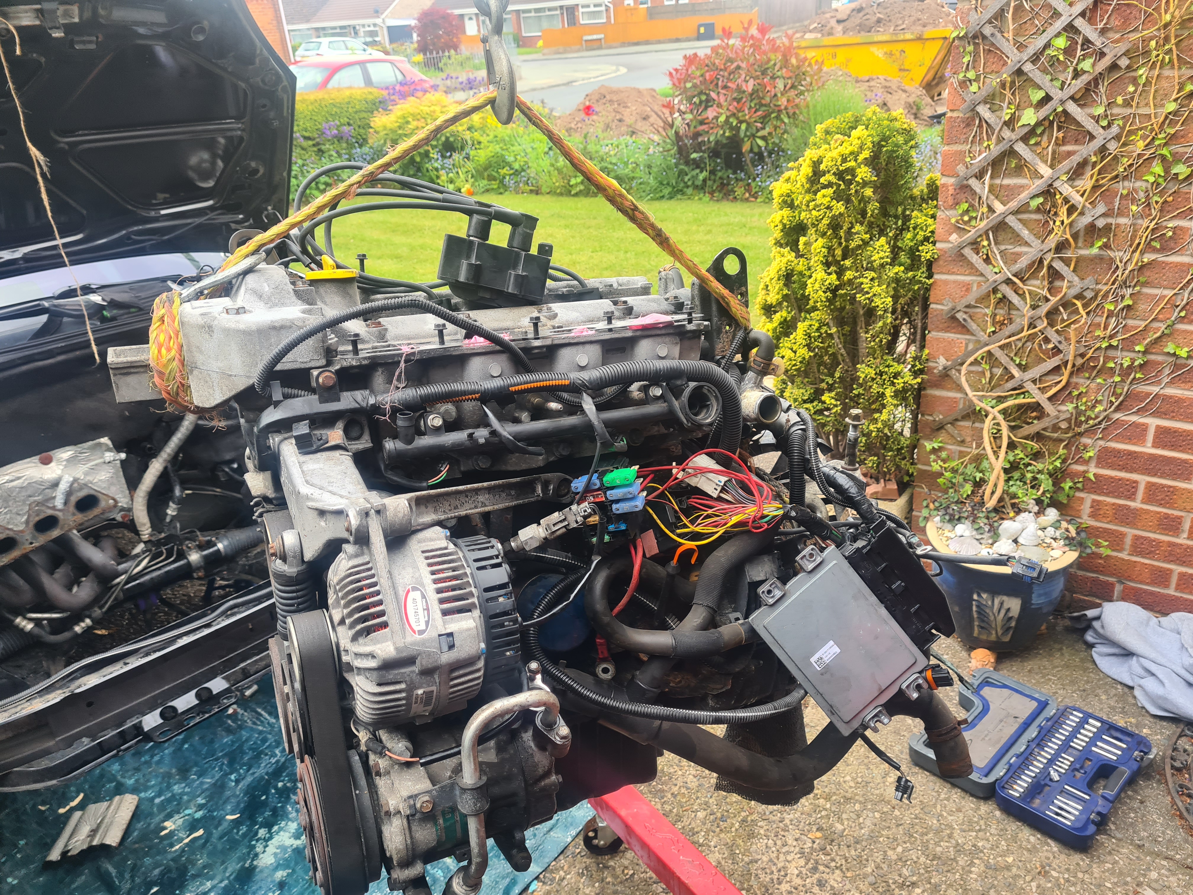

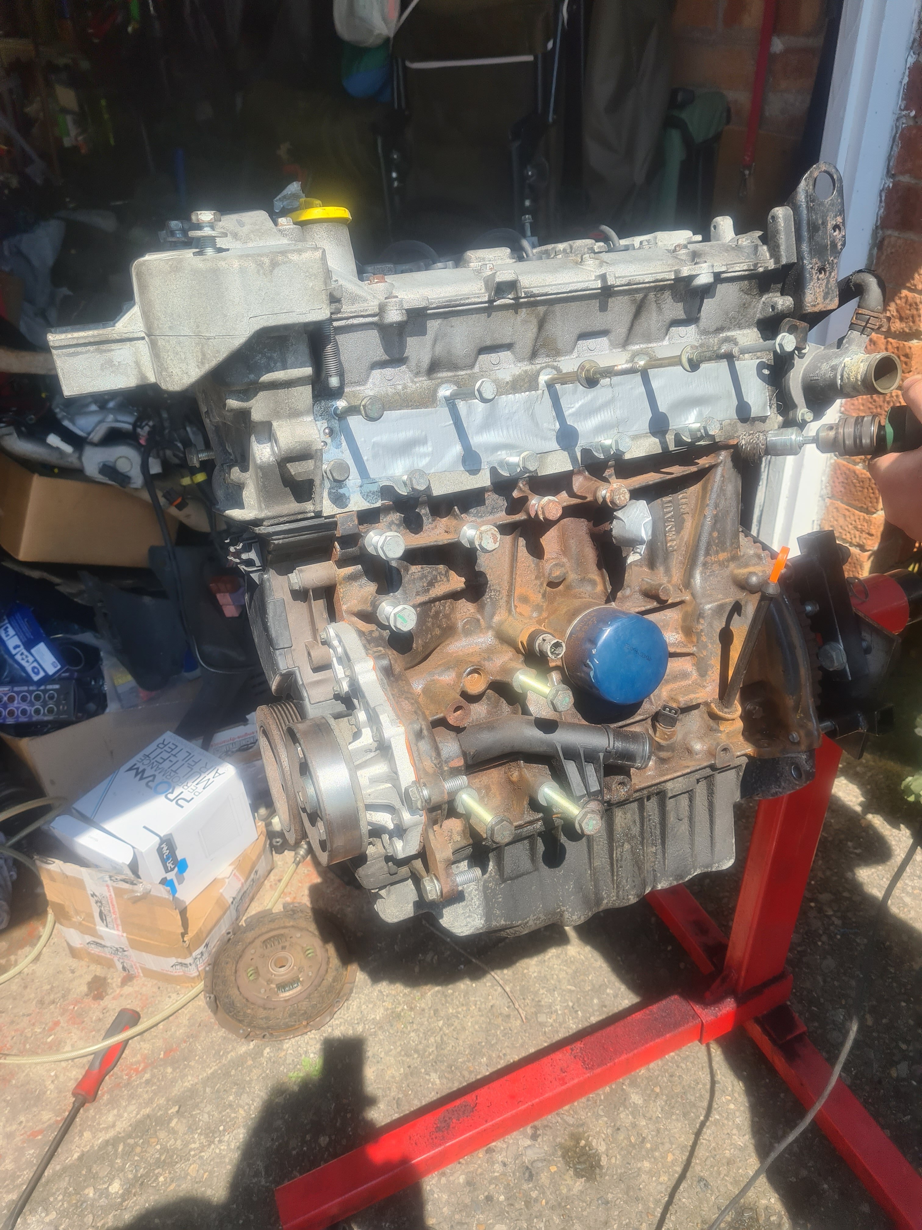

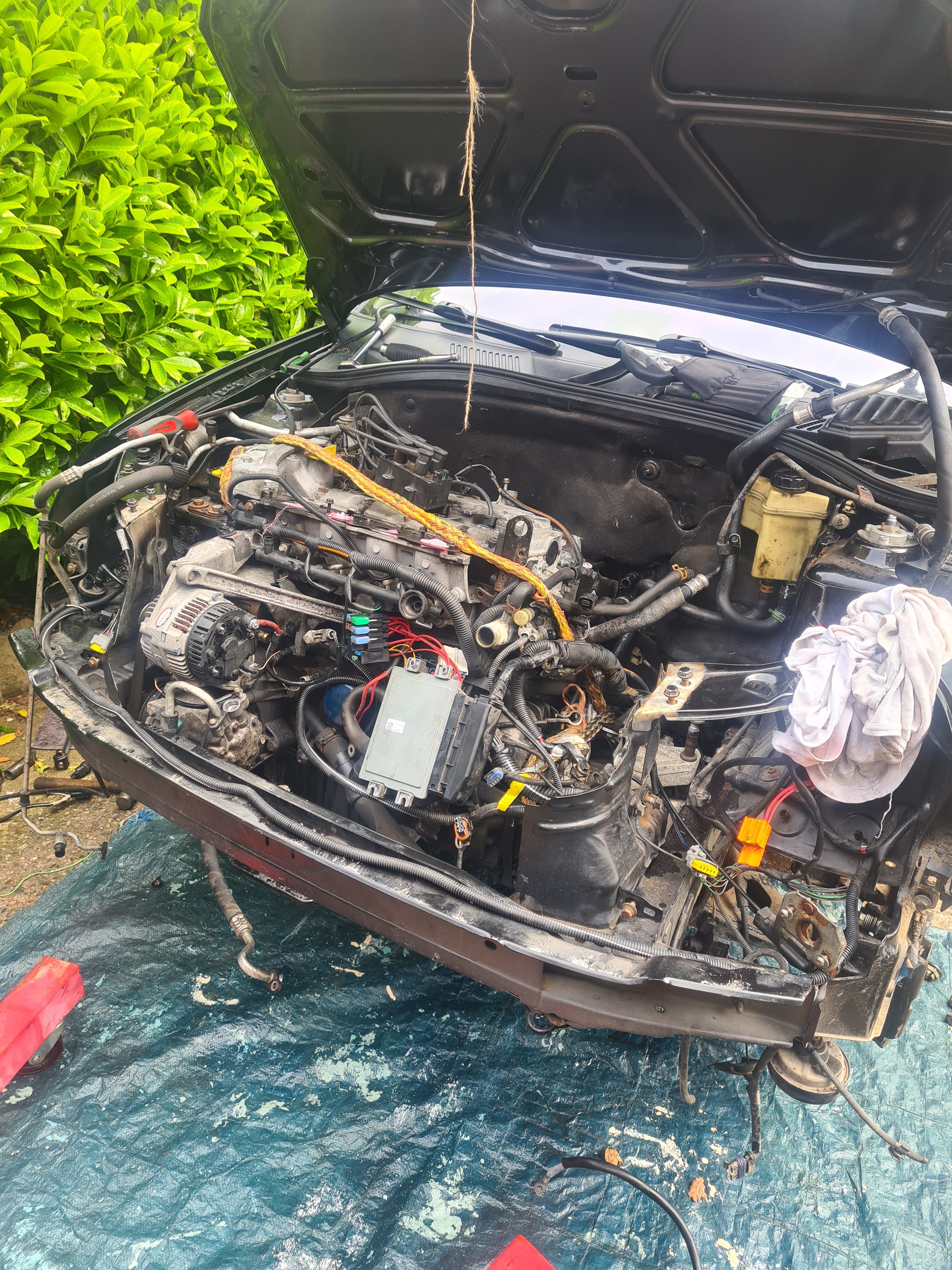

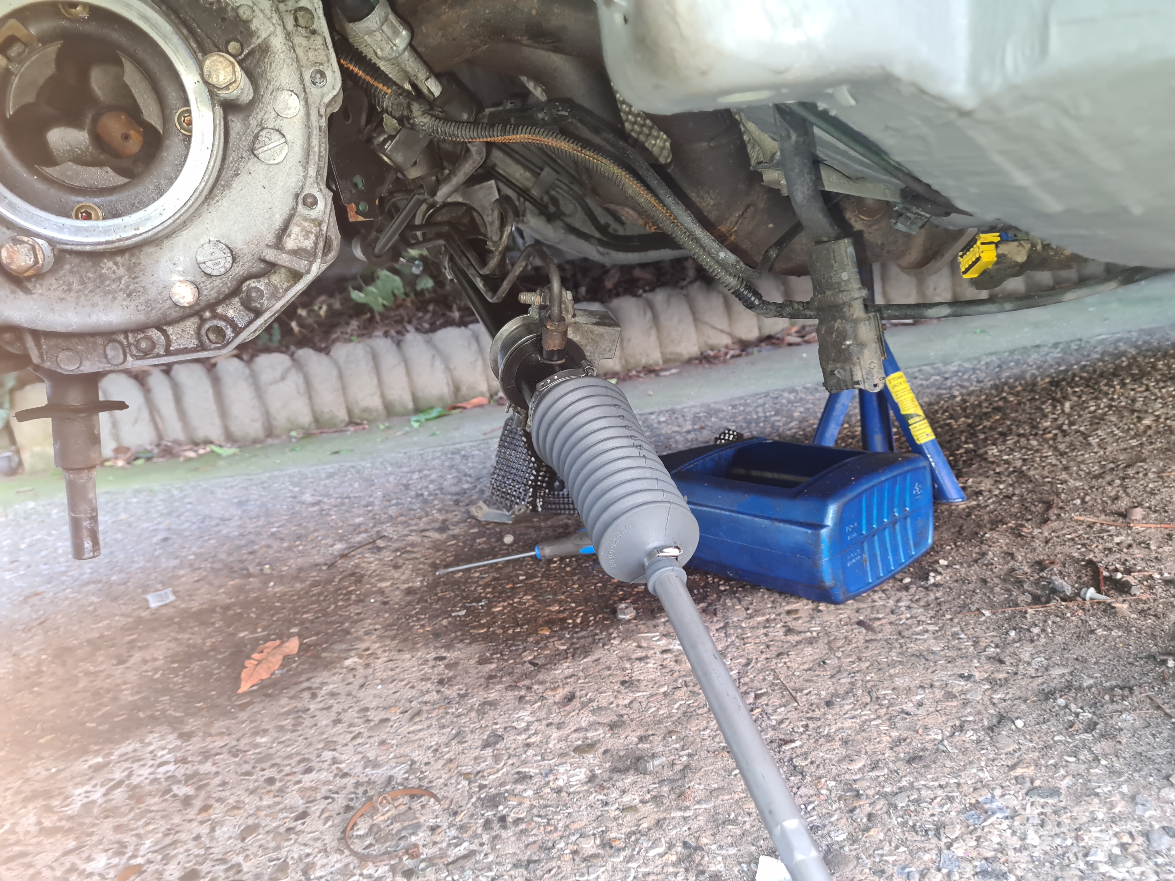

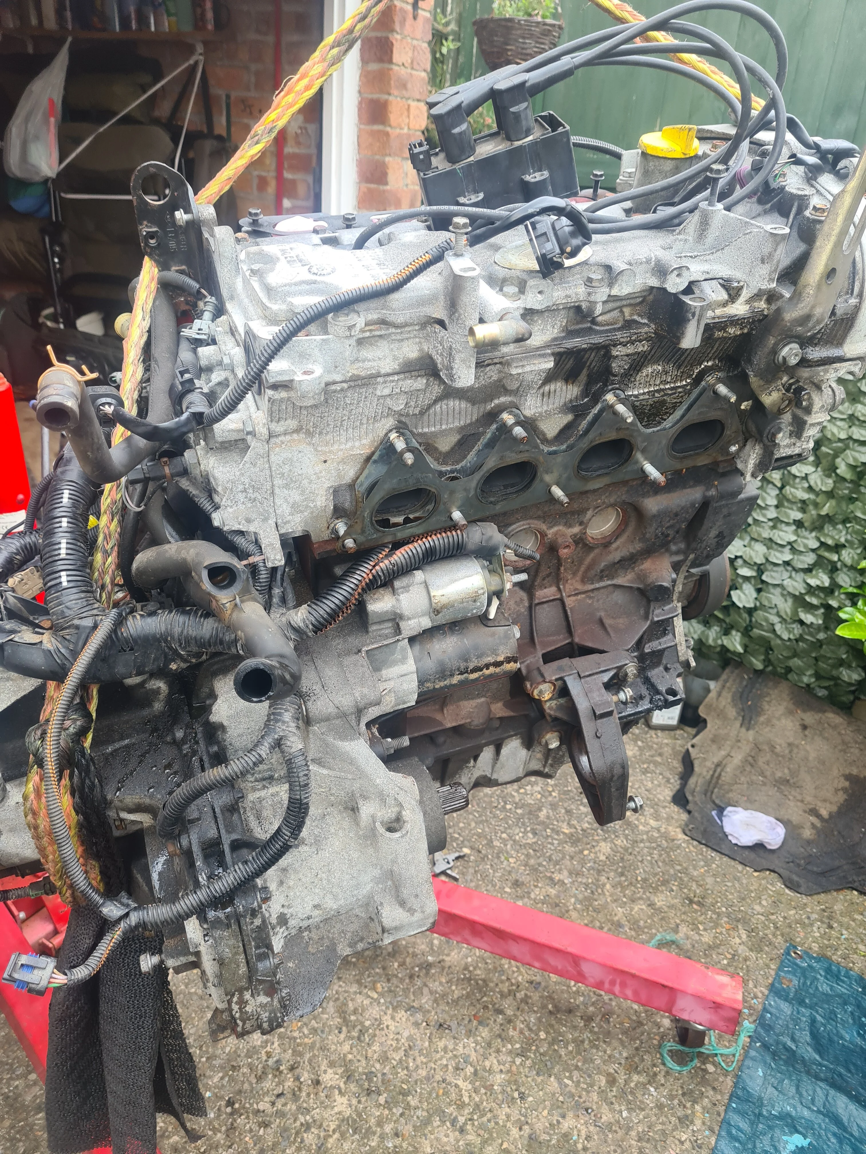

First off got stuck in removing the engine i know it can be done in place but to save hassle and to give me the chance to clean, tidy and paint parts i decided to go down that route
How it was looking before a bit tired and looking its age in my opinion

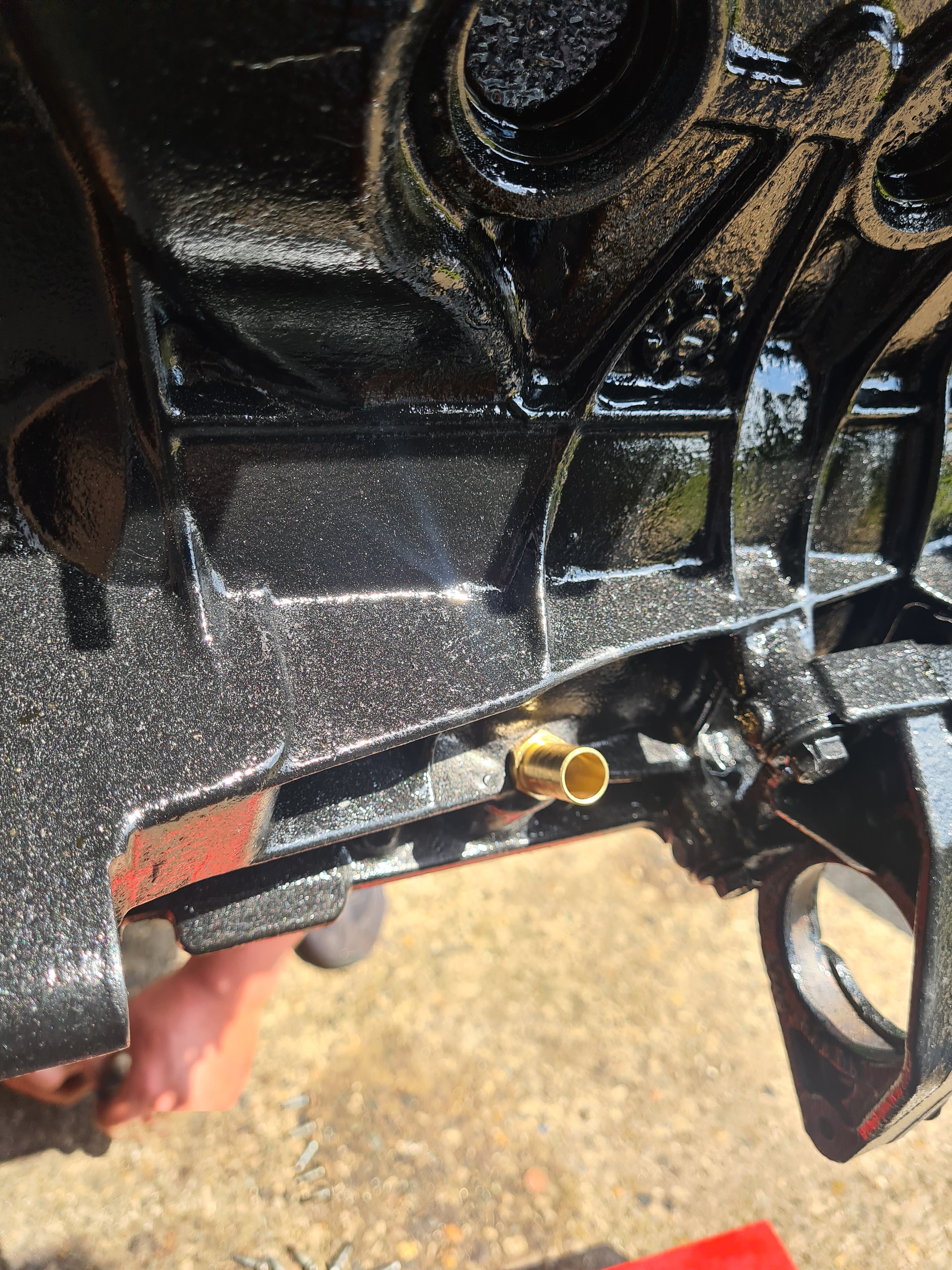

3/8 Oil drain tapped into the block
not going to lie i did not enjoy that part 😂

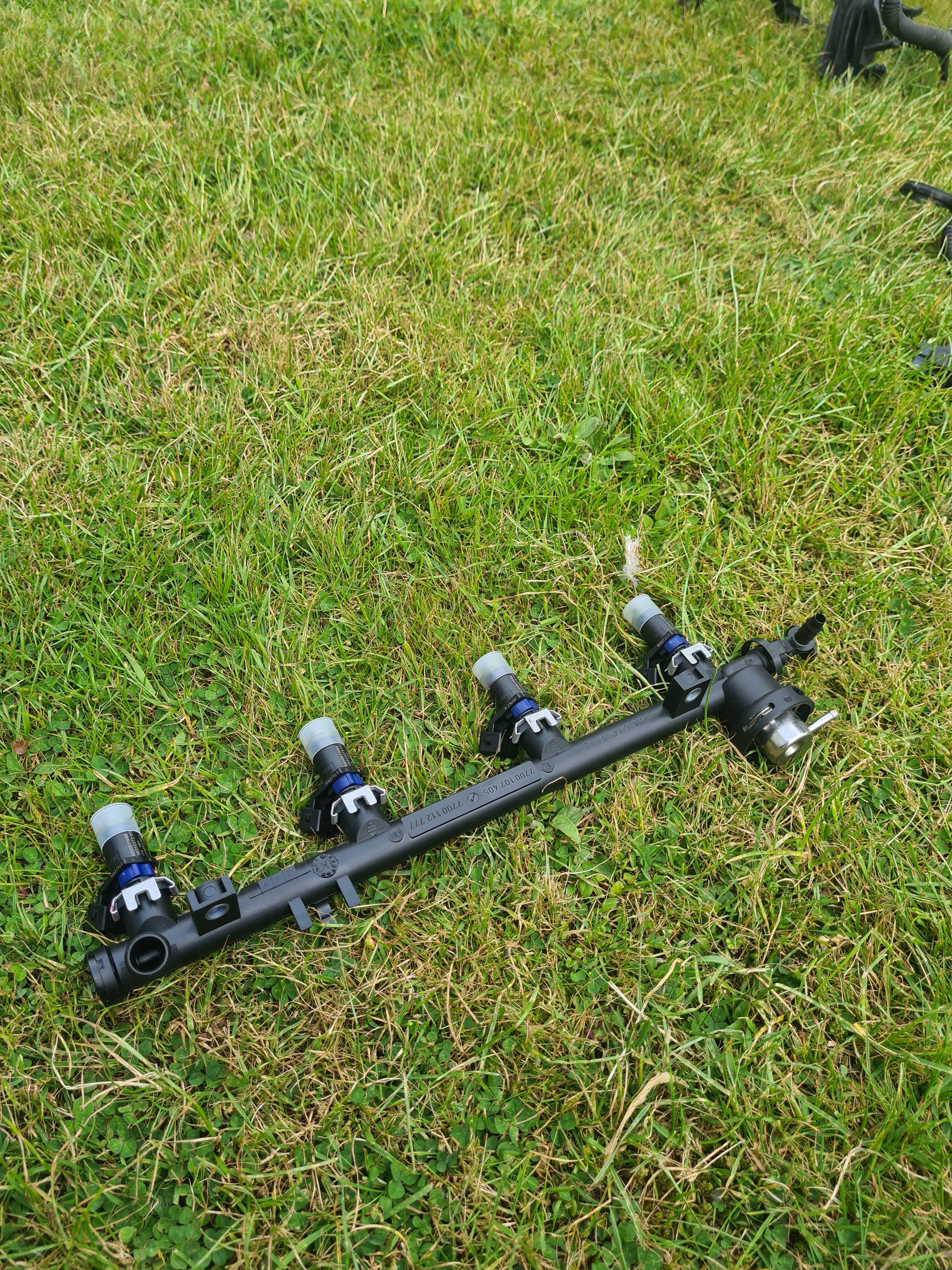

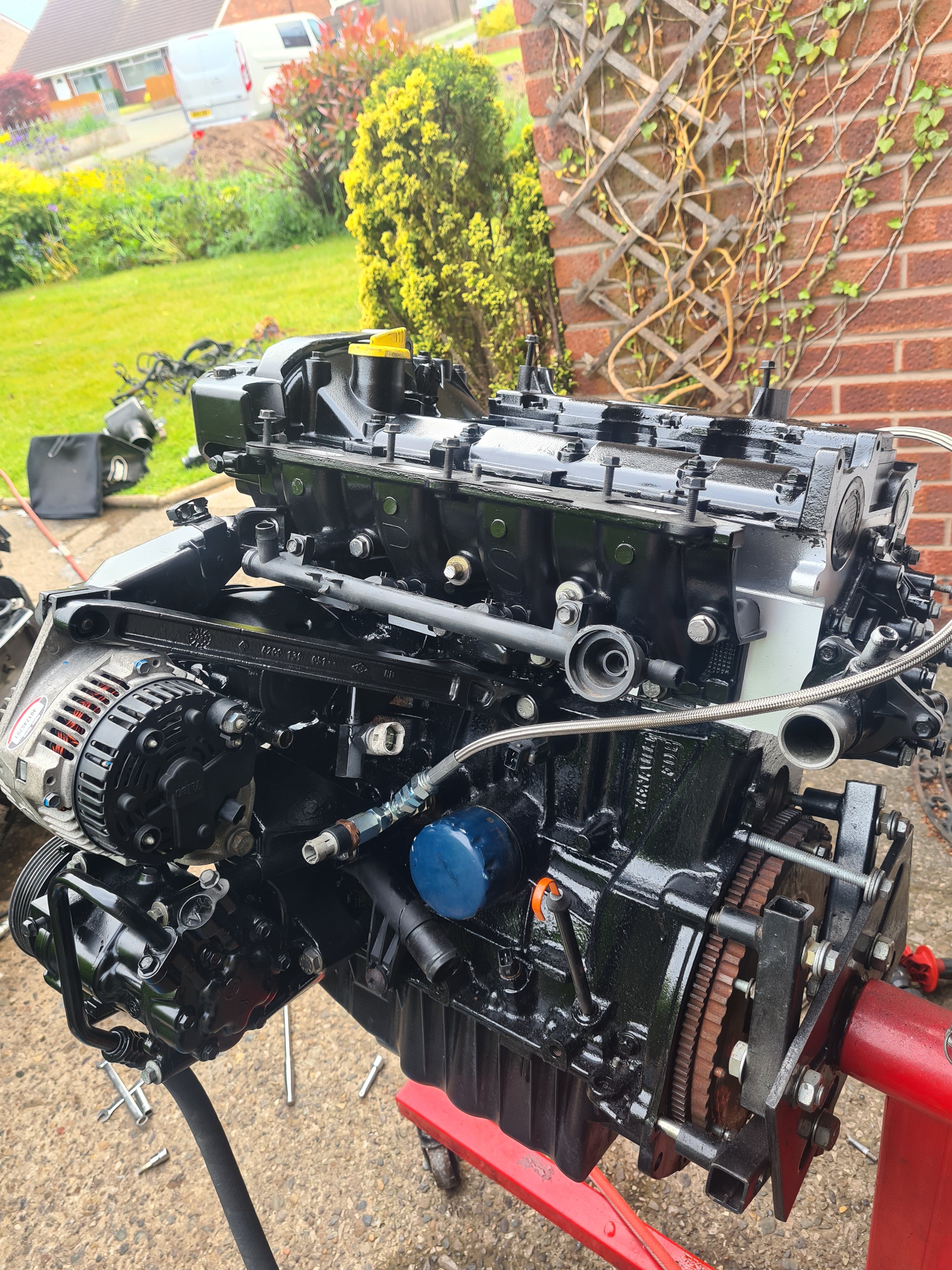

modified fuel rail to accept fuel pressure reg and return line
then got around to fitting the oil feed line i did order the engine dynamics one for 80 quid but it did not fit my turbo so tried to have a new fitting or new line made up and after much messing about with pirtek who basically just told me to go away and demon tweeks couldnt help either found a place 10 mins up the road who made a whole new line and fittings up while i waited for 20 quid M & R hydraulics in ellesmere port it was called id highly recommend them

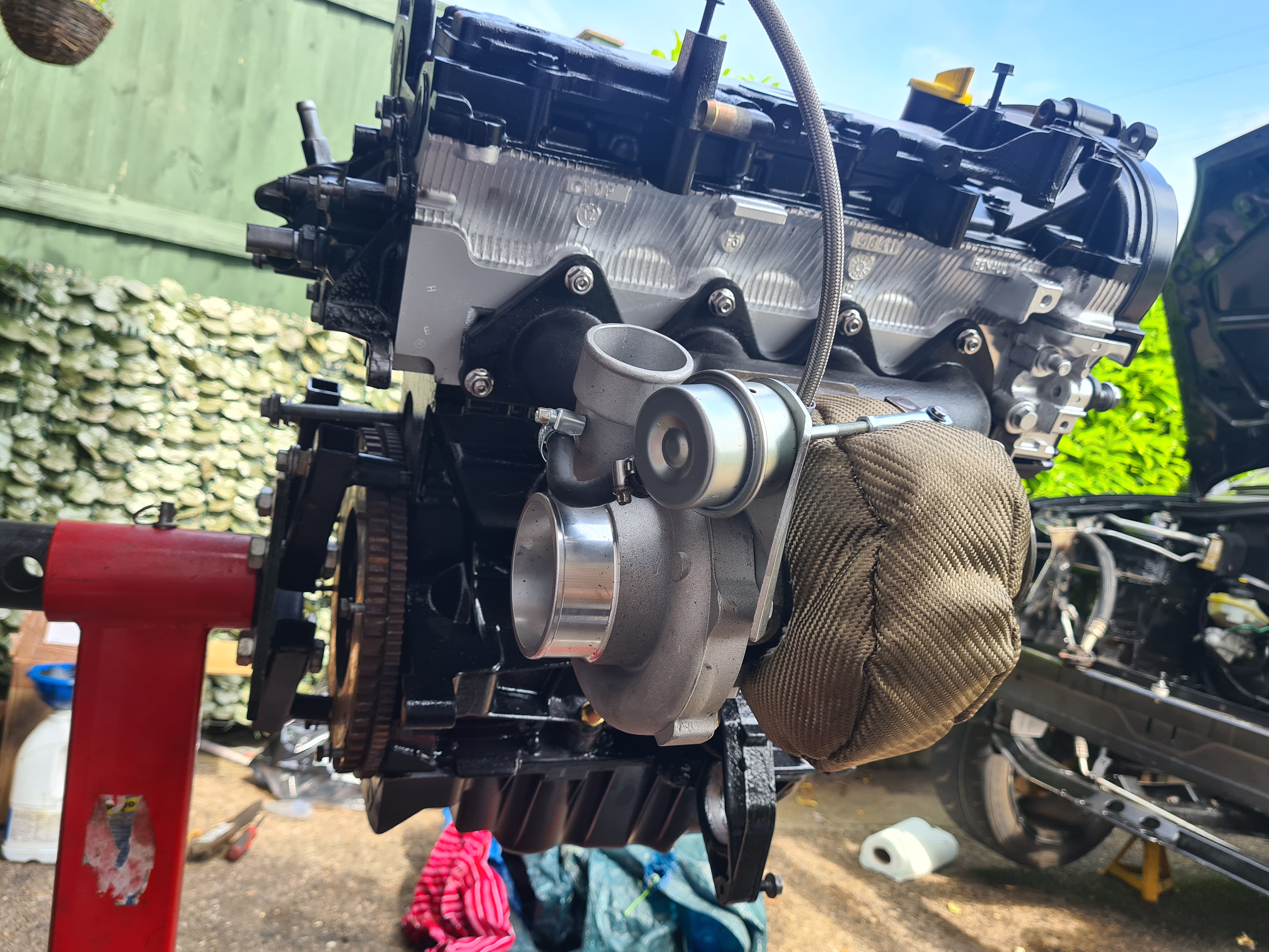

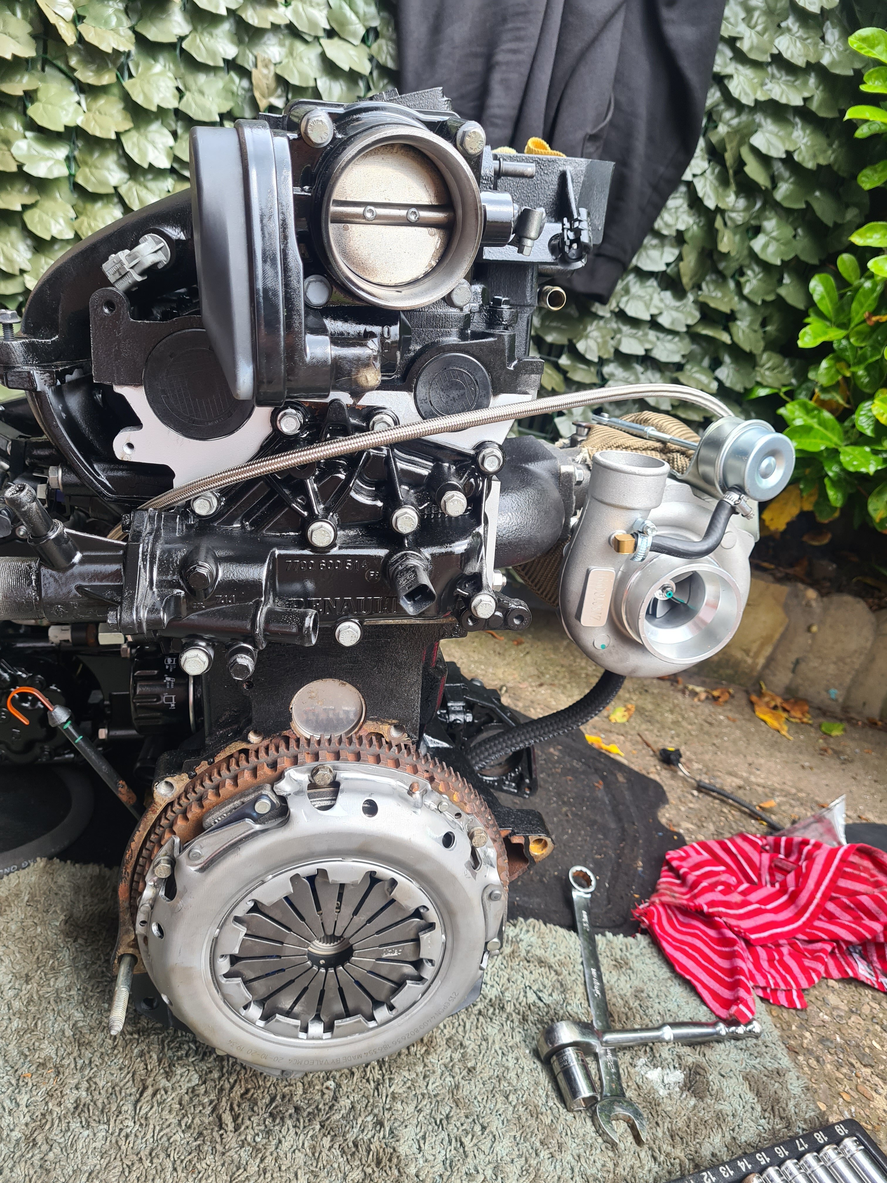

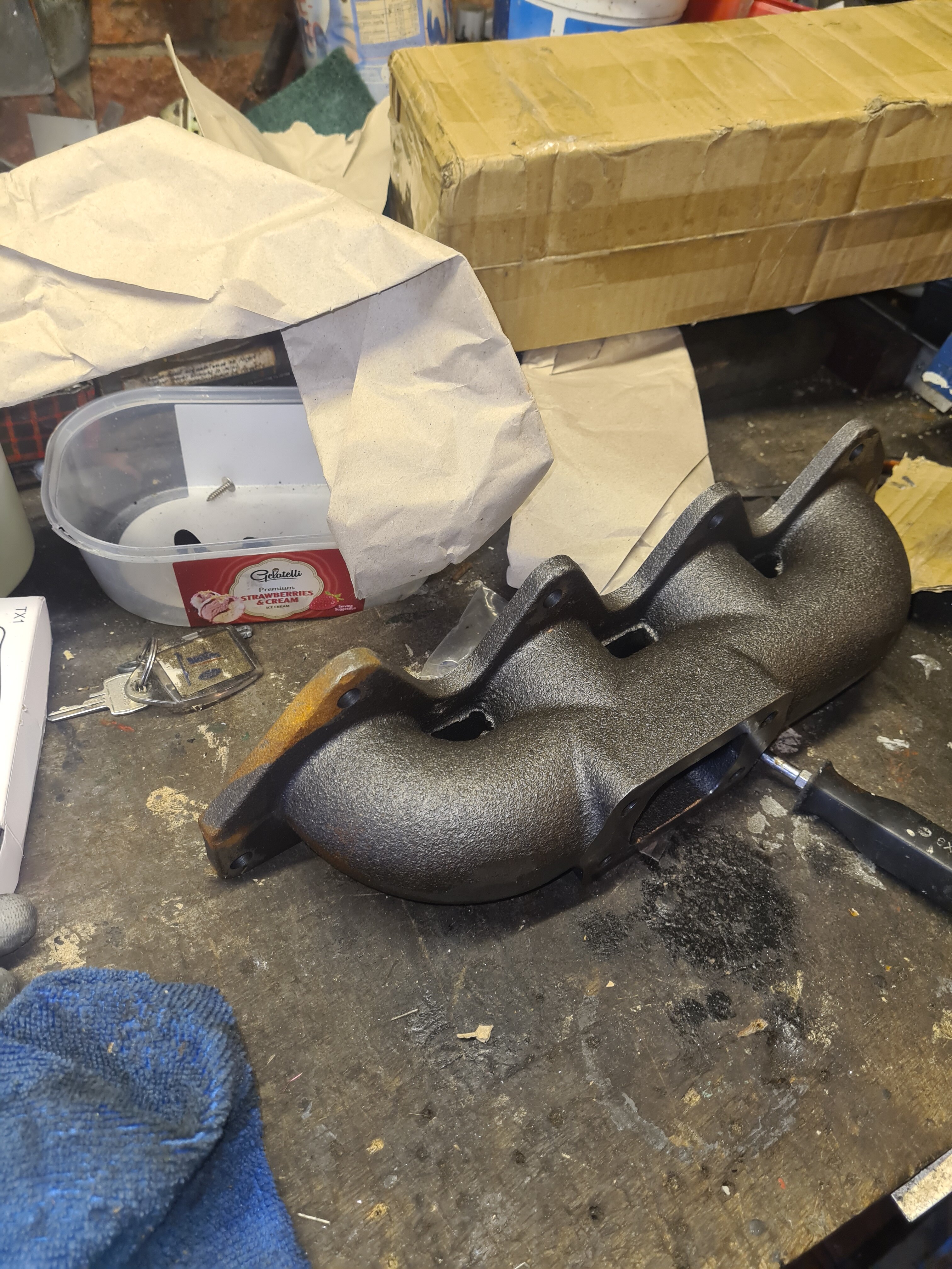

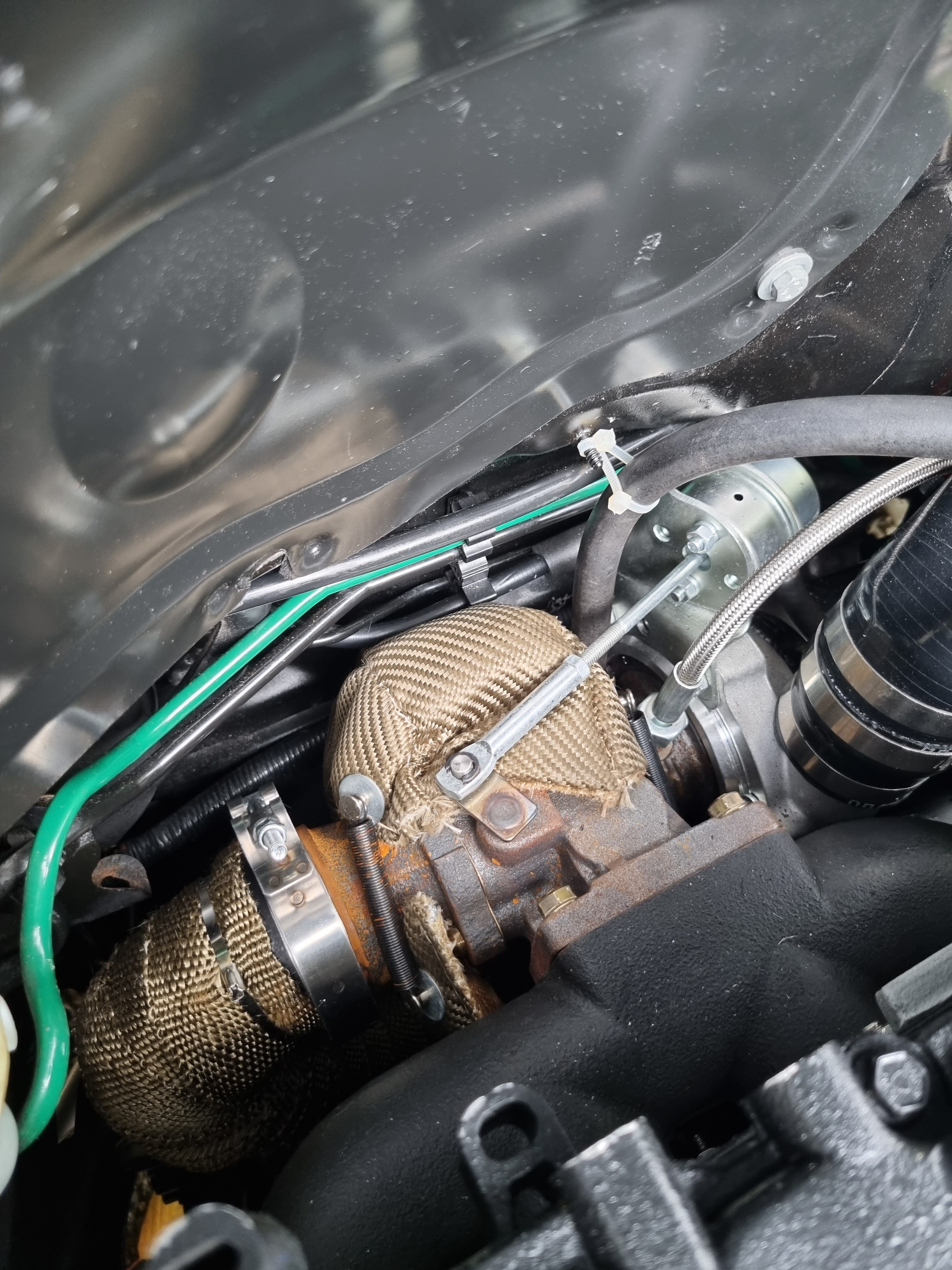

then got around to bolting up the log manifold and turbo with a new gasket, studs and nuts
had to give it a lick of paint first tho as thats how it looked before hand 😂

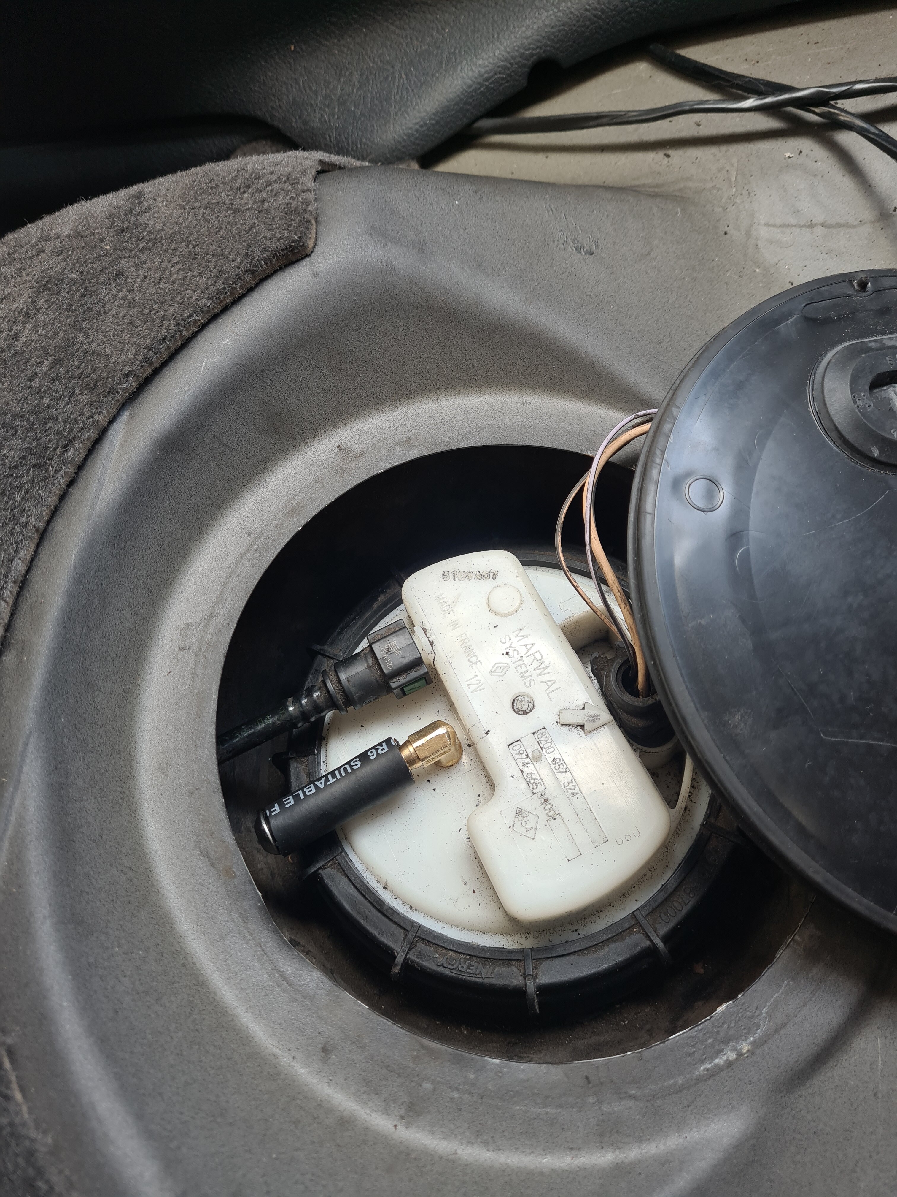

modified fuel pump assembly to accept fuel return line did this bit while i was waiting for parts to turn up if anyone was wondering what the little piece of blocked hose is for 😂
I also blocked off the fpr but i dont seem to have any pics of that

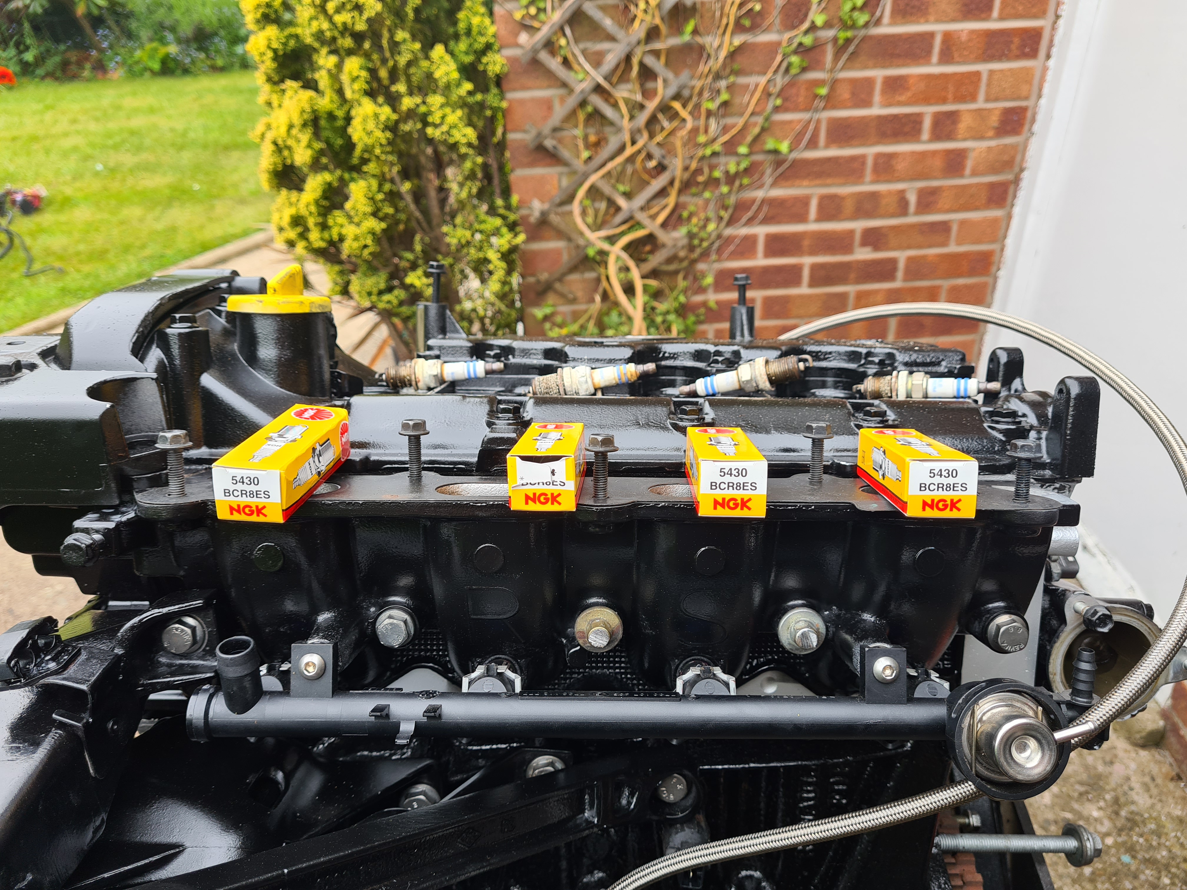

New plugs n oil filter fitted
engine dynamics paddle clutch kit fitted

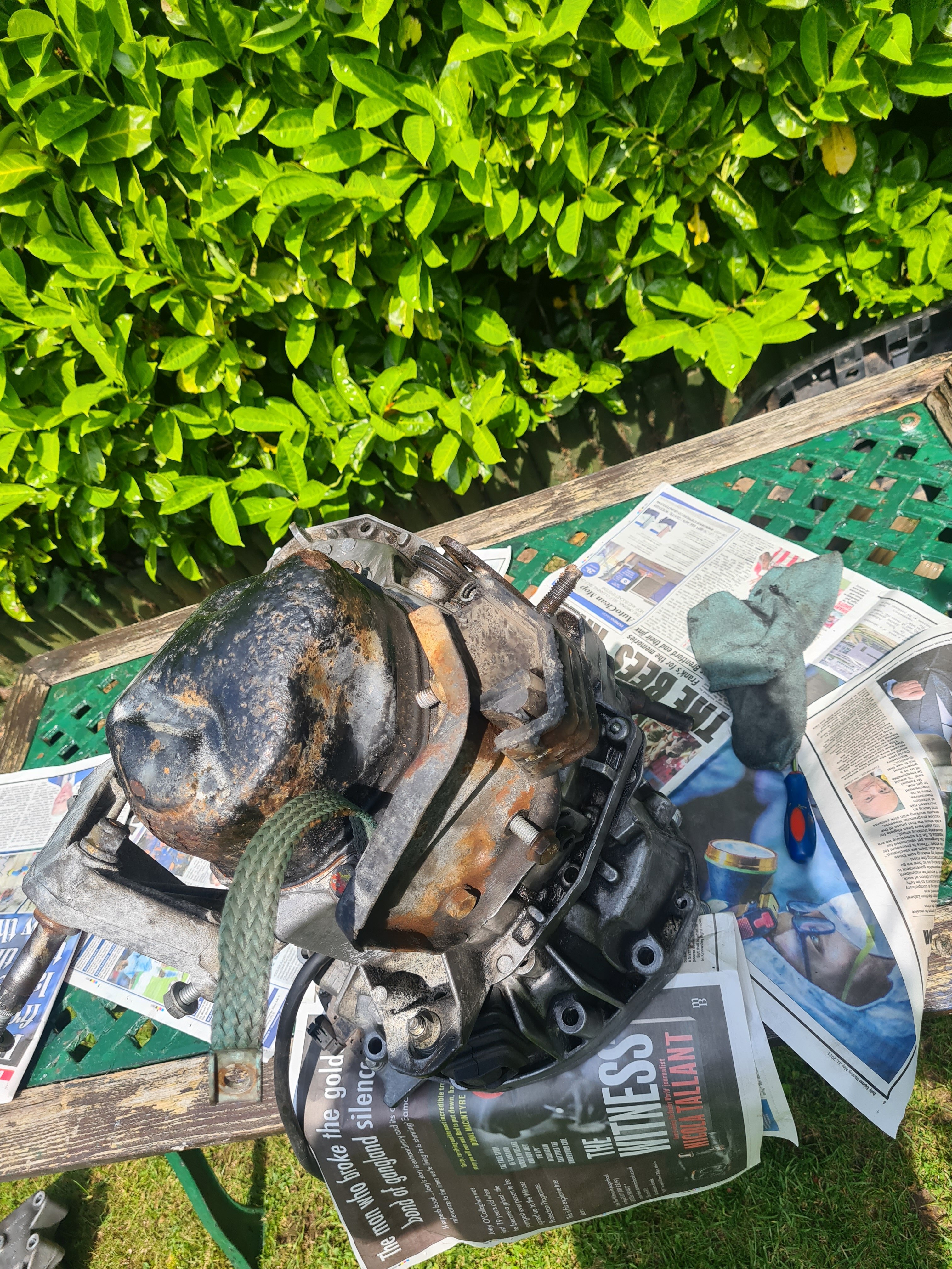

While the gearbox was off thought it would be rude not to give it a lick of paint
heres how it was looking before
Came up looking pretty well

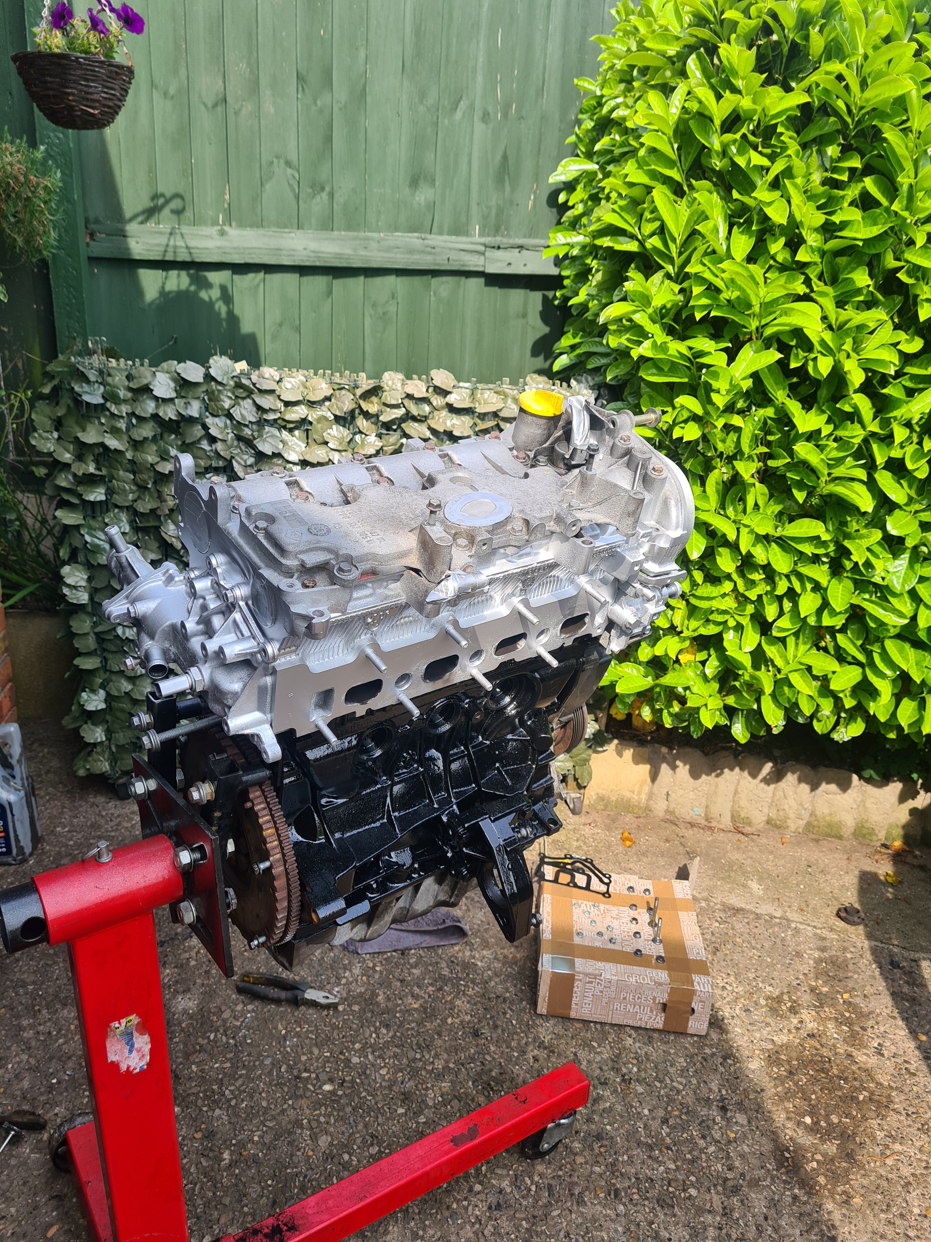

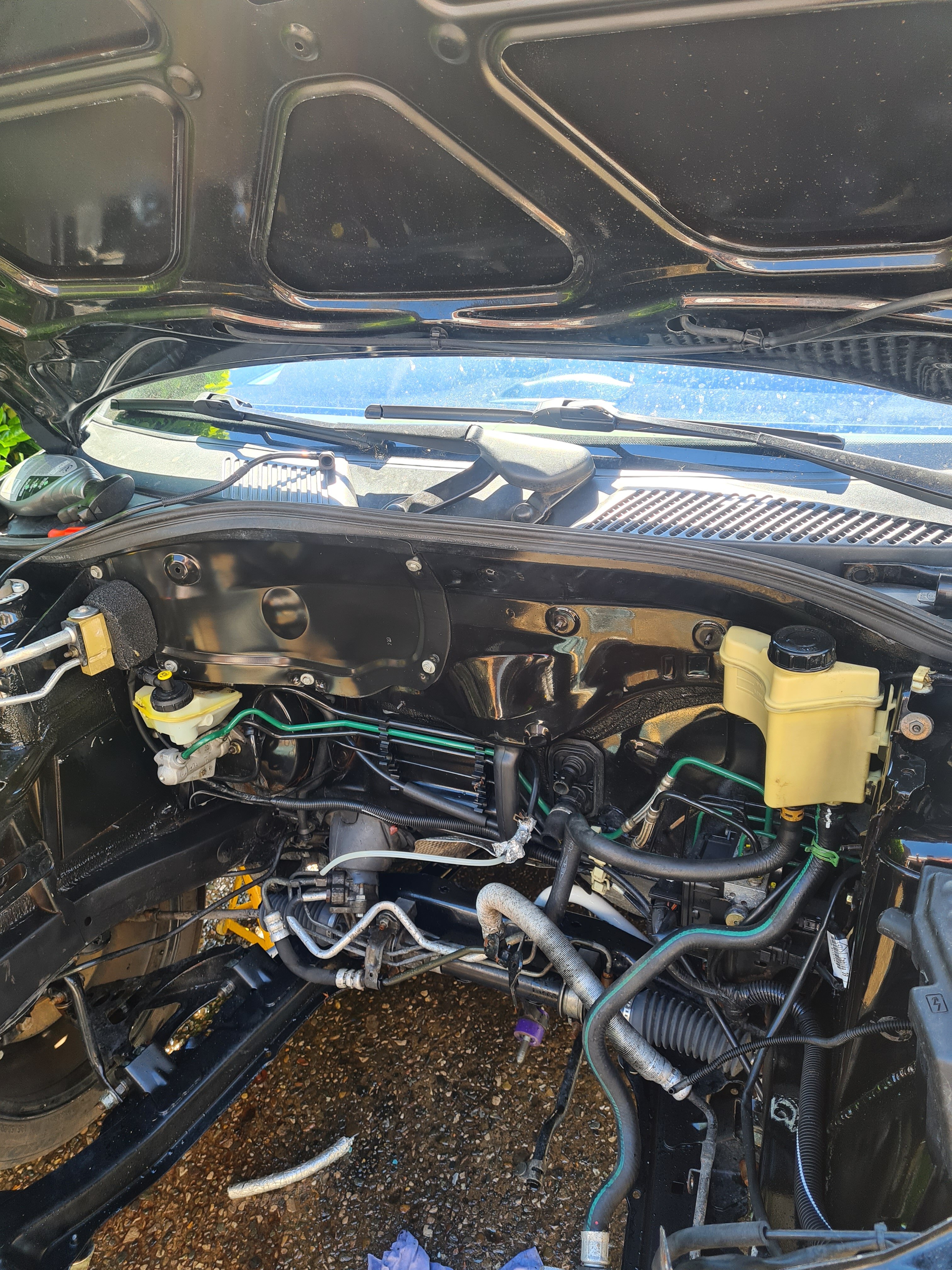

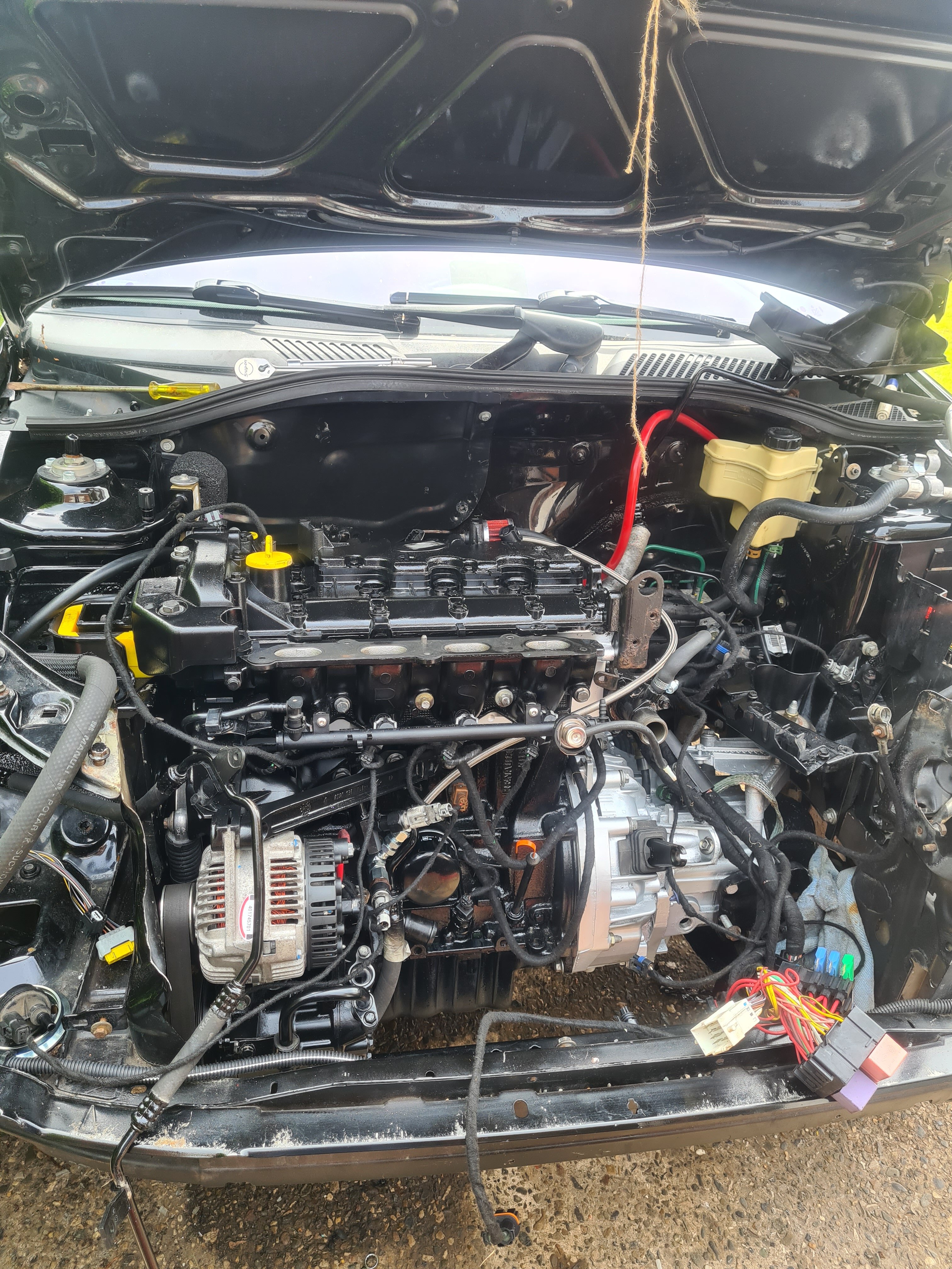

After about 3 days of prepping and painting parts the engine finally went back in onto the mounts

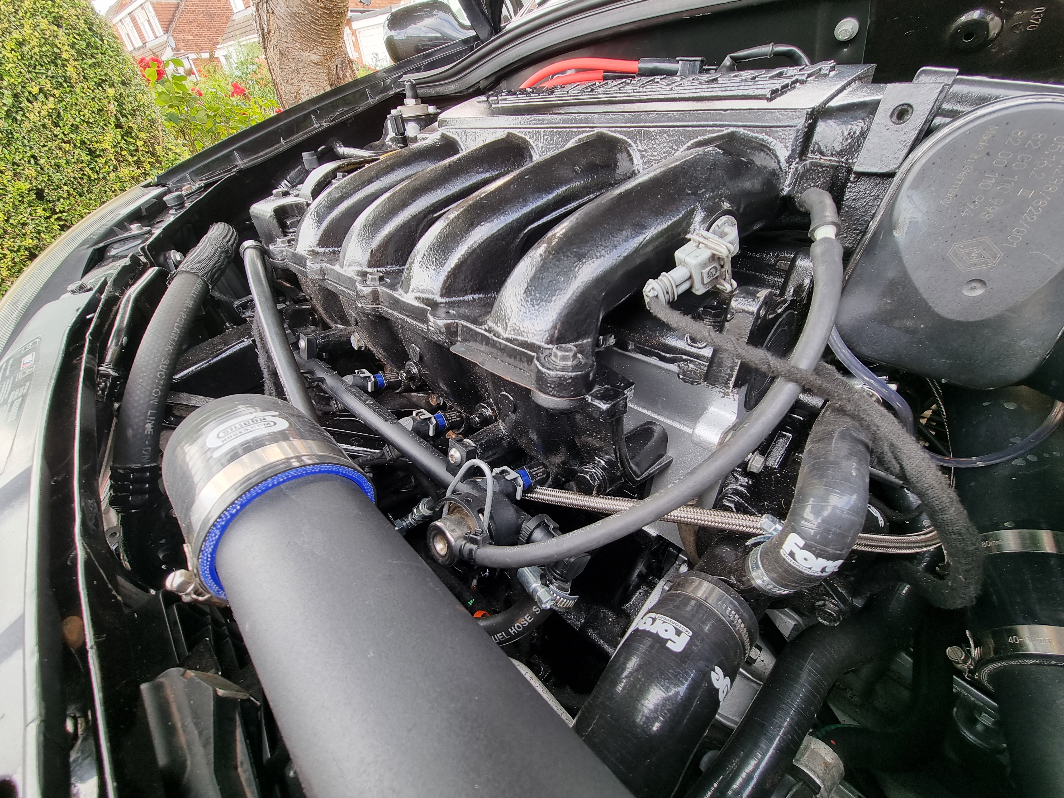

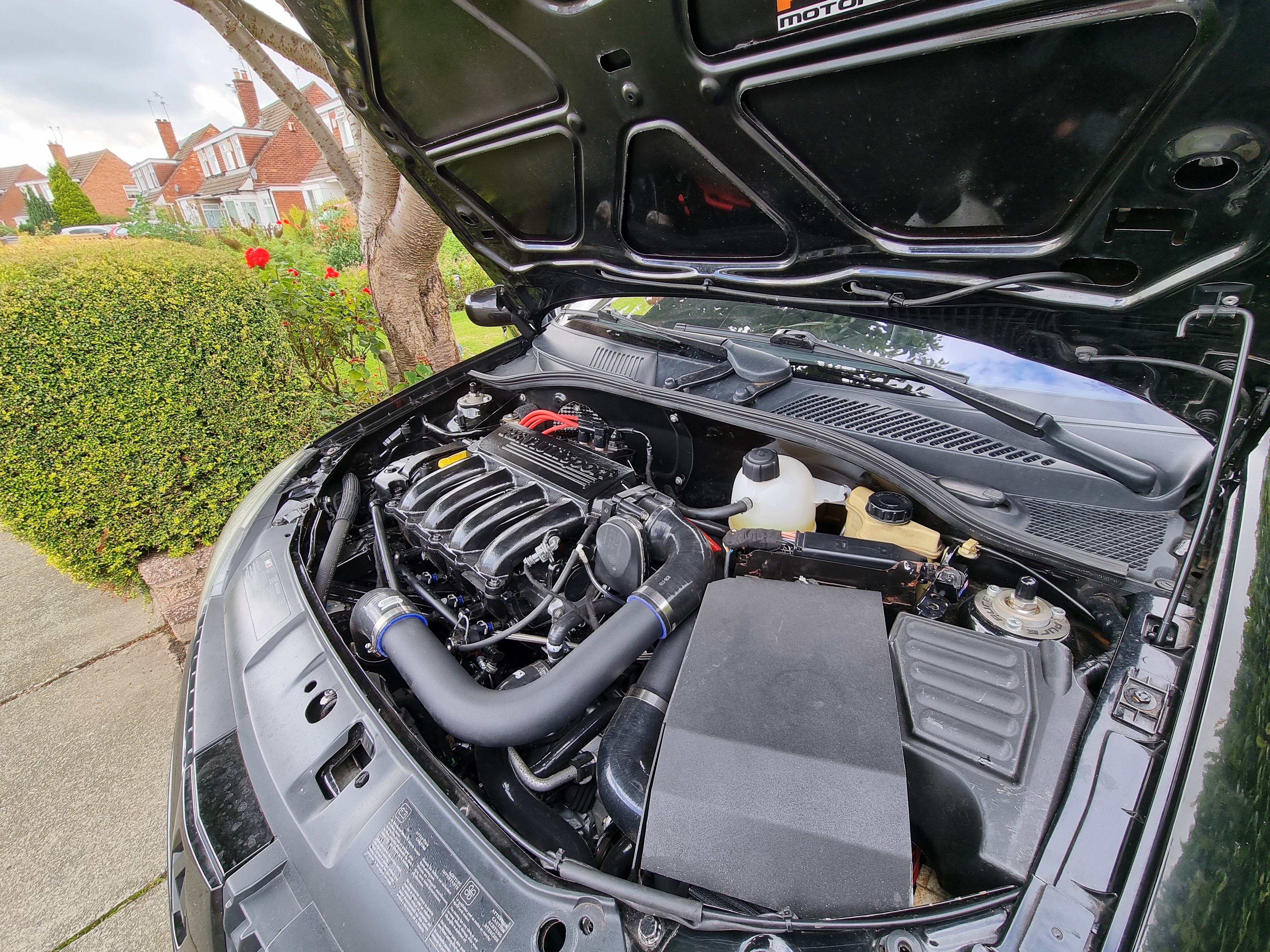

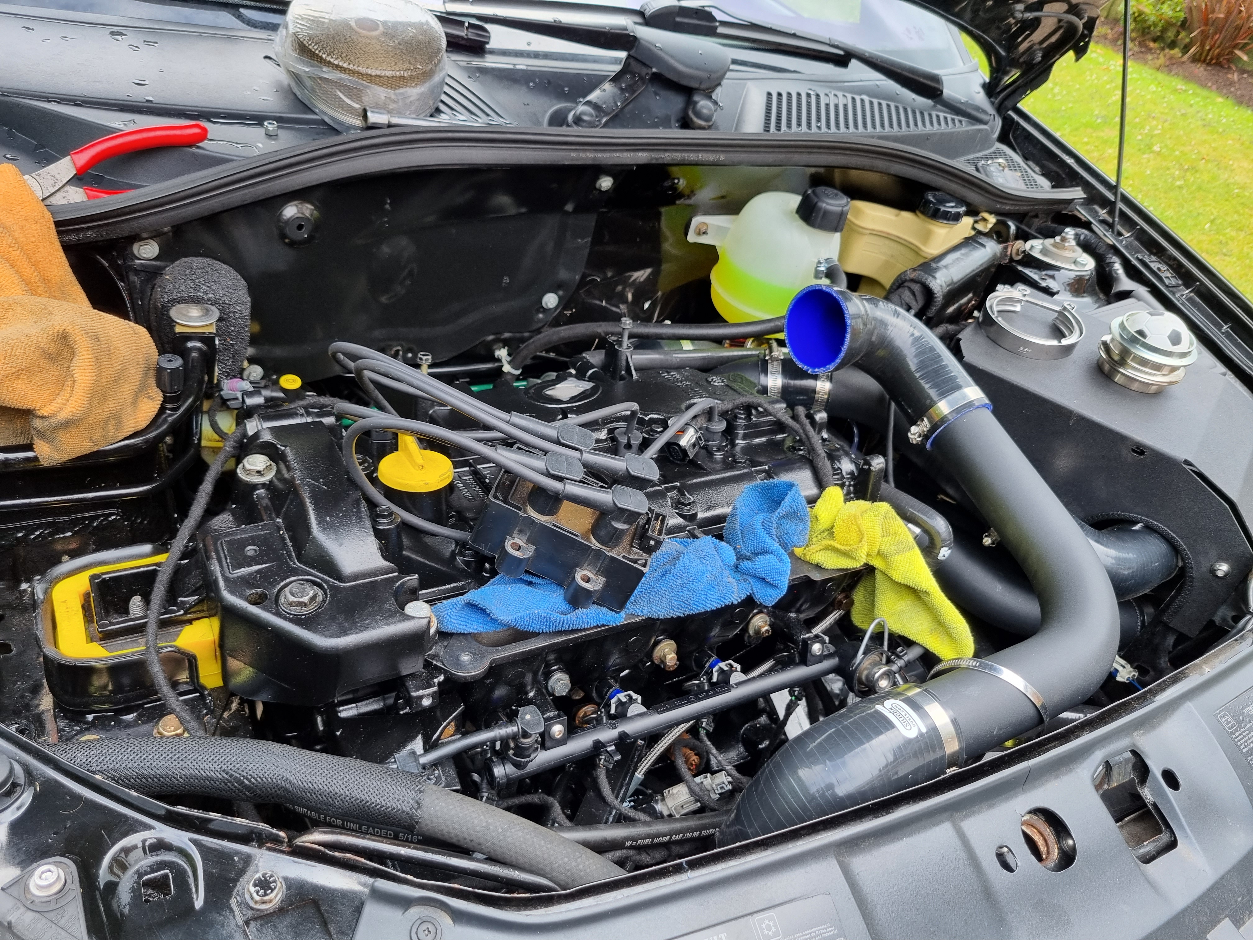

then got around to fitting a forge coolant hose kit in black, a new header tank and some fresh type d

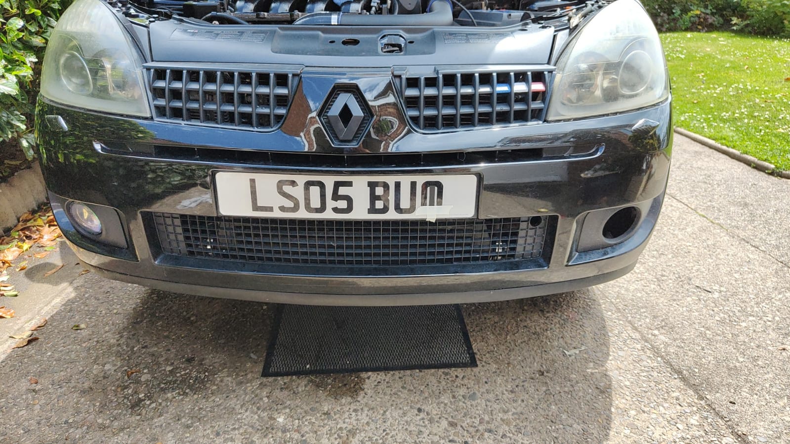

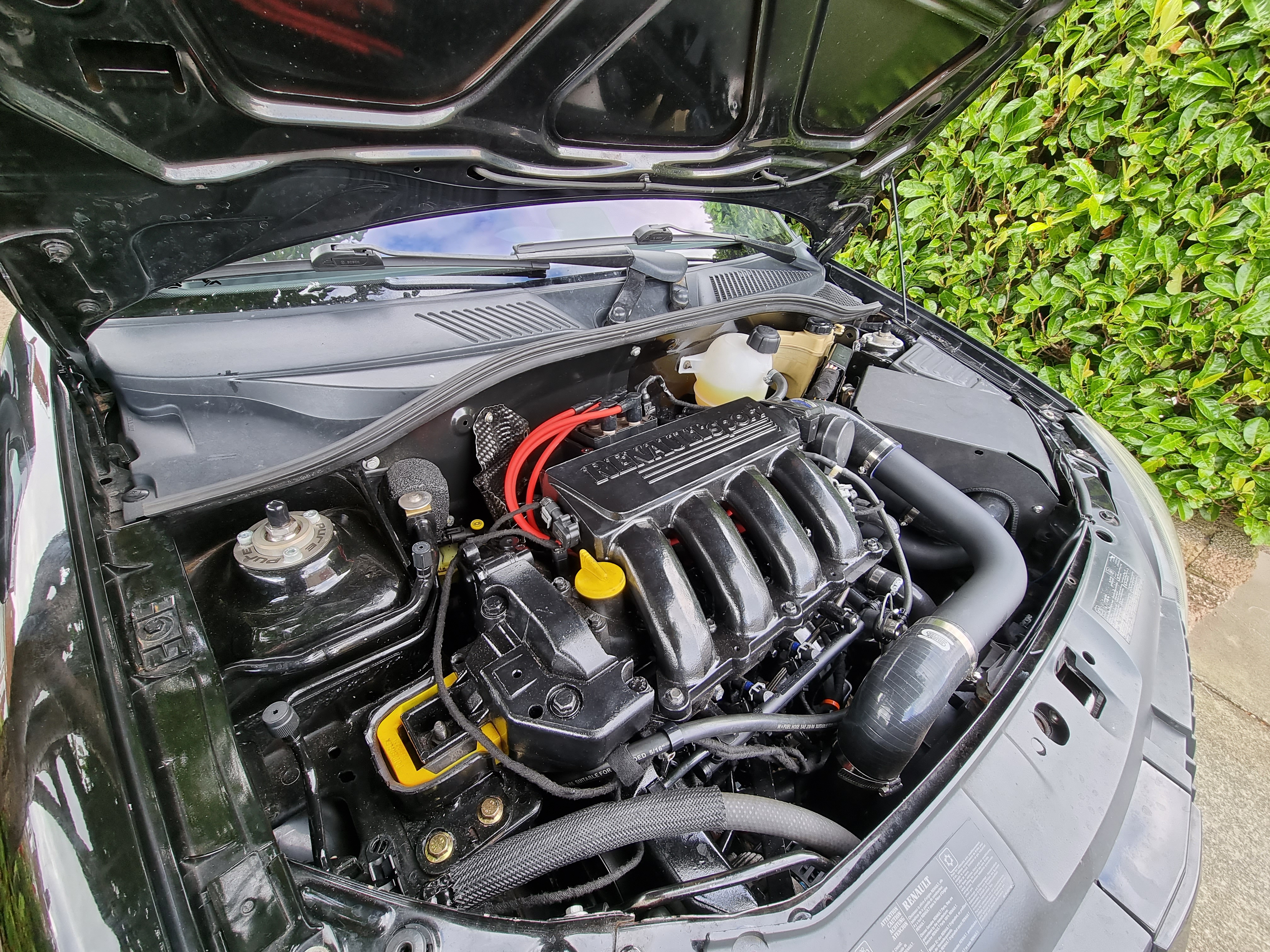

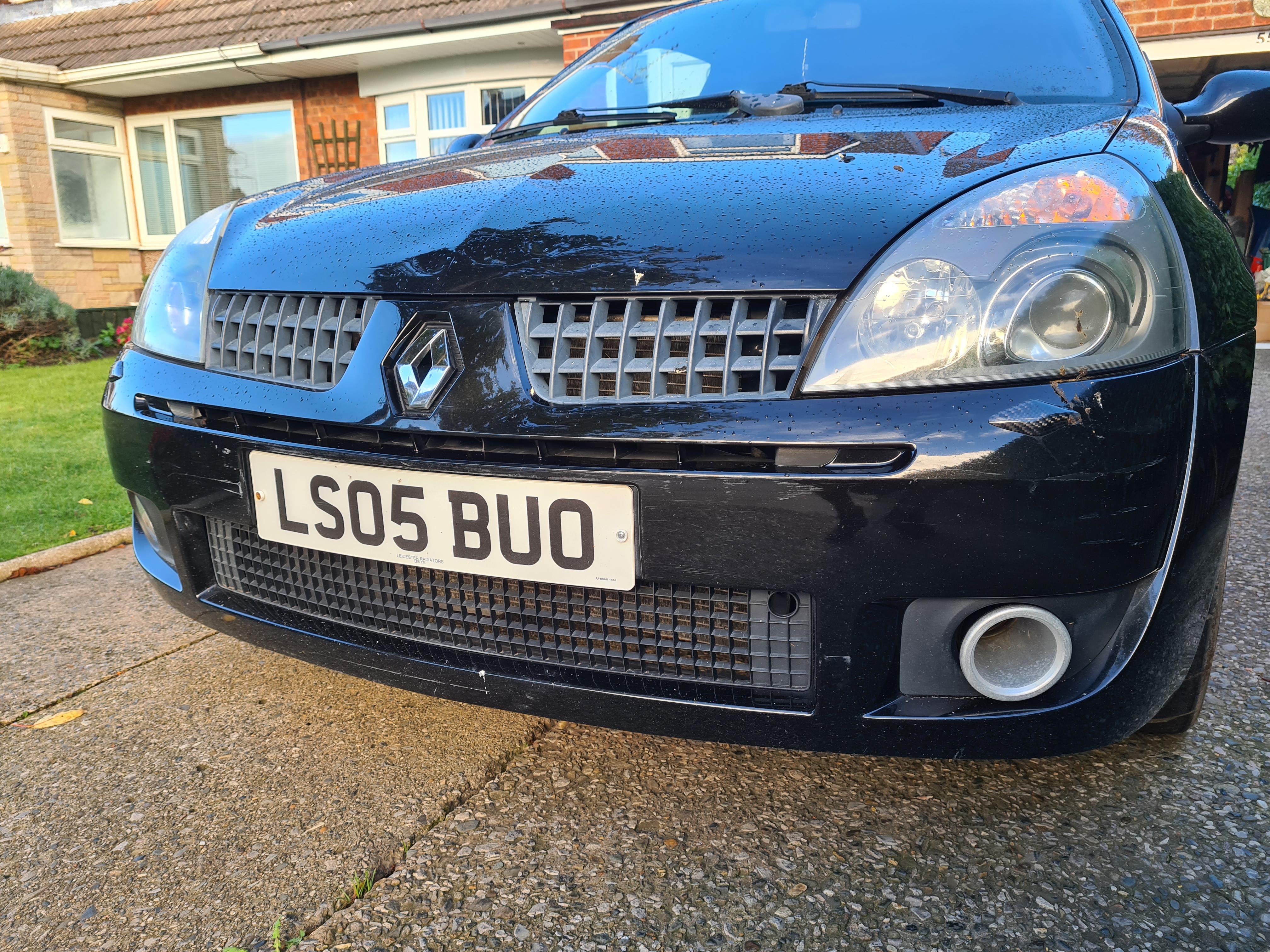

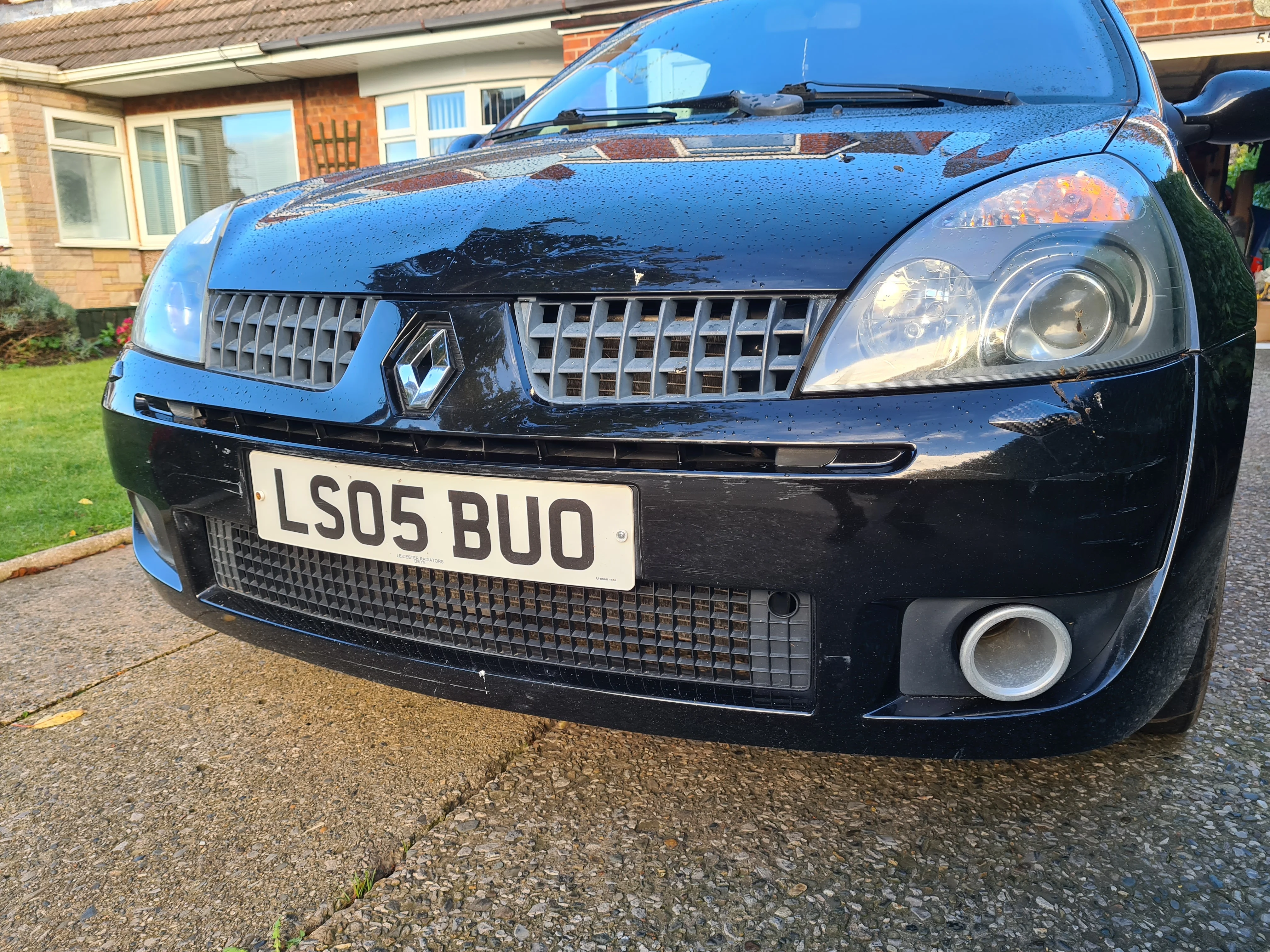

Also fitted the ebay intercooler and started clamping up the pipework
ordered a 2.25" ebay kit for around 60 quid thought id rather cut and chop that than paying 300 odd quid for a engine dynamics kit although i did have to spend qbout another 50 quid on hoses to get it to work. Pic of the intercooler bolted up. Thought i had a pic with the bumper off but i cant seem to find it pretty straightforward to bolt up though bought some m8 threaded rod and drilled the crash bar. Theres already 2 holes that line up perfectly with the mounting holes on the intercooler

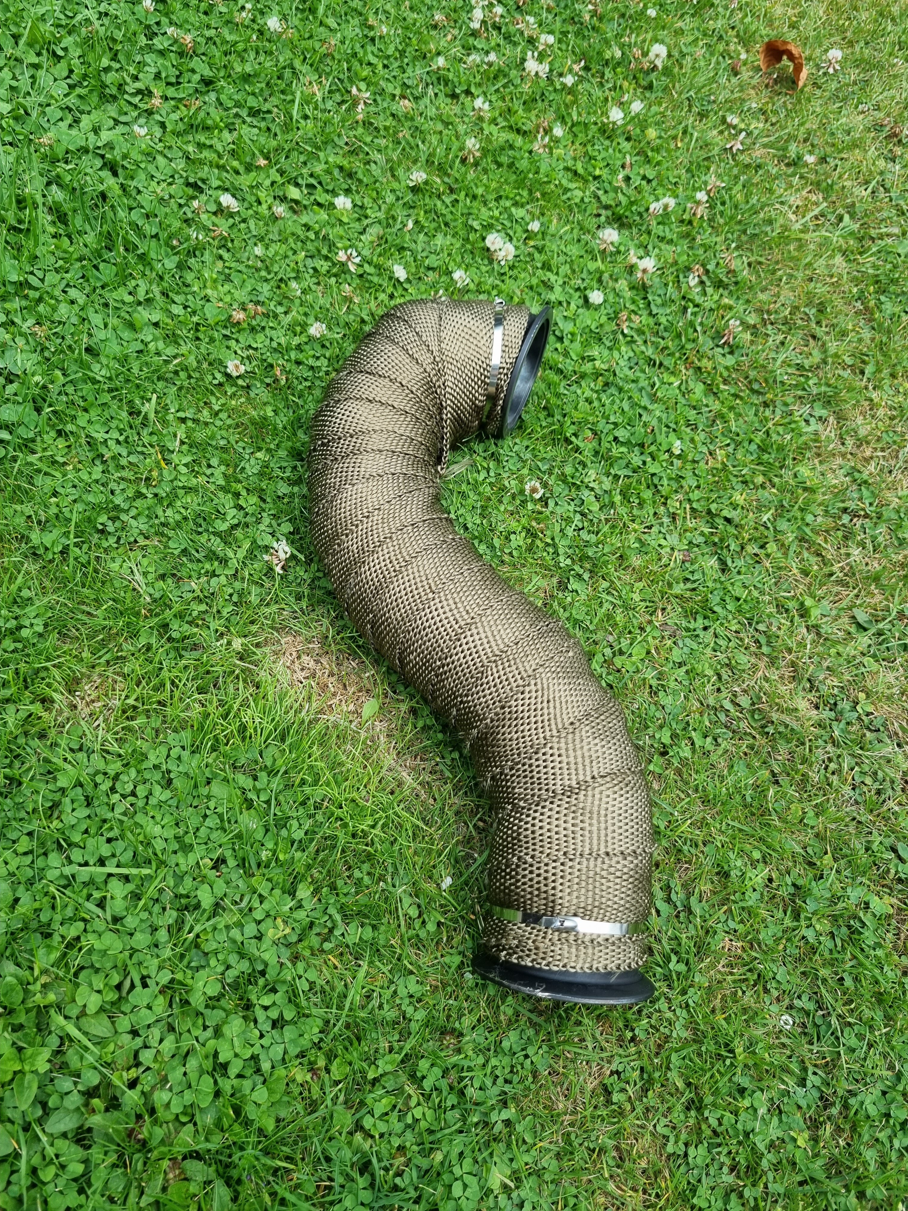

Diy turbo downpipe cost around 40 quid after buying v bands and some mild steel although it needs re-doing as for some unknown reason i thought id have enough room routing it under the subframe rather than above and its now it scrapes on the smallest of speedbumps 🙈
downpipe and turbo set up i did have to change that actuator too as it wasnt made for something running about 7 psi of boost 😂

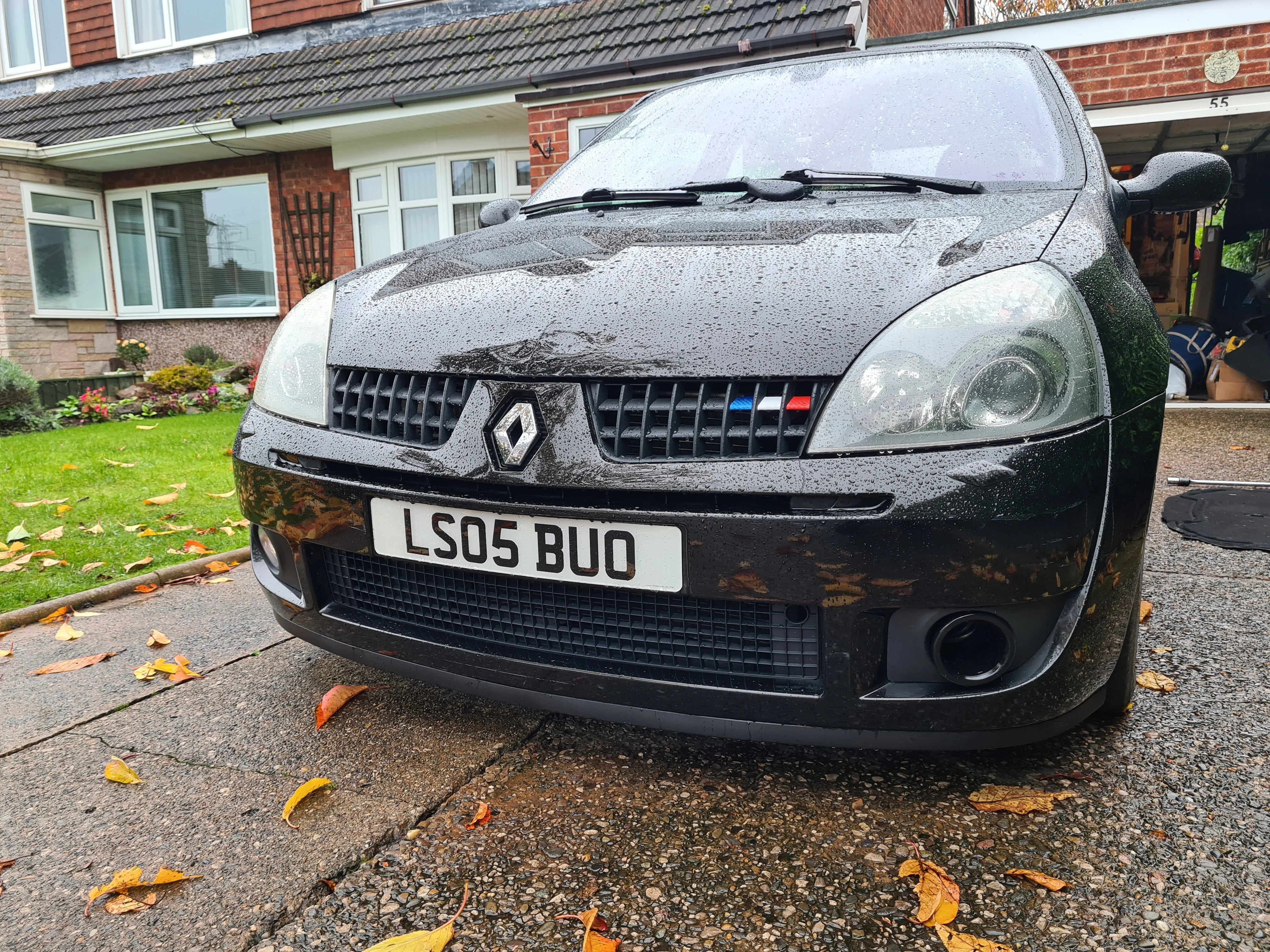

few pics of the car all back together and after giving the inlet a lick of paint
Also had to wire in the efi forced induction module. Probably forgot loads of stuff as well but Anyone thinking of turbocharging there clio do it. I absolutely love how it drives now

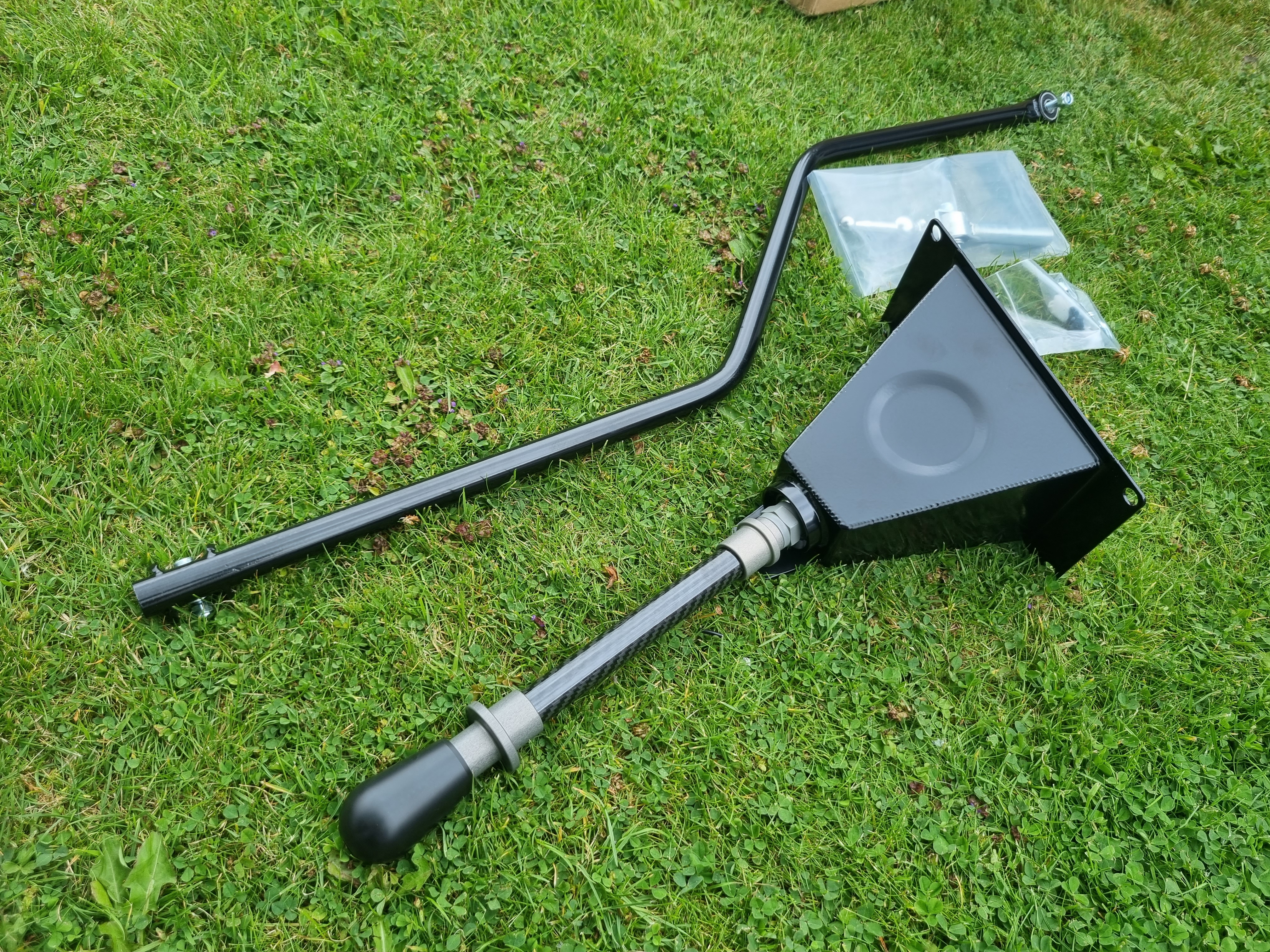

Had to treat myself to a pms shifter as the sloppy gears let the car down in my opinion

One question that goes back to the start of your thread, why were you advised not to drop the rear axle mounts off? Is it in case the bolts snap off?
It's pretty fun at this power level I wont lie and for the relatively cheap cost of doing the conversion well worth the money. Its been a while since I dropped the rear axle but yeah pretty sure I read the bolts that secure the bracket to the chassis can snap so I left them alone all came out fairly easily
But that’s where a lot of the corrosion is hiding. For a tidy up fair enough, to stop the rot setting in, brackets off.
