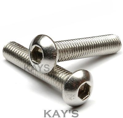

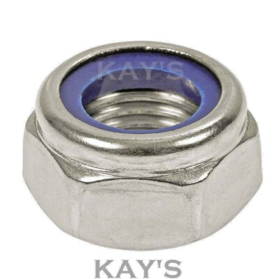

The side skirt sits over the arch liner, no need to remove them to get the skirts off. If the head has snapped off and the rivets are drilled out of the skirt it should come away. If I were you I'd refit the skirt with small dome headed stainless bolts with unlocks instead of rivets so you can annually remove for maintenance
Could you provide the details of the "dome headed stainless bolts with unlocks" so I can get a set. Your idea is a good one so I can keep the maintenance going and keep an eye on things every year or so.

I used small stainless washers as well, form b or c, can remember
Cheers I've got them now. Just need to finish off the paintwork before fitting the sideskirts back on again. Will be handy to be able to take off every spring to give it and behind the fuel cap a good wash out 👍🏻👍🏻
