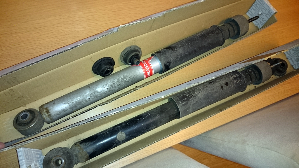

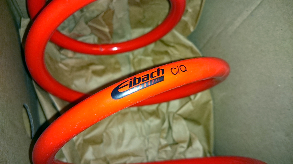

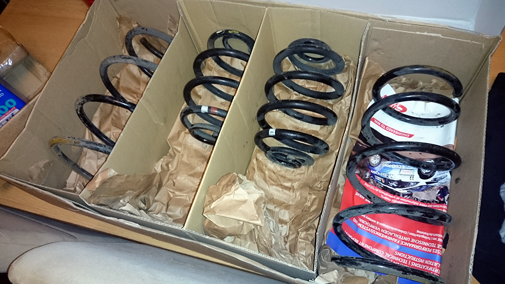

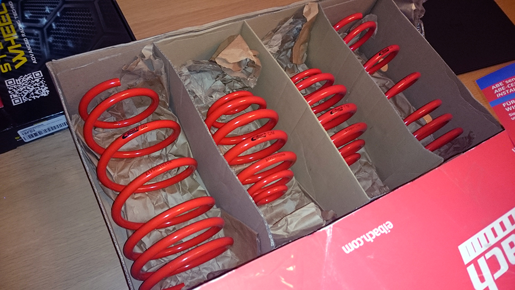

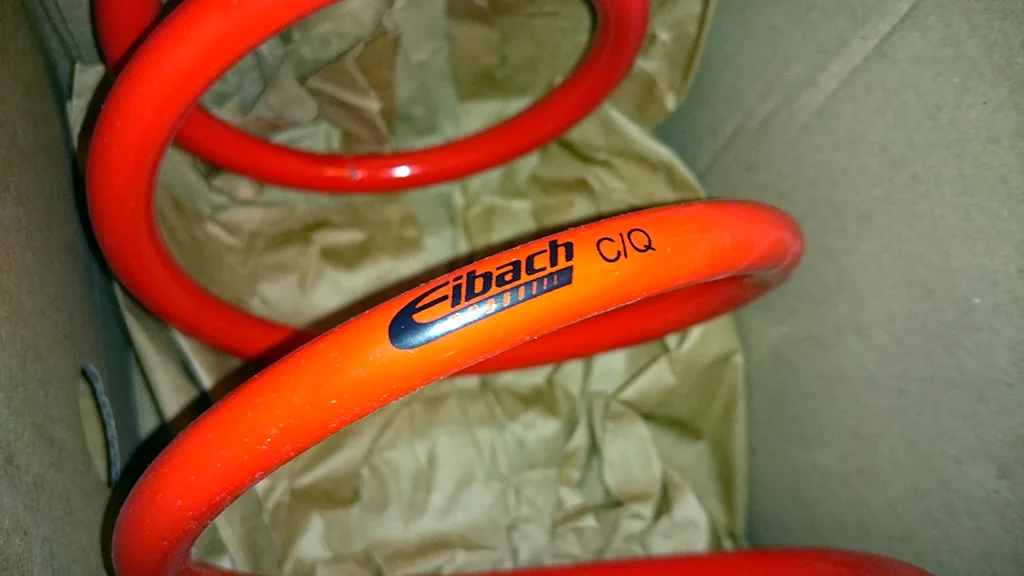

Eibach Sportlines have arrived as well as new cup front and rear shocks. Nearly getting there with all of the parts now!

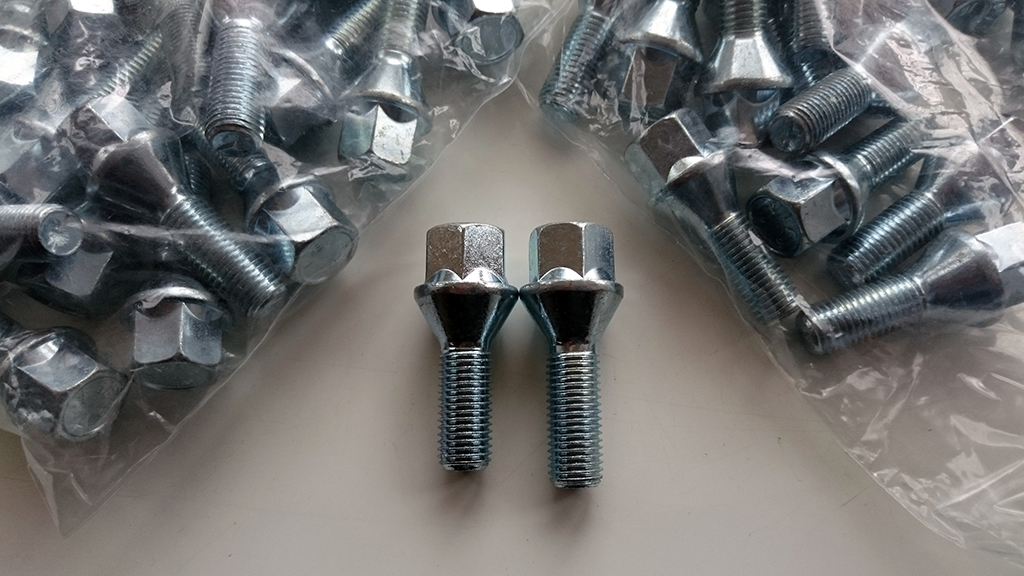

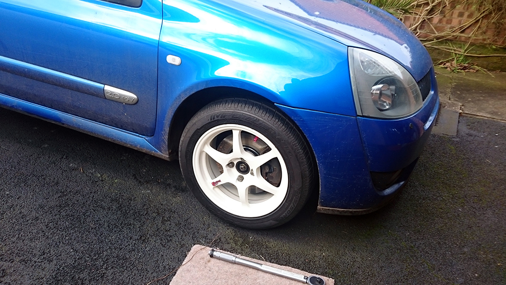

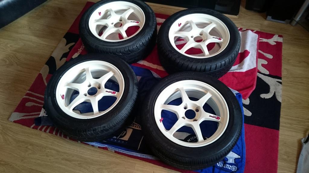

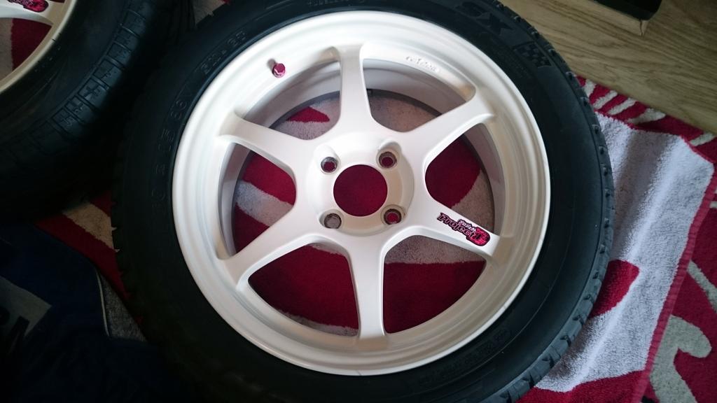

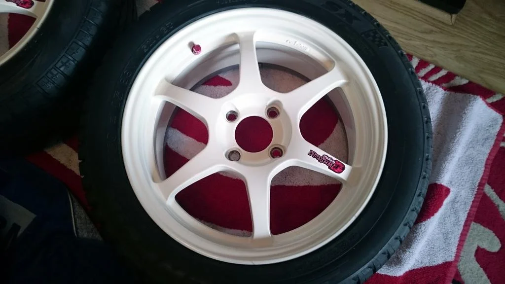

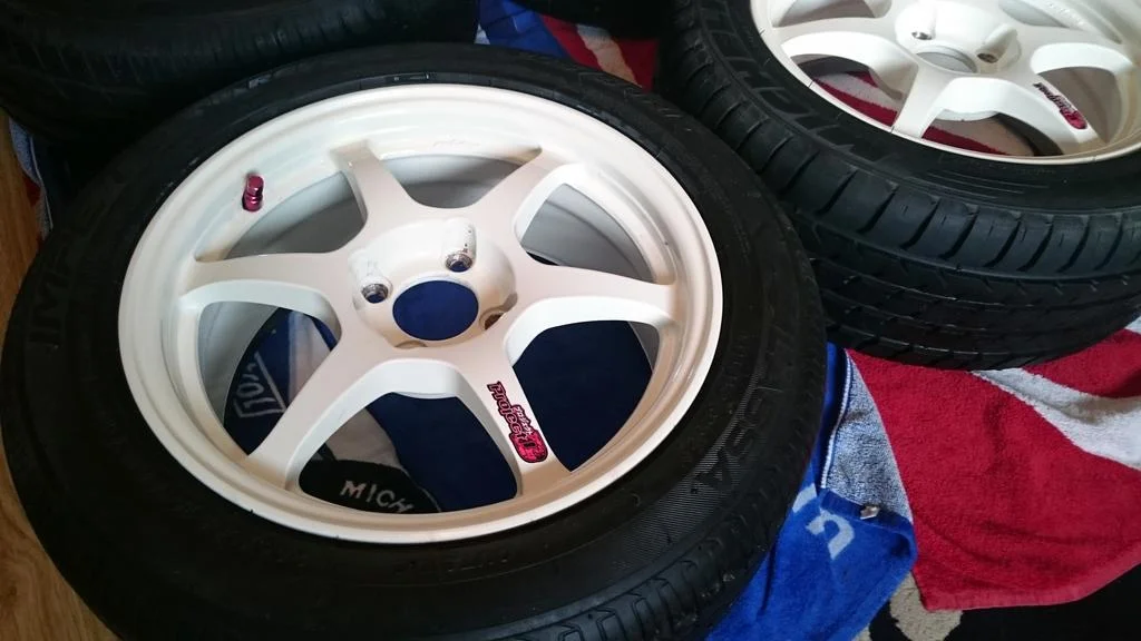

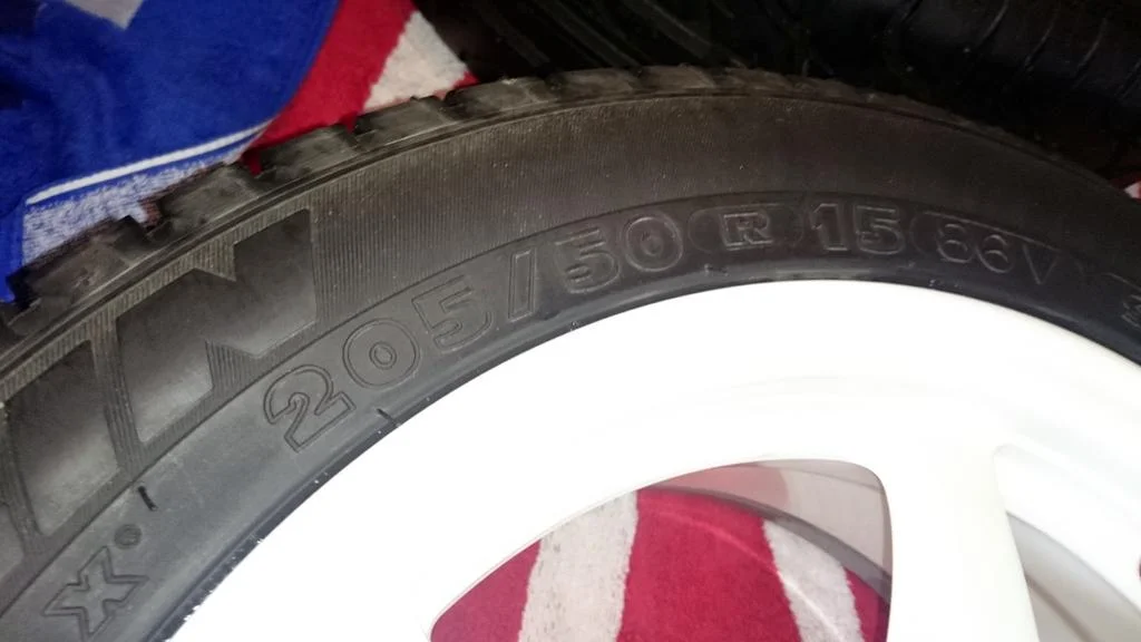

I've picked up some wheels today for a bargain on eBay. They've been recently refurbed in white (not ideal for cleaning) but look decent for the price. I just need to get some decent tyres sorted now, which shouldn't take long.
Hopefully the OEM wheel bolts will fit too!
They're Lenso Spec-C I believe. Not the worlds greatest manufacturer, but I'm lead to believe they're pretty strong.

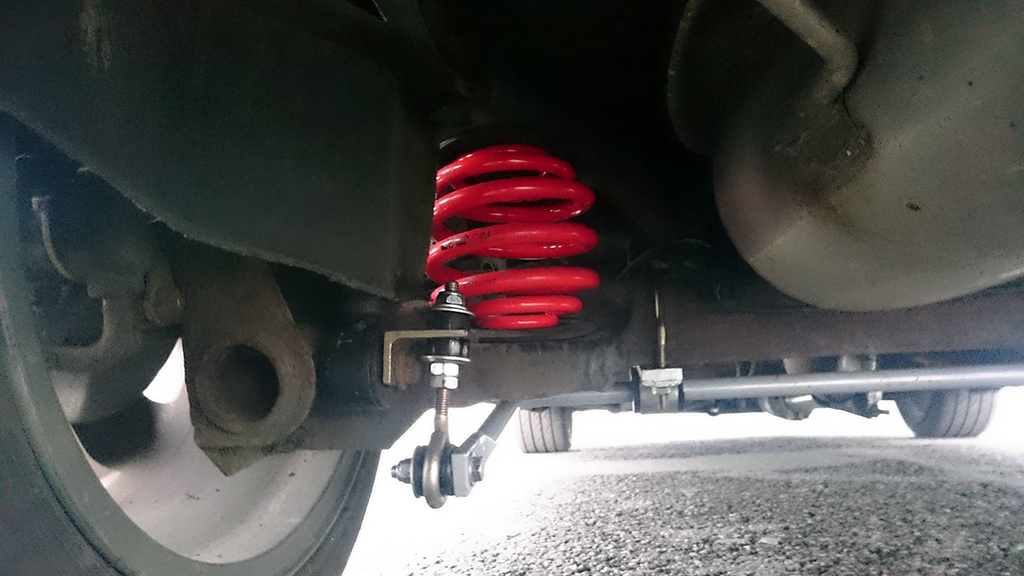

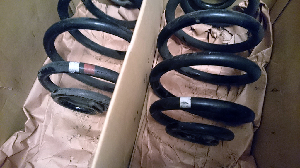

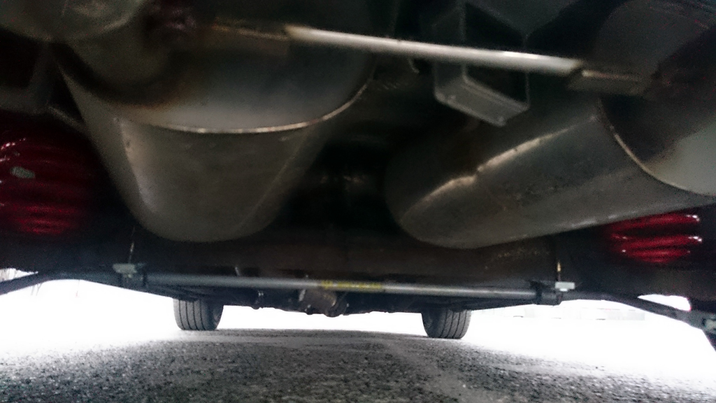

Finally some proper progress. Over the last few weeks the car has had most of the parts fitted and the handling feels good for the first time (although the tyres are shite). I think the main problem can be seen in the photos below, odd rear shocks and odd cup/non cup rear springs. That can't be good?!? Why would people just change 1, and then for the wrong one!!
No wonder the rear of the car felt awful!
Anyway, the car has now had:

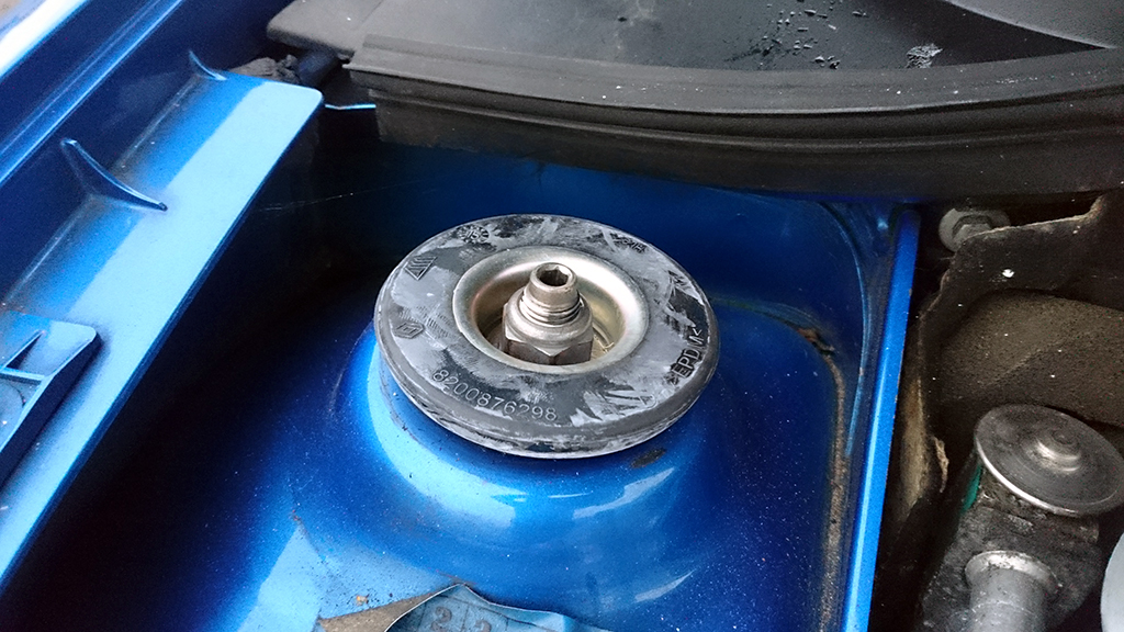

  • New Style Front OEM Top Mounts

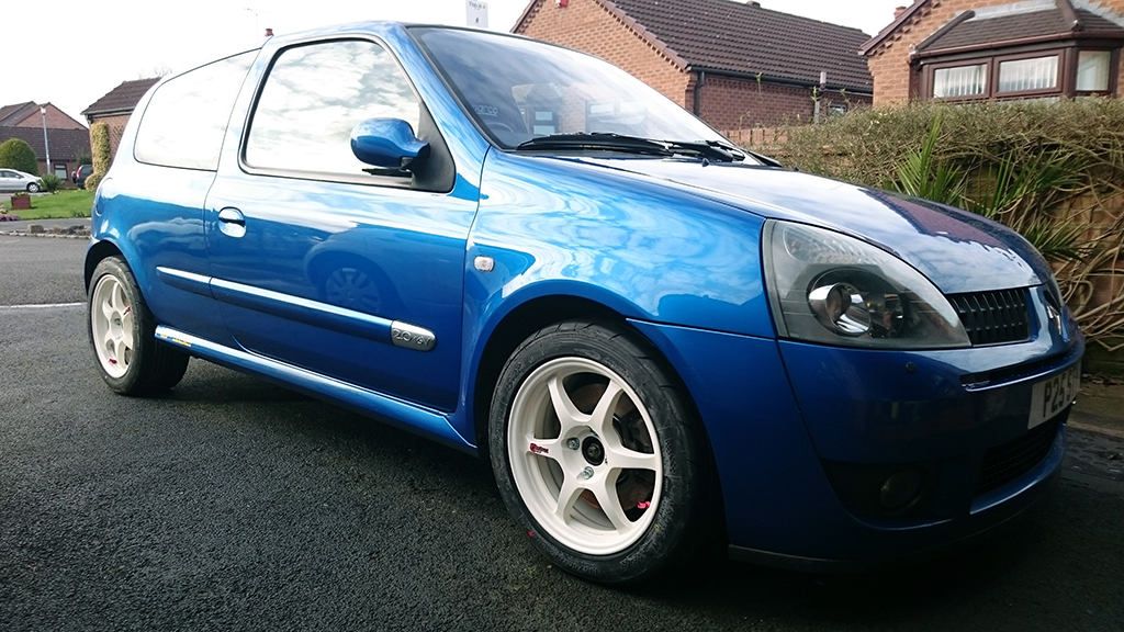

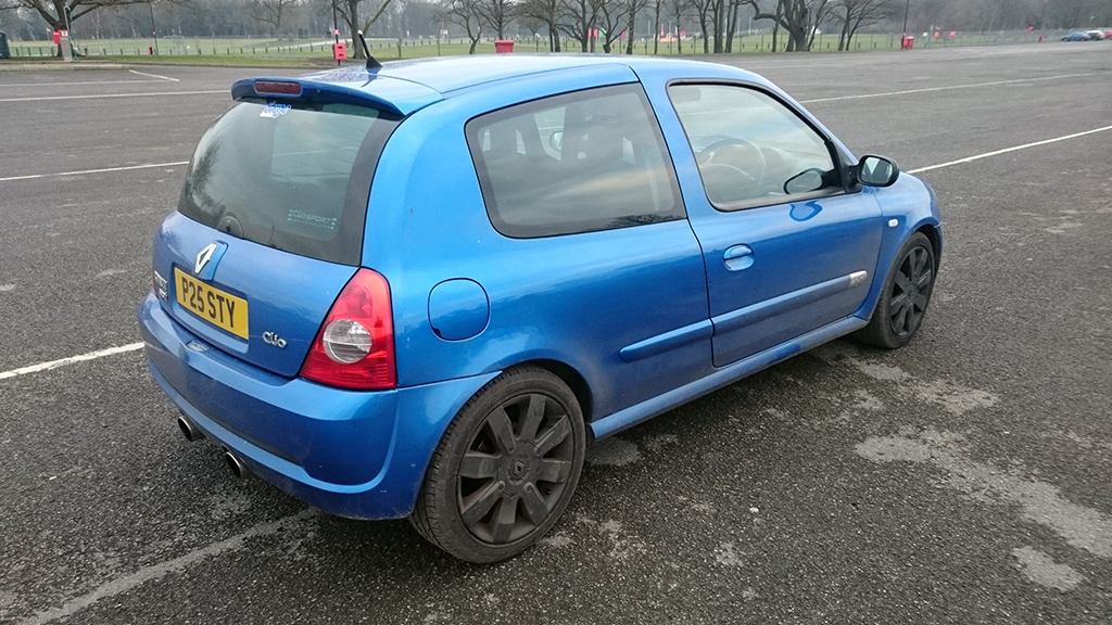

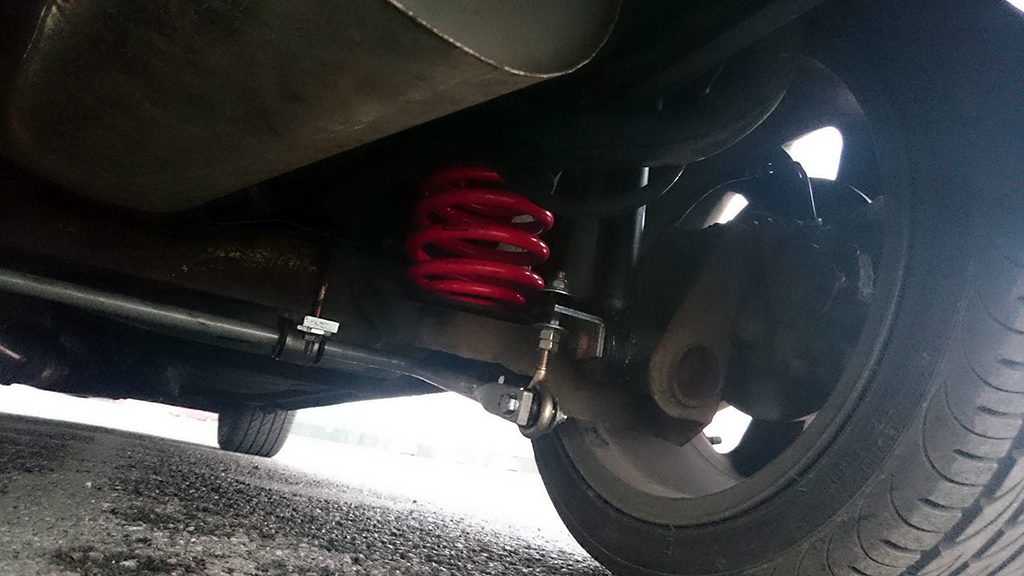

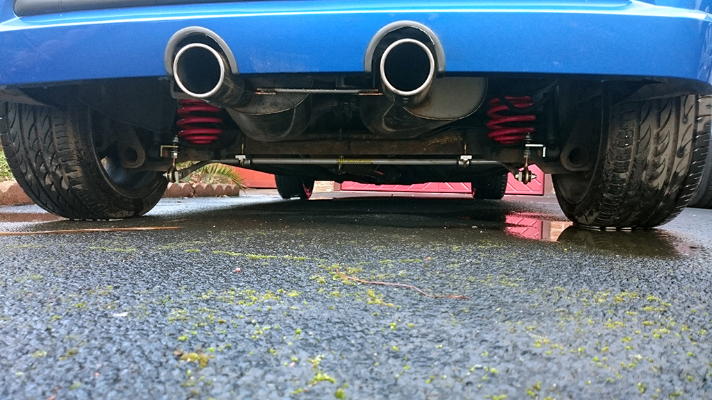

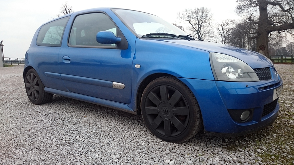

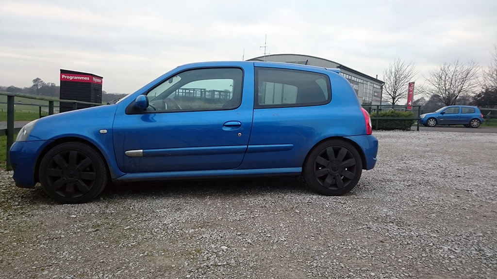

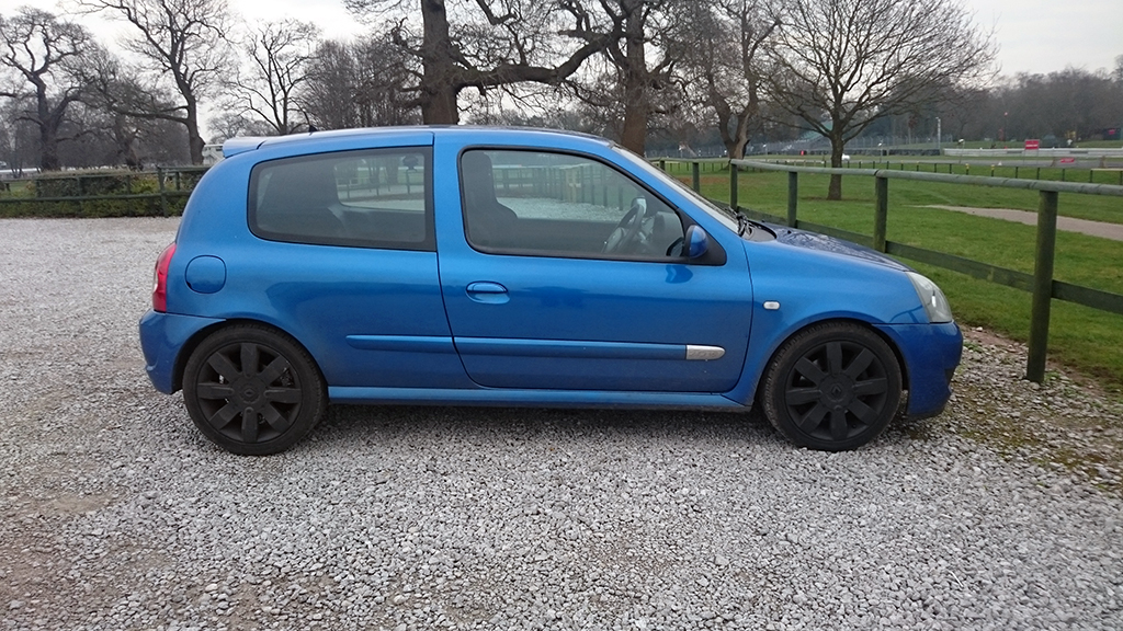

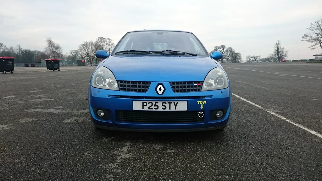

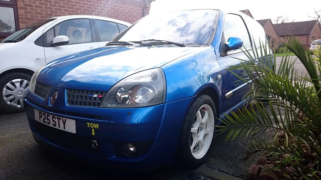

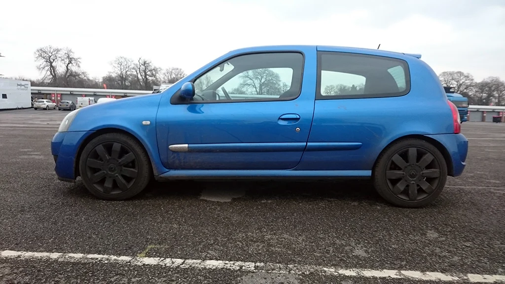

I took the car for a much needed run out to Oulton Park this afternoon as it's been months since it's had a good run. It was great fun! The car does sit nicer on the springs as well, I think it'll drop a smidge more as well.
I should add that the car stops a million times better as well. I've bedded the pads nicely as the roads were quite quiet, so hopefully that'll do nicely.

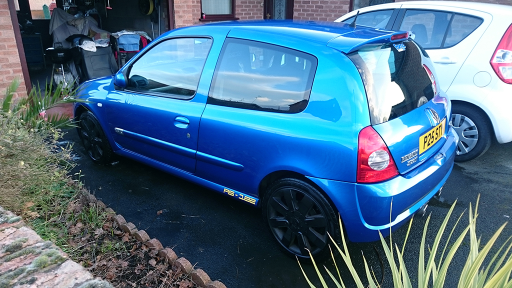

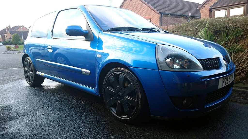

A few more to show the drop:
A one with another 182 buddy in the background (seen this car a lot at Oulton so guess they work there):
She needs a damn good clean now!!!

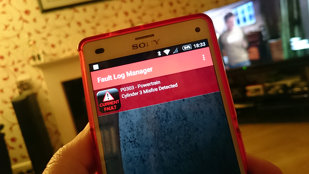

Disaster on the way home though, after finally getting everything sorted I'm getting a different EML on now, but only very rarely when stuck in traffic. I'm gutted to be honest as I thought I was finally getting there ready for a first track run in March.
The light flashes and comes on when stuck in traffic very infrequently, maybe 2 or 3 times in an hour of driving (and I was in traffic more than that). While the EML is flashing a torque scan gives a P0303 Powertrain Cylinder 3 Misfire Detected.
While scanning and the EML is not flashing it doesn't show any faults.

I got them for £150, so not bad at all really although the tyres are extra crap!
I've not checked that they fit yet (only concerned about bolt size fitting through the holes as they look like they might be a touch tight), but I will be keeping them all being well :up:

Free time can be a killer! I always end up on TVR's when there's too much spare time. I'd almost given up on cheap wheels as I've had 4 or 5 failed attempts at getting some. I bet you've had a few sets over the years though!
Your new fault is an injector. I had the same and an injector clean by @dann2707 seems to have sorted it.
Thank you for the help. To be honest I was thinking more along the lines of the plugs but if you've successfully solved the same problem I'll go with that first. I know the previous owner had cleaned the injectors so I guess the fault may have cropped up before I bought the car and replacing the lambda has brought it back up?

Yer i would say the same, might be worth checking the plugs and leads as well. Could even be the coil pack.

In a further update to the P0303 fault, I took the car to work today for a decent drive (22 miles one way) to see how the car was running. On the way in this morning I got the same engine light flashing but this time did have a small misfire. The car was hesitant under power while it was cold, but after a few miles (2 or 3 max) seemed to improve vastly and the light didn't come back on again. I was guessing along the line of the plugs after actually feeling the misfire for the first time but reading above it could be the injectors.
On the way home though the car was spot on, no engine lights, no rough idle and no hesitation. All the way home the car drove completely normally and was a bit of a surprise to be honest. I now know the handling issues are 100% sorted though, the steering and handling were great. I'm just a bit baffled about the fault now. Maybe it was just a bit of shite with the car being sat for a few months? Probably not though...
flashing eml is an injector unless it brings up no.1 as this can be something else but 99% of the time it will still be an injector. don't bother getting them cleaned.

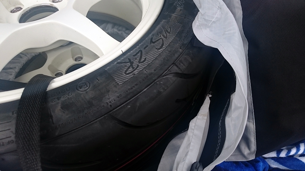

I've ordered some Nankang NS-2R tyres in the track compound from Demon Tweeks which are getting fitted next weekend. I'll head over later and see if the wheels fit, fingers crossed they will!

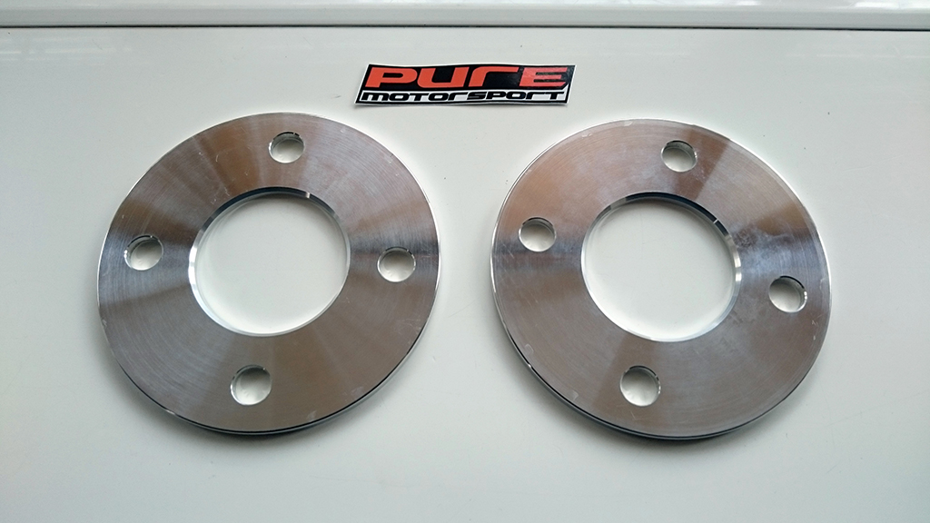

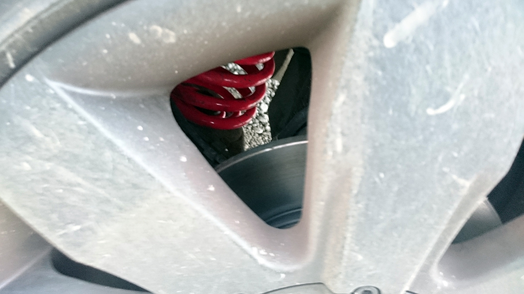

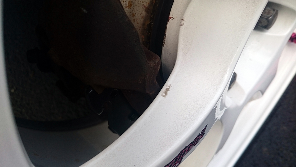

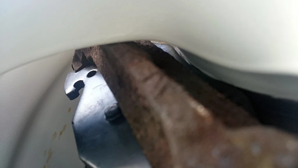

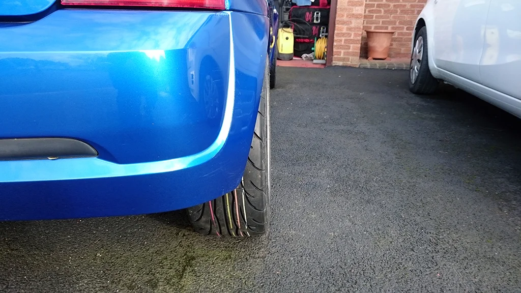

Well a few updates after a few hours yesterday afternoon. The wheels don't fit over the rear calipers, I thought I was home and dry with the front being fine but the rears foul. I think they look ok though.
Do I need to just buy some spacers for the rears? I've never really been in this situation before so I'm not sure how much to space out and if spacing will causing issues for rubbing? Can you just space the rears or should I do the fronts as well? So many questions!!

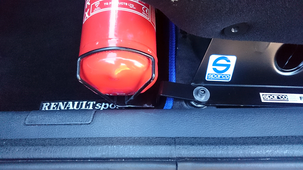

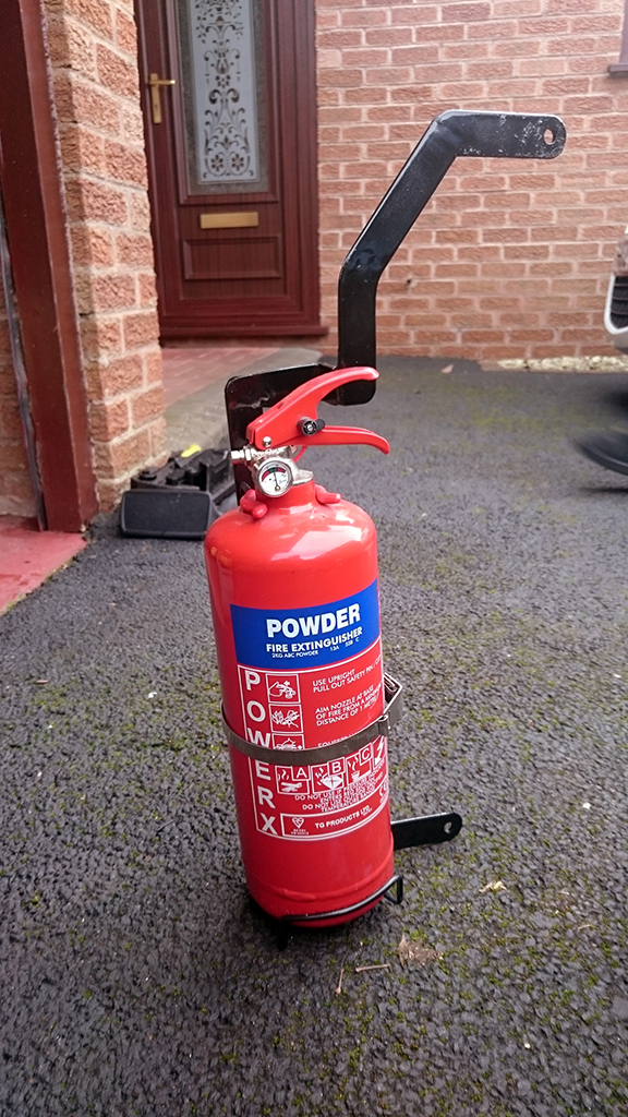

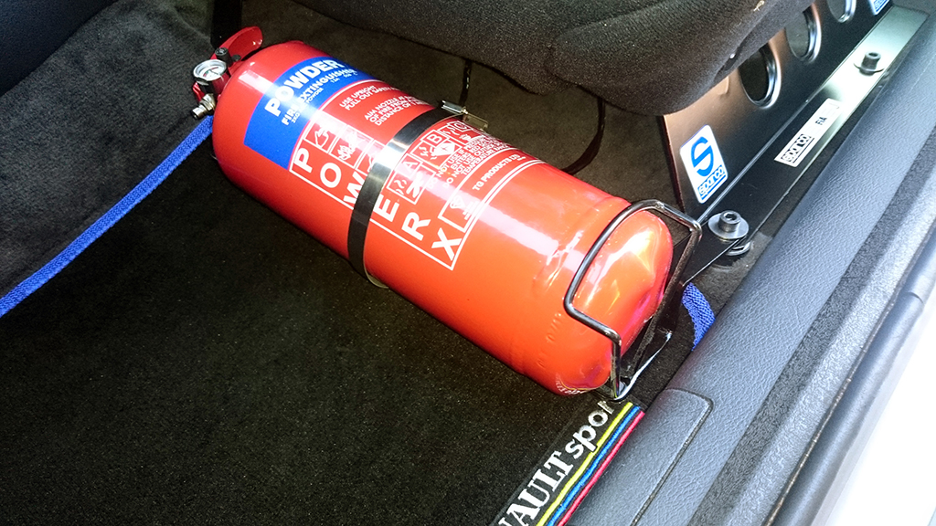

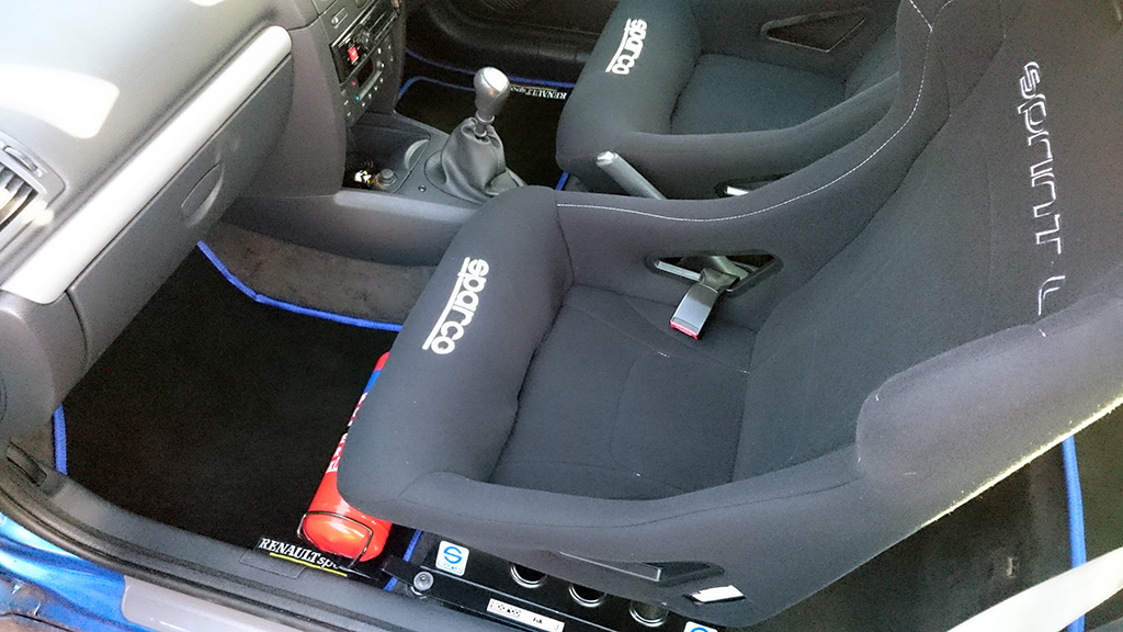

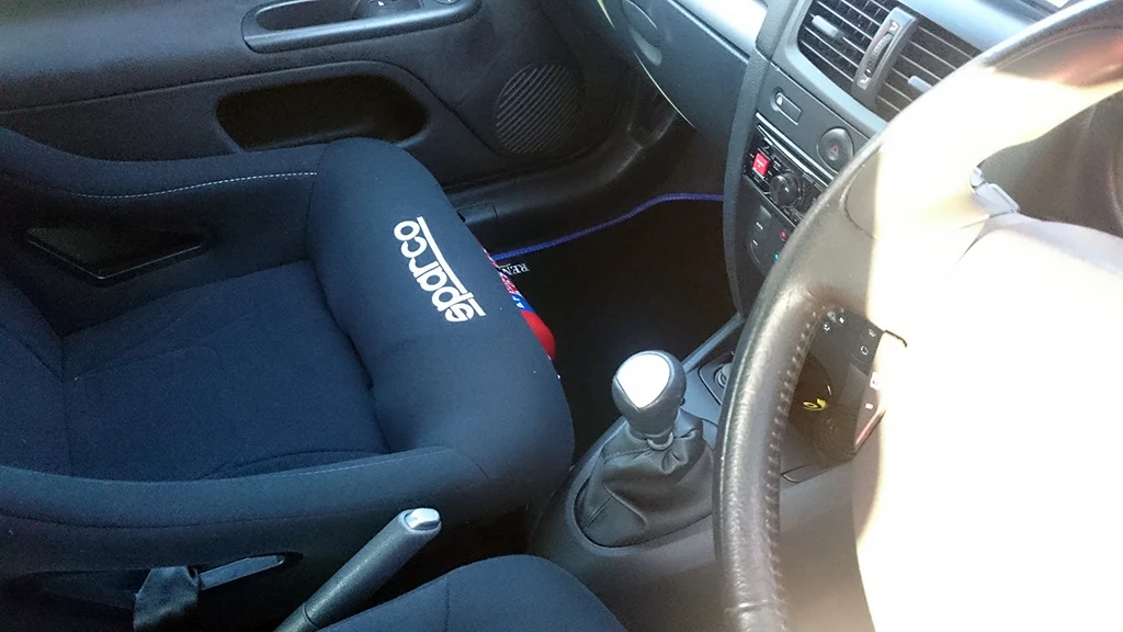

I did get the extinguisher fitted in the passenger foot well though. The original bracket was made for my old Evo VIII, so it was modified to match the fixing points for the Clio.
It's nice and secure and great for quick access.

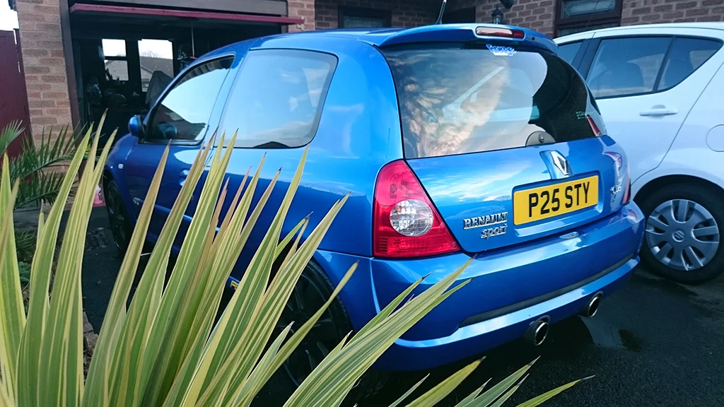

Then we gave it a much needed clean and stuck some sill stickers on :)

I can't stop thinking about the wheels though. Maybe I should grind away some of the face of the calipers? Only a few mm?

We went to Demon Tweeks to get the track tyres fitted to the wheels. Nankang NS2R in track compound were a very good buy so I went for them, apparently they're discontinued in the track compound so may be replaced by something else soon? While there it was rude to not have a look around. I could spend an absolute fortune there!
Then a quick look at the new parts that have arrived. Hopefully these wheels will now fit with 5mm spacers for the rear. Time will tell!

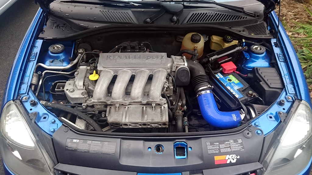

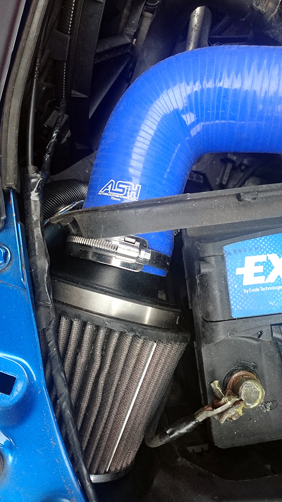

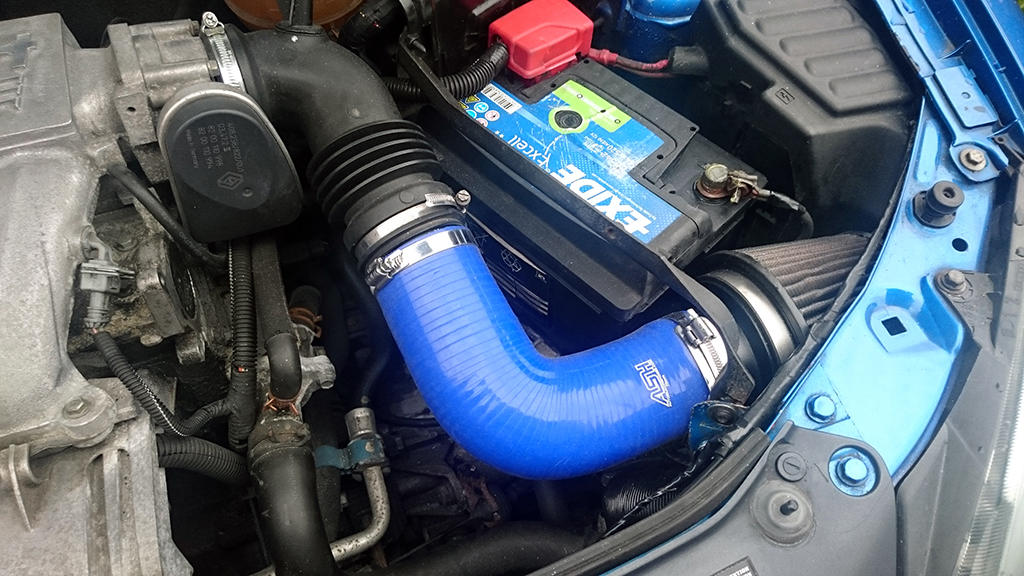

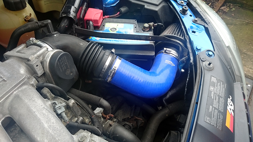

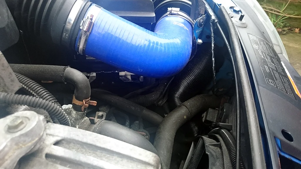

We (well, my girlfriends dad) managed to move the filter to behind the passenger headlight even with a big battery. The bracket took a bit of persuading but it should be a lot cooler over there and a suffer a lot less from heat soak. I might put a hard pipe in now I know that it fits!
The cold air feed from under the car is still in place and has been wedged in too. Every little helps :up:

First of all I got the track wheels fitted now the 5mm pure motorsport rear spacers arrived. They all fit and with a mm or two to spare. I've not had chance to have a drive out yet though as we got blocked in, but hopefully I will have had a run out by the weekend. The new bolts make a big difference too.

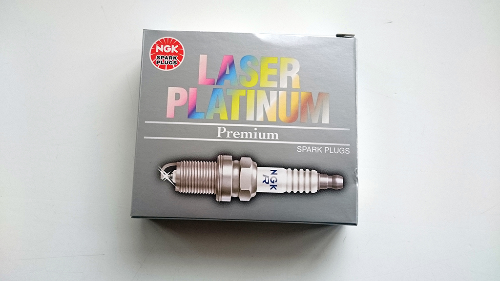

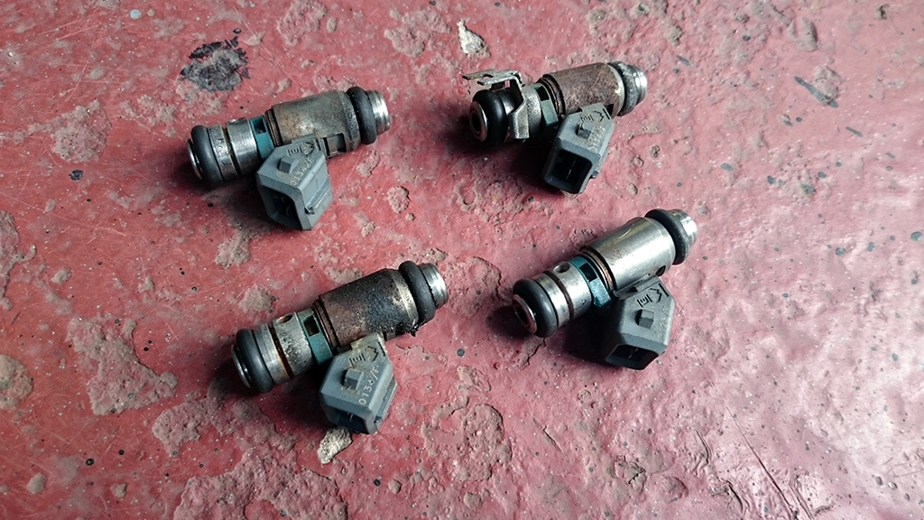

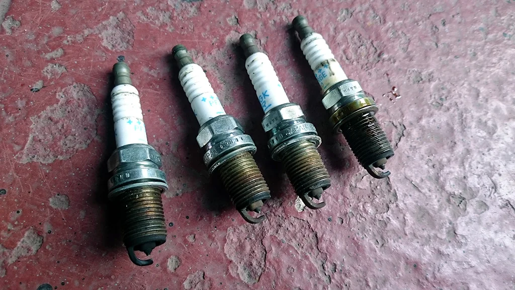

Then it was onto the proper task of solving the P0303 fault that cropped up a few weeks ago. I decided to swap all of the plugs and injectors in one go while everything was accessible and it wasn't too bad of a job. The old plugs were in so tight though you wouldn't believe. I was worried about doing some damage but perseverance paid off.

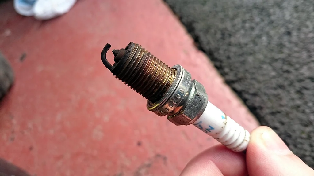

I'm not sure when the plugs were last replaced but this is what they looked like. 3 didn't seem too bad but one was sooty (I can't remember which one now though - it may well have been the 3rd.
The injectors were a bit fiddly but easily do-able. The 3rd was easily the worst condition out of the 4 and took a bit more persuading to come free. All out though and looking like this:
After putting everything back together it was time to start her up. The difference was incredible - much much smoother on idle. It really was quite a difference and surprised me to be honest. I always knew the 182's had a lumpy idle so assumed it was normal, it seems that this wasn't the case. The car idled for a bit without the problem so I'm hoping the error is gone. It certainly should be.

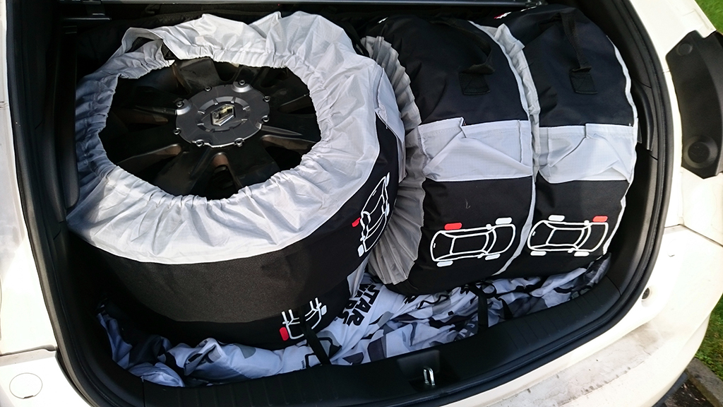

On another point, the Type R boot is the perfect size for the lugging spare wheels around! :smile:

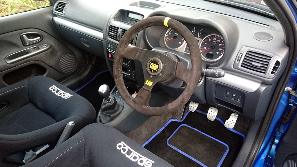

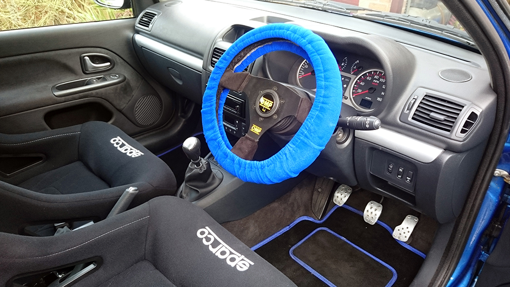

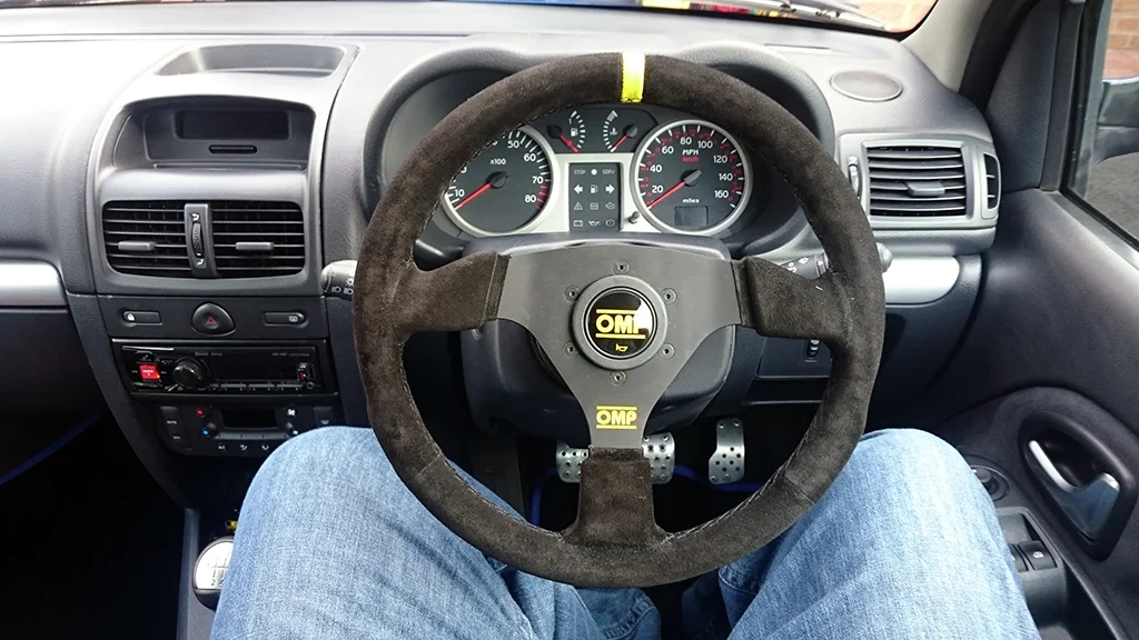

Some more progress today with the fitting of the OMP steering wheel and Phase 1 indicator stalk. All went quite well other than needing to nip to Halfords to buy a T50 Torx socket, that was a bit of a pain.
The Phase 1 stalk is perfect though, saves messing around and shorting the horn wiring.
