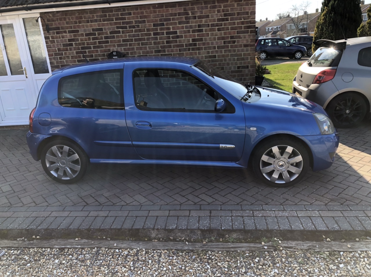

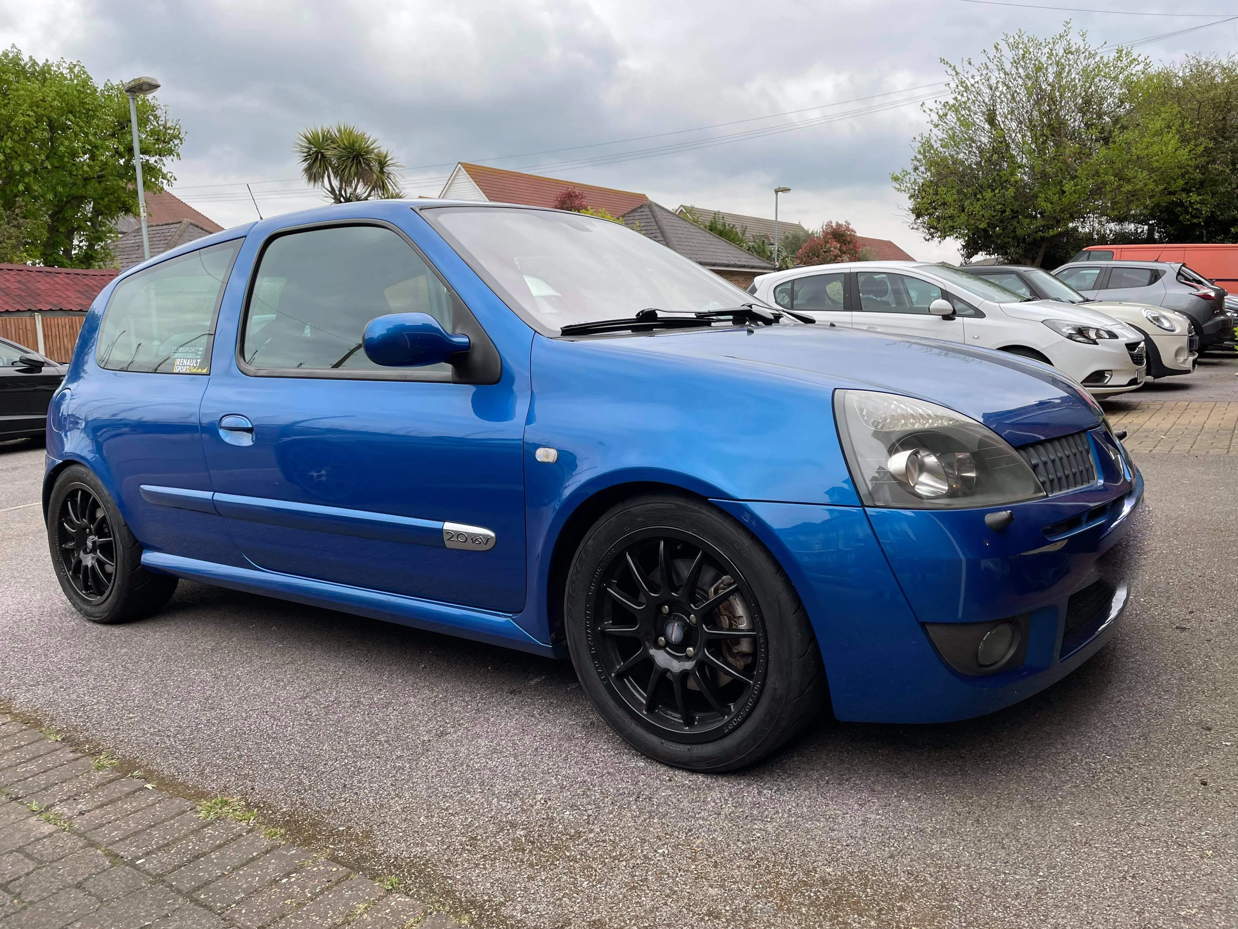

This is the car as it stands - not gonna stay like that for long though!
Looks good Steve, looks identical to how mine did 5 years ago. As long as its mechanically sound it might not be the worst idea to just take it onto track and see what it needs/what breaks and go from there, you don’t need to spend loads of these to enjoy them on track but a set of decent pads and tyres is a good start, followed closely by suspension/seats/steering wheel imo.

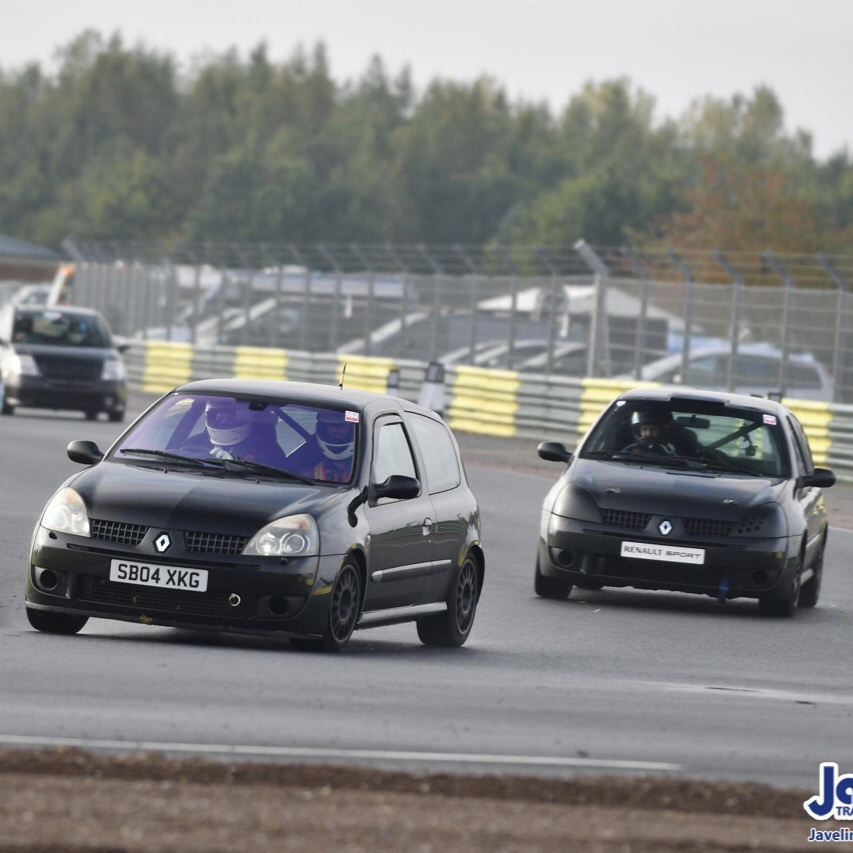

PBS are a good pad for fast road and are decent for track days. As was suggested above, take front fogs out to get some cooling to the brakes. They’re pretty good around track from factory but you’ll soon find the limits when trying to keep up with dedicated track Clio’s. A few lads I go with have a half track half road going Clio 182 and it does pretty well.
They're running :
* Brembo HC front discs
* Genuine rear discs
* Eibach B14 suspension
* Yokohama AD08R tyres
* PBS front pads
* Ferodo DS2500 rear pads
* Rear seats out
* Half cage
* EPAS
* Sabelt 6-point harnesses
* A couple of half decent bucket seats.
Car goes very well and is still comfortable on the roads as a daily. As suggested above, they’ve kept carpets, dash, headlining etc
This is them just in front of me at Croft. Mines race prepared but I have to push on a bit to get past them. I think anymore than the above and you’ll probably make the car a touch uncomfortable for daily use.
I’ve missed off a few things like PMS air con delete kit, Powerflex poly bushes all round, braided lines etc...
Most of the modifications they’ve done have come from years of doing trackdays and things breaking down like power steering pumps, exhaust flange falling off, destroying standard bushes etc.
I guess it’s better to fork out now, than spend good money on trackdays only to find the standard parts can’t handle the stresses of a trackday. I’ve towed their car home more times than I care to remember 😫 They’ve finally got the message 😂

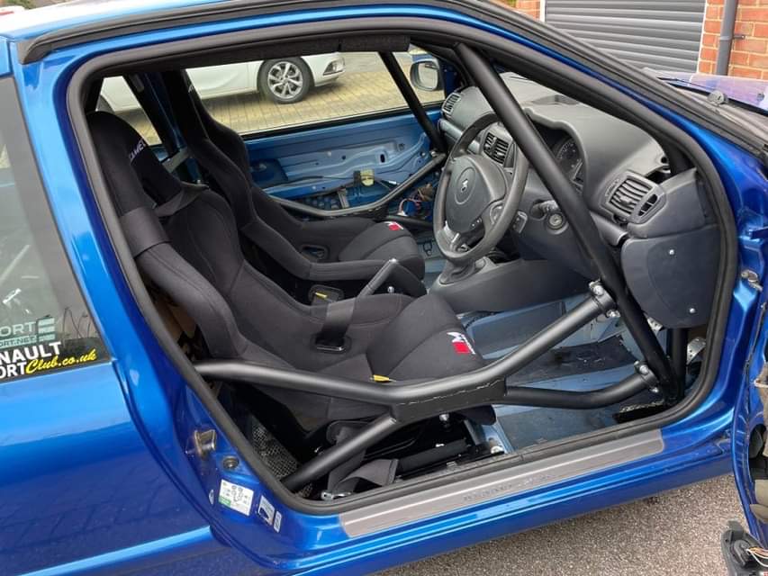

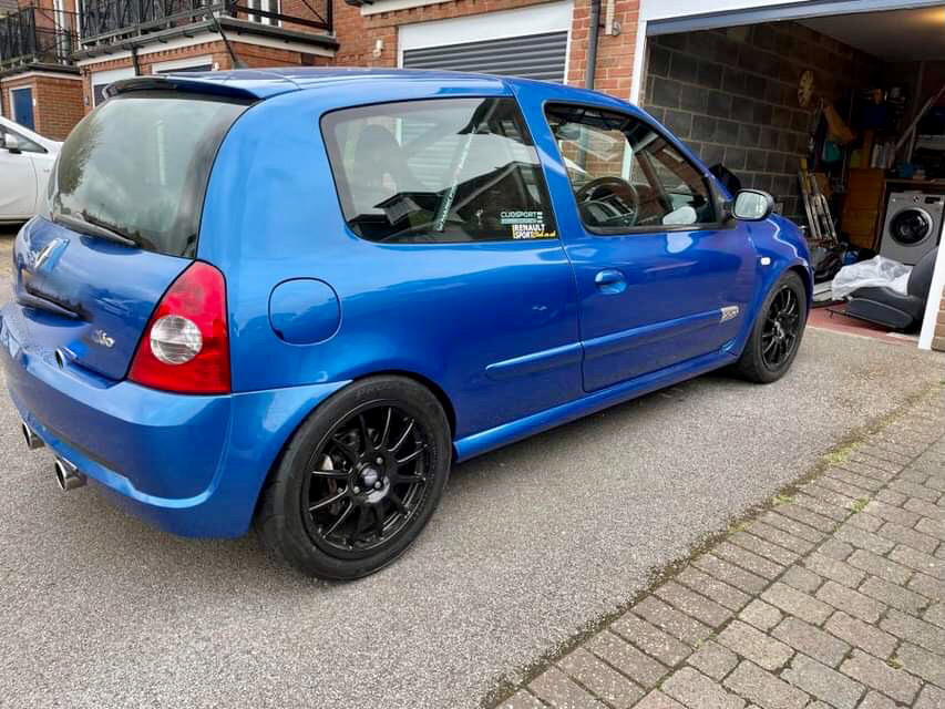

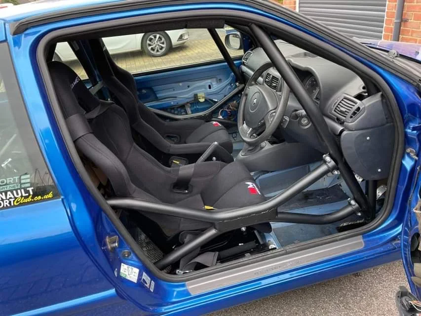

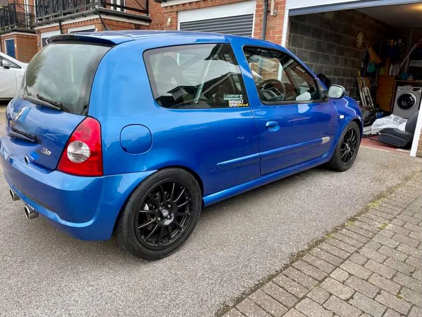

Thanks for advice, I’ve done quite a bit now :
full cage
BC DS suspension, fully fitted, geo and corner weighted
Winmax W5 front / PBS rear pads,
Motomec buckets/OMP harnesses
TD wheels with 888 tyres
first track day yesterday at Brands, car felt very good but need time to get used to it and fine tune damper settings
ive got track day door cards on the way to today up the interior and also want to replace steering whee for a decent new one, any ideas gratefully received
loving Clio ownership and doing the mods etc
any further advice / comments welcome!
full cage
Looks good and sounds like your enjoying it.
Sabelt do a 330 mm wheel which is popular amongst Clio owners.
Thanks for the advice gents! 👍

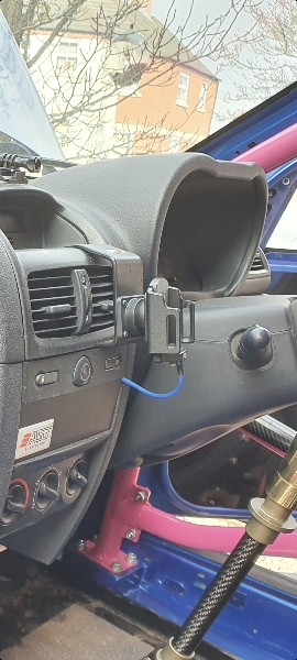

I have another one - I’m looking to use my iPhone to record track footage/lap times and I’m going to try Harry’s Laptimer App
im looking at RAM mounts which look good. But at Brands, you need a secondary tether for the phone. Has anyone done this, and any advice nurse best mount and tether to use?
any advice very welcome
