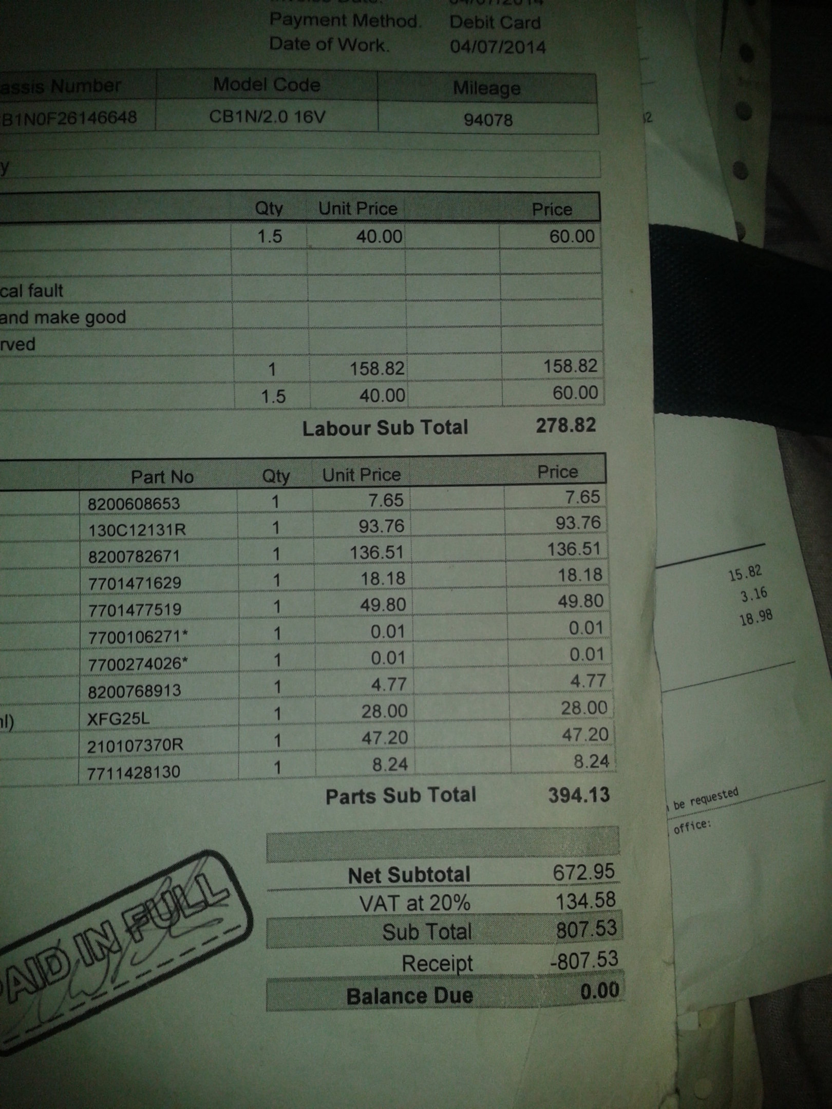

I don`t understand what you are saying.
The clutch plate is engaged when the pressure plate grips it and spins the gearbox mainshaft. the cogs on it and stirs the oil.
When you disengage the clutch, relieved of this drag, the rpm might rise a little, but not enough to notice.
Seems to me you should look into the authenticity of the belt service, there should be a detailed invoice with part numbers & prices, totalling something around
£550, not something scribbled in a service book.
And the whining could be the water pump or a worn belt pulley.
This one included a water pump & some additional work.
