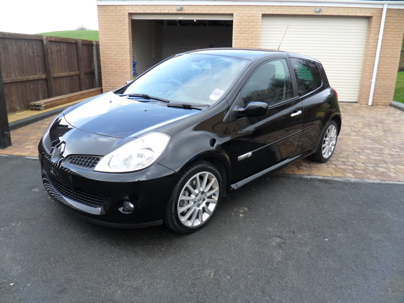

It was done about 2 weeks ago but not had much time to write it up
Anyway car was pretty bad, i know james said his dad works near a steel mill or something so maybe because of that but we did our best on it and got probablies about an 80% correction on the paint
Process as follows
Plates off
Rinse
Snow Foamed
Rinsed
Washed with microfibre mitt
Shuts cleaned
Clayed with dodo supernatural and last touch as a lubricant
Dryed down
Taped up with masking tape (ran out of 3m)
Machine polished using flexipad and 3M pads, using menzerna and 3M compounds
Washed again
Dodo blue velvet applied with sonus pad
AG super resin on all glass apart from windscreen
Plastics (interior and exterior) dressed with poorboys natural look
Tyres dressed with megs high endurance
Alloy faces protected with poorboys wheel sealent (alloys were getting refurbed soon anyway)
Interior hoovered out
James wanted the clio badge off, so we heated that up and used some tar and glue remover on the resedue left over (snapped the O sorry mate lol)
Thinks thats it really

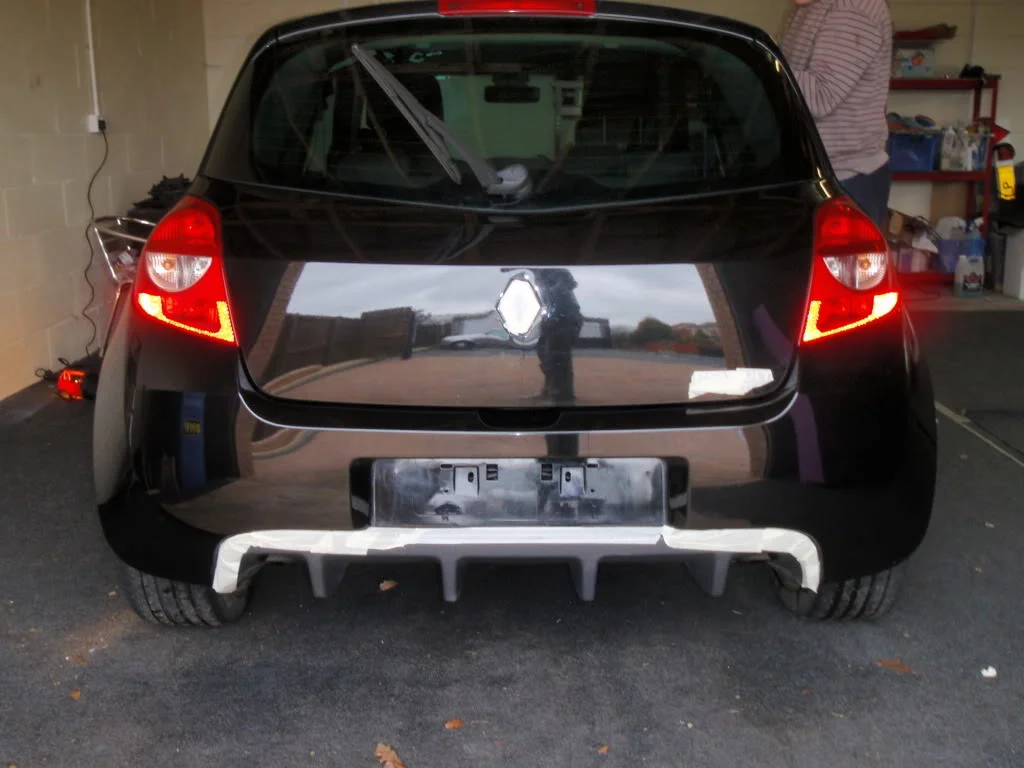

Really didnt get a lot of after pictures due to camera dying

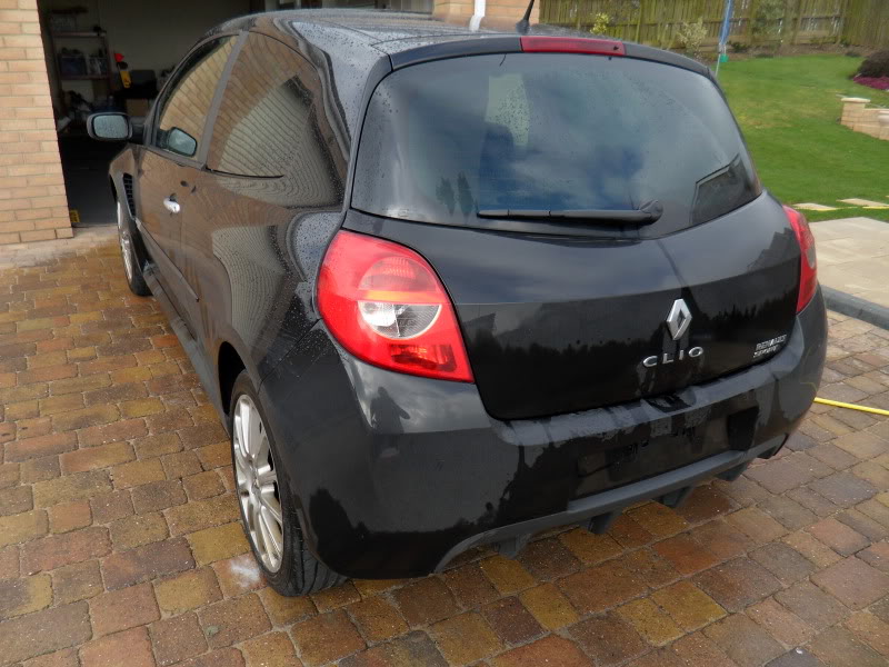

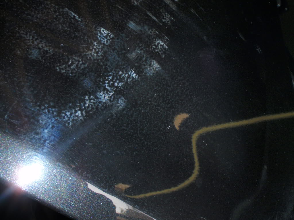

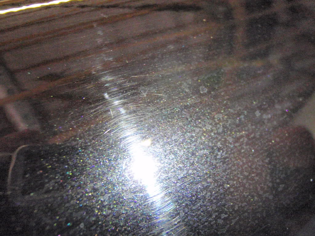

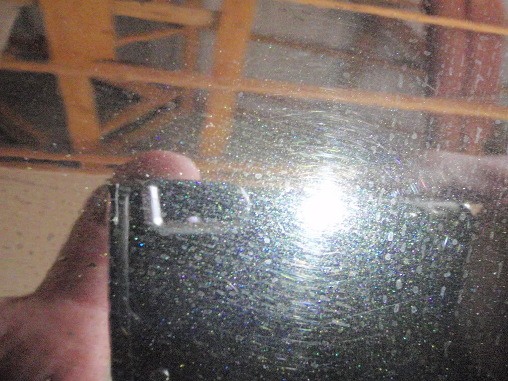

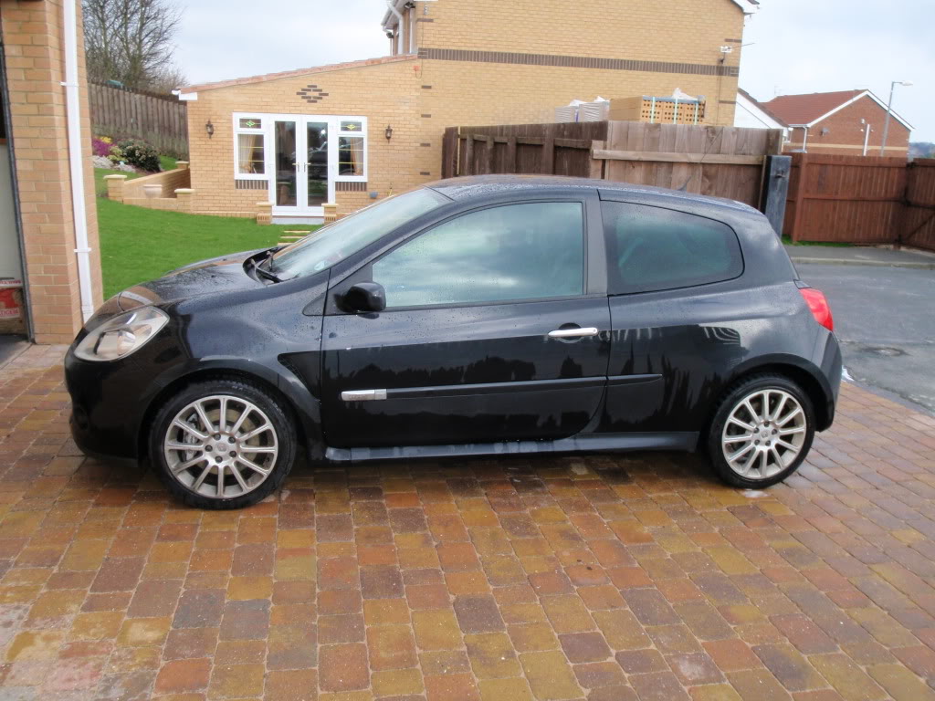

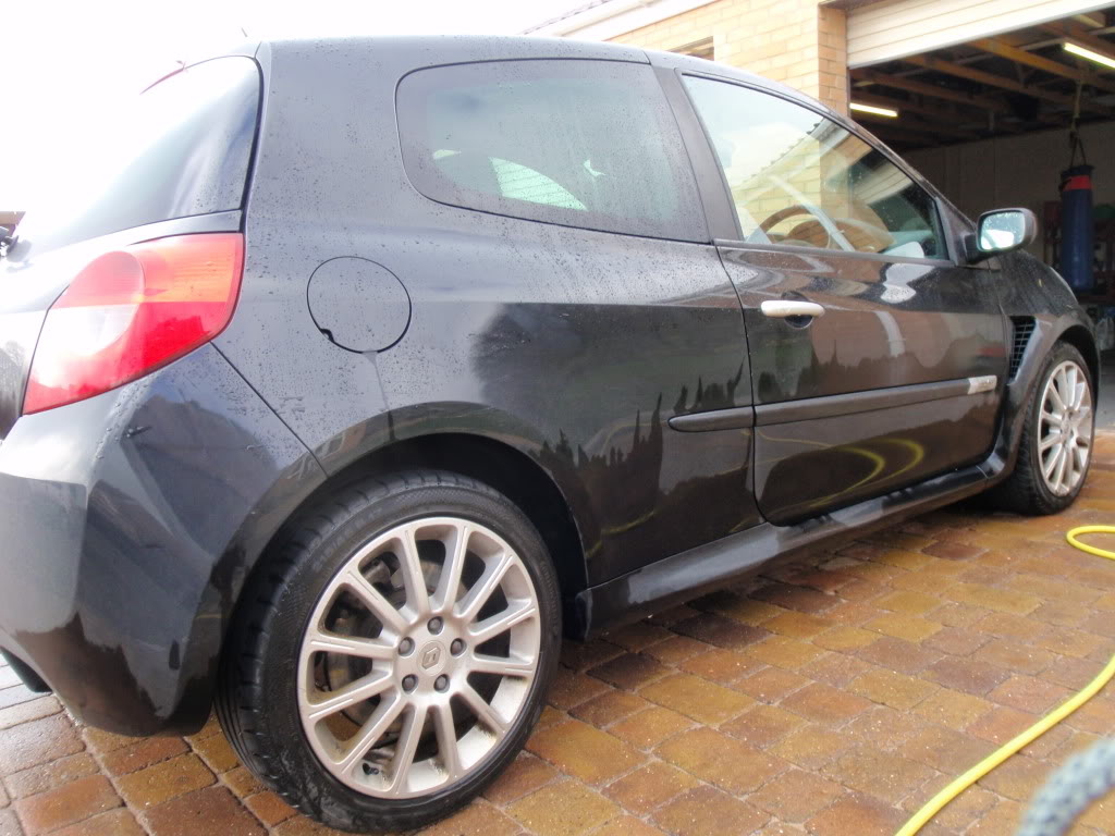

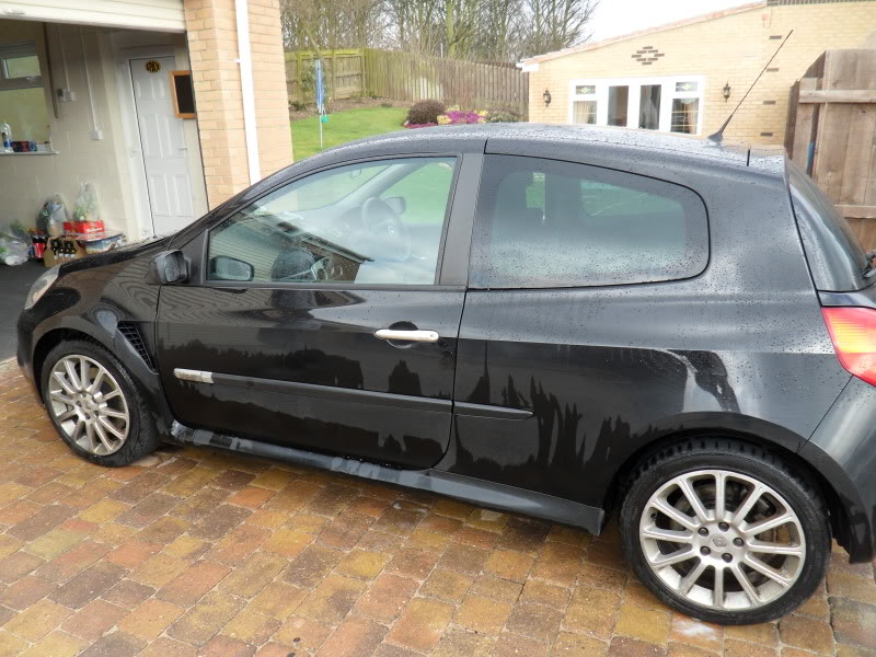

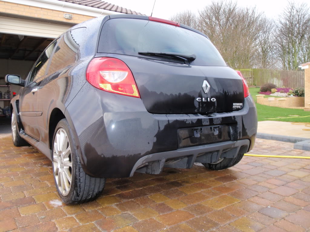

Before

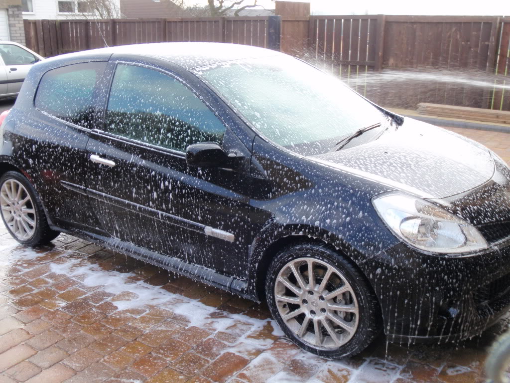

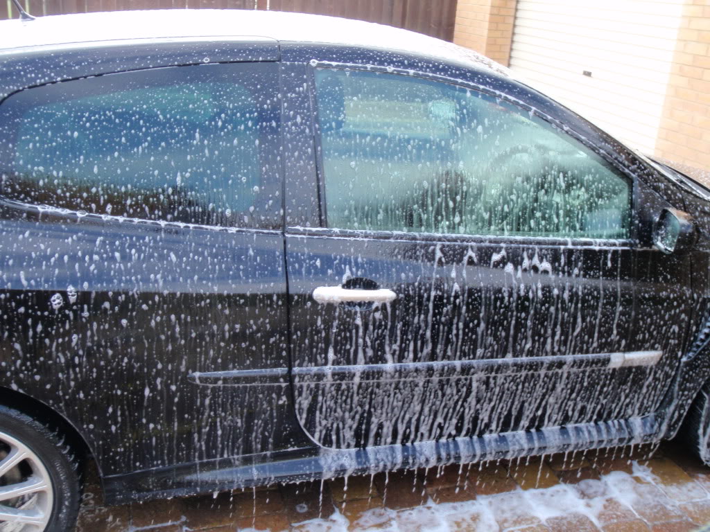

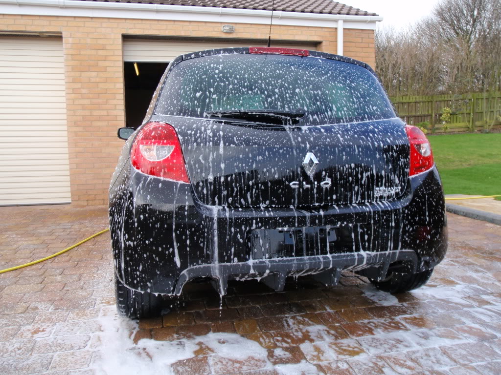

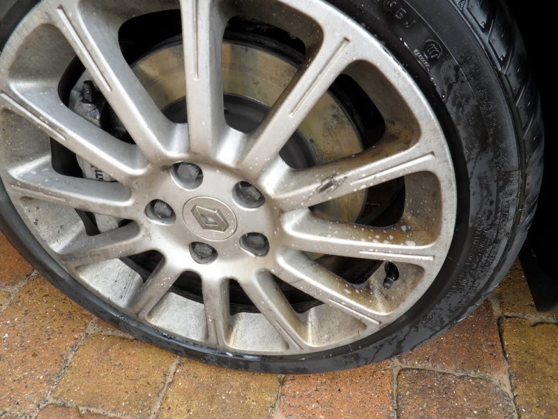

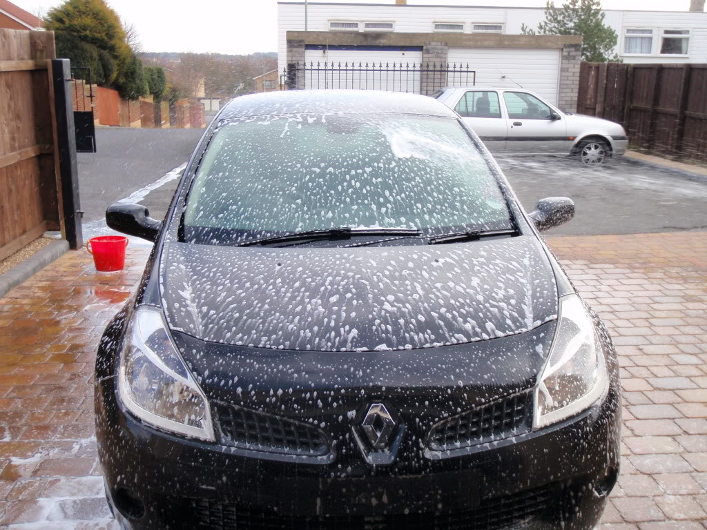

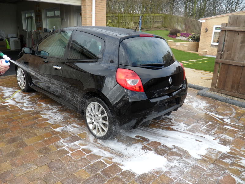

Rinsed, Snow foamed and washed

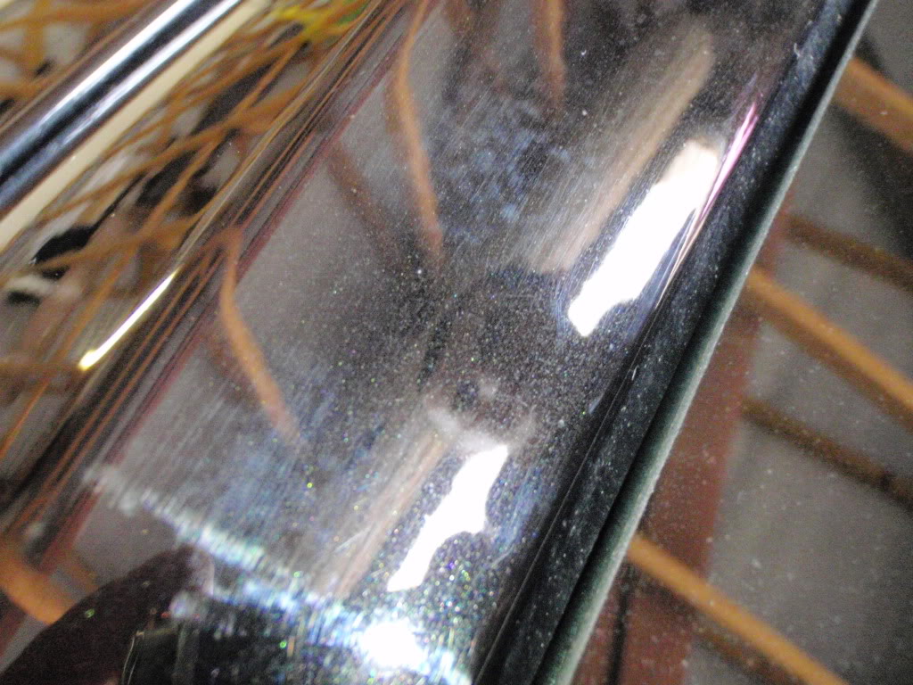

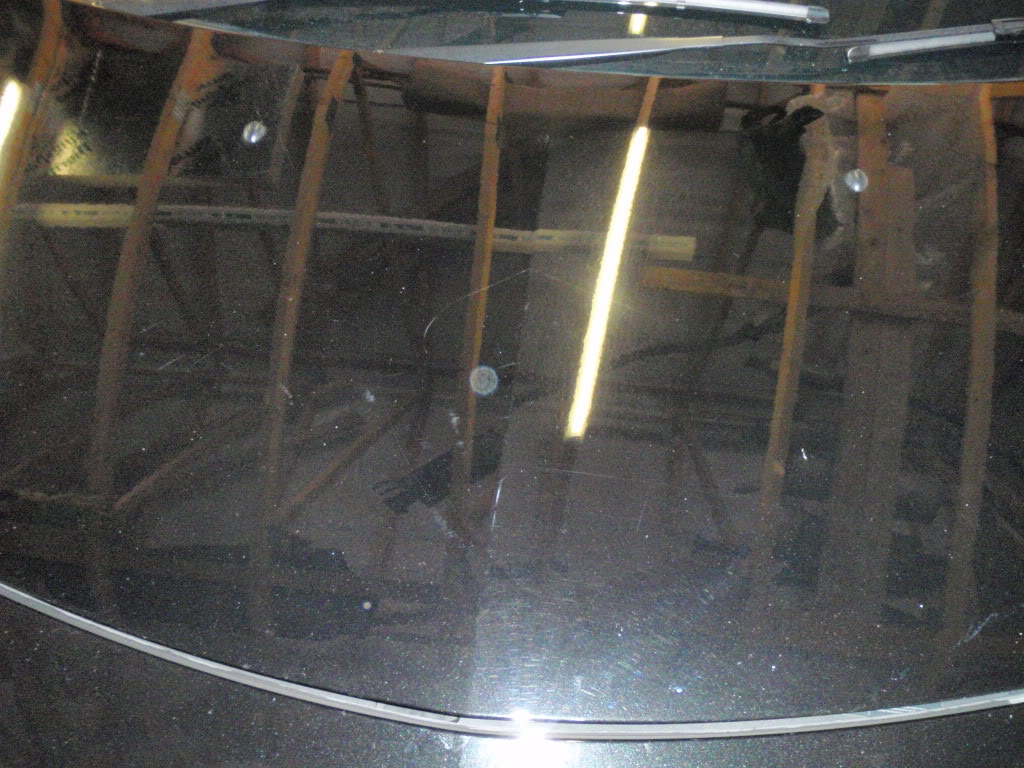

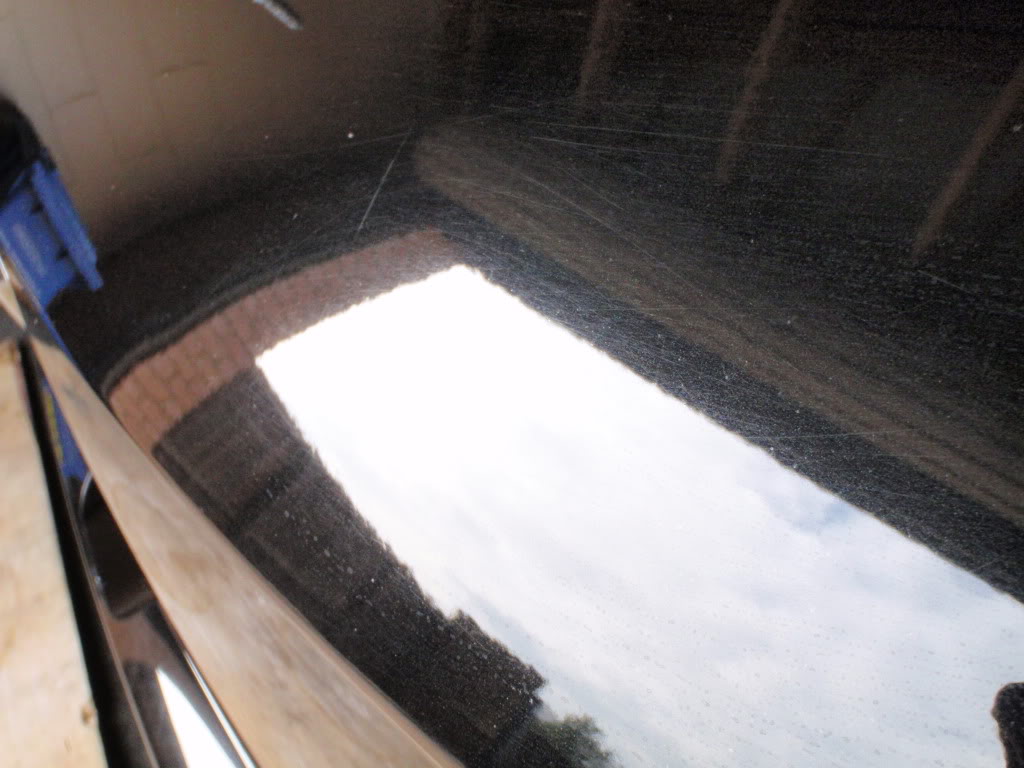

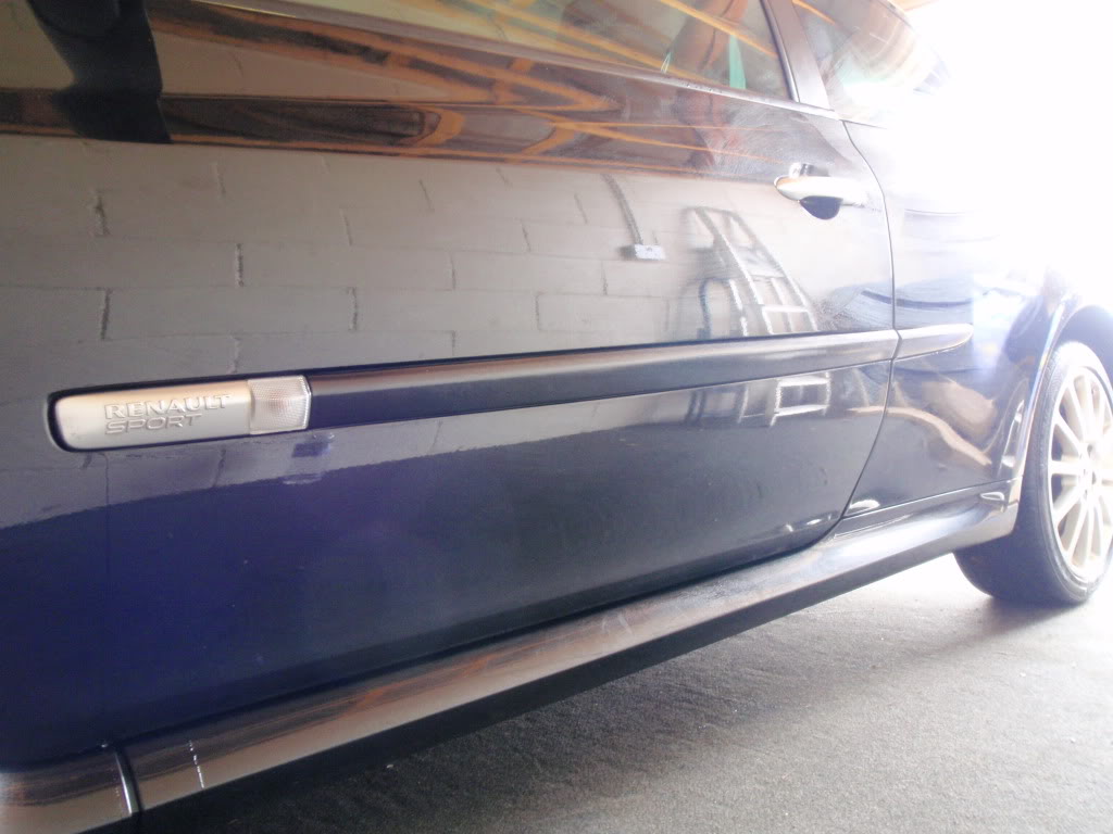

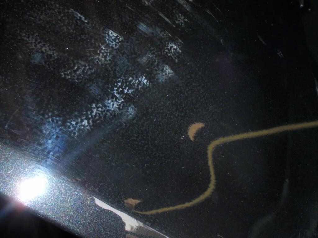

Lot of sanding marks on the car But they came out no problem

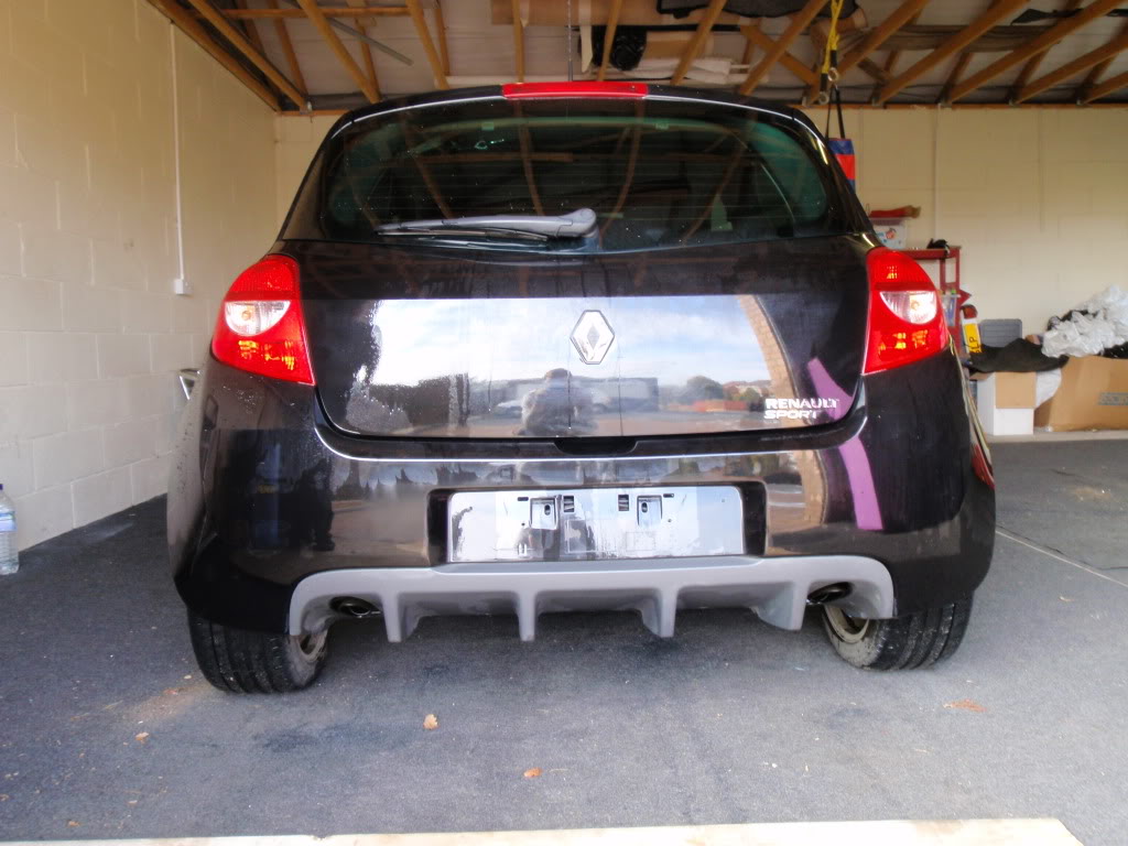

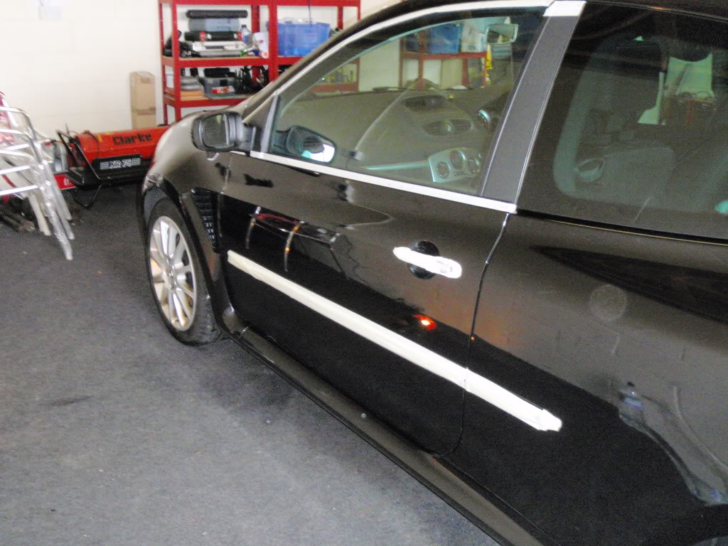

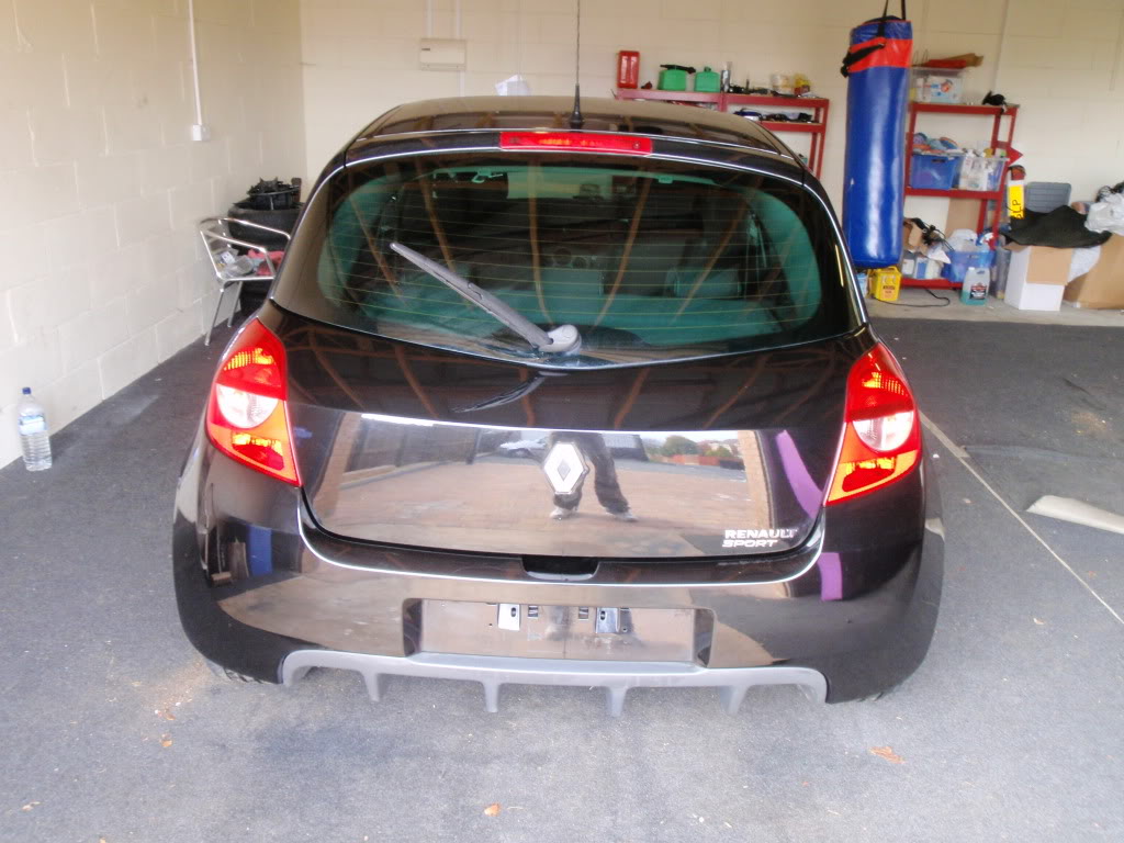

Clayed and de "clio" badged

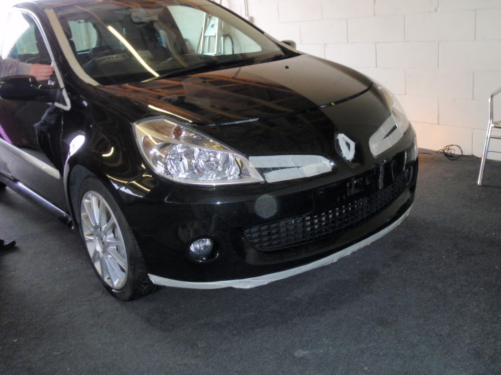

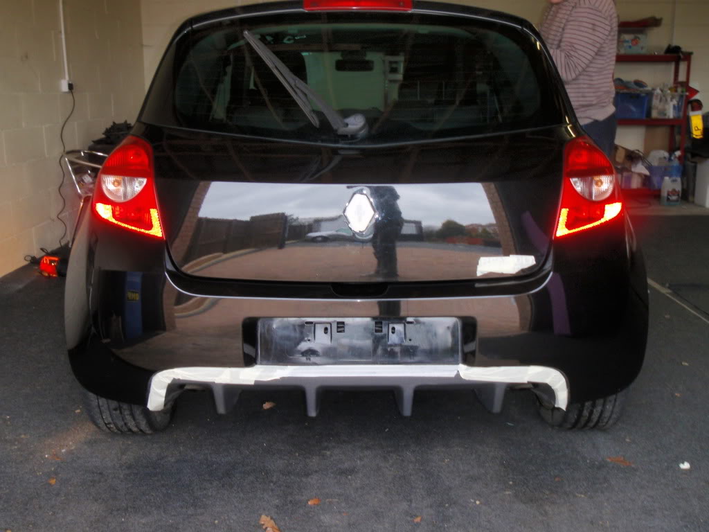

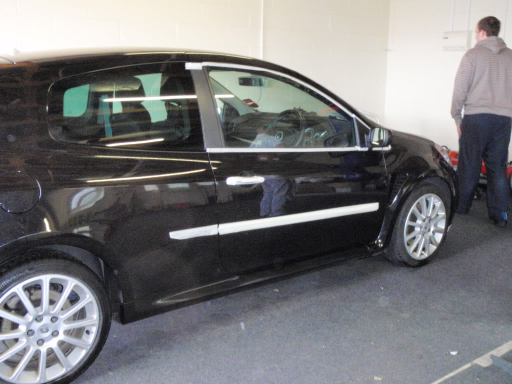

Taped up

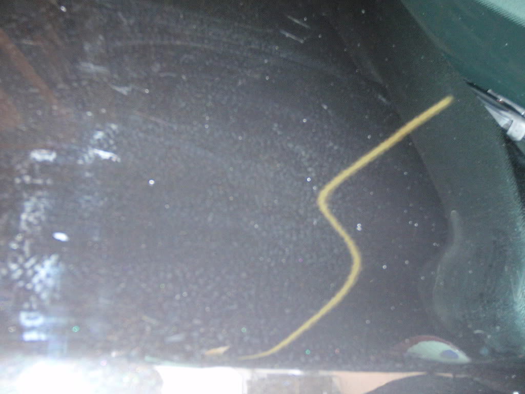

50/50
Then the camera died, forgot to charge both batteries up too

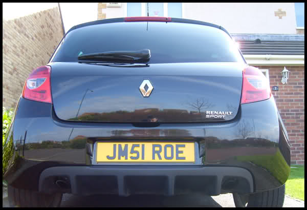

And the rest of the pictures are from his progress thread

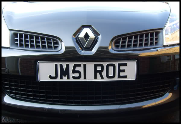

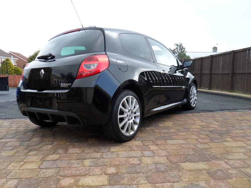

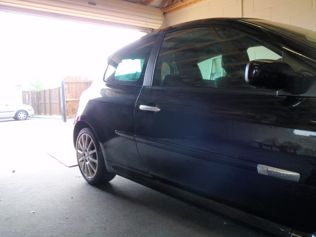

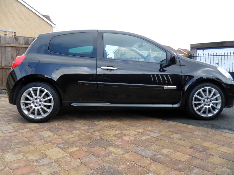

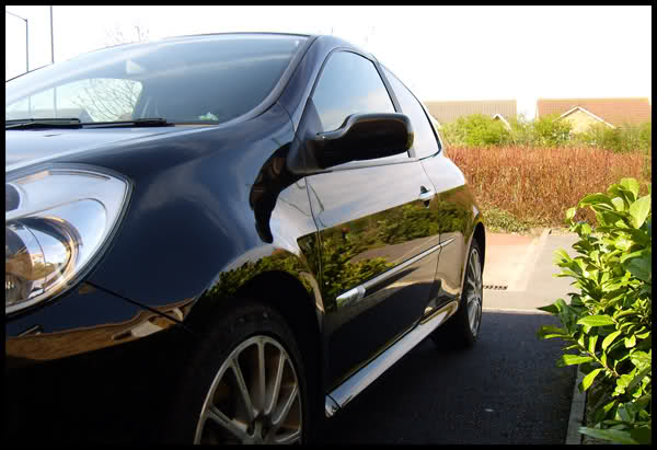

Came out really nice but would of really liked to of wet sanded it when we get a paint depth gauge
Just need it on coilovers and them rims in anthracite now
