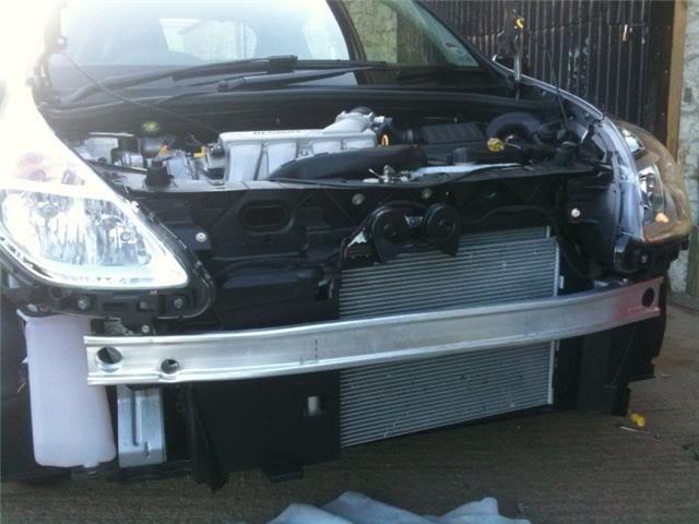

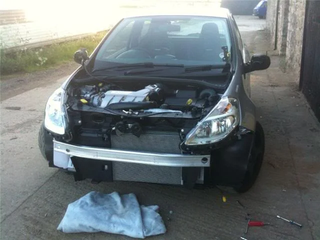

  Clio sport 197
afternoon all,
ive followed this guide and have removed the front bumper, the headlight however has a black plastic cover at the bottom with what looks like a triangle head screw?
hopefully have done the hard part just need some info guys? how many places is the headlight being held in by? do i have to remove the triangle headed screws?
Muchos thanks guys!!
