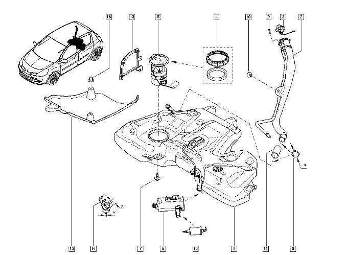

Get him to start it while someone hits the x on the bottom of the fuel tank. Apparently sometimes they get blocked and hitting them can loosen the s**t
Part number 82 00 685 651
Unit price excl. VAT 174.12 GBP
Unite price (with VAT) 208.94 GBP
Looks very easy to swap yourself.
Do 200s have the wider hole under the real seats?
Apparently it's a tank out job on 197s!

If the tank is the same as a 1*2, make sure it's not full to the brim. They can deform around the ring that holds the pump in place if they're not empty.

This allows you to see where everything is.

Common on the mk3, mine cut out whilst driving Had to be towed back by the old man in his defender
Tank off, so that's cutting the exhaust too (if standard) unless you drop the rear beam
Looks like he'll have to get am aftermarket system then

I think you could butcher it out under the seat true pikey style
