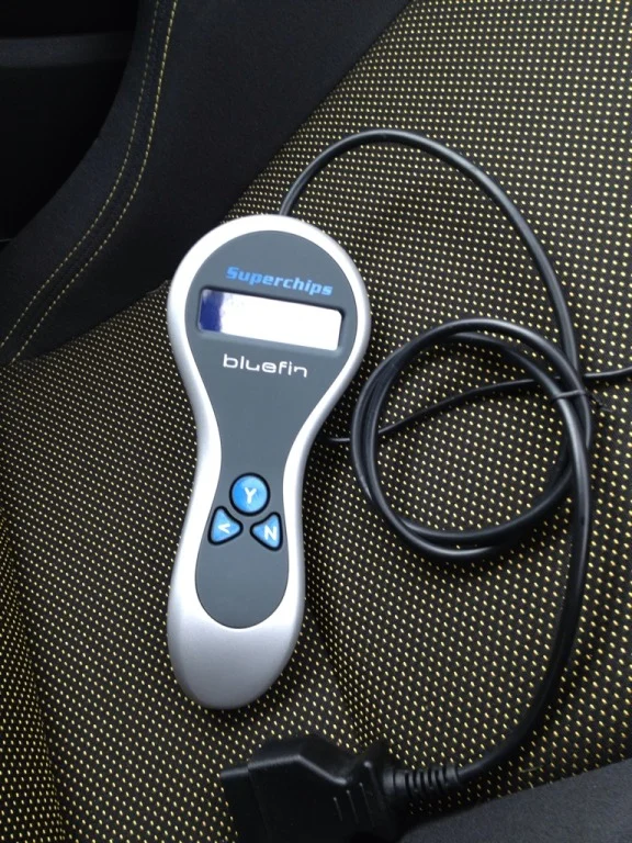

This....

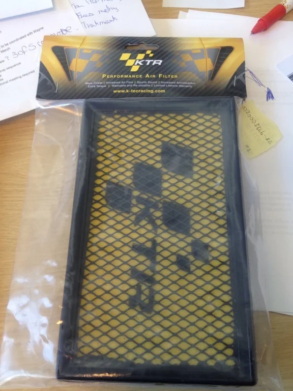

plus this....

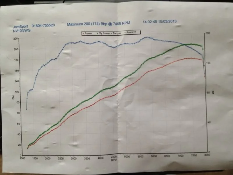

equals....
200bhp with KTR panel filter and Bluefin generic map. I'm happy with that, not a huge increase in peak power but if you look at the graph the flat spot in the torque is pretty much gone and the power delivery is so much smoother! All for the small sum of £240. Not bad.
Oh and for those who are worried... I got them to do AFR for the whole rev range and at peak power it was 12.0 and mid range it was 12.5 to 13. So it's doing what superchips said it should and is running richer than standard and not lean
