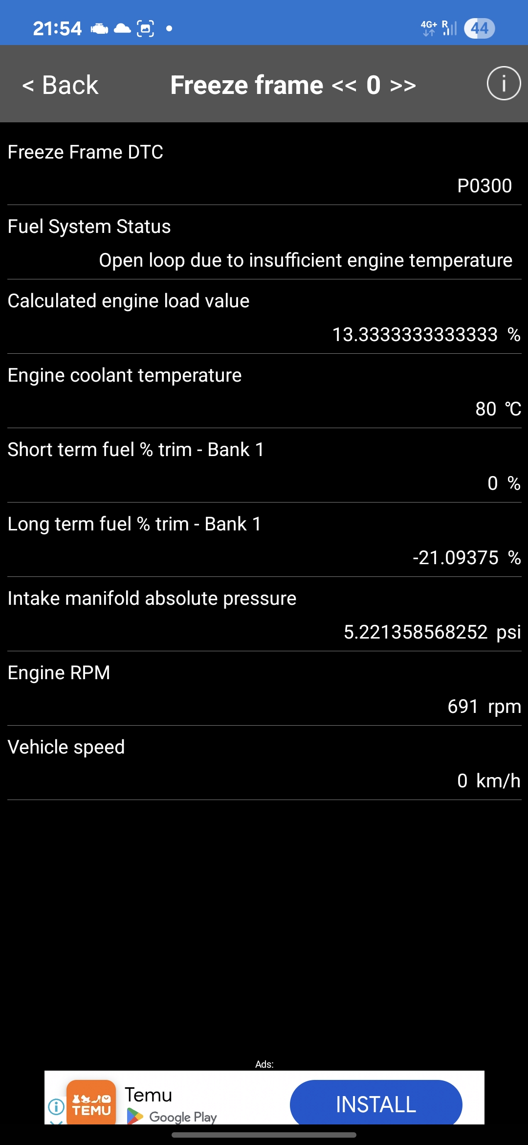

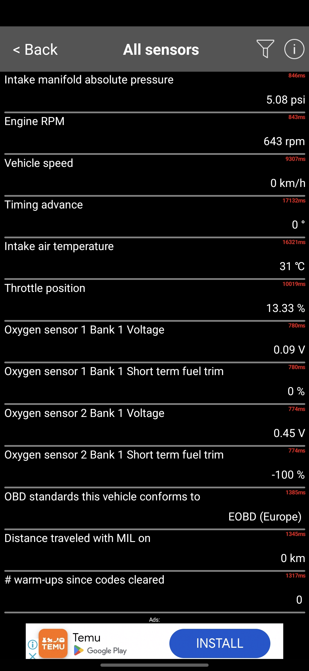

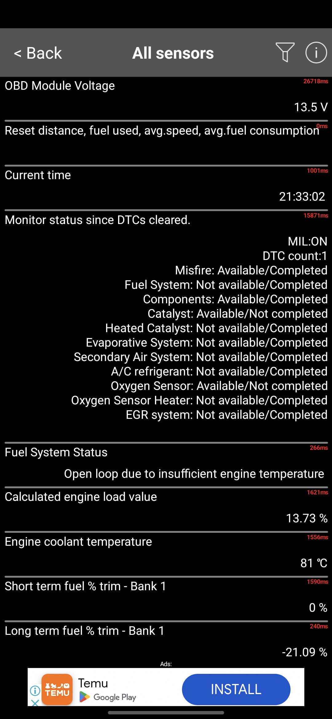

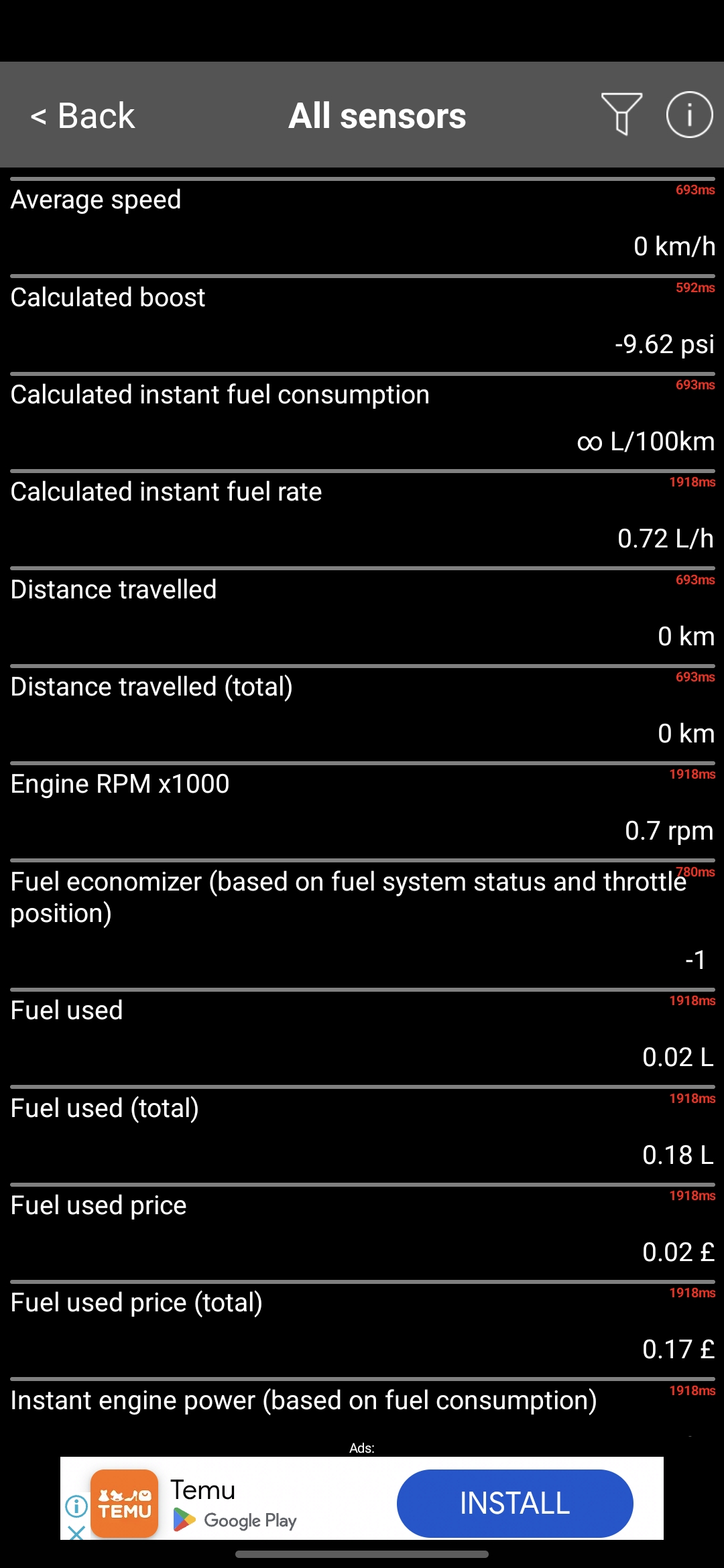

Hi everyone, I'm having a problem with my Renault Clio 3 (petrol engine). When the car gets warm the engine starts to vibrate and idle roughly, and the check engine light starts blinking. I scanned it with OBD2 and got code P0300 (random/multiple misfires). I also captured live data and a freeze frame screenshot while the light was blinking, so I know it reflects the issue in real time. Here's what I've already replaced:
• Spark plugs
• Ignition coil pack and leads
• Engine oil and filters
Cleaned the fuel injectors
New timing kit
• Valve clearance The problem still comes back after warming up. Anyone experienced something similar or know what to check next? Thanks in advance! (Screenshots attached)
