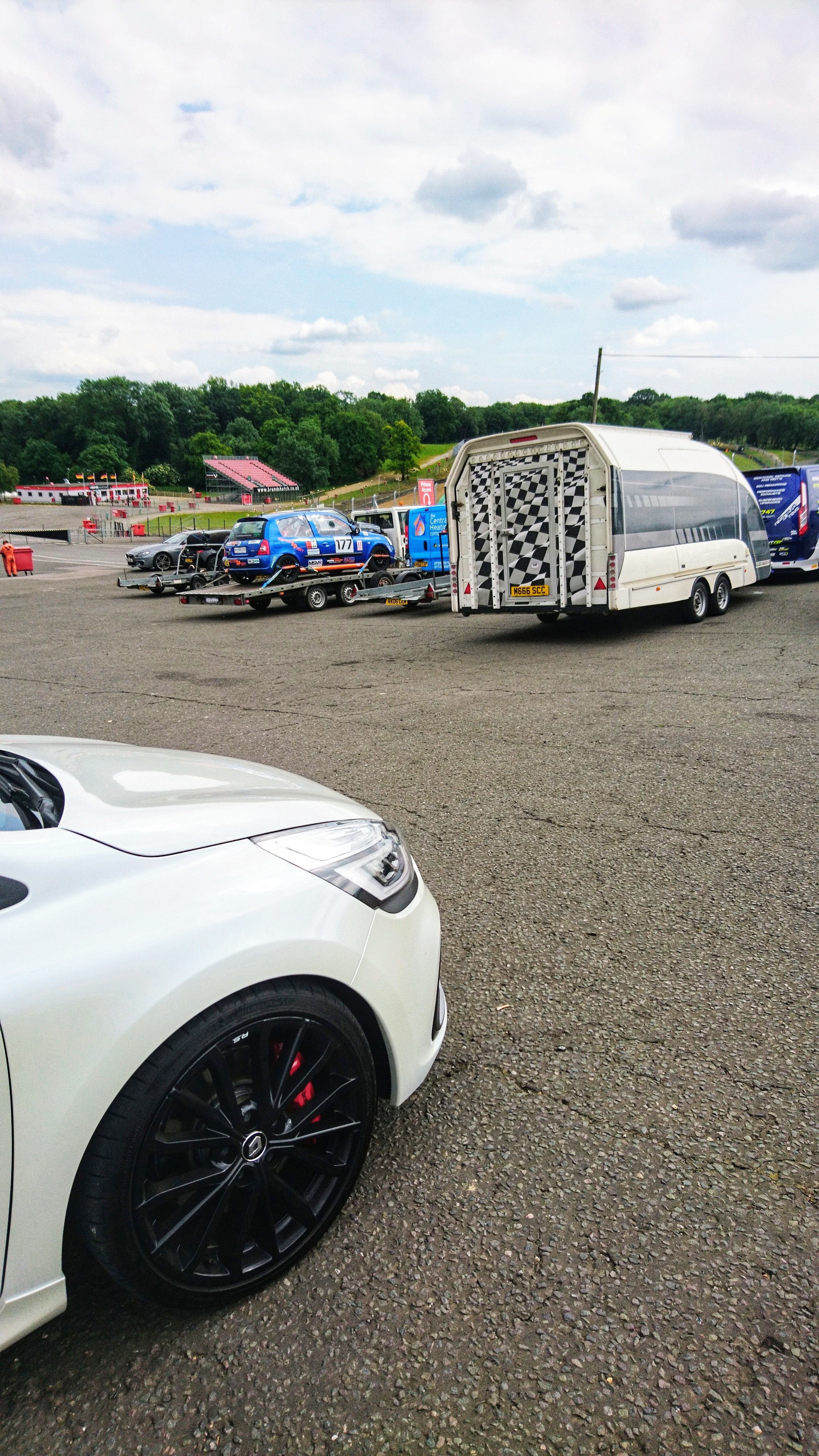

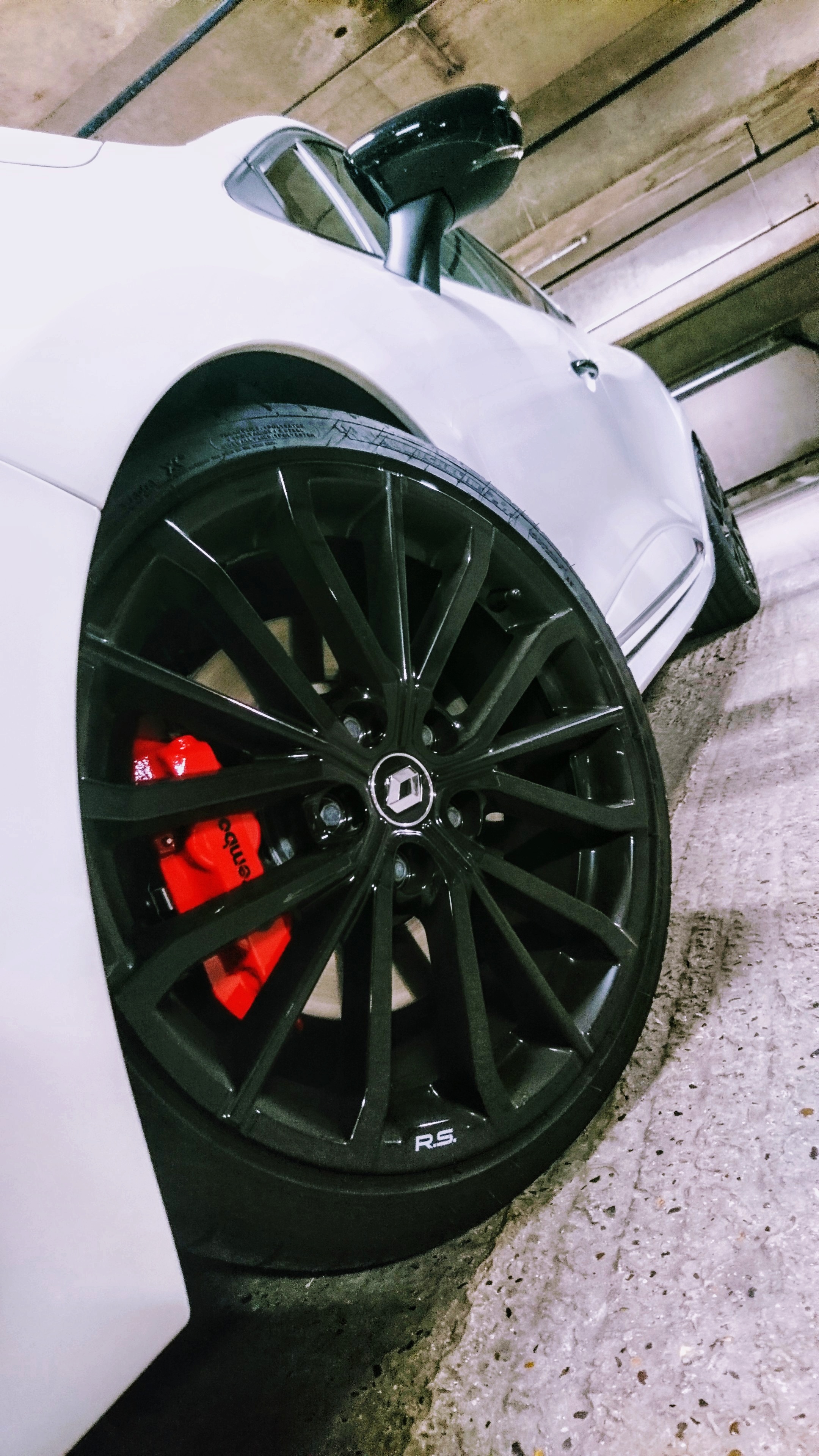

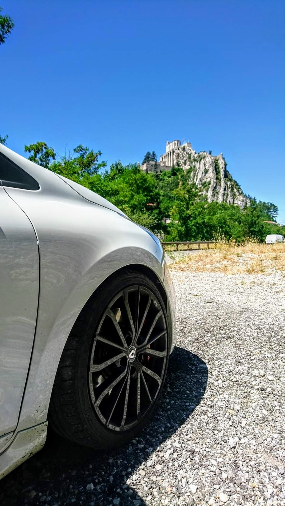

OE offset is 55 on a 7.5J
You should be ok up front as I ran 16mm Eibach spacers, the rear max I wouldn't go more than 10mm. I used the PMS hub spacers and the stance was just right IMO. 15mm all round will go but the rear will have a bit more poke and might... Might just rub when lowered.
I assume their 5x114.3?

I've heard the rears is the trouble like you said. I might just get 5mm machined off the rears and keep ET40 at the front. What are your thoughts on this? Got any photos of yours?

Machining 5mm off the rears will be fine
