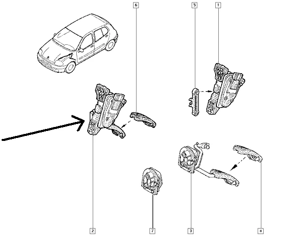

My girlfriend has a clio dci that is a bit tempramental, it has developed an intermitant fault on the accelerator. The pedal moves normally but it just stays on tickover, she turns it off and on a few times then it starts working, she reckons this happens more often when she starts and stops a lot. Any ideas?
Cheers.
First thing i would check is the throttle position sensor ( built onto the acc pedal )
