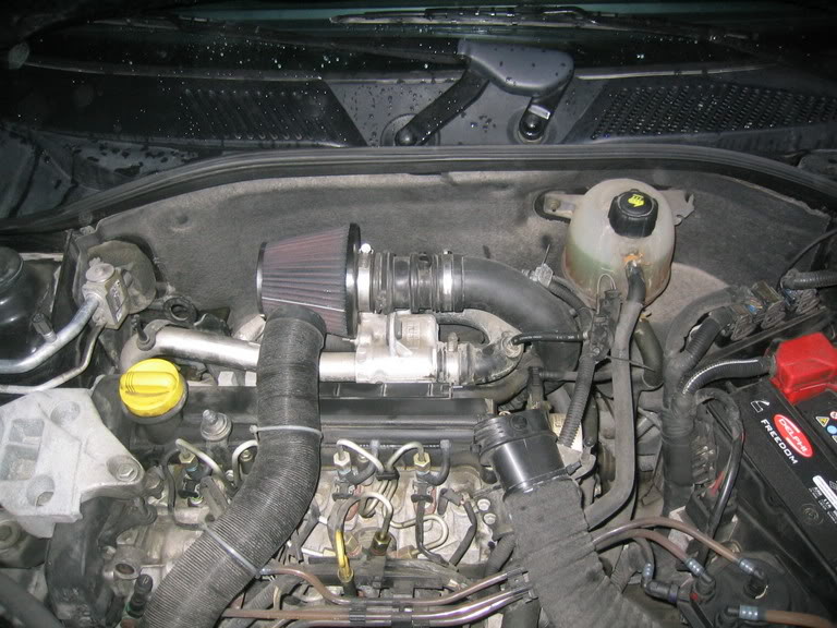

I got an induction kit! I must say, it made that diesel sound really come out however the turbo sound is much better. After some time you dont realise the irritating diesel sound.

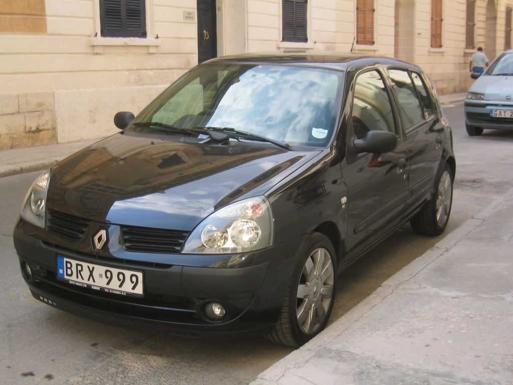

Trev can you send some pictures of your car? I would love to send some of mine however I dunno how to insert a photo into this Thread thing.

Trev, the induction kit is on the exterior section. You have to remove all the filter box. Basically the plastic cover of the engine has to go. Again, its easy to fit on, very basic.

Martin, im trying to attach a picture of my car on the site. Where do you have to go?

I have a K&N induction kit gen2. I got it from a local dealer of K&N, specifally for the dci.
I have seen them available in www.potn.com and in the official K&N sites.
