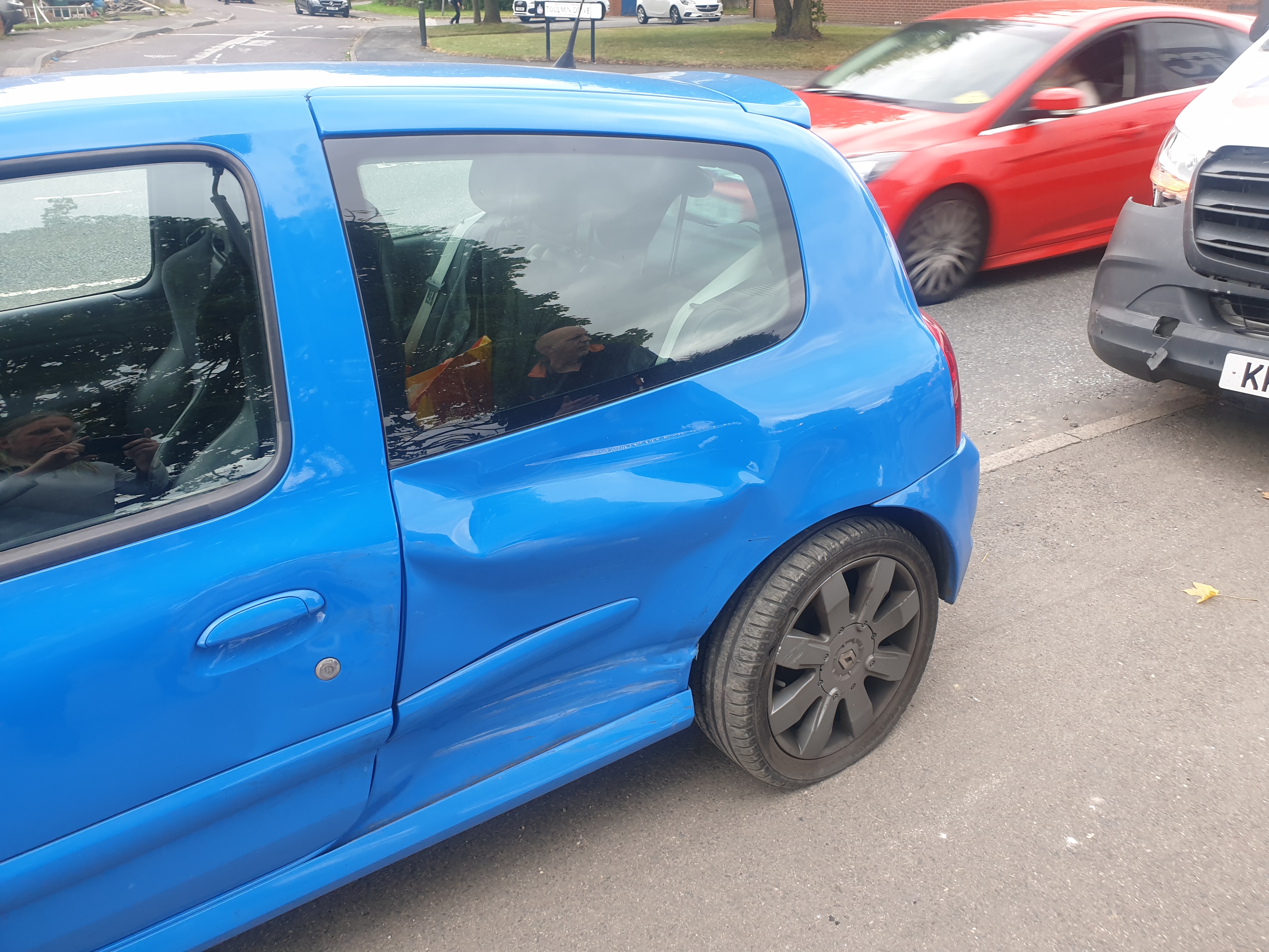

got t boned on island friday... i think its terminal

Thats very fixable. Looks like beam is bent, with a new beam thats drivable again.
Ok dent man would be able to pull the large soft dents out above the trim line however I doubt they will be able to sort the sill area nicely without car needing filler and paint. But either way body shop would do all of that without issue - I personally wouldn't put a new rear quarter on but lots of places prefer that to spending the time making panel the right shape again.
Did you get their details, was it their fault etc?

Dont even waste time on trying to repair it IMHO. Get the insurance money, buy it back and strip it for parts.
Buy another.
Klumpy Dumpy
Not all gingers stink of piss. But I do.
New rear quarter and a rear beam if you're lucky
That being said the rear beam mounting points on Clio's are made from cheese so if count your stars and hope they're intact. It would cost you more to buy another RB than it would to get it repaired
