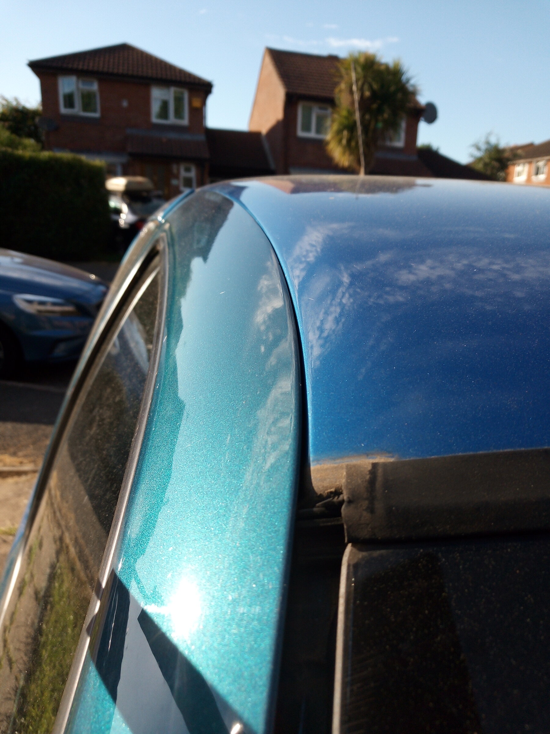

I am currently have a Phase 1 project sitting on my drive. When it arrived the N/S door was sitting completely differently to the O/S so for this reason I believed it had had a knock. It also had Phase 2 door strips on so I'm sure it is not original. I now have a 182 sitting on the drive to use for the project and since the doors are in better condition I thought I'd swap them over.
The O/S one is against the wall and the car is on stands at the moment so although its the one that is causing me issues I've had to look at the N/S one first. Also I know the N/S one fits well on the Phase 1 so it's correct.

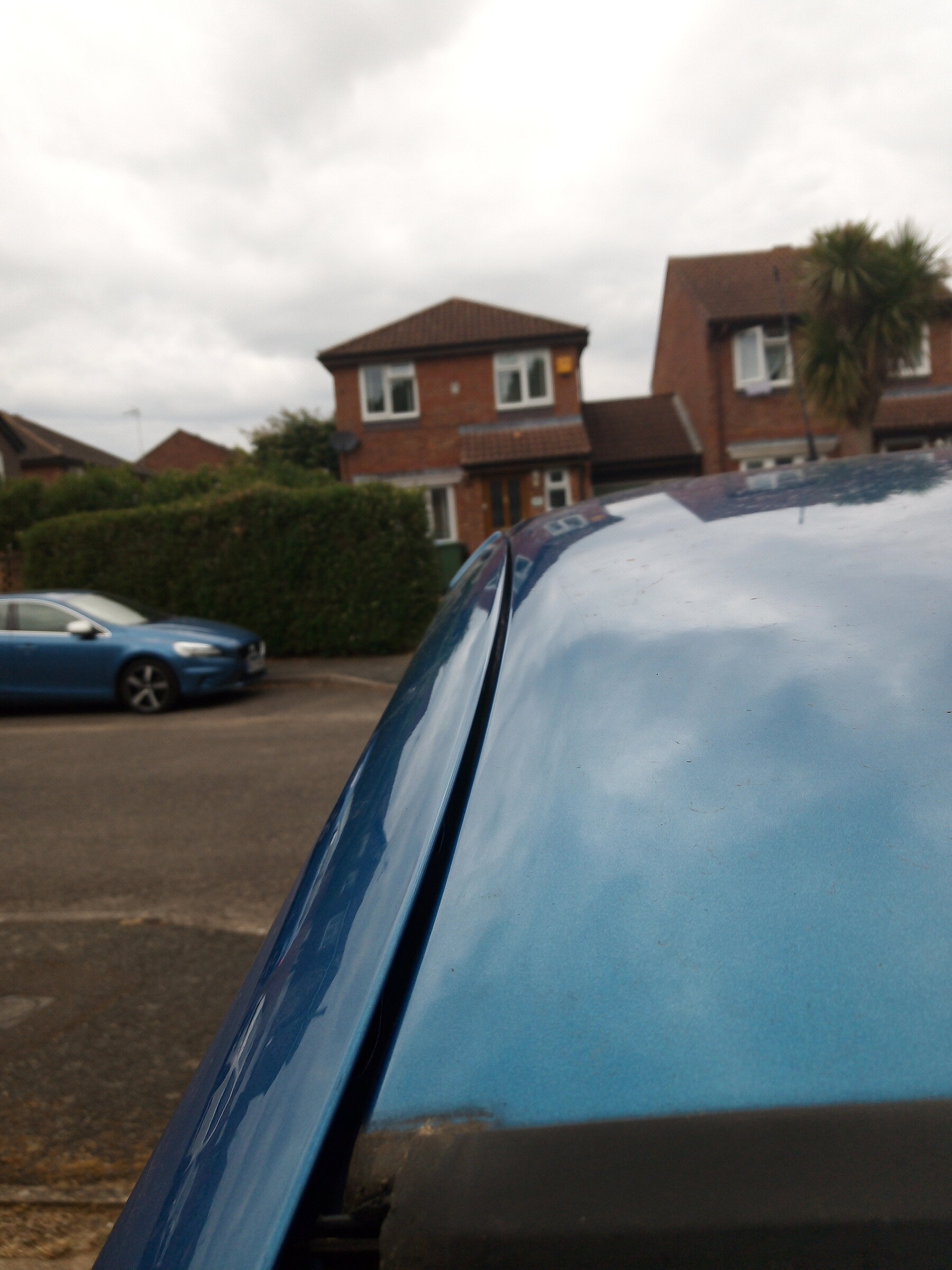

Here is the Phase 1 door then the Phase 2 door on the Phase 1, The Phase 2 gap is bigger and the top of the door sits proud of the roof edge.

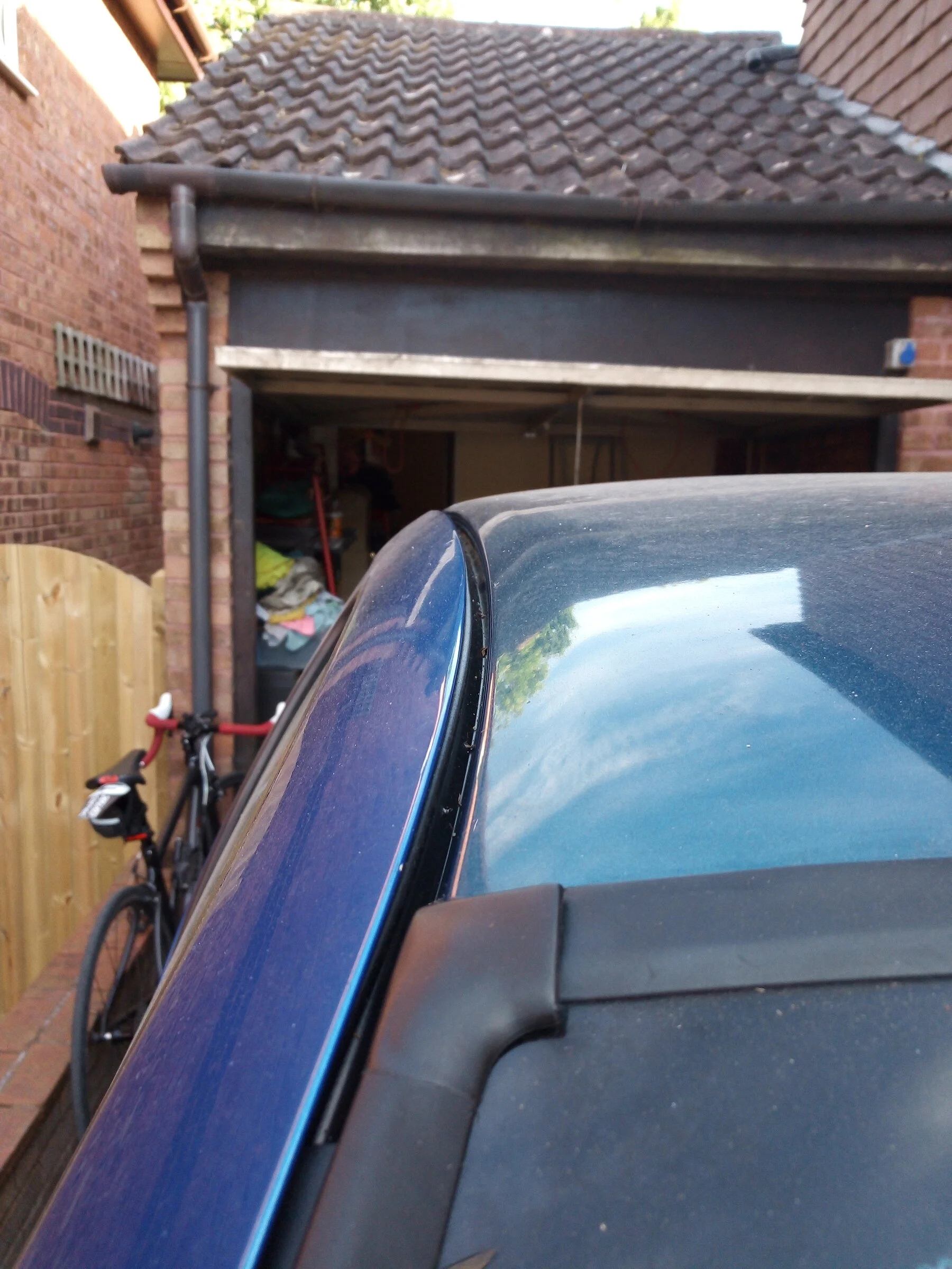

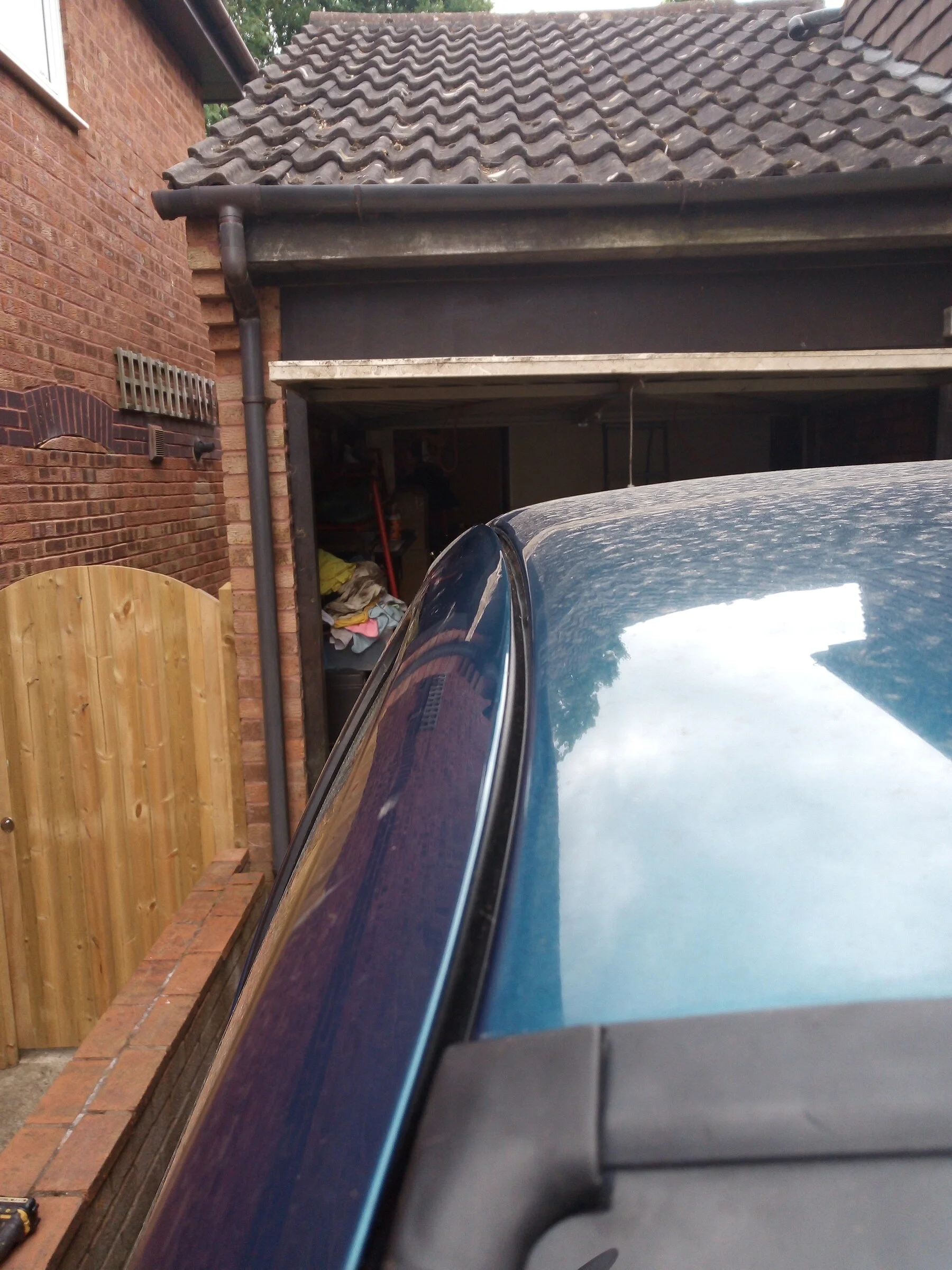

Now both doors on the Phase 2, The phase 1 sits really close to the roof in the centre, The Phase 2 door, although not perfect sits with a fairly even gap along its length.

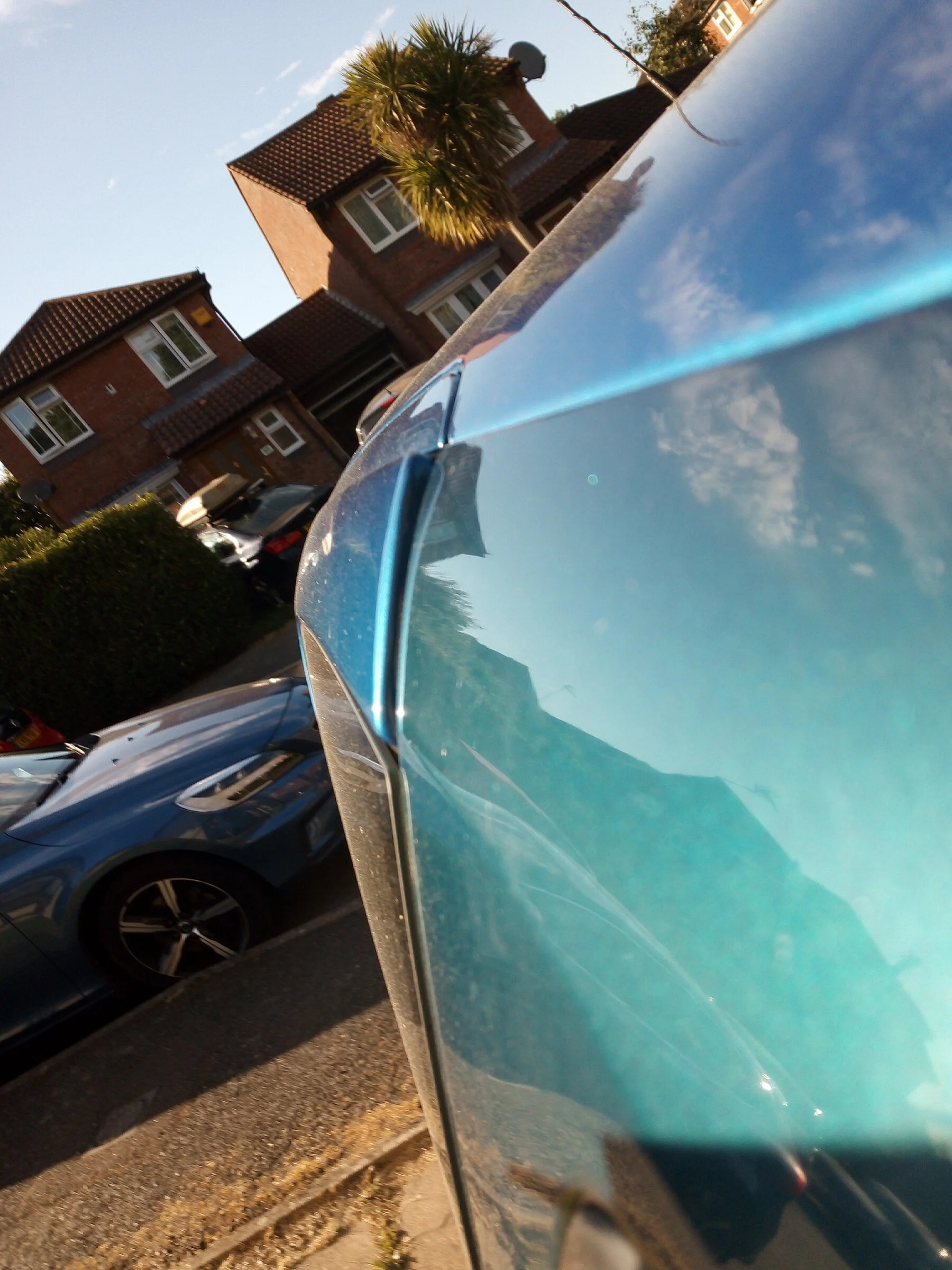

Also the Phase 1 door on the Phase 2 shell leaves the rear with this extra lip that sits smooth with the original door.

Yes I’d say just pretty badly made. There’s some old footage floating around on the internet of a Renault factory with a technician bending a door in all directions and hammering the catch with a mallet to get it to fit! So with those sort of tolerances and probably some variation in the rolling over the years between phase 1 and phase 2 I’d say that’s the problem.
A bit of fettling required but you should be able to improve the fit.
