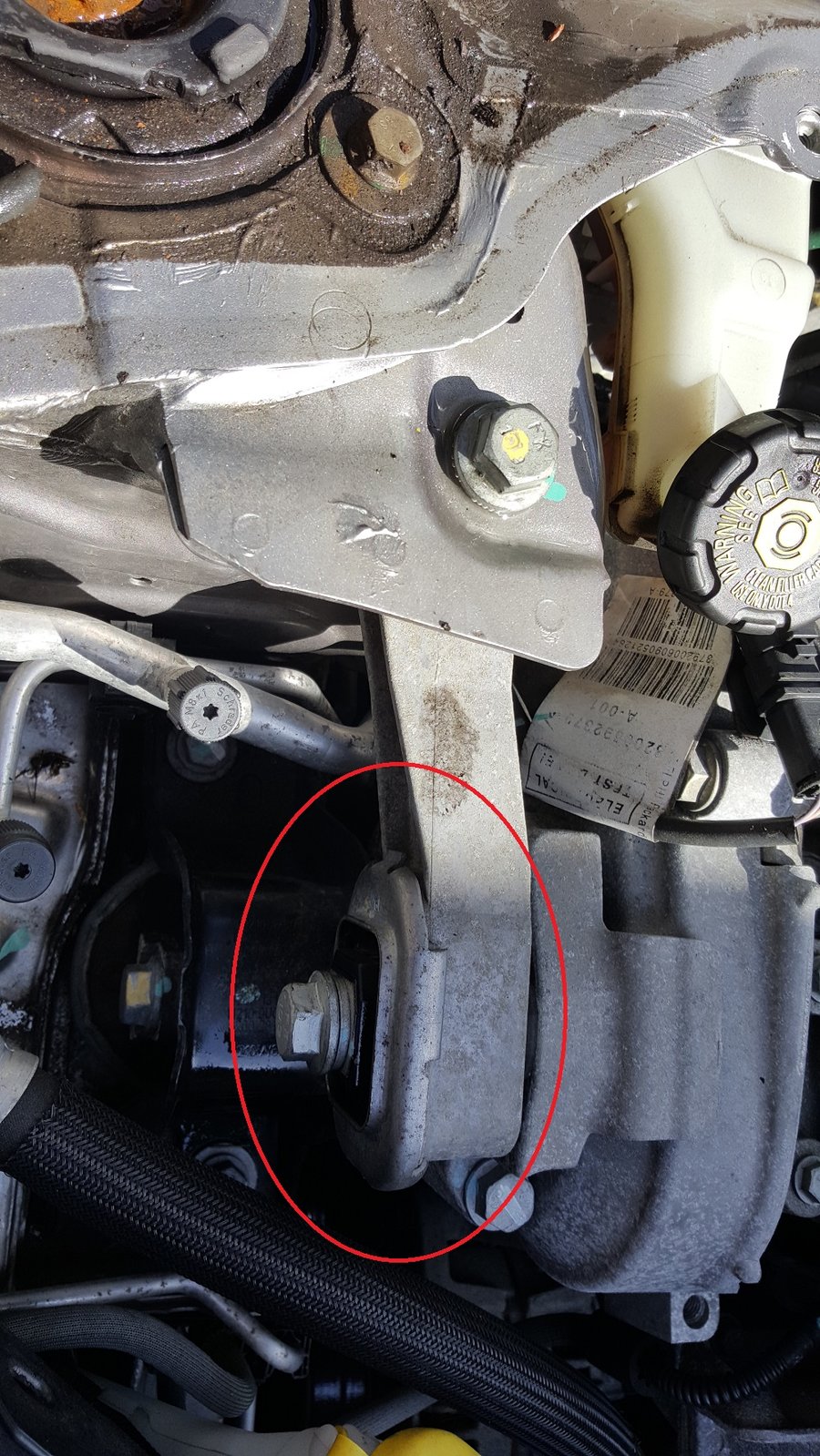

Sounds like top engine mount bush. I just has the same issue on my 197. Its an easy DIY job. I have some photo's if you need a guide.
Yeah please! Although I went out for another drive today and it wasn't doing it at all! Really weird... would it be intermittent? Is there a way to test it? My clios just a 1.2 mk2.
Mine's a mk3 but give the part shown in the image a wiggle. If there is some play then that might be your issue.

Well i've done over 60 miles in it and the noise hasnt returned.. I have noticed that my gear changing in 2nd and 1st seems to be getting tougher though.. looking at dogbone mount? I'll have a wiggle of the top bush. How would i know if it's the dogbone?
