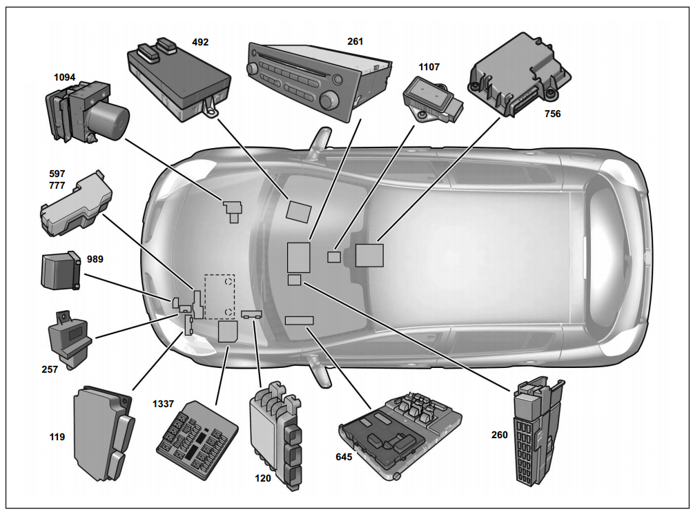

There is a lighting control module (989) and some wiring that you will need first of all and you will need CLIP to see if the module is already in place. If so simply have it configured and it should work but honestly I don't think you'll have it:
Yes, it is required as it monitors the CAN ID from the SAS to monitor the steering angle which when the lights are ON then tells the UPC (1337) to switch on the NS/OF cornering lights accordingly.

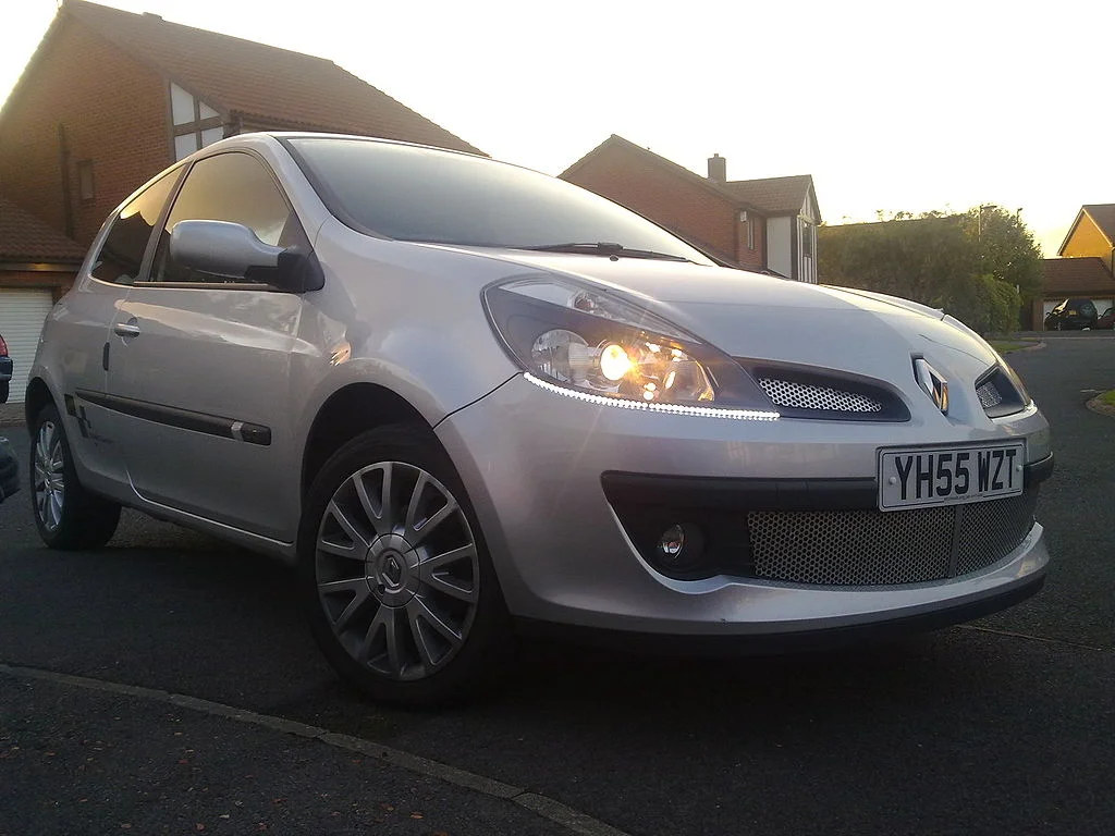

Those little LED's look horrendous mate :(
As does the grill IMO.
Not upper or lower clio are mine :)
Here is mine http://www.cliosport.net/forum/showthread.php?692726-MK3-Clio-from-Sarajevo/page2
