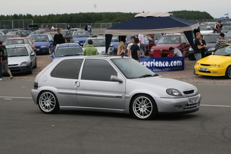

anyway pics of the 2 cars, the saco being at last years fcs!

3) the old wheel size debate! ive read on here and been told by a mate such things as 16s for handling, 17s for looks which is reasonable but with the profiles on the speedlines being a 205/45/16? its not going to be too dissimilar? im mentioning this because im a sucker for superleggeras and it would most likely be easier to fetch a set of 17s which dont seem to look too big on the clio

3. 15s for handling by far. 16s for looks, standard tyres are 195/45/16. 17s are too big and most of the time look silly imo, some look ok though (very few), superlegs possibly.
