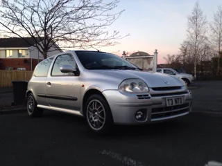

Never really posted but thought I'd put up a few pictures of my clio.
Bought the car around 6 months ago off a friend. I remember him buying it from new so I am only the second owner.
He had parked the car up for a few years and it hadn't moved so I bought it and started to take it back to standard.
Not much had been done but there were wolfrace alloys and a fate exhaust on the car. Usual induction kit and few other things.

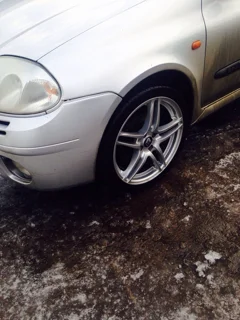

Old wheels,
I then thought about a set of turbines but changed my mind after trying them on.
I then bought a set of oz f1s (not renault sadly) but they were too cheap to pass up

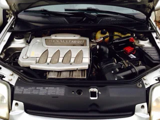

Got the ph1 airbox fitted and wheels returned.

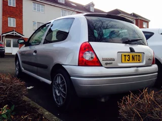

This is my daily driver bought it with 69000 and has now covered 76000
Not got much else planned for it really. Needs a good wheel refurb and a steering wheel retrimmed

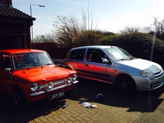

My other pride and joy takes up a lot of my time
The clio has a few issues but nothing too bad. Decides to cut out occasionally for no reason and I have problems with the hazards but I know that's pretty common.
Cheers for looking
Anyone with any ideas towards the cutting out it would be appreciated.

Having a few problems that it keeps cutting out! Feel like I need to heel and toe a wee bit when braking or it cuts out, anyone got any ideas?
The Chubby Pirate
  Golf R
Take the TDS sensor off and give the end a rub down lightly with sand paper!
Take the airbox out and its atop the gearbox bell housing!
