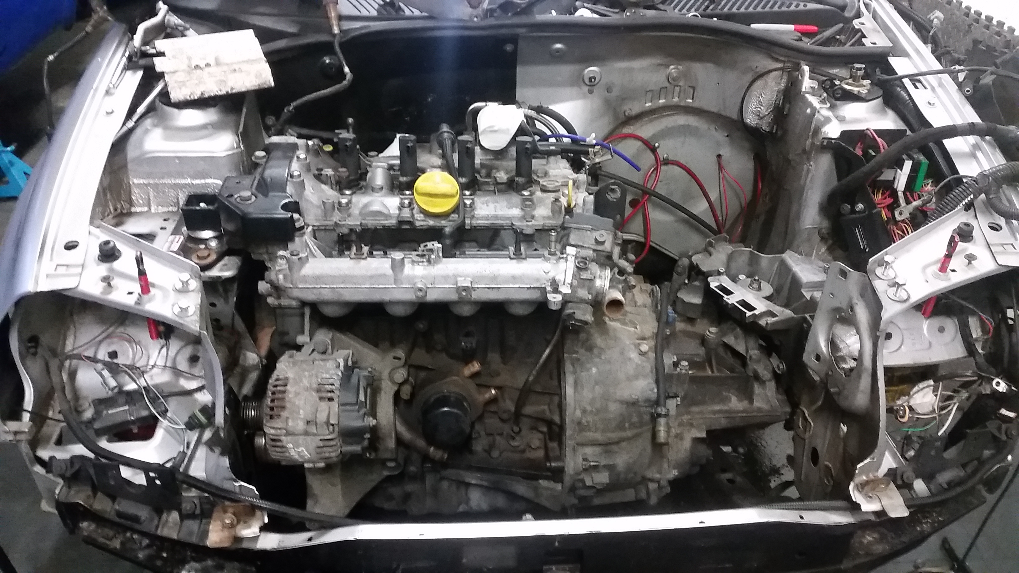

So, popped the engine into the bay tonight to try and see how much of the chassis leg needs modifying so will get on with that. Annoyingly the vibratech mount from the clio fell into a load of pieces. So jigsaw puzzle of Megane spider mount and clio top half need putting together too.

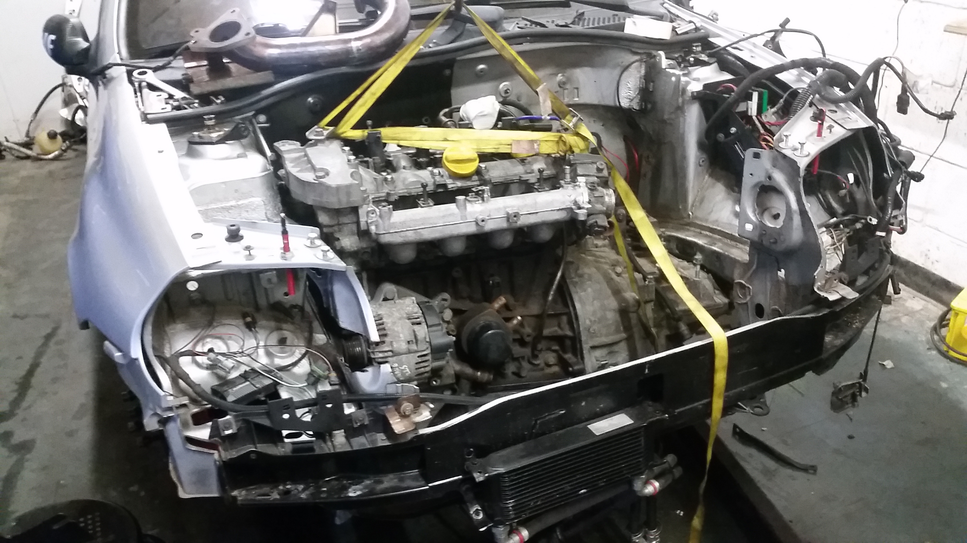

Another little update:
So I managed to get the vibratechnics mounts off the clio tonight and onto the megane engine and block tonight, I then set about getting the engine in and positioned roughly to see how much of the chassis rail needed manipulating.
After putting the engine in and out a few times and marking the area with a sharpie I had managed to mark out and indent the area enough to allow the gearbox to clear the chassis by enough the get the engine bolted up on its mounts properly.
So now I need to mock up a front torque mount and rear dog bone. The engine will then be removed again, painted and finished off to hopefully be fitted for the final time.

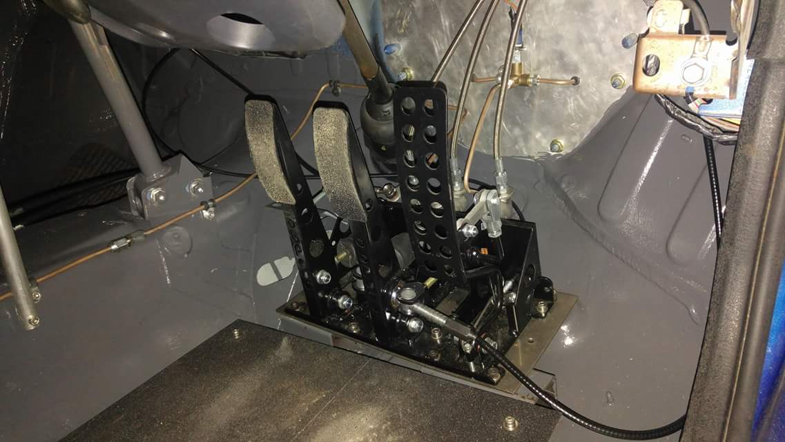

So in other news I made a purchase off @dann2707 so now have a pedal box! So going to do a similar false floor idea to his which should sort the limited space there is for the downpipe with the master cylinder in the original location. Also sorts the hydraulic cutch on the megane box.
