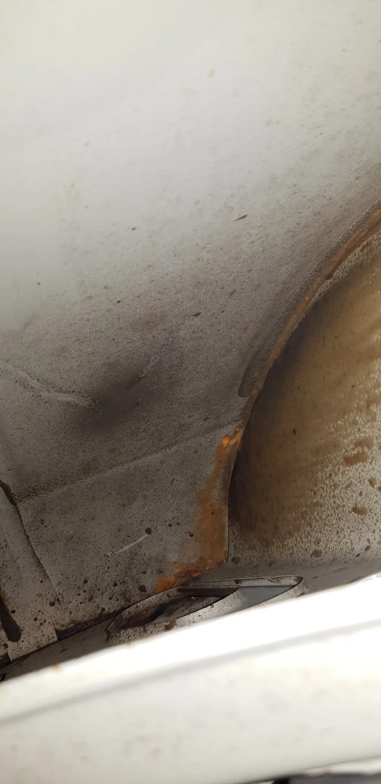

To my surprise this is what I found! Clean a whistle, just goes to show the outside can sometimes be deceiving, you will see what I mean in abit!

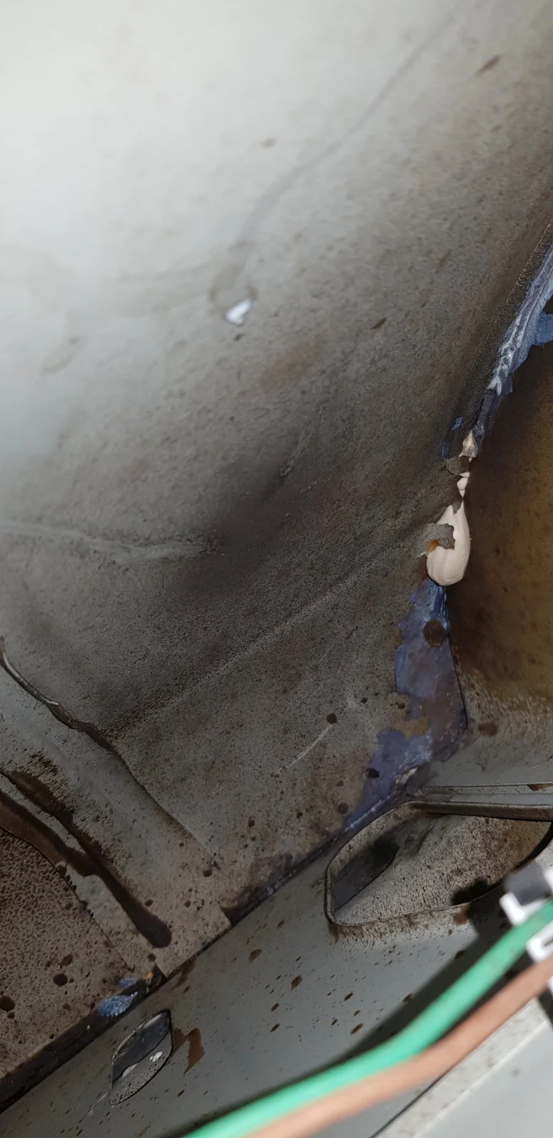

If you have rust in there I would reccomend a wire wheel on a drill, or get your hand in with some sandpaper until the rust is down to good metal. Then apply a good coating of rust converter, in my case I used Kurust and a little paintbrush.
This is after a good helping of Kurust was applied to where it looked like there was abit of surface rust. The white blob is filler popping through in case you are wondering, I took this photo later on as at first I couldnt get the doorcard off (wasnt pulling hard enough) so I left it before I lost my temper!

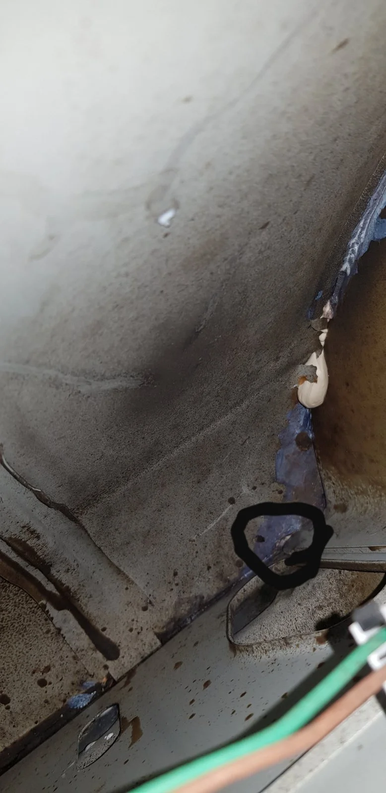

IMPORTANT
Inside the black circle you should be able to see that little silver bit, this is the drain hole, make sure whatever you do inside your sill or outside that you keep this passage clear, I used a wooden stirrer to poke any things through that got in there.

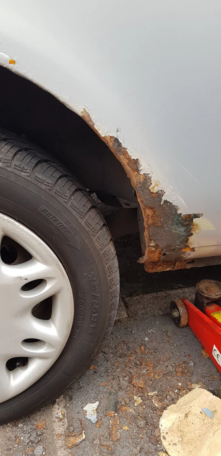

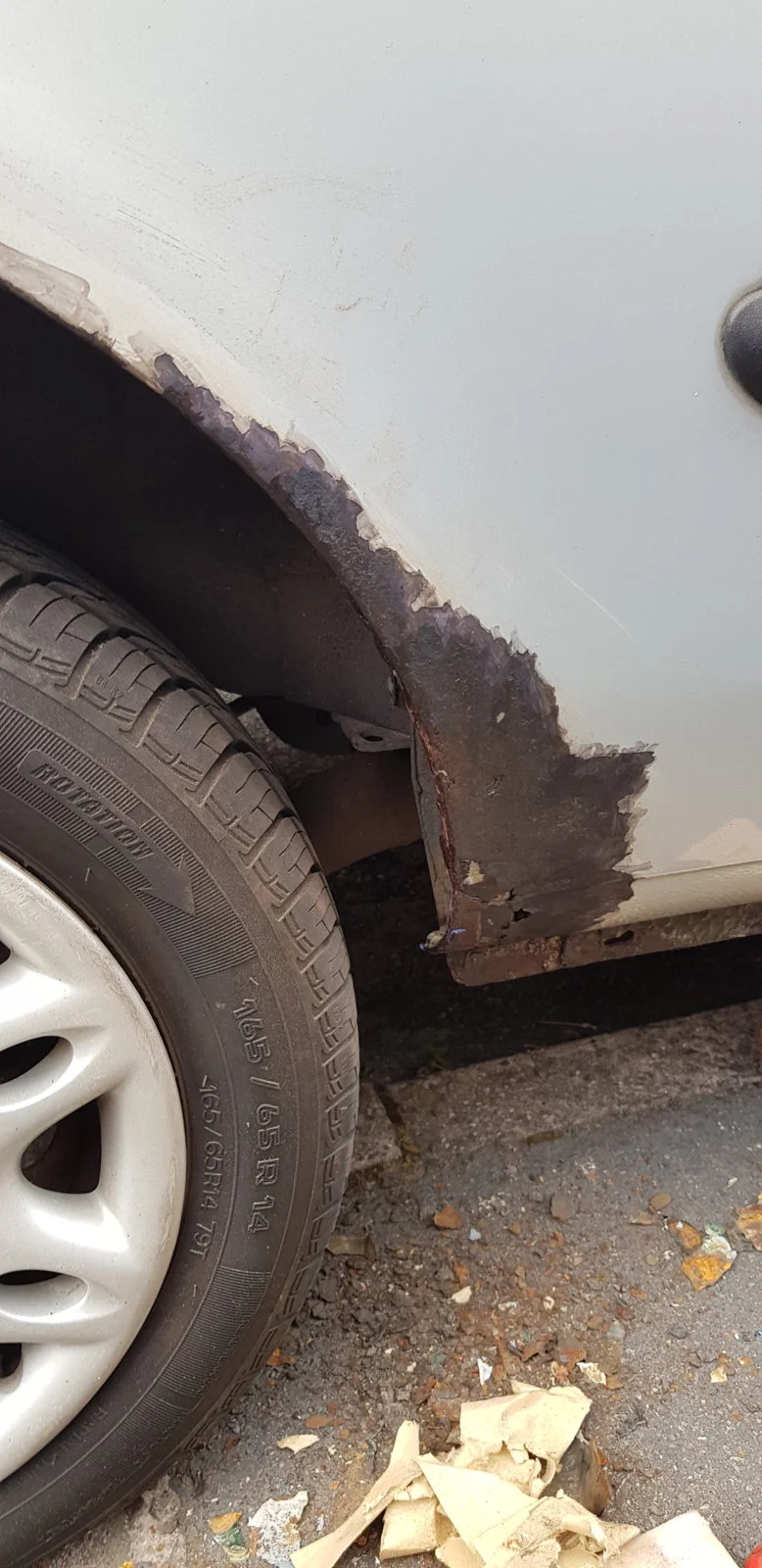

This ladies and gents is the outside of my car!

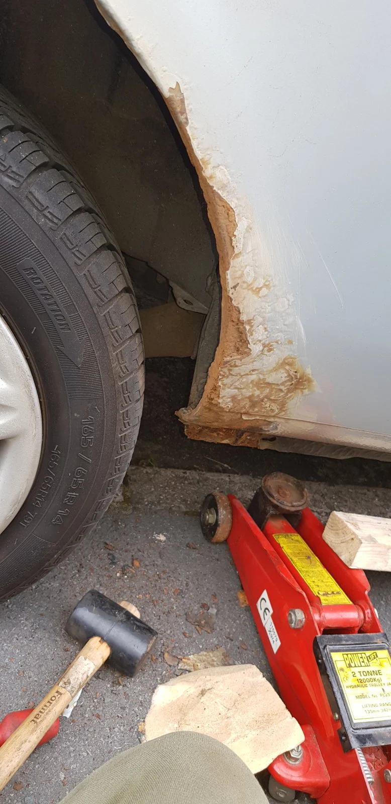

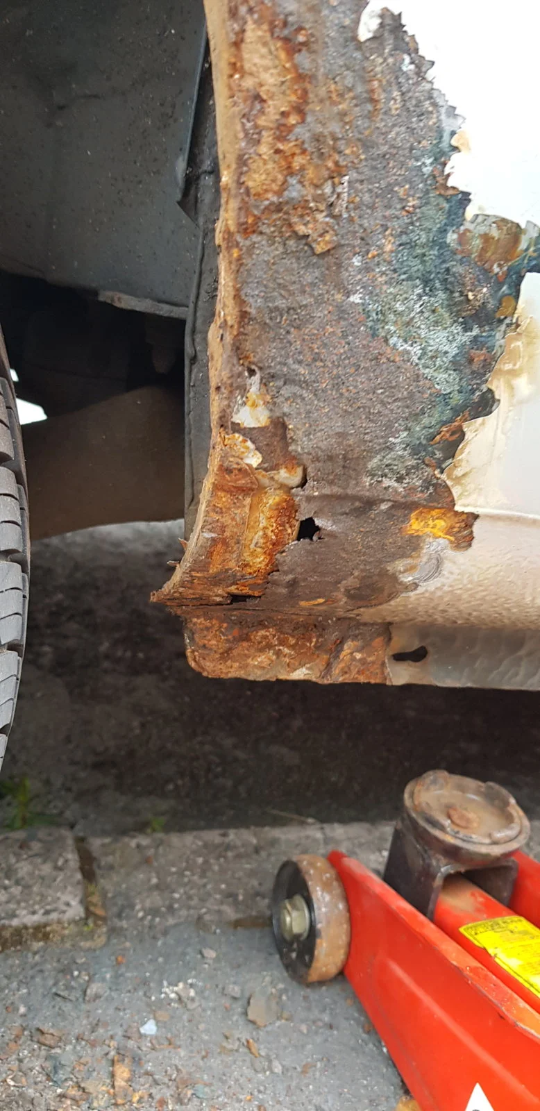

It's not going to be nice, but you need to chip all the rust off, I used a small rubber mallet and a flathead screwdriver, i hammered the screwdriver head at and angle, so I was chipping away at any metal that's to far gone, and that above is what I ended up with, nothing loose left.
Looks worse than it is! Once I had chipped all the loose rust off I then took to a low grit sandpaper and a block to rub back the surface rust to bare metal, or as close to as possible. Once your satisfied your rust is as gone as you can get it, or be arsed to get it, apply some Kurust to the bare metal areas, dont be stingy with it, get a good helping on!
The metal then changes colour and your left with something not looking too bad!

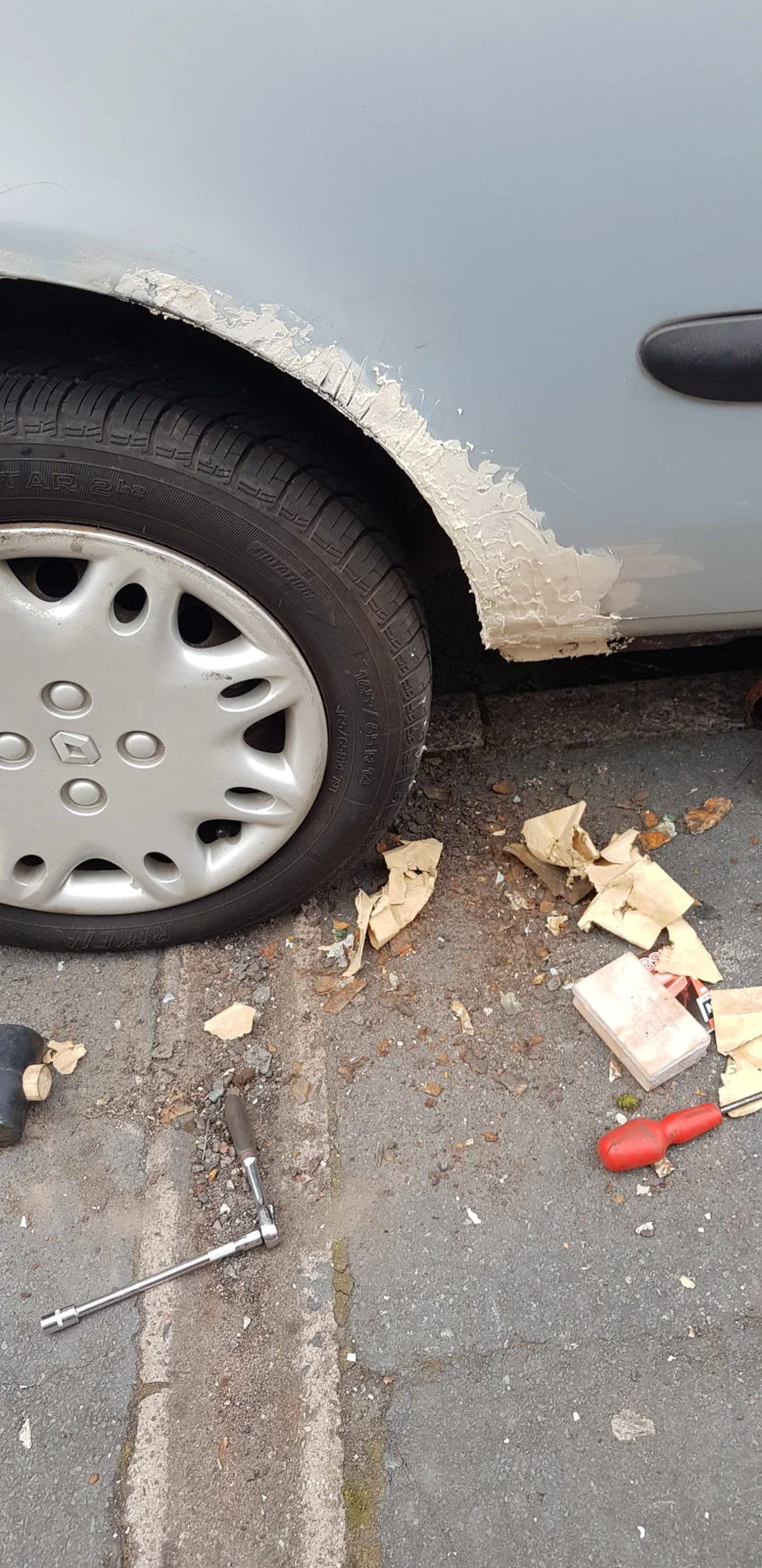

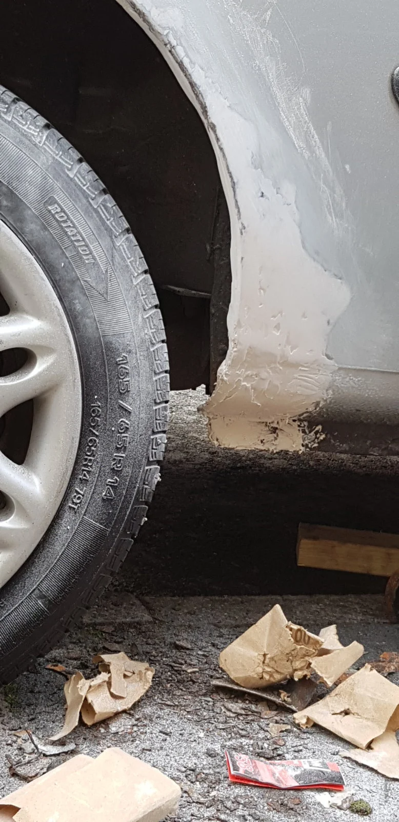

Next I filled. I can honestly say it takes talent to be this hopeless with filler. For anyone doing this job and reading this, dont put too much filler on, you will spend hours sanding, trust me, I know! I'm sure you already know, but golfball of filler to a pea of hardner and mix well as ed China would say.

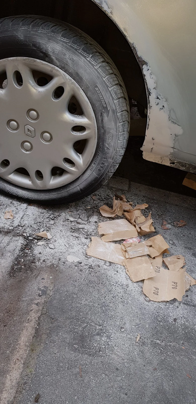

I gobbed so much filler on that it took me hours to sand back as I'm doing it by hand. I used 90 grit sandpaper to take it back. Lots and lots of 90 grit.
After many many swear words, many sheets of 90 grit, many sore hands and arms. This is the result, its pretty smooth, fairly accurate and all in all not too bad. So far my total bill is £6 as the sandpaper and tools I managed so scavenge from my fathers shed, so I've only paid for filler so cant grumble to much. By the time I had done this it was 8:45pm and my back and hands were buggered so i packed up for tonight. Providing the weather holds tomorrow I have plans to use knofing putty, a higher grit sandpaper and hopefully get some primer down. If not then I shall have to wait for the next nice day/evening after work.
