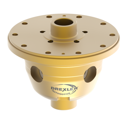

Drexler do one, they posted about it on their facebook about 6 months ago
have a play with setup though, I thought mine badly needed one from day one with the factory SuperSports, I changed them at 10k miles for a set of Pilot sport 4 and it TRANSFORMED IT! had I heard it I would have assumed the supersports were just past their best but I had it from 1000 miles and 3 months old!
  2017 Clio RS 220 Tro
Awesome thanks guys, I'll follow up with Drexler as the Waldow one is just a marked-up Drexler unit... no way am I gonna pay that much without fitment included!

Unearthing this thread to say that I recently emailed the the guys at Quaife, and they told me that they currently have no diff that fits the edc box, but they were available to make a custom one, if I wanted to.
Might be something that someone here is willing to do.
And for the record, did the same with the guys at wavetrac and no answer whatsoever.

Hi, I found this thread while search for proper LSD for my CLIO 4 Trophy.
Someone maybe know the price of the Drexler diff for the Clio 4 ? and how is that diff compare for other popular company such as Quaife mentioned above.
  Clio iv rs200 Cup
Quaife is a Torsen, which means it will shift torque to the wheel with the most grip. It won't work with one wheel in the air; while they will make the best use of available grip, they aren't predictable like the others are, particularly following a loss of traction.
You can read more info from this link:
Since Drexler is the only option ( the best option, too), you can contact
Nick at CM Engineering, the UK Drexler distributor.
I've had it for about 3 years now, only 2 oil changes; not that I need it often, but I prefer overkill on maintenance in general. It is mainly a track car; with the correct driving technique and suspension setup, it makes your car feel like an AWD car. But please remember FWD needs the best tyre you can get; no LSD will cover up the loss of traction from budget tyres.
