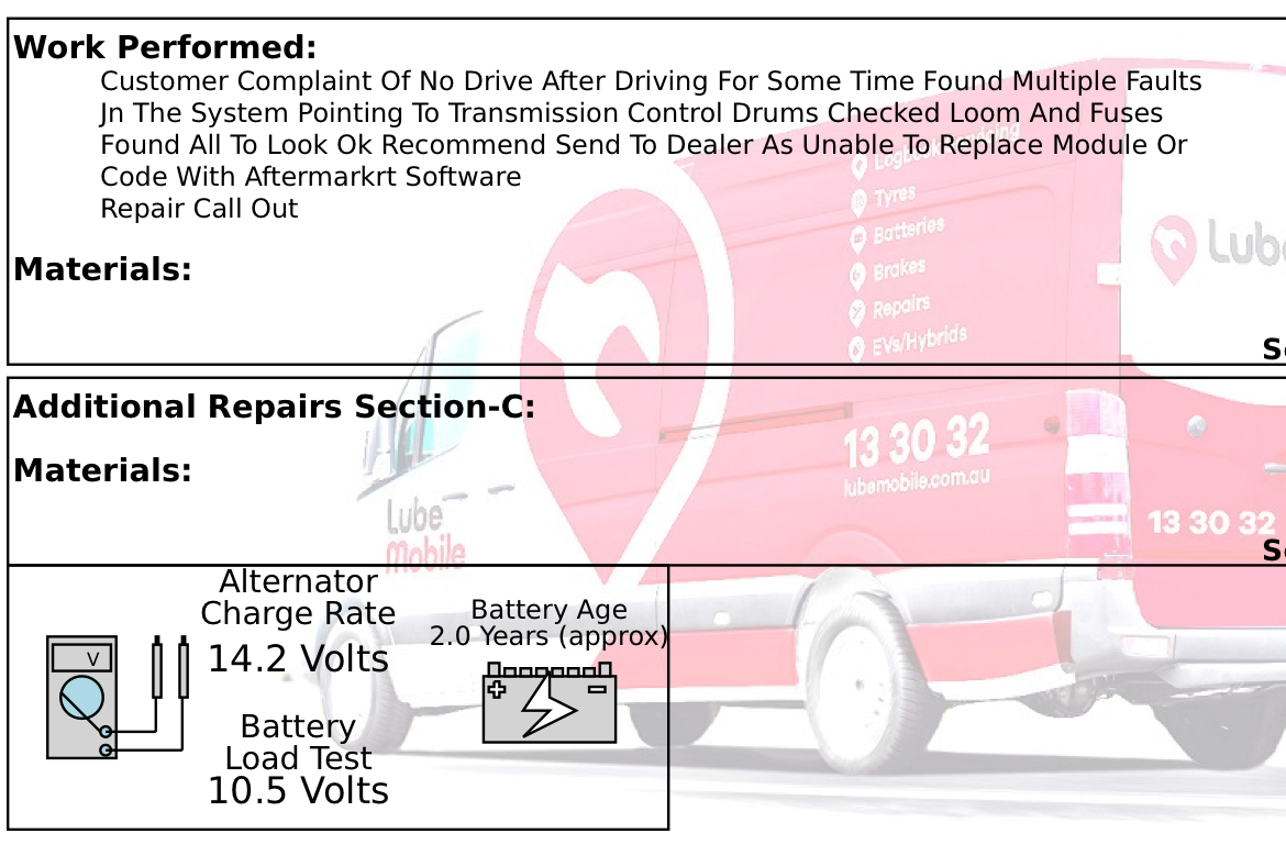

Booked in with Renault Servicing on Friday
  2014 Clio RS
Not sure about the load test result.
Latest, tried it again tonight - all warning lights have gone but petrol gauge showing empty (it wasn’t empty and definitely wasn’t petrol that leaked out when I broke down)
Keen to see what Renault say in the morning

4k for just a auto gearbox computer Is alot.
The computer is around £1200 quid
Depending on where the OP lives (I’m guessing Australia) $4k is about £2k. £2k for the TCM + programming at a dealer probably isn’t too far fetched.
