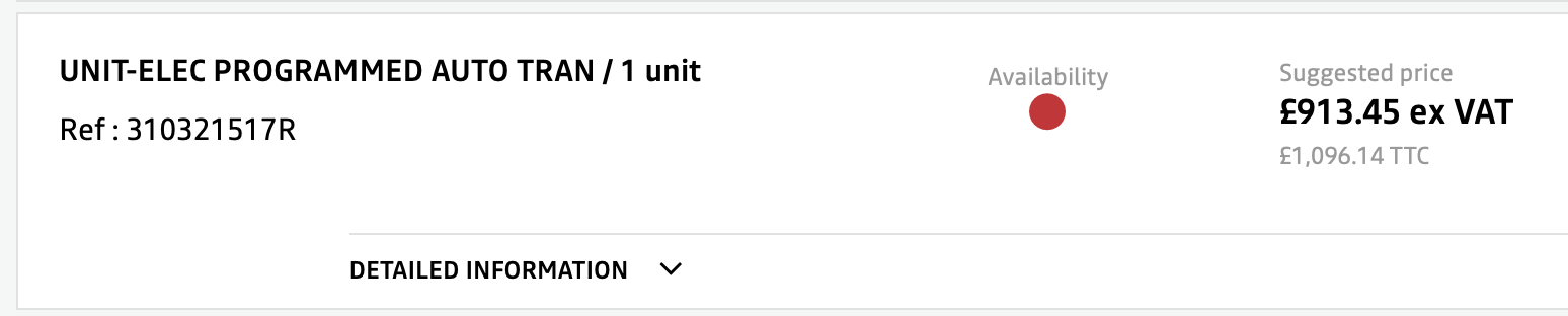

Not cheap these
Is that the official price fro Renault? I saw $3,000 in Australian dollars. And that was a few months ago ...
This is the RRP from a Renault dealership in the UK but some dealerships might be slightly more expensive or slightly cheaper.

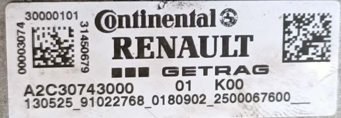

I bought a TCM reconditioned from China. Nobody here could reprogram it. So I took it to the dealer here and they charged me three hours labour to put it in. I got a call saying that it was a unit from a 1.2 Captur and was not compatible with an RS200 and could not be used. The Chinese dealer thought that it SHOULD be reprogrammable for an RS.
Does anybody know if this is true? Is the physical unit the same between the two cars? I was happy enough with the dealer service, but I wonder if they were being lazy about reprogramming it rather than just setting clutch points etc.

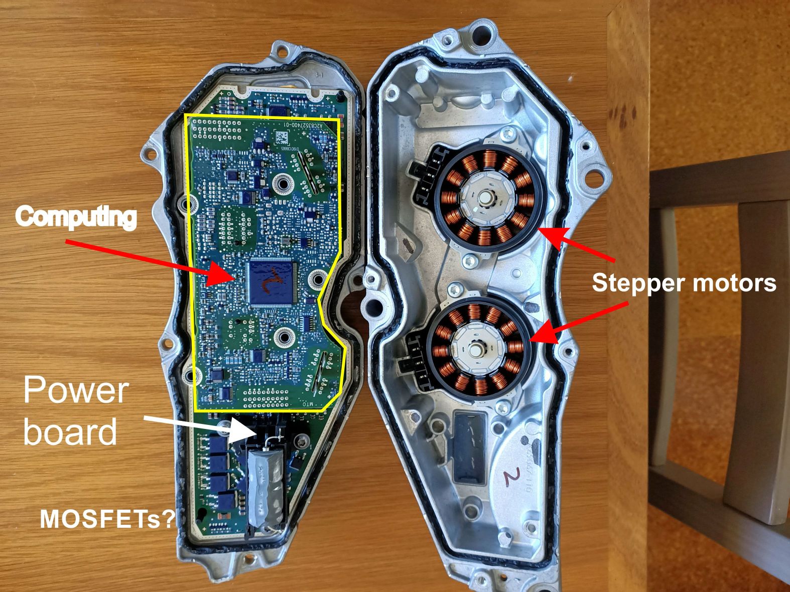

Attached is my new TCM opened up, as I can't use it anyway. Renault claims that it is a board for a 1.2, not an RS. On the right is the motor unit. Outlined in yellow is what I take to be the computing board with a chunky CPU in the middle. Below it is what I take to be the power control board. The pins to the motors come through the outlined computing board from the power board below, and pin into the connectors by the motors.
If i were designing it, I might separate the power and computing boards, as here? In mass specs they are optically separated.
I think that the power and motor boards for the 1.2 and the RS might be the same. Possibly the computing board is too, just programmed differently.
My terrible plan is to open my RS TCM and see if cleaning might help, and look for blown components. A friend of mine with a Citroen cleaned out his TCM and it worked much better after that.
Failing that, I shall try to transfer the computing board from the RS to this unit (very carefully) put it all back together and see what happens. It depends if everything specialised is on the computing board, and that I don't damage it. And where the very intermittent fault is.

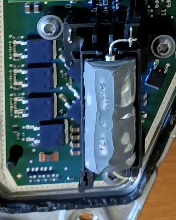

I took out the original TCU which was throwing occasional Check Auto Gearbox errors. I split it open. NOT an easy job and I got a good deal more energetic with levers than I intended. Fortunately, while the software may be soft it doesn't seem to be brittle...
I couldn't see anything damaged inside. I concentrated on the MOSFETs (none of which looked cooked) and the large capacitor. I was interested to see that the Chinese reconditioned unit still had the original capacitor as there was original adhesive on it as well as new. The back of that unit has (I think) a coil on it and therefore I assume that the whole thing smooths power surges, but I am not an electrician. The new capacitor was soldered in whilst the original just had grip fittings. The old capacitor still held a good charge: take heed!
I couldn't think of a way to test the steppers. There is a very high resistance across the terminals, so there must be a driver or something in there.
The computing board, if it is, was extremely reluctant to separate from the back board, so I left it in there. But what IS replaced in the Chinese reconditioned units? I see no evidence that those boards have been repaired and I'm sure that replacement cost would be prohibitive. So at the moment it seems that neither the boards nor the capacitor are replaced. Are the stepper drivers replaced? I don't know.
So putting all these thoughts together I soldered the new capacitor onto the back board fitting and put it together with the new steppers.
To my surprise the car started and runs fine without errors. I made a 5 km loop with the gearbox working perfectly. We'll have to see in the longer term.
When it fails again I will try swapping the two clutch servos. I have spares of those. I would have thought that a failed clutch operation COULD cause any of the errors that I have seen.
Sorry that there wasn't a more concrete result.
As above, I decided not to risk my computing board and left the two boards together. I rebuilt with the new capacitor and steppers but all the old computing bits. So far, a week later, the car is running perfectly even though it's pretty hot at the moment. I'll update later if/when I get another Check Auto Gearbox. If not, then the problem was in the steppers. I've not retuned the gearbox at all, but it seems that the settings retained on the board work fine.
When I looked on line the opinion seemed to be that MOSFETs are very robust and don't deteriorate much over time.
I'll give it a bit longer and then I have some lower mileage clutch servos that I will swap in and see what happens.

You may have inadvertently solved your TCU issue, all mosfets tested okay and nothing else looks to have an obvious issue BUT the capacitor and it's out of spec....I would assume so was yours, both motors and coil were perfect. New capacitor on the way, maybe this is all that goes wrong with them... I would really like to get hold of a completely failed unit to test and trail things on..
The capacitance should be 2200uF. The measured capacity was over 2500, which is high although in spec. High reading may indicate ESR issues, so I measured ESR and it is very high (80-100 times higher than expected)

I would guess the reconditioned unit had a new capacitor installed in it, maybe that's all they do component wise to call it reconditioned if that's the failure point on them
Resistance rises as the capacitor begins to fail
I'm not sure. Capacitance generally falls. I thought that yours seems fine to me. It's very close to spec. And its main function is probably to provide juice to give the steppers a kick, so a slight excess in storage doesn't seem to me like a problem? And, as I said, the capacitor in my reconditioned unit looks re-used. I'm not sure about resistance. Actually I'm not sure about ANY of it! ;-) But a new 1000 uF capacitor off our shelf has a resistance of 4 megaOhms. The slightly damaged one in my original TCU has a resistance of 22 megaOhms.
As for testing the steppers, the gearbox works the vast majority of the time, so I might have to test the steppers a LOT to get a failure. A job for an arduino? But the failure may not be reported by the stepper electronics. It's probably reported by sensors in the gearbox, because the steppers don't seem to care what position they start in.
Either way, capacitors or steppers, in my unit at the moment the problem does NOT look to lie in the boards. Which is what I was first thinking of.
But despite my doubts, it's not exactly clear to me what can go wrong with the steppers. When my TCU next fails, I shall try just changing the capacitor and shoving it back in.
My apologies, I know that this is going round and round. I've attached two photos. They were taken when I first opened my Chinese rebuilt TCU. The first is the capacitor and the second is the socket that it sat in, in the motor-side of the case. It is clear that they have cut the capacitor out of the gum used to glue it in. You can see the cuts on the capacitor and the socket side. I can see why they cut it: I damaged my original trying to lever it out. So the capacitor is definitely re-used and probably from the same TCU.
That means that my current TCU is running with the original boards, a re-used capacitor and probably reconditioned steppers. I assume a stepper driver problem caused it to fail. I suggest the existence of a driver because if there were simply connections to the coils, there would not be close to infinite resistance between the three connectors for the steppers.

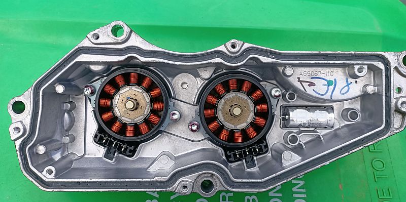

The capacitor is glued to the motor half of the casing but the holder is on the bottom board, when reinstalling we put glue on the capacitor installed in the holder then put the motor half of the case on, the holder just has pinch style 'teeth' that hold on to the wires of the capacitor

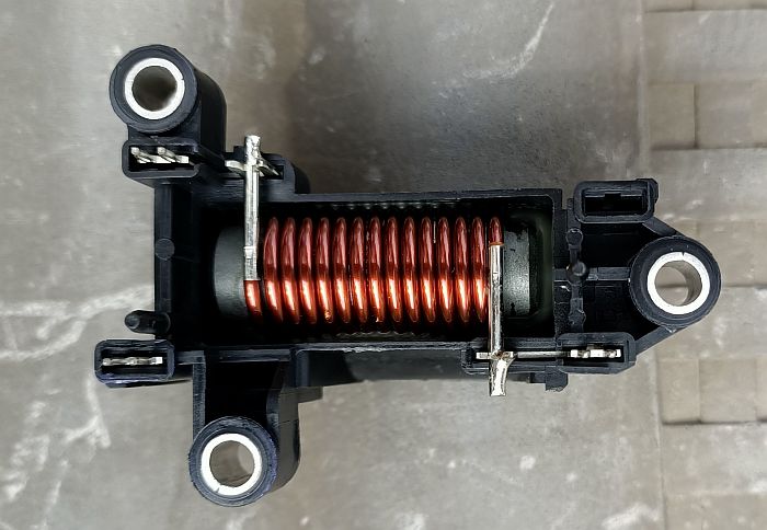

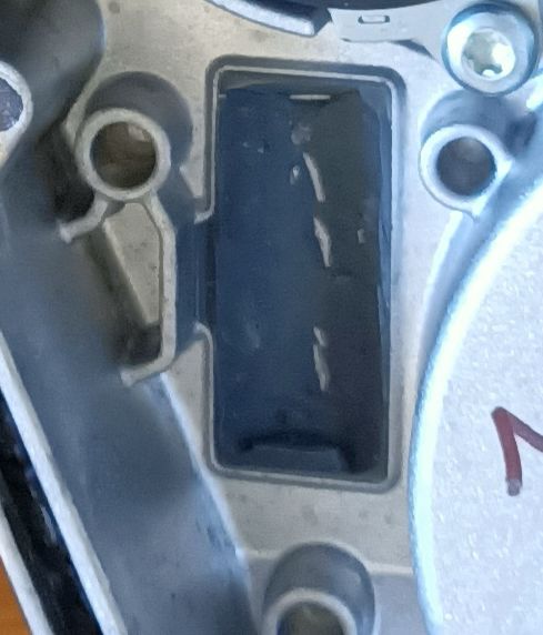

There are 4 steppers driven from the TCU. Two (in the TCU) make the gear changes. But the wires to the two clutch actuators (I think) also come from that box.
As I am not planning on using my old TCU, I bashed one of the steppers out. Really there doesn't seem to be much to go wrong with them, so I have to put my vote with ClioRS200T that the capacitor is the key.
Though I've seen at least one failure from an exploded MOSFET.

Okay I see. I got my together with new capacitor today and drove fine and the error code I would always get instantly is gone
So appears we've found the fault with these units, fixed for £12 lol
