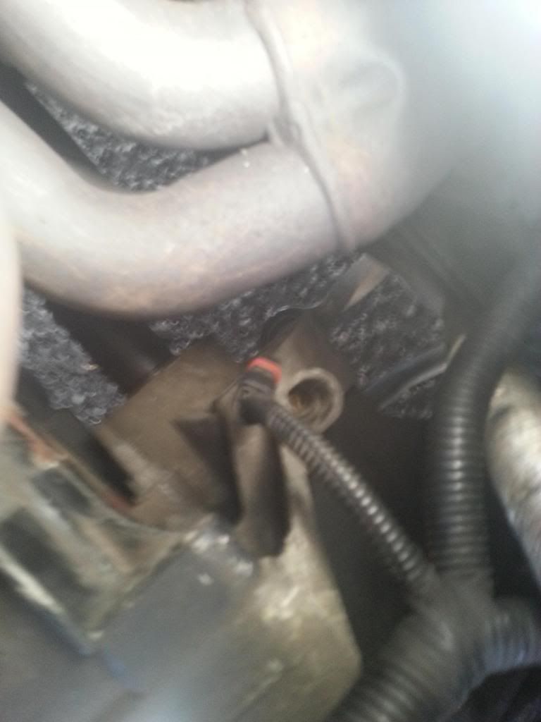

hi there, my clio 172 will not start, the starter motor just clicks, i have noticed there is a cable that is hanging out near the starter motor and i cant find where its meant to go, can anyone with a sport tell me where its meant to go please, i have attatched a picture of it.
http://i1232.photobucket.com/albums/ff379/bordertechnologycentre/20130501_122342_zps8a61bcca.jpg
also i have the dreaded UCH fault aswel, could that be related to the starter motor not working? or just a coincidence?

Not sure what that loose wire is for...

Are you sure it doesn't go into the whole on the gearbox directly in front of it in that picture? If no one answers by then, I will go out an have a look later this afternoon for you :)

The connector is for the speedo transducer, which you don't have. Nothing to do with the starter.
