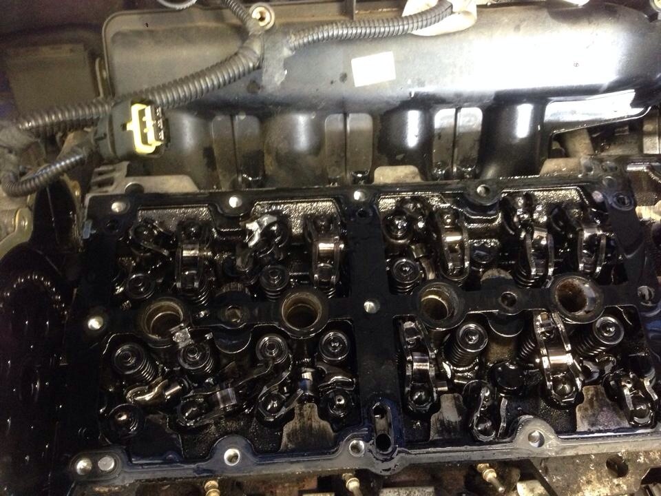

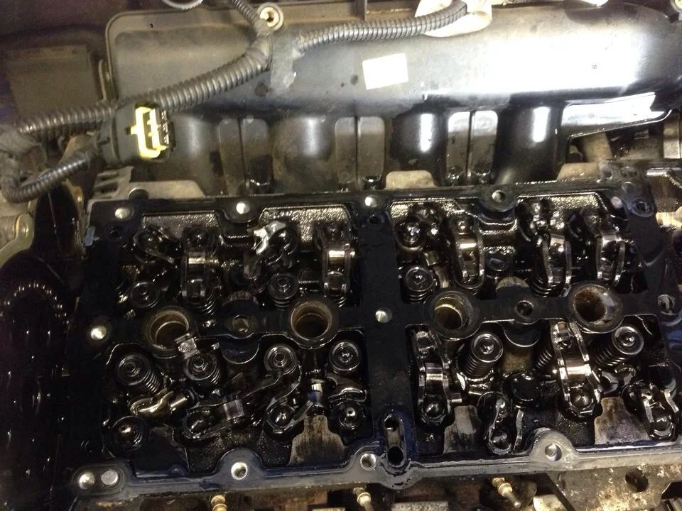

Yes, but at least a noisy chain is not going to mess up your engine; i have heard of some smaller-engined Clios having their belts shot at as little as 36,000 miles.
Really???
Here's what a noisy chain caused.
