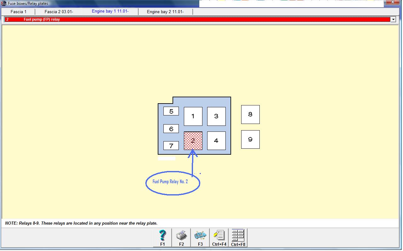

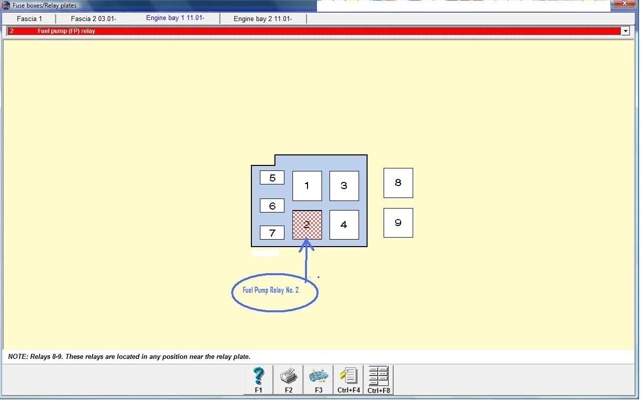

Could a faulty fuel pump relay/fuel pump cause these symptoms?
Anyone got a pic of the 182 fuel pump relay, im sure its under the bonnet but im unsure which one it is.
  PH2 172

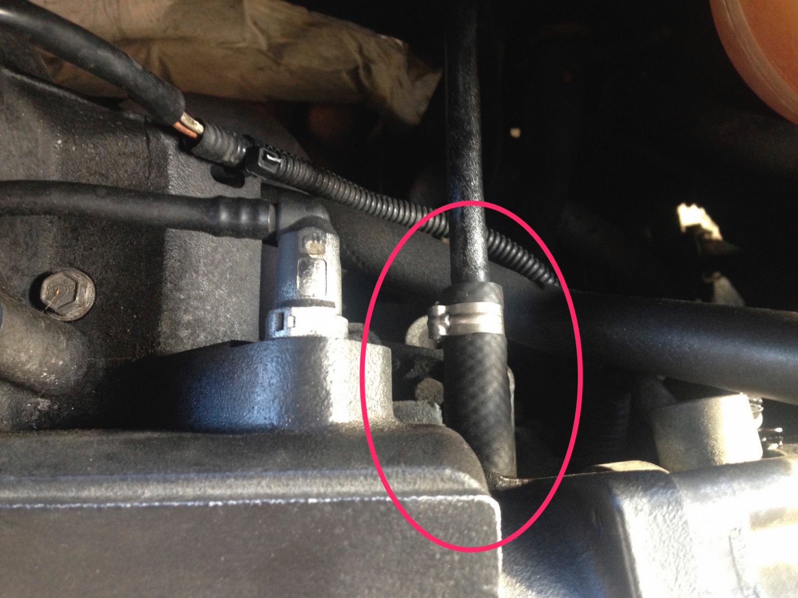

I think i have worked out the misfire, but i wont know until tomorrow.
I was thinking to myself earlier, since this misfire, the brake pedal has been really hard, so i have just been round to the garage and checked the plastic vacuum pipe for the brakes that comes off the back of the engine, and yes its got a big crease in it and a little split, so somehow its been trapped when the car has been taken apart and creased it in half!
Could this be the cause of the over fuelling and rough running? I havnt driven the car the past few days since its got worse.
Hopefully this will fix it, any ideas how to fix the pipe temporarily until i get a replacement? Its the plastic pipe the goes to the back of the inlet on the tb side. Its kinked double, could i snip it then join it with a small snug hose and small jubilee clips just to test it?
Where does this pipe lead to? Is it hard to change? Its this one, although i think this is a 172?

pull it out of the rubber pipe, cut it back a bit and then shove it back in the rubber pipe.

just cut the damaged section out and stick it back together in see what happens, looks to be some sort of vacuum pipe
  RB Clio 182
the split is 12" long?
No, the split is tiny, it looks like the pipe has been creased in half but straightened out again but now its left with a crease and split.
The damage is about 10-12" away from the inlet.

ah!! ok, cut it at the split and then just join it back together with some rubber pipe. it's the vac take off for the servo, goes to the bulkhead and then across the back of the bay to the servo.
  RB Clio 182
no just cut the kinked section/area out and tape the pipe back together to see if it sorts the issue, if it does then carry out a permanent repair :smile:
Sorry mate i was replying to bloke, i should have quoted, yea im going to do this but join in with hose and clips.
