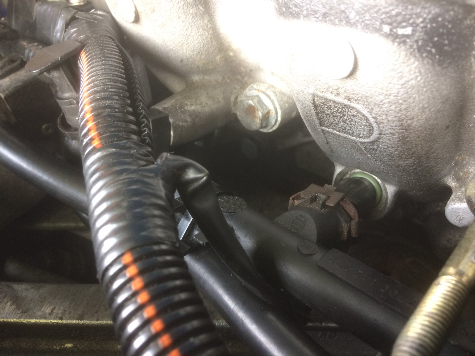

Ill pop round in ten mate and put them up, cylinder two injector fits nice and snug, the other three dont go in and you can see the o ring clearly not pushed in far enough into the inlet.
I could put them in the inlet first but then im guessing ill not be able to push them into the rail far enough, and if i do they will just pull back out of the inlet.
  RB Clio 182

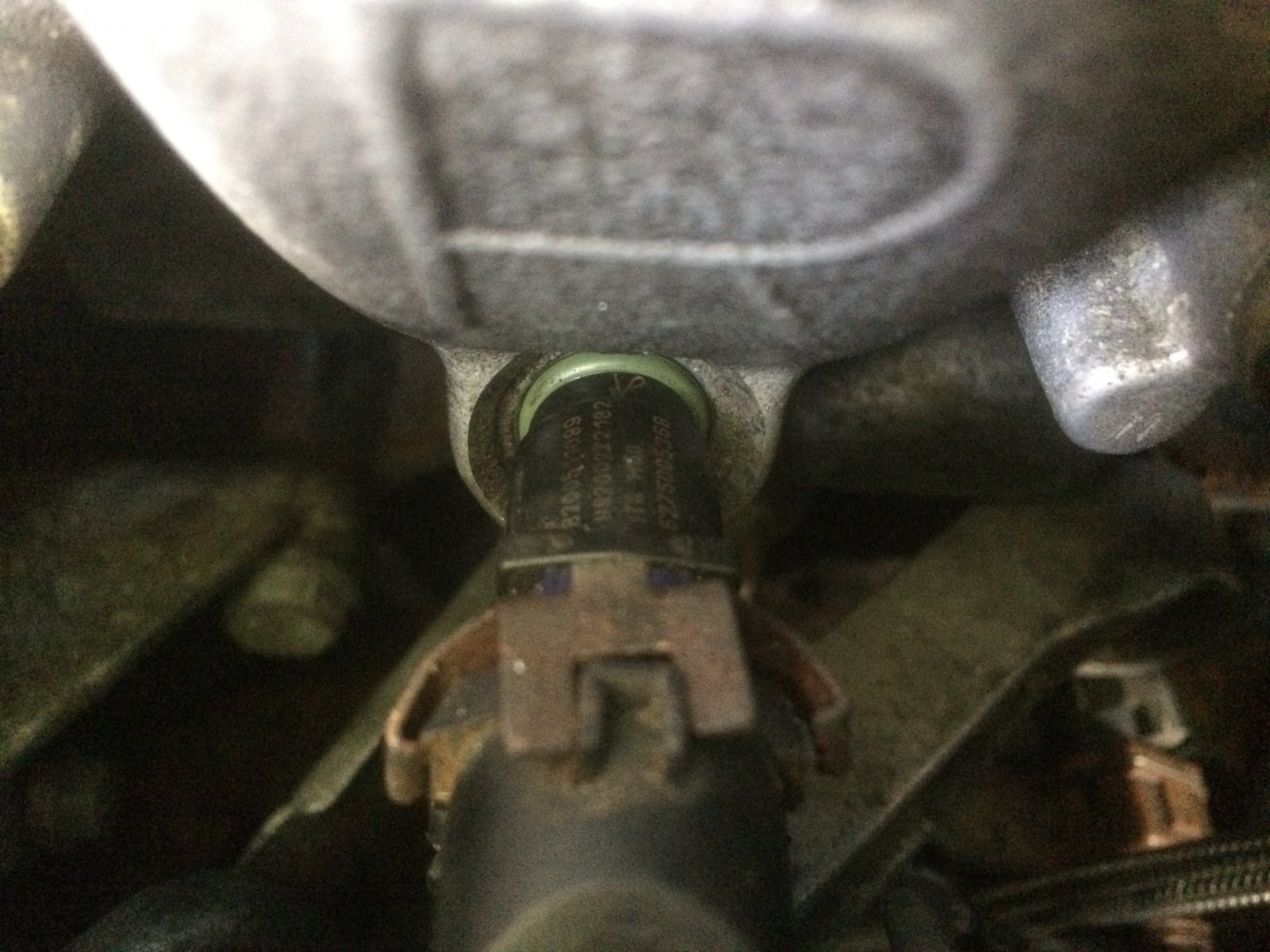

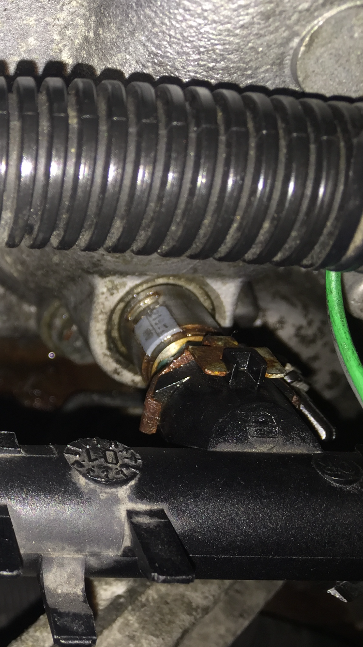

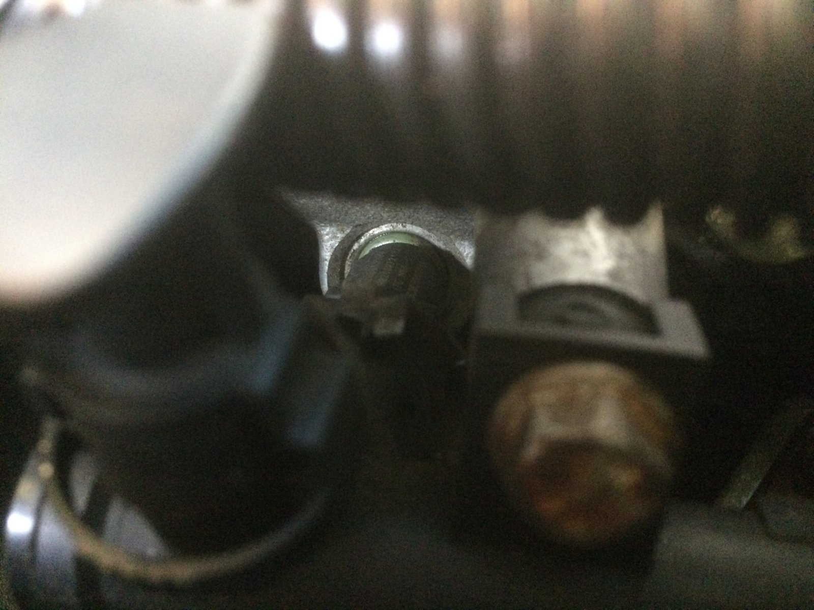

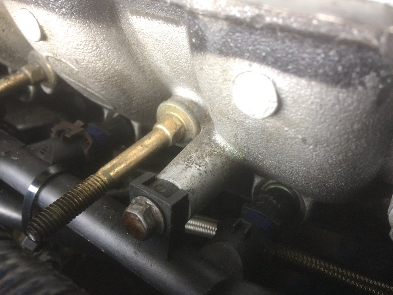

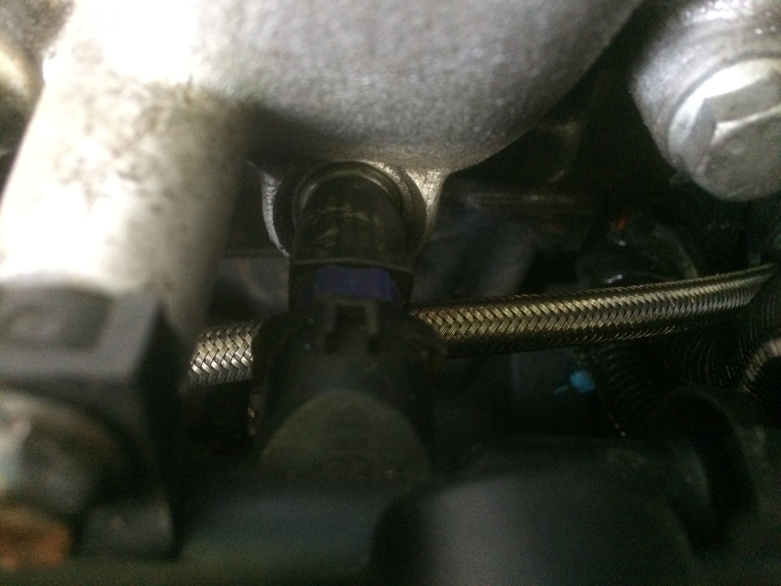

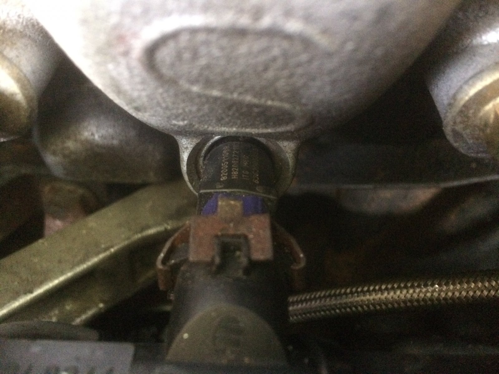

Heres a few shitty pics of how far the injectors push into the inlet, its physically impossible to push them in any further.
Its weird how cyl 2 injector goes all the way in but the other three dont, excuse the missing clip off injector one, it didnt have one on when i received my car back from ct.
Cylinder 4
Cylinder 3
Cylinder 2
Cylinder 1
Cylinders 1 & 2
Cylinder 3(cyl 4 is a b*****d as its hidden behind wires and s**t but it looks the same as cyl 1 3 and 4)
Sorry about the pics, i cant get my phone in to capture them properly, but as you can see, injector 2 goes into the inlet nicely, the others dont.
  dan's cast offs.
unbolt your fuel rail and tip it down then push and the injectors should seat properly. then lift the rail back up and bolt it into place. also looks like your injectors are orientated the same as the clio ones, they need to be 45deg out otherwise you're going to have potential issues with port wetting. without looking in the flesh is guess at the injectors being pushed a bit to far into the fuel rail as well.

I will have a check tomorrow, the injectors are only pushed in the rail as they should be, just popped in, i will give everything a double check tomorrow and try your method of refitting, i did take my time refitting and adjusting and thats the best i could get them.

The o rings fit mate, but the injectors dont seems long enough to fit down the little pipes.
I assume you have checked they are all the same length & part number?
I have noticed 225 meg injectors have green O rings, in what way (other than colour),do they (the O rings) differ from the usual black O rings on 172/182 & standard Megane?
