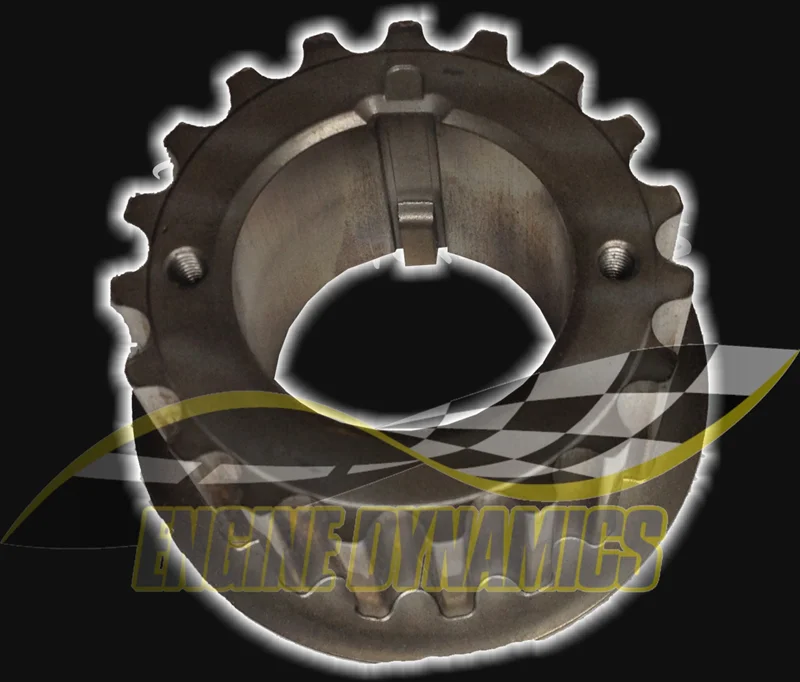

Yes should be keyed on turbo and supercharged although it may be the exhaust pulley or the inlet. The nut and bolt should only be used once and the surfaces degreased and torqued to spec as you properly already know.
Crankshaft Toothed Bottom Pulley with Integrated Key
Crankshaft Toothed Bottom Pulley with Integrated Key, recommended for use with Superchargers, High Boost or engine speeds over 8000rpm.
Scroll to product details
NEW
£43.33 exc. VAT £52.00 inc. VAT
This pulley features an integrated locking key that directly fits onto the Clio crankshaft to prevent slippage (no modification required). The original pulley relies only on bolt torque to retain its postion and have known to slip on engines that are Supercharged or use a High Boost turbo setup. We would also recommend these pulleys if the vehicle is subject to consitant engine speeds over 8000rpm.
No modification is needed to fit as there is a keyway in the Clio Crankshaft. These pulleys are factory fitted to the Megane 225 / 230 / 250 / 265 and Clio 197 / 200 as standard.

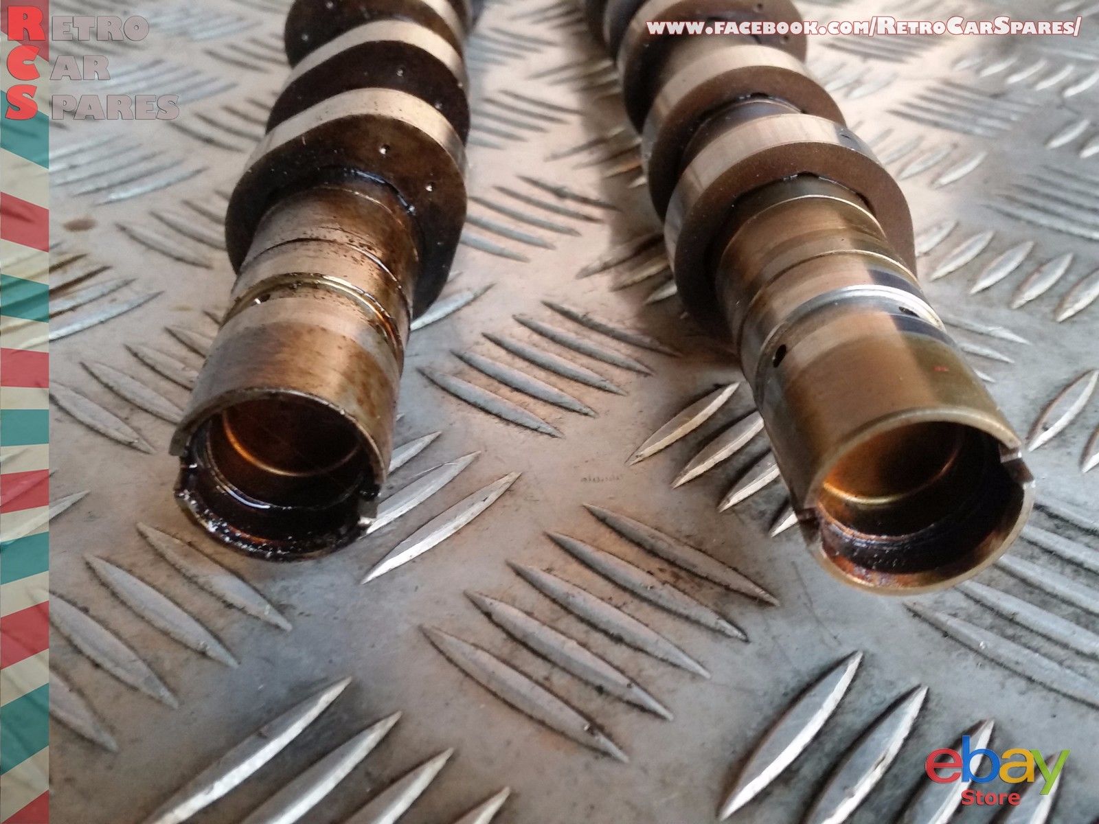

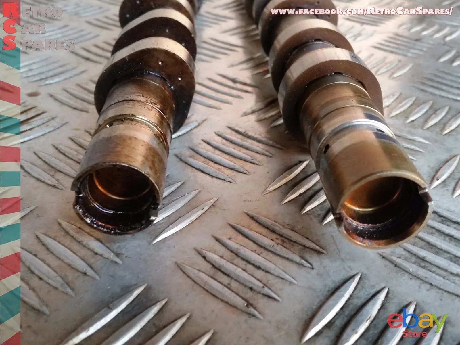

Would it have really have added so much to production costs to have proper woodruff keys, or splines & timing marks, rather than have a bit of horseshoe shaped piece of angle iron & a locating bolt in the crankshaft, with all the tapers at the correct torque.
And some some good solid cams?
