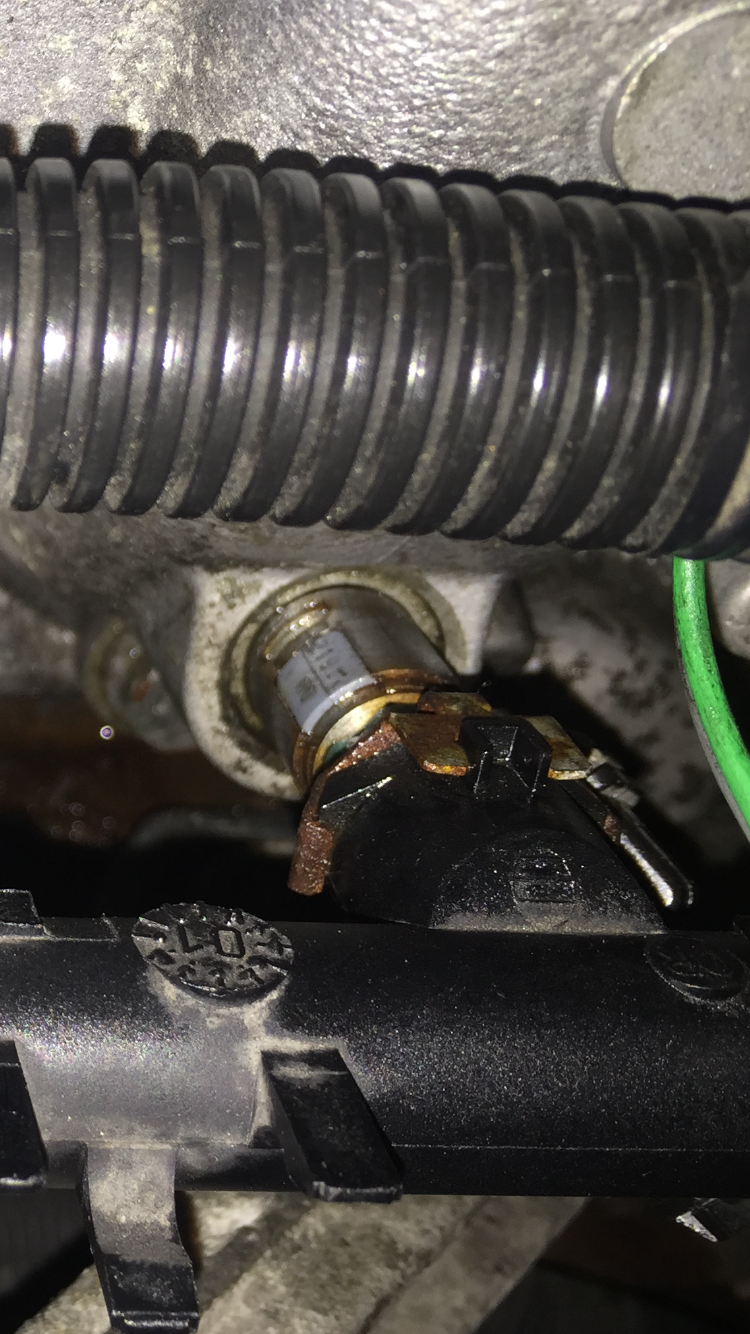

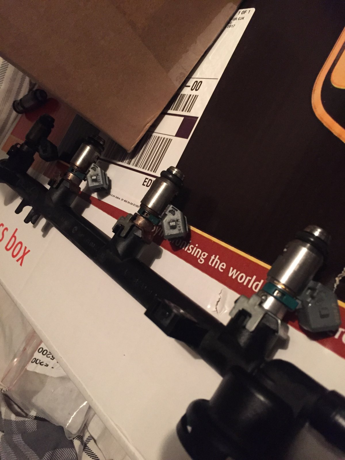

I took the injectors out earlier and put some cardboard under to see the spray patterns, but the one nearest the cambelt end popped out of the fuel rail, and the others left no spray at all, i only turned it over for a second, the car actually started lol.
When i took the fuel rail off, two injectors were left in the lower inlet and two came out in the rail, are they meant to be so loose?
I put them all back in the rail before fitting back on the inlet, but they dont seem to pop in the inlet far enough, and the wont go any further due to where the rail bolts back on.
I have also noticed that on the adaptronic ecu,
The injectors should be held in the fuel rail with clips.

Do they not have the clips on??
  RB Clio 182
The injectors have the clips but they are a bit s**t, lol at davyy :smiley:

the injectors should be clipped to the rail, you don't need the clips there but it keeps them on the rail when you pull it off.
unplug coilpack and then see how they are on cranking. all this really does is tell you that they can fire and and give an idea on spray pattern. doesn't mean they are fine.
pop them all out again, off the rail as well, check the o rings are ok. try and get some rubber grease, thin smear over all the o rings and then injectors back in the rail and then refit the rail.
if you can get a multimeter check resistance on them, should be about 16 ohms.
