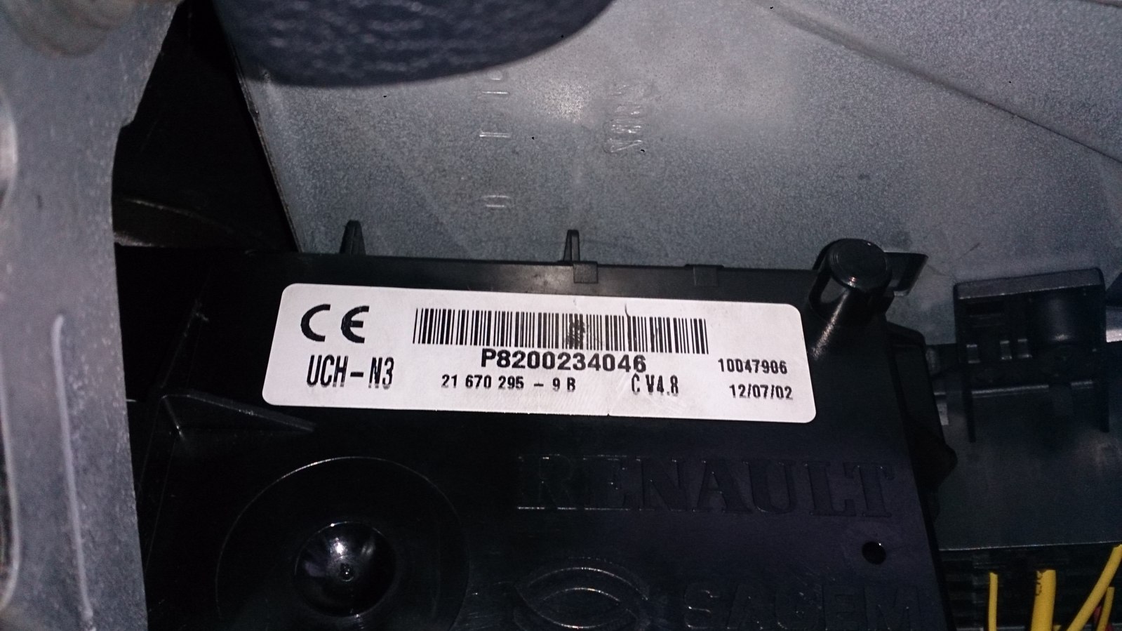

Okay the electronics in the car are getting worse, when I brake my indicators come on instead of the brake lights, and when I indicate the brake lights come on instead... so I am in need of changing the UCH Asap! Here is the code I have on the bottom, I have been searching on ebay and cant seem to find one with the same serial or version number, does the serial and version number need to match? or can I pick up another N3 UCH with a newer version and serial?

New UCH required. Simple
If you have an N3 you need an N3 but ignore the rest. They are coded to each car though
